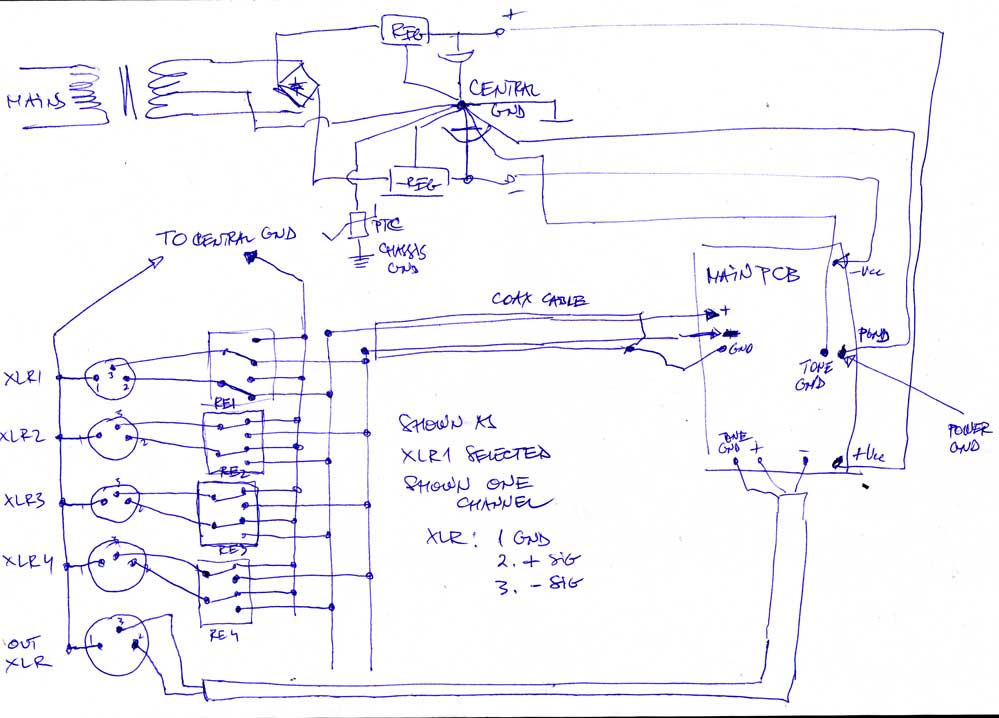

ya mean takamisawa?

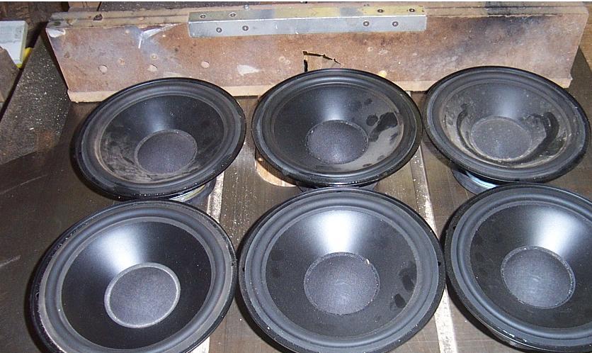

mpmarino said:
OT 🙂
Thinking about an open Baffle -
Alpha 8 or Beta 8 for widerange driver?
or?........
me thinks Alpha .......... but you can check curves by your self ........

I'm thinkin even cheaper -
I have ~20 of these peerless. I know nothing about them (I know they are 4r and 8" across 🙂 ).... and probably ~88db.
6 per side series parallel for 2.6666666667 ohms 😀.
Toss in an 8" wideband and an APT80(?) or something. Just wondered if alpha or beta 8 has been heard by you guys - the graphs don't always tell the whole story:whazzat:
