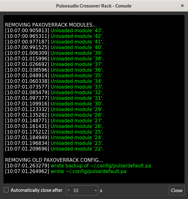

When Pulseaudio has problems..
1. System is sitting for a while, a channel disappears (no output). I click to remove modules, the new default sink is blank. I try again, it appears. I reload, this doesn't fix the problem. I close the crossover and open again, now it works.
I am OK with some problems. What is the fastest/best way to recover from this?

Hey AllenB, sorry for the delay. Forgot to answer...
Please tell me the used pulseaudio version and os.
Also can you please post the output of "pacmd list sinks" at the time the problem ocurrs. And after system startup... And the contents of the file .config/pulse/default.pa when crossover is inserted. Please attach as text files or use a pastebin!
It's OK, I have good tunes 🙂
Buster
PA 12.2
Paxor 1.46
Sinks before load xo.
Sinks and default.pa after load xo.
Sinks when choose 'remove filter modules' and there is no available default master sink.

ok, Somehow pulseaudio winds up in a state where it doesn't work anymore. can you please post the "console window" output when removing the modules in paxoverrack...
PS: Please check if after removing modules the crossover statements are removed from your ~/.config/pulse/default.pa
./default.pa, paxor does add and remove the statements the way I would expect it to.
I opened the console, chose remove filter modules, sink was blank so I cancelled, there was no console output until I repeated and chose a sink. I should have tried clicking yes when it was blank, (vague memory I think it won't accept, but I should try again later after it has time to do it again).
From the console log it looks like PaXoverRack removed the modules correctly.
The sink lusts you posted indicate otherwise. Can you please check once again?
