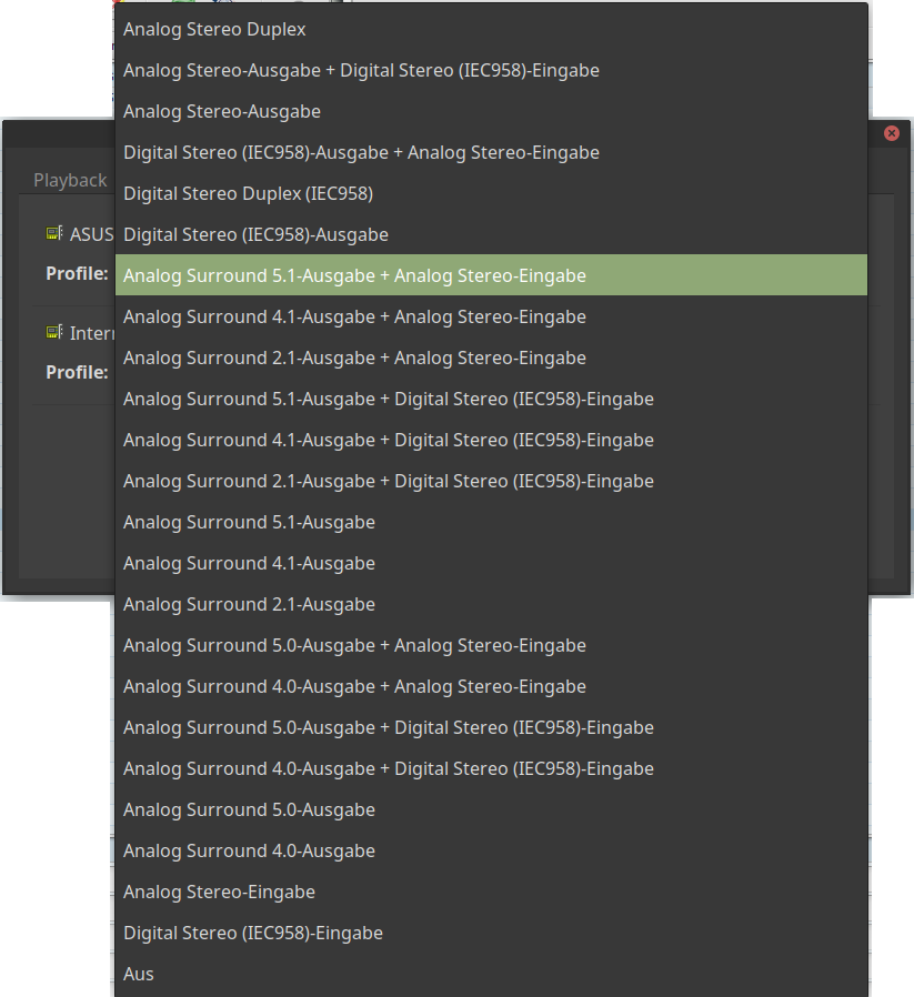

I use mate-colume-control to switch card profiles, but for this screenshot I used pavucontrol as it is available more widely:
attachment.php
How do these profiles correlate with the alsa subdevices? Maybe DarpMalone just needs to switch to a different profile with pavucontrol? Just a guess...
It's not clear at all to me how the different devices announced by alsa match to the different configurations (profiles?) that pulseaudio will show.
I think Profiles describes it
so there is a udev rule will maps a device to a particular config file (e.g. /usr/share/pulseaudio/alsa-mixer/profile-sets/default.conf) and that config file determines who the device to turned into a pulseaudio profile
PA profile definitions are part of PA in /usr/share/pulseaudio/alsa-mixer/profile-sets/ . The /usr/share/pulseaudio/alsa-mixer/profile-sets/default.conf describes the syntax and principle, plus profiles for general soundcards.
If you list your pacmd list-cards, you will see all your devices with all the profiles offered. The current profile should be in "active profile:" line. DarpMalone's list shows only the single mono card -> device -> profile. IMO his PA somehow detects his cards incorrectly and the detection outcome fits only the single mono profile out of the long list in /usr/share/pulseaudio/alsa-mixer/profile-sets/default.conf
DarpMalone: please check that your /usr/share/pulseaudio/alsa-mixer/profile-sets/ contains the profiles. I have:
