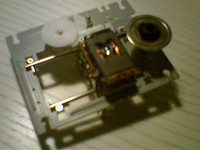

Just got back from a monthly meeting i have with some pals and somebody gave me a sanyo pickup. So i had a look on the net and found it at some spare part companies.
Was actually looking for cdp's where it was used. Could not find much, so i just looked here for a moment to c what is new.
And found this thread. The thing i got seems to be a SF91-5-6, where the 5&6 seem to be the number of pins on two connectors (?). There is one 91 with more pins, but it does not seem to have a chip on-board (jrc,8 pens ~opamp i guess).
My transport is actually not used, so now i know what dead cdp's too look for (thanks). Pic is from camera phone without much light, so a bit fuzzy.

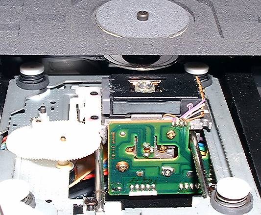

This is the picture of the transport - finally.
I got this transport + DAC for little money because it's old and was not working right. I thought it could be fixed and still be good for the also old fashioned 16bits 44.1khz CD. (Don't want to start a discussion about this, however.)
Yes its the Sanyo head - will give you the Correct Part # when I return from a business trip.
Do you have the Clock-Lock card in the ordinal (2x BNC leads to the transport)?
The servo sections very weak in the Transport, but the Dac uses 2x DAC7 - with SAA7350 & HDCD - still a good DAC.
