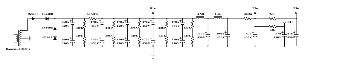

3: Sometimes I have one filter feeding two filters (say one for gain, and one for phase splitter as in the Williamson. It would be nice to model that. I've included an example.

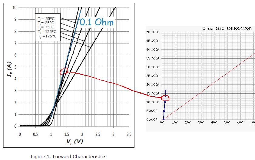

I've added the "Cree C4D05120A Silicon Carbide Schottky Diode" to the rectifier textfile from this link. Could someone tell me if the data is correct? It differs quite a lot from the other SS rectifiers in the library.
http://duncanamps.com/psud2/show_rect.php?rect=Cree%20SiC%20C4D05120A&type=SS&dres=1.85&vlaw=81&vfac=1.4&vpiv=1200&ipks=46&ipkr=26
