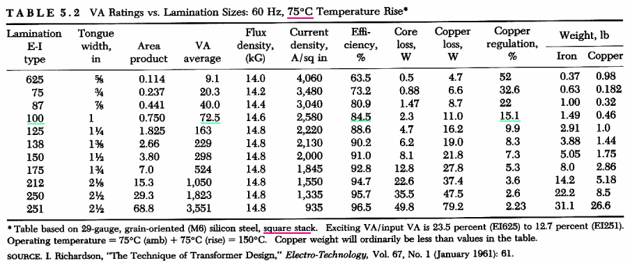

No; but I happen to have some transformer VA/regulation data handy. Attached.
Two tables.
The first has notes, and some data for 45 deg C rise working.
The second is for 75 deg C rise, which many users would call "too hot!!" It is more an indication of what a given core "could" do, with a fixed load (regulation unimportant). Most of our stuff will not be worked this hard, or rated for such rise.
Note the difference for EI-100 core in square or near-square stack at 45 and at 75 deg C rise. The cool near-square shows 89% efficiency, so regulation probably near 10%. Regulation be dammed, let it run hot, 1.6X the power and 15% regulation. Very nearly the same power source, but re-rated to run too hot to touch.
I *think* I have seen a curve VA/reg, but not finding it now, and would have to be tweaked away from extra-hot designs.
For more fun: when you face small windings at 700V(CT), the "optimum" wire size is too small for rapid winding. We sometimes see these with lower DCR than you would expect from line and heater DCR-- they upped the HV wire size to speed production.
We can't get a spot-on guess, of course. But it may help to not use 31 Ohms for a wee little lump with hundreds of Ohms inside.

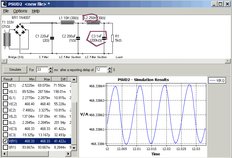

Let's try a big L and no C... well big L and small C.... ....uh, PSUD hates to do that. It ran 2pFd last cap but hit Time Step error; 100pFd popped a box "0.001u...{or more}". (So why didn't 2pFd barf pre-run?)
Fairly basic if extravagant DC filter, ending with 250H+30r and 1nFd+200K(!) loaded in 5K. By dirt-sketch, taking C2 as "huge" (lo Z), the output impedance sketches like:
Freq __250H __1nFd+200K ___Zout
_20Hz__ 31K ________ 8M ___ 31K
200Hz__310K ________ 1M ___236K << resonance near 300Hz!
_2KHz__3.1M ______ 280K ___257K
20KHz__ 31M ______ 208K ___207K
A "low Z" power source for a 5K load might be 1/10th load, <500r. Here the audio-band Zout is like 50X the load! Yet the ripple is teeny (41uV).
Comparing 5K load to 50K load and running to asymptote.... uh, I have found an oddness. But by inspection, the DC impedance is near 100 Ohms (31+30+30+waveform).
On _your_ plan, assuming I1 is zero then 50mA, and shows a 5V drop, the DC output impedance is 5V/0.050A or 100 Ohms. (But this can not be right?) The audio-band output impedance is dominated by 60uFd, which a good audio Reactance Chart will tell you is 133r @ 20Hz, 13r @ 200Hz, 1.3r @ 2KHz, and probably ESR limited and also moot above that. (2m seems unlikely?)

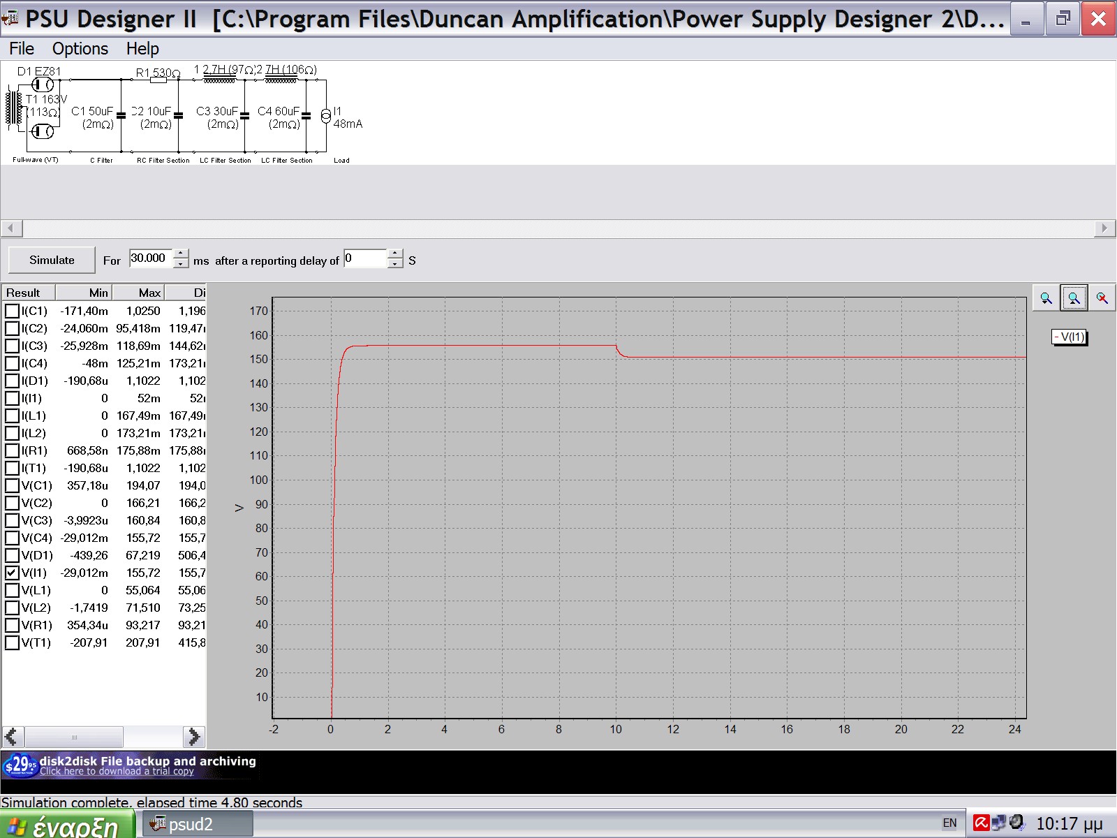

OK. I had to read this many times but I think I got it. Thanks! Now, given the chance, I would like to ask something. So far, when using PSUDII I try to achieve a voltage plot with a as sharp and clear as possible roll off thinking that this means low Z out(see pic). Actually not my thinking. There is a paper somewhere on the net about it - unless I haven't understant it correctly. I come to think that this approach is not right. I would like your opinions on this please.
What is causing the step in voltage @ 10seconds?
It is a stepped load (current tap) to see how it reacts. Novice approach... I think it's better to move it in a new thread after all. I don't feel comfortable destructing all those scientists from contributing to the development of this software. I wish I could do so! But I can only speak the voice of all us non EEs for who the PSUD is our desert island software! 🙂
