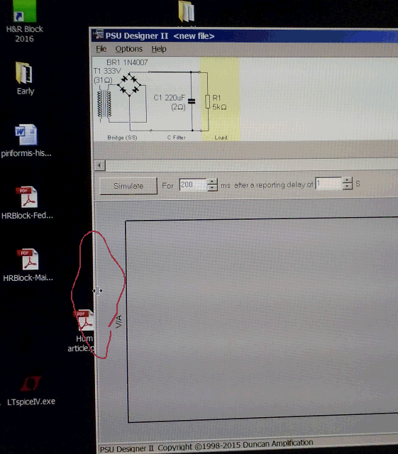

And BTW, FWIW, FIY: I just discovered a "buglet". I discovered the the results panel can be re-sized (another thing I didn't find over the years). Good! BUT when I resized it to zero (to emphasize the curves), it won't come back! And does not heal on re-start.
Attached image shows the resize cursor doing nothing. Cellfone shot because Windows screen-grab did not show cursor.
Obviously I will fix that by deleting the program and installing a new copy (or beta 6). So don't even look at it. But if you re-use this panel code in III, it is something to look into.
