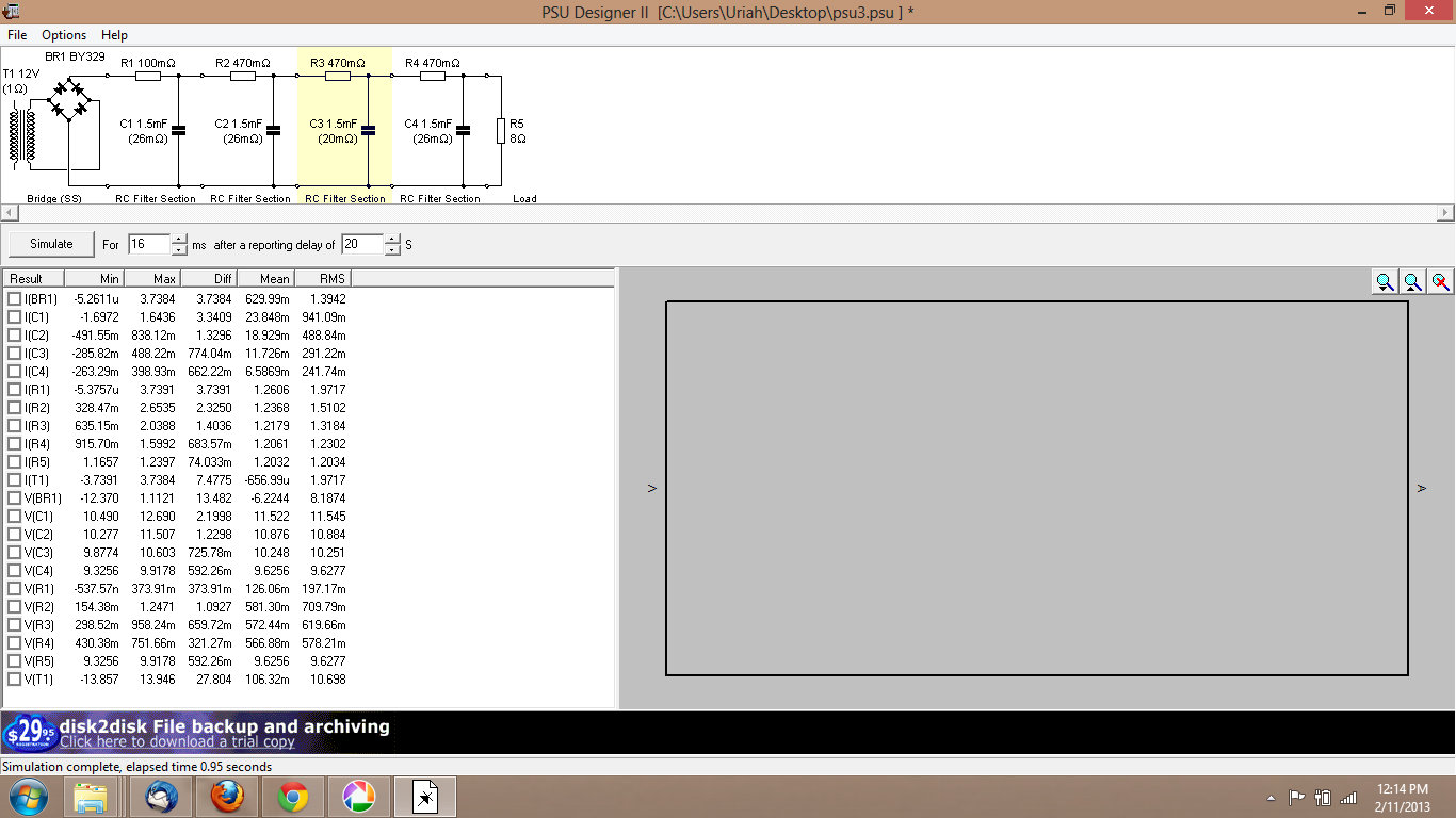

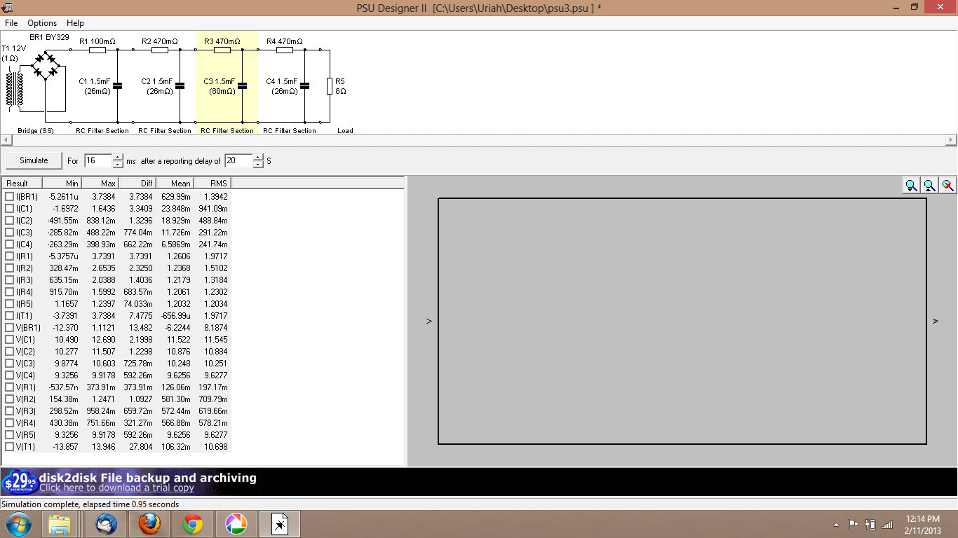

Agreed. I just wanted to show how the standard schematic simulates vs the 100r ESR. The one that looks right is the standard values.
I know PSUD is giving false values but at what point do the values stop simulating reality and start being totally false? If I sim with low ESR cap at .026R and then use the same cap with 1R or even .05R the numbers look like less noise.
So it seems like its not just with large ESR that it gives false results. Ill show you. Here is a schematic with .02 ESR, .08ESR and 100ESR caps. Each of first twoare rather normal and last is extreme but common to all is higher ESR = lower noise.
Each has better noise than the previous. Does PSUD work at all considering this?
Could it be the resistance of the capacitors you have in the sim? I usually just plug in 1 Ohm there....
