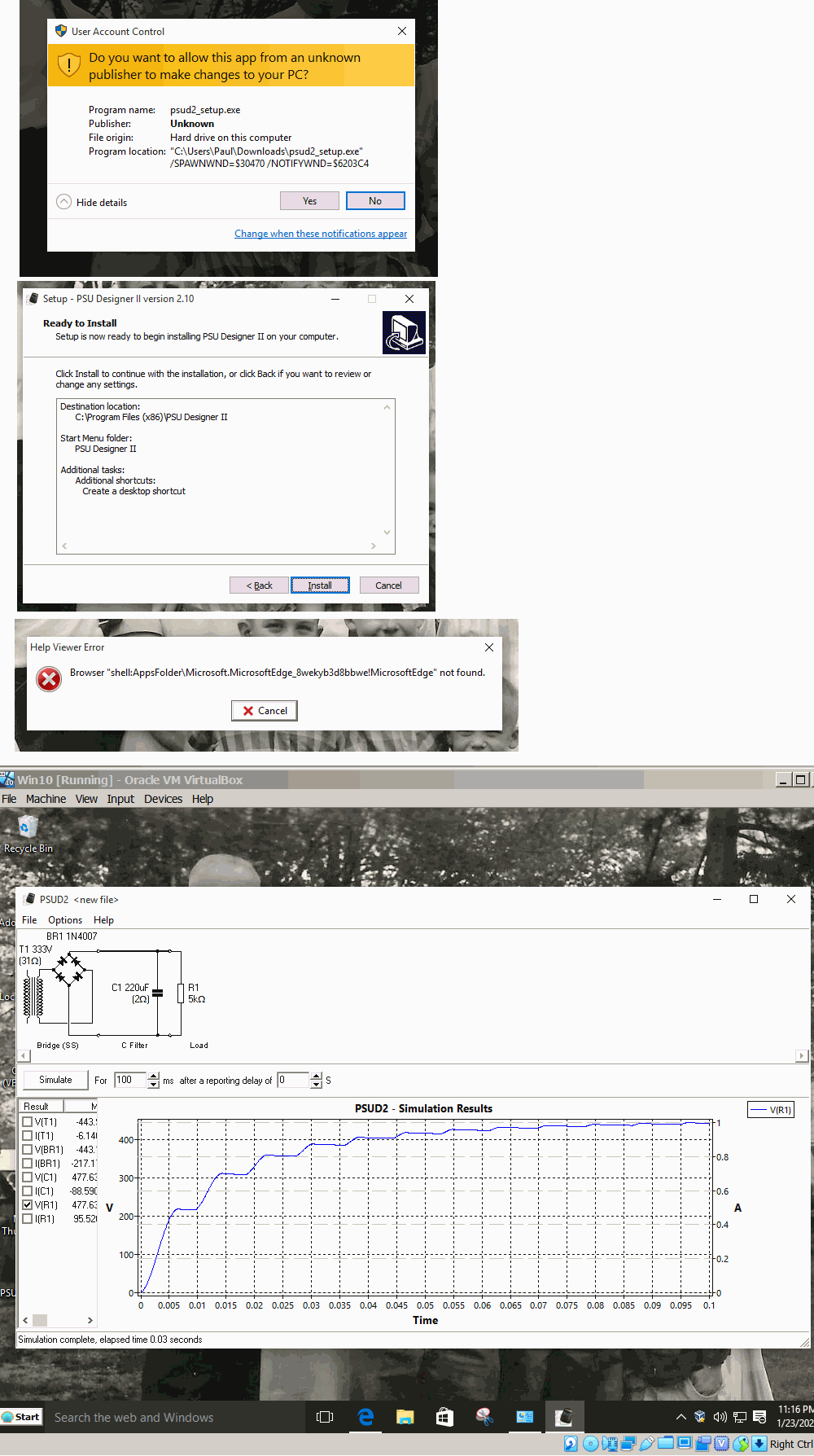

I poked a little and could not figure where PSUD was writing a file *on opening* (as you imply). I would think it might have an options file but I did not see anything. We may need Duncan's advice.
But I done enough PC support to know the O/S and the privileges would be the first step, so me asking saves him a step.
You still have not said WHICH Windows. Win7 does things one way. I hear Win10 does many things different.
Thanks again PRR.
Running Windows 10 with latest updates.
Don't like to run apps that require admin privileges as that may open up a can of worms.

Gotcha. But Windows can be such a fuss-pot. The question may be: do you need Admin just to *install* or every time you *run*? It is reasonable to require adult supervision to install software. Once admin-installed it should run for ordinary users.
I don't have Win10 here so I'm just stirring the pot until a Win10-guru comes by.

Lots of programs require "admin" access on every launch. CPU-Z is a good example. Windows makes it possible to ruin your system by clicking on a bad URL, so I wouldn't worry about running things with elevated privileges. If you really care run Linux instead of Windows, and use PSUD under Wine.
CPU-Z puts its fingers into the PC's most intimate parts. It does not directly find places to breech, but the info it returns could help a hacker, and is NOT generally needed by "users" (typists, accountants, surfers...).
PSUD is a "calculator", and should not be poking the system's secrets. Win10 changed some of those secrets which means some old code run afoul of Win10's security(?). Win10 redirects the most common things (INI files in executable directory) but PSUD is probably unknown in Redmond.

Installed PSUD2 off the Duncanamp webiste.
Unfortunately, when I try to run the program, a psud2 error window pops up indicating "Invalid filename". There's an option to ignore the error and selecting that results in another psud2 error window saying "Access violation". Anyone else having this problem and know how to get around it?
Does anyone know where to find a copy of the previous version so I can use that while trying to fix the problem with the recent release?

I can send you a previous version but I know for an absolute fact it will make your problems worse, not better. Windows 10 has been tightening up security left right and centre around what applications can and cannot do with minor, and some not so minor changes. Windows 10 sends out updates every Tuesday and I'm behind on following their changes.
To be fair to Microsoft, they have been preaching for years (or even decades) about how to write apps to fit the Windows model. PSUD2 dates back to the late 90s so has been around in pretty much the same guise for over 20 years - it doesn't fit the MS way of doing things.
PSUD3 brings us into the 21st Century, however it's nowhere near even an Alpha test at this point in time, so that's no help to anybody...
I'm putting through a number of changes for PSUD2 to work on the Apple Mac this weekend, at the same time I'll audit all the things that are screwing up Windows 10 so hopefully will have a more "W10 friendly" version by tomorrow night.
You shouldn't need admin rights to install or run the software, unless you are using a company machine that has Windows policies set to prevent installs by non-admins (nothing I can do about this, sorry!)

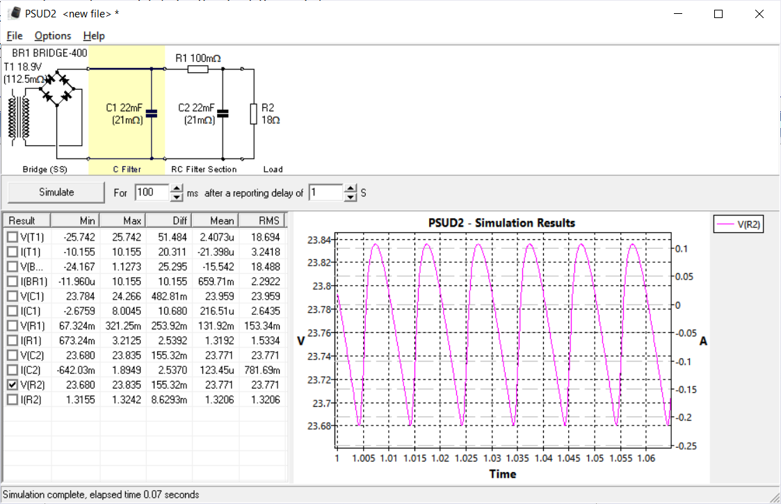

I just stumble across this great tread and downloaded the software.
I am trying to learn how to interoperate the results. I have no issue with the graphs but I haven't got my head around all the columns in the table.
I understand the Min, Max and Diff columns, but I'm not sure what the Mean and RMS columns relate to. (I know what RMS means).
In my attached example is I(C1) = 3.3229 the RMS ripple current at that point?
In the table where do I see ripple voltage?
Sorry for the rookie questions.

The numbers are basically to help you work out ripple and average voltage, however it's essential that the power supply is in a steady state for them to be meaningful.
Your simulation starts from 0 seconds and it looks like you have soft start enabled, I would recommend a sim of 100mS after a reporting delay of 1 second to get your ripple and average figures (soft start turned off).
Once you do this, the V(R2) box, the one you are really interested in shows:
Just to expand on Mean and RMS, Mean is simply the average voltage over a period of time. For those reading who are not sure what the RMS means, it is the effective voltage that would provide the same amount of heat in a load. If the ripple is low, the two numbers should be pretty close and the difference will only be of use in some rare cases, like a mains power supply for the an absorbtion fridge in a camper where the output might be a bit rough.
So... to summarise on the columns:
- Min 23.680
- Max 23.835
- Diff 155.32m
- Mean 23.771
- RMS 23.771

Hopefully one last question.
Can I conclude from the example above, in regards to C1 that the ripple voltage is 482.81mV and the ripple current is 10.68Amps?
Thanks.
Thanks.
Ripple voltage across C1 is 482mVp-p.Can I conclude from the example above, in regards to C1 that the ripple voltage is 482.81mV and the ripple current is 10.68Amps?
Ripple current in C1 is 2.64Arms.
Note that the voltage on C1 has both AC and DC components - as indicated by a voltage across C1 of 24V.
Note also the current through C1 is AC only for that steady state period (after 1 sec delay to provide steady state conditions) - whereas if you had a period starting at 0 sec, then the capacitor current would include a DC component due to the charge up phase of operation.
