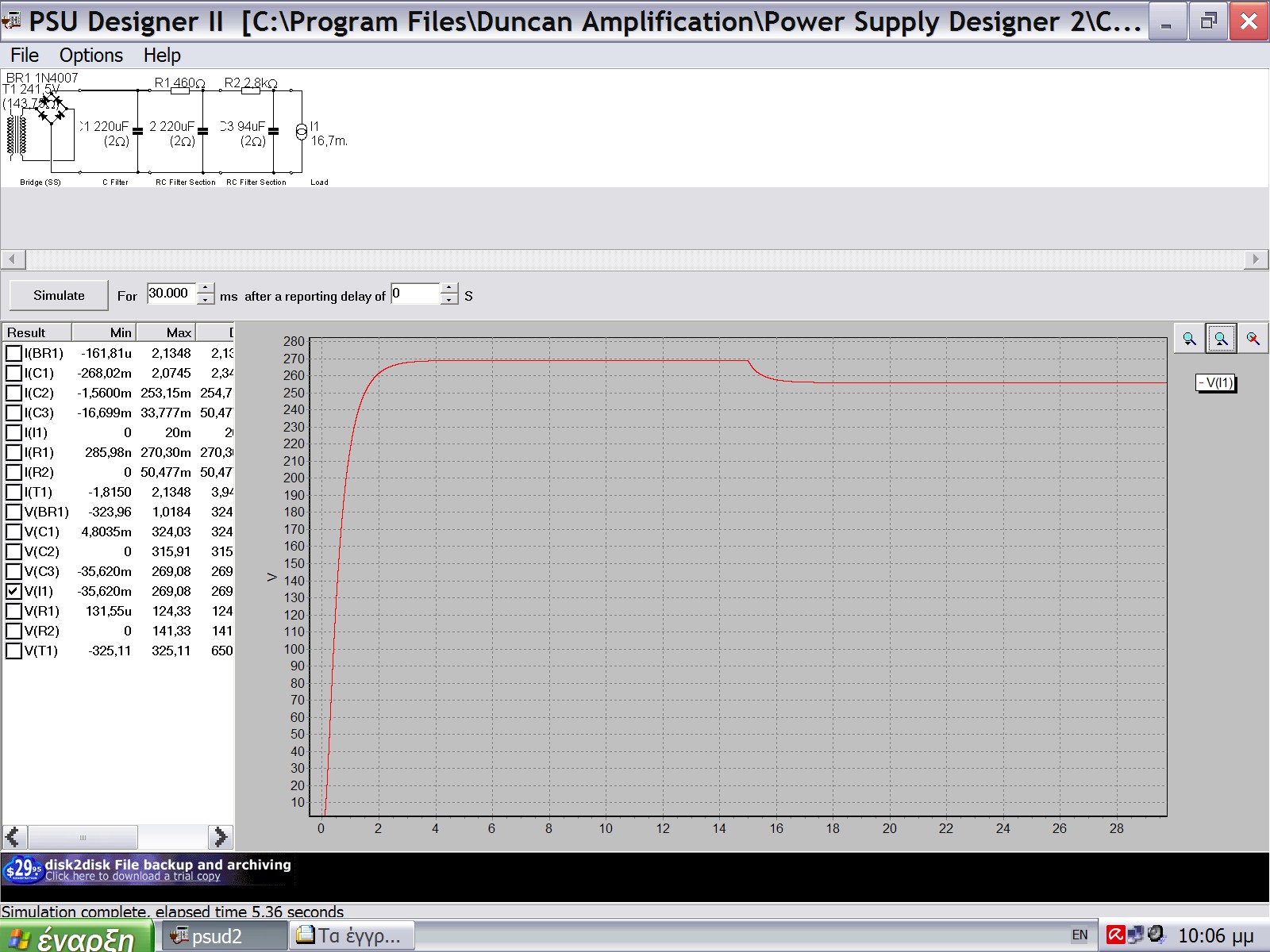

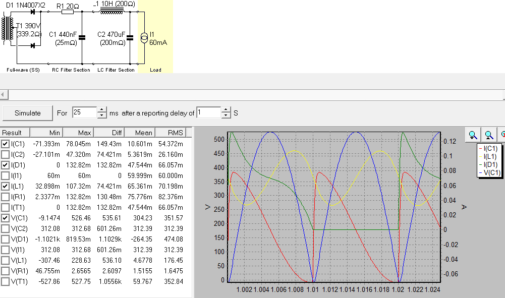

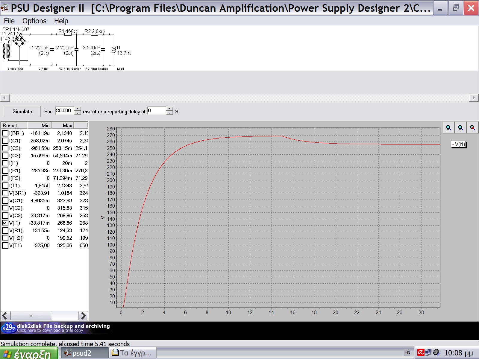

I' m following this interesting discusion and allthough I feel rather
uncomfortable to pop in among qualified people, I would appreciate
if you could take the time to answer my novice query.
I can only rely to PSUD for designing power supplies and I was
aiming for fast rising time because I thought this would be a low
impedance psu. Of course, ripple has to be low too so I would get
something like the first pic with a 94μF final capacitor. Inevitably,
the voltage will sag on suddent current demant. I simulated the same
psu with a 500μF final capacitor - second pic - and the same sag
will occur but with a slower rate and it will be followed by a slower
recovery time. I think both situations will be audible in a different way.
Could one of them fool our brains more effectively?
Also, I read in voltage regulators datasheet that bigger output capacitors
improve transient response. But regulated voltage supposedly doesn't shag,
or does it? Could be something else beside voltage stability?
actually, you want "springy" instead of "stiff"
like a 20 uf then a 8H in series and 20uf with something like a 5v4 or 5u4 rectifier.
of course there is other combinations. I imagine Dr Lowmu has some better examples of this beside the one that poured out of my head. I would do a search on this site for his post on the subject.
the voltage will sag on sudden current demand. I simulated the same

To test a supply in PSUD, allow it to start up and stabilize, then do a 15% ( arbitrary ) current step, and see how the supply responds. How the supply starts up, from turn on, has little to do with the " sonics" process, assuming one uses proper rated parts and a good design.
I would like to propose to you, that the supply for a 2A3 Loftin White amp, should not have any Ls higher than 20 Ohms DCR , nor employ any Cs larger than 50 uF in any one spot !! Large caps, 93 uF, or 500 uF, in the B+ ruins the dynamic capability of the amp, because the large cap ROBS the tube of instantaneous energy, on peaks, and it truncates dynamic contrasting, as heard by our EARS and brain. Also, low ripple is NOT too important to the low gain Finals 2A3 stage, anything 800 mVAC or less will be fine. Low ripple is very important to the high mu Driver stage however. !! I shunt regulate my Driver stage with just a single part. Uber stable.
