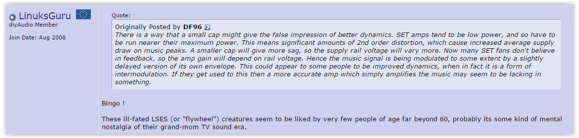

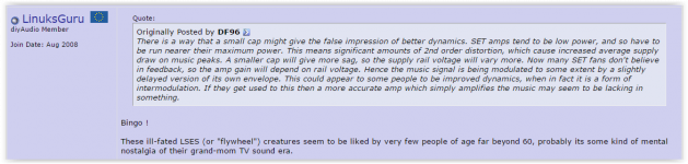

There is a way that a small cap might give the false impression of better dynamics. SET amps tend to be low power, and so have to be run nearer their maximum power. This means significant amounts of 2nd order distortion, which cause increased average supply draw on music peaks. A smaller cap will give more sag, so the supply rail voltage will vary more. Now many SET fans don't believe in feedback, so the amp gain will depend on rail voltage. Hence the music signal is being modulated to some extent by a slightly delayed version of its own envelope. This could appear to some people to be improved dynamics, when in fact it is a form of intermodulation. If they get used to this then a more accurate amp which simply amplifies the music may seem to be lacking in something.
Bingo !
These ill-fated LSES (or "flywheel") creatures seem to be liked by very few people of age far beyond 60, probably its some kind of mental nostalgia of their grand-mom TV sound era.
One can search AudioAsylum for enormous amount of this junk science presented as "brilliant engineering gem", promoted by someone without even basic knowledge of electronics.
