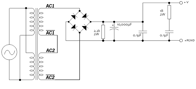

I have made my first PSU like in a diagram. I have cheap tpa3118 d-class amp and tangband w3-871SC connected to it.
Has someone a clue why i have constant noise coming from the speaker even though i have no signal connected to my amp.
The noise is so loud that i can hear it from two meters away from the speaker.
I am suspecting my psu, should i try to filter this noise somehow.

Open inputs? Connect to source or connect inputs to gnd. Inputwires and all wires basicly to and from ampboard should be tightly twisted, I don't mean you should twist psu wires with inputsignal wires and speaker wires, each separately.
If ampboard is set at very high gain, own noise could be audible too. Especially when speakers do not have Zobel, but like Tangband have 50-100 ohm impedance at filterfrequency, causing treble frequencies (audible from ~4kHz) to be boosted.

I haven't done any groundings, so i think I should work with that. My connections are exactly like in diagram.

The TPA3118 Chip has about 65 dB power supply rejection ratio. The Tang Band driver is 8 ohms and 87 dB per watt. A 10,000 uF capacitor loaded by a 35 mA draw will have about .035/(.01 x 120) or .029 volts of ripple. That would be .0001 watt or -40 dB. So the hum should be = 87 -40 -65 or -18 dB at 1 M. This and the harmonics should be just audible at a distance to the loudspeaker of .25 M.

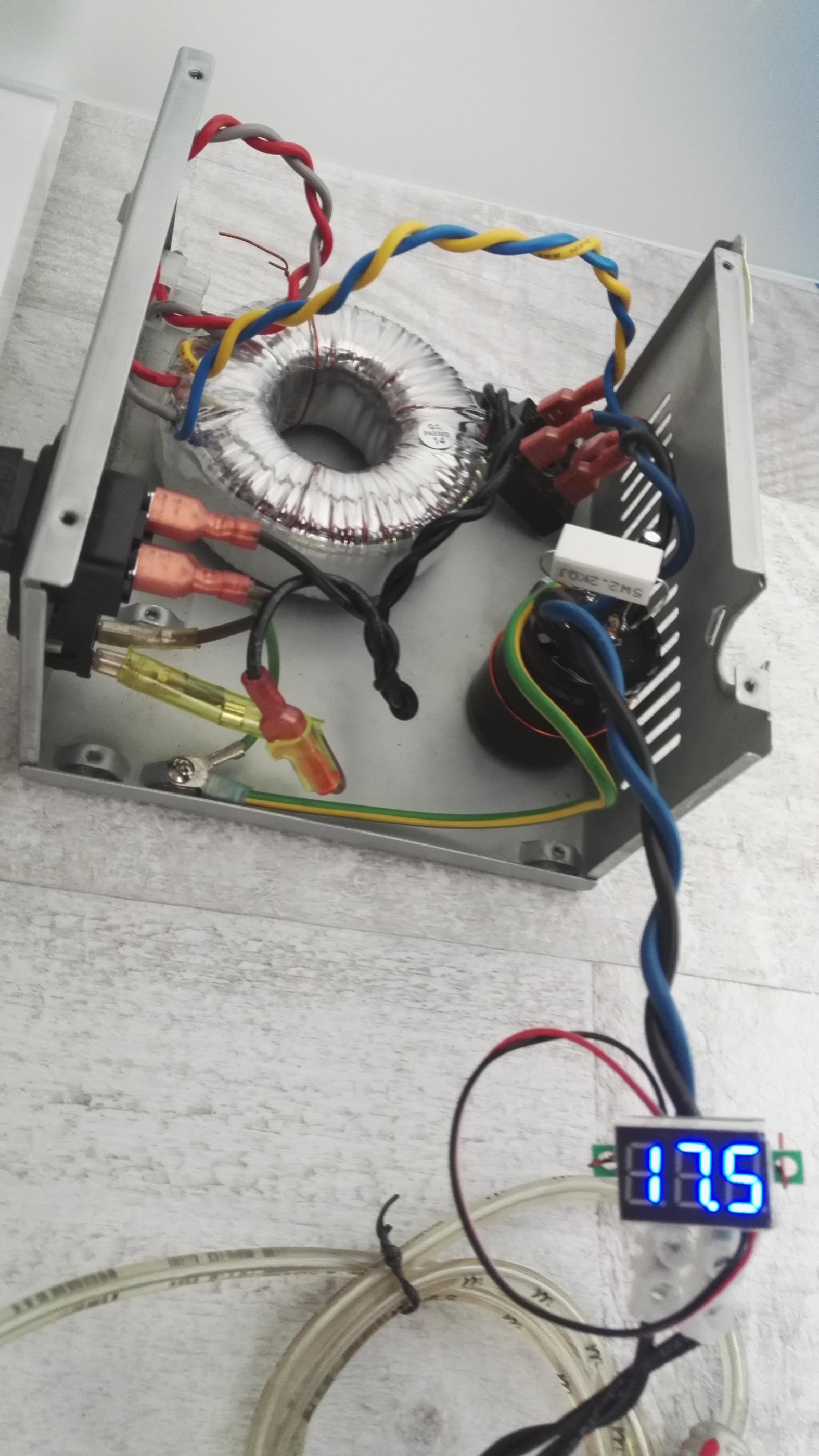

Gain of that ampboard is either 32dB or 36dB and set with r27/r28. I don't know how high the output from your dac is, but I think normally around 2Vrms ??? If normal I would remove r27, then gain becomes 20dB, for me that is high enough with my dac and cdplayers.
You have 2 signals, left and right, and that amp module is mono, but you didn't mention how many modules you have and how you connected them. There can be a ground loop. Also you didn't mention PSU of the digital to analog converter (it is as important as the PSU of the amplifier).
You still didn't show any detail about the GND connections, and if you tried to short amp inputs directly or not, and with what result.
The problem is definitely in connections of the system, but it is not shown yet at all.
If you use an RCA cable, then you have GND (outer ring). RCA cable is shielded (unless it's a cheap junk), so you have a grounding/shielding system already, but we don't know what is it like.
As suggested, you need to show a picture or two of how you implemented the circuit.
That 10,000uF is going to demand quite large charging pulses so you need to take the output directly from its terminals, a common error is to wire from the rectifier instead. Also when you are pulling fairly large load currents from the bridge rectifier, the rectifier will produce very short duration spikes which will go through anything, including any regulators you may have. Answer is to fit something like a 220nF capacitor across the transformer wires connected at the bridge rectifier. These spikes can be quite large so think 400V minimum working for the capacitor.

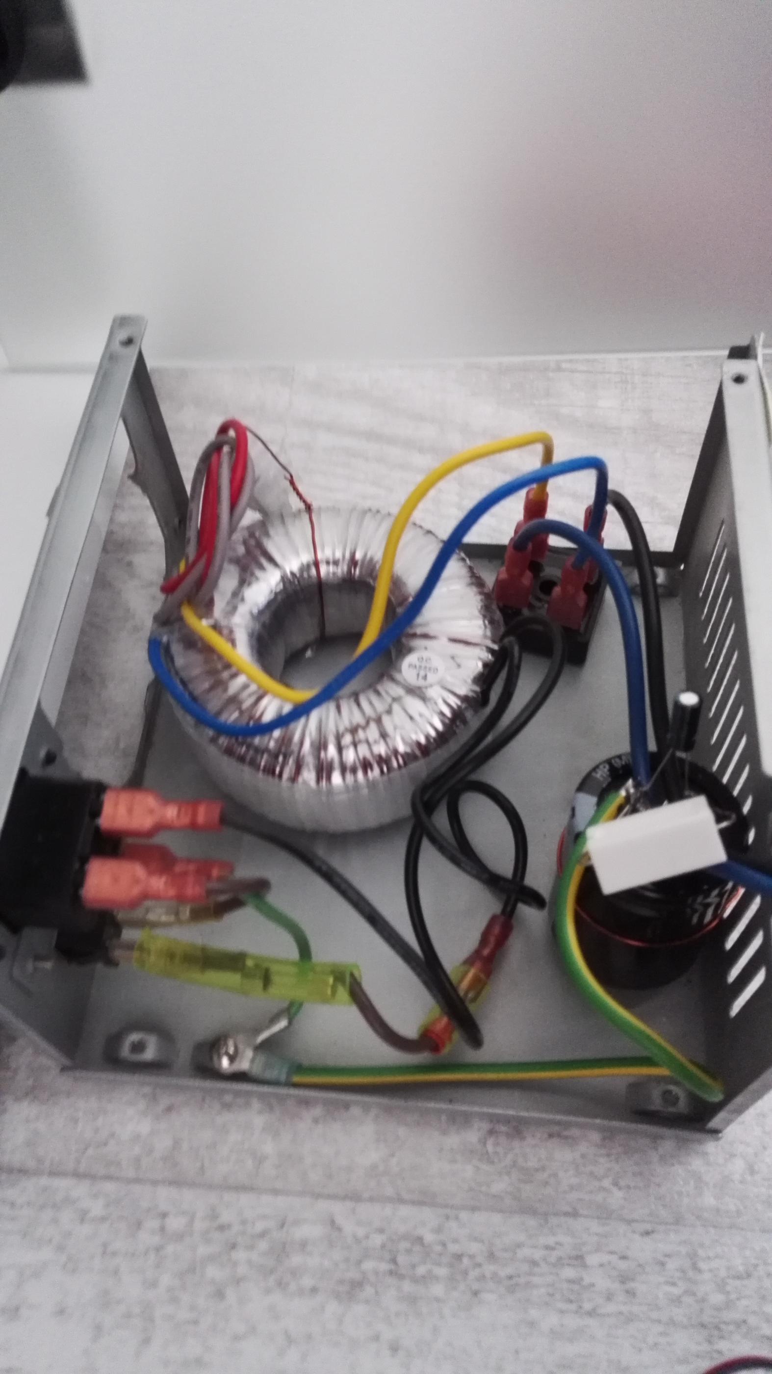

Thank you for your aswers, here are the pics that you have been asking. This is just a test connection so I haven't got any enclosure yet.
