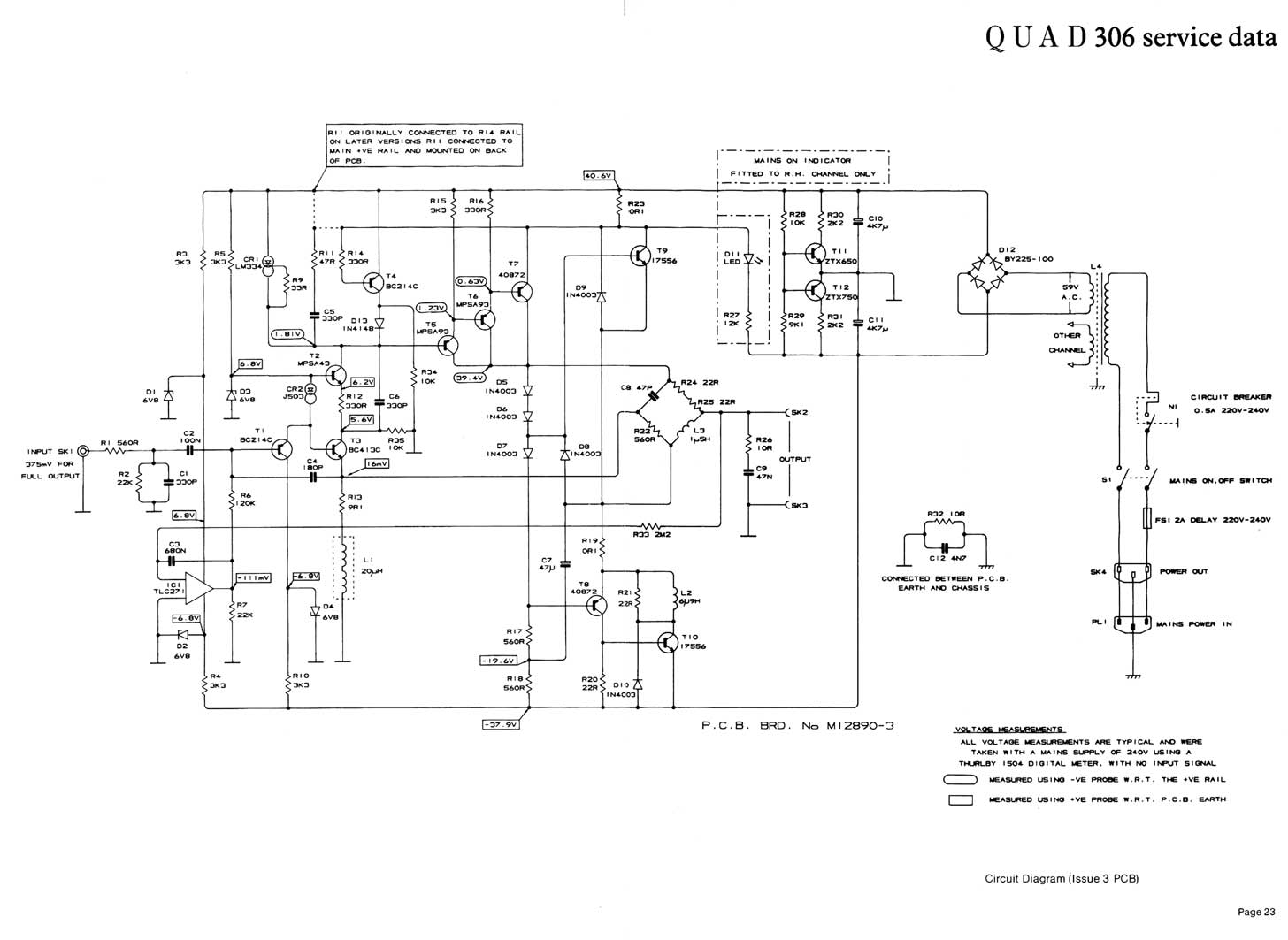

I found this setup with 7812 / 7912 , anyone used this ?
Thank you,
- Bruno.
EDIT:
I miss read the ic, seems to be " R-78CKxx-05 " can a 7912 be used there ?.
Definitely not.
What you want is a small DC/DC converter that gives +12, -12 from a 9 to 15 volt input.
Like these. The search function shows 1000's of different types so you will have to find one. I've tried and given up 🙂 These work well and are easy to use.

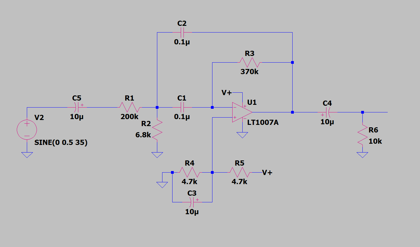

@Mooly Simplest solution without waiting for shipment , would be making the op amp work on single supply like this:
any drawback ? besides it will run on lower voltages +-6v , and needs blocking caps on both input and output.

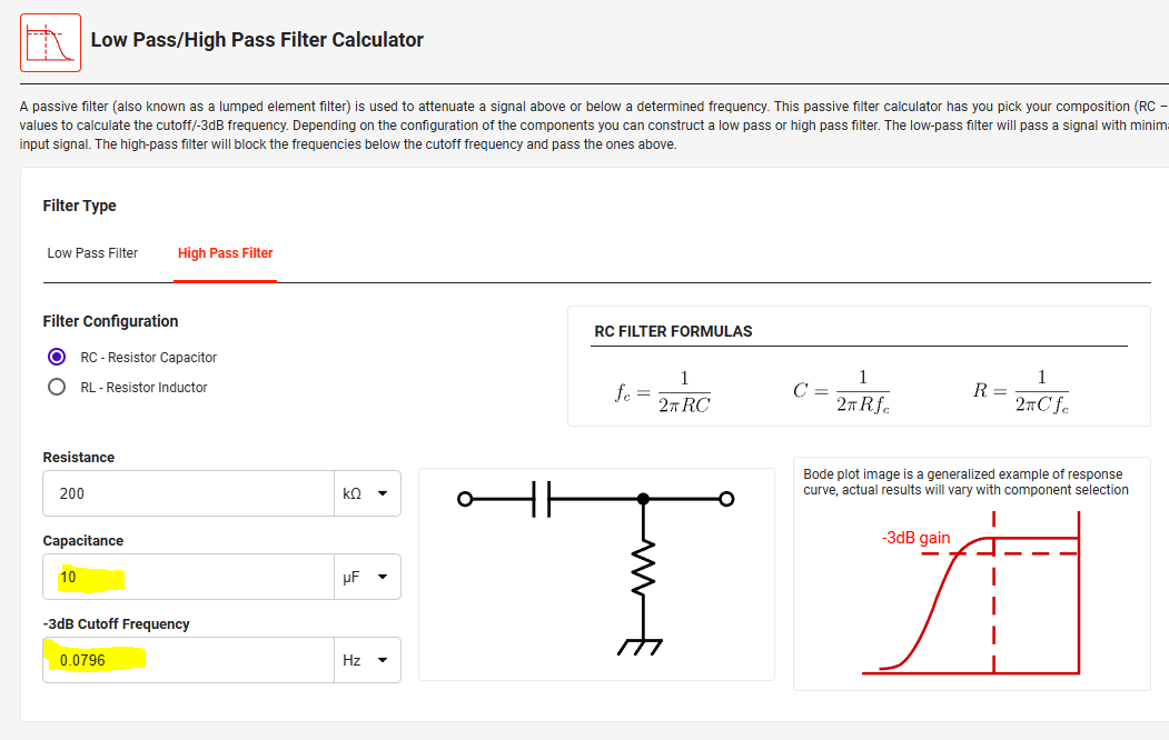

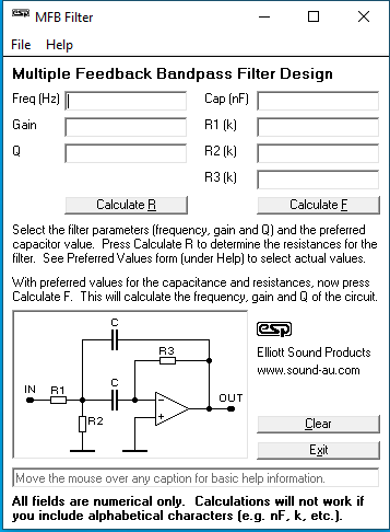

C5 looks big in relation to working into 200k (0.08Hz -3db
Using this calculator. for the filters, haven't picked values yet.
Even 0.1uF works. maybe 1uF for all input caps caps . or use smaller value for higher frequencies.
There will be 10bands.

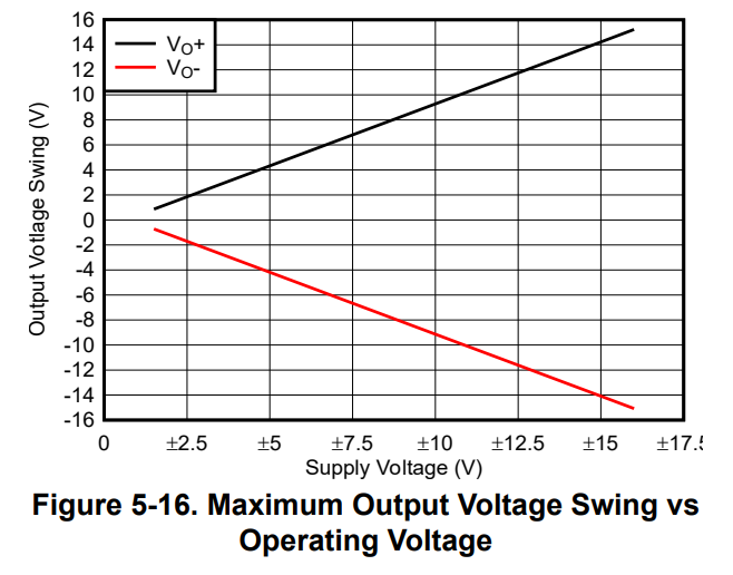

- So , using a single rail supply is fine. will +-6V be enough to output 2.5V ? ( 2.5v for max amplitude , last LED. to LM3914 ). I can't find output voltage swing vs supply voltage for NE5532, 4558 seems to output +-4V at +-5V supply , seems a bit optimistic tho.
+-6V , even 2v per rail loss, it's +-4V so around 2.8Vrms ?

12 volts (doesn't matter if it is 12v single rail or -/+6v split rail) for the opamp will get you your 2.8 volts rms you mention. If you try going a bit lower on rail voltage then the choice of opamp becomes more critical.
The 5532 is fine but is also quite a high current consumer which you don't want if using a DC/DC converter.

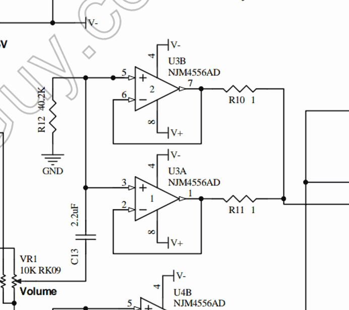

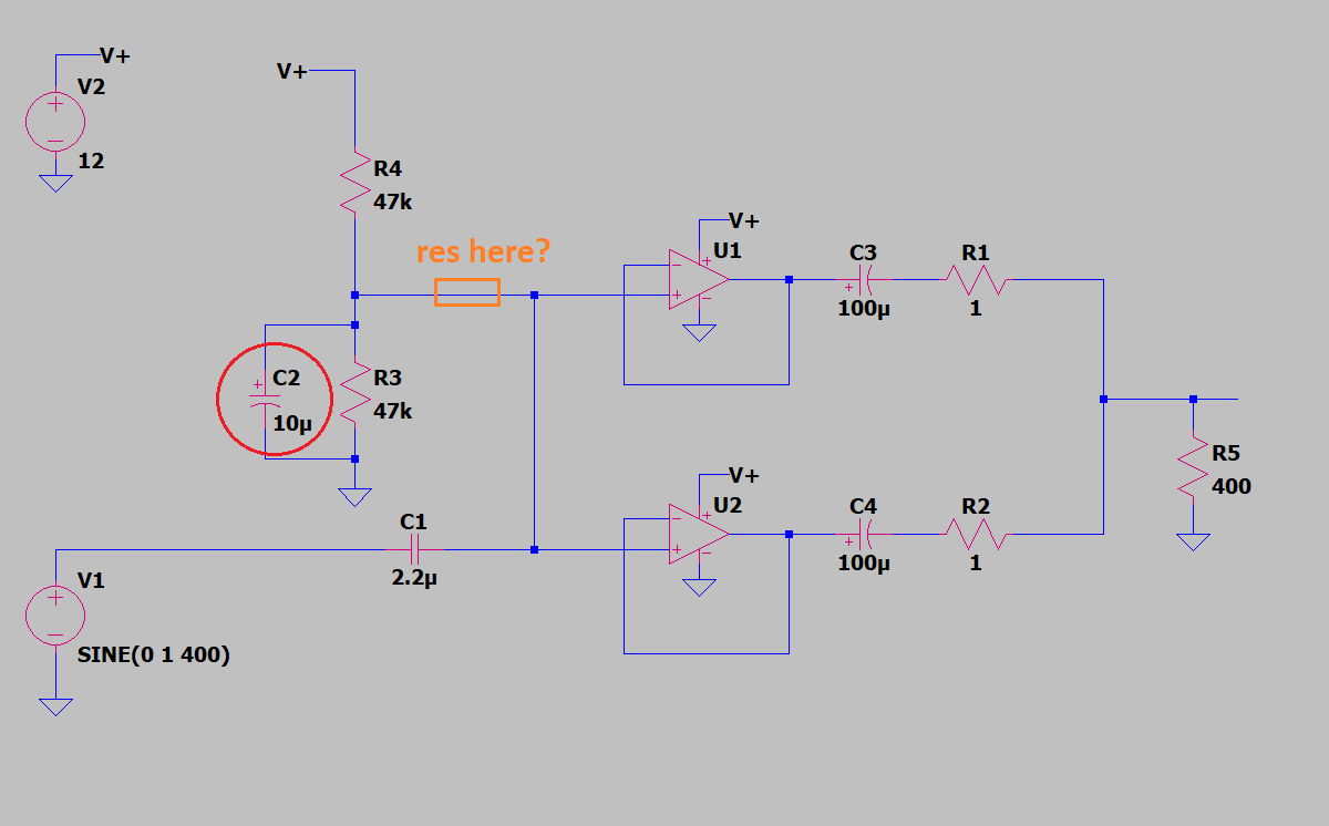

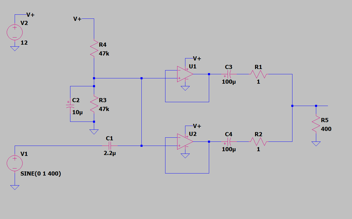

Looks like you are using one half of the opamp. Why not run in parallel to get more current.
I never did run op amps in parallel. but I've seen the approach on the forum.
I need a buffer ( with gain ) that runs the 10 MFB band pass filters, I'm assuming one simple op amp might struggle.
Or use a buffer unity gain , and make the filters with gain ? like 5 or 10 instead of 1 ?.
That circuit should be fine from one opamp. The simulation will show the sort of opamp output currents involved... they should be quite low.
400 ohm as a load is high enough to drive from a parallel opamp setup with the right opamp. That would simplify the circuit to essential a few components. This would translate to a single rail design easily enough. Shown as unity gain but can be made to have gain in the usual way.

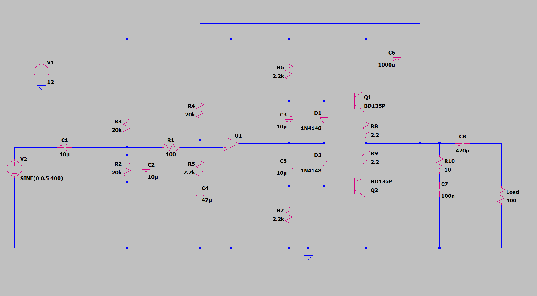

I'm not sure if I need two voltage dividers, on per amp , or one like this will do :
and the output caps before or after R10 / R11.
