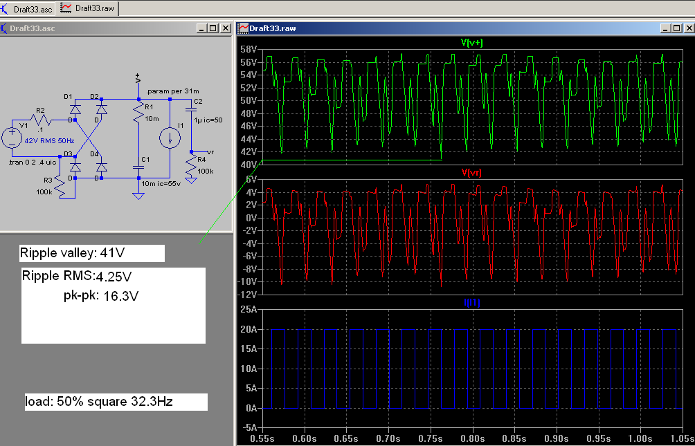

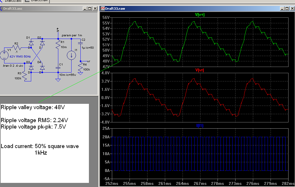

Too bad, but reality doesn't agree with you. You have totally missed the point and are instead posting loads of irrelevant formulas.
Waveforms attached. Clearly load current frequency does make a difference. Average current is 10A in both cases, but ripple voltage is double at low frequency.

It was a simulation of a power supply, not an amplifier. You said that the frequency of the current drawn from a power supply doesn't matter for ripple voltage. I showed that it does. Even more interesting is that the ripple voltage is somewhat lower when 20A DC is drawn than when the 10A average current (20A when on) square wave is. Although the square wave only draws half the power of the DC load, ripple voltage is higher!

Ripple voltage is the magnitude of fluctuation in DC output voltage at a specific output current, the difference between the minimum and peak supply voltage. Ripple voltage increases with capacitor discharge, which occurs as the voltage drops below the peak value; a longer filter time constant gives better smoothing, a complete discharge means no smoothing.
The value of the ripple voltage is dependent on load current, power supply frequency (period of the ripple signal) and capacitor value:
Ripple voltage = load current x diode off time / filter capacitor.
The ripple frequency output of a full-wave rectifier is twice as high as the input AC signal frequency.
A larger capacitor shortens rectifier conduction period.

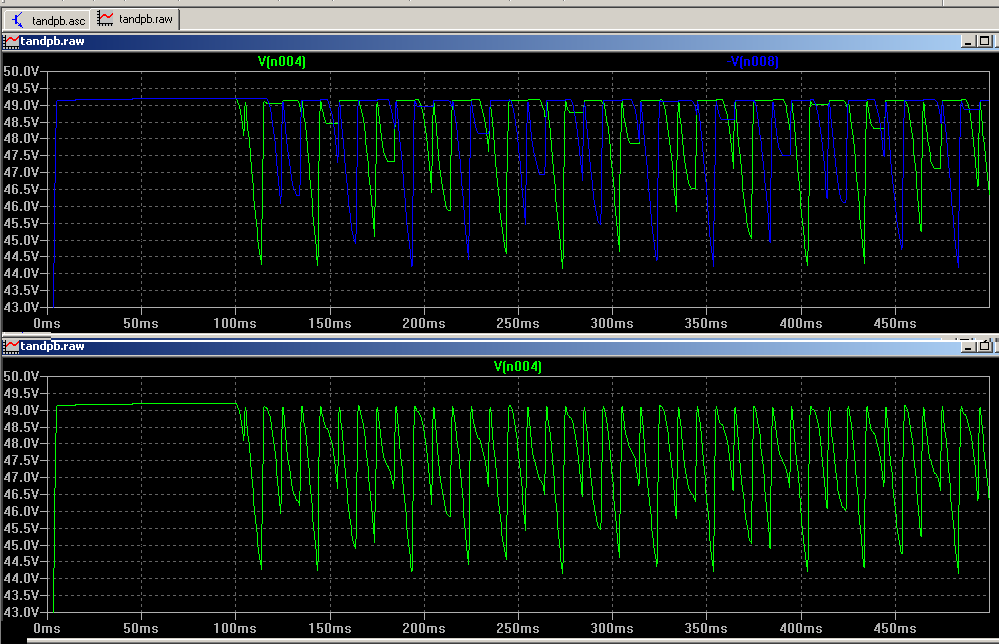

Attached picture shows:
10A pk (~7A RMS) sine load at 31Hz
15mF smoothing per rail in non-bridged, single 15mF in bridged
50V pk (~35V RMS) transformer
Upper plot is rails of non-bridged amplifier. Lower is rail-to-rail of the bridged amplifier.
Ripple valley voltage is the same.

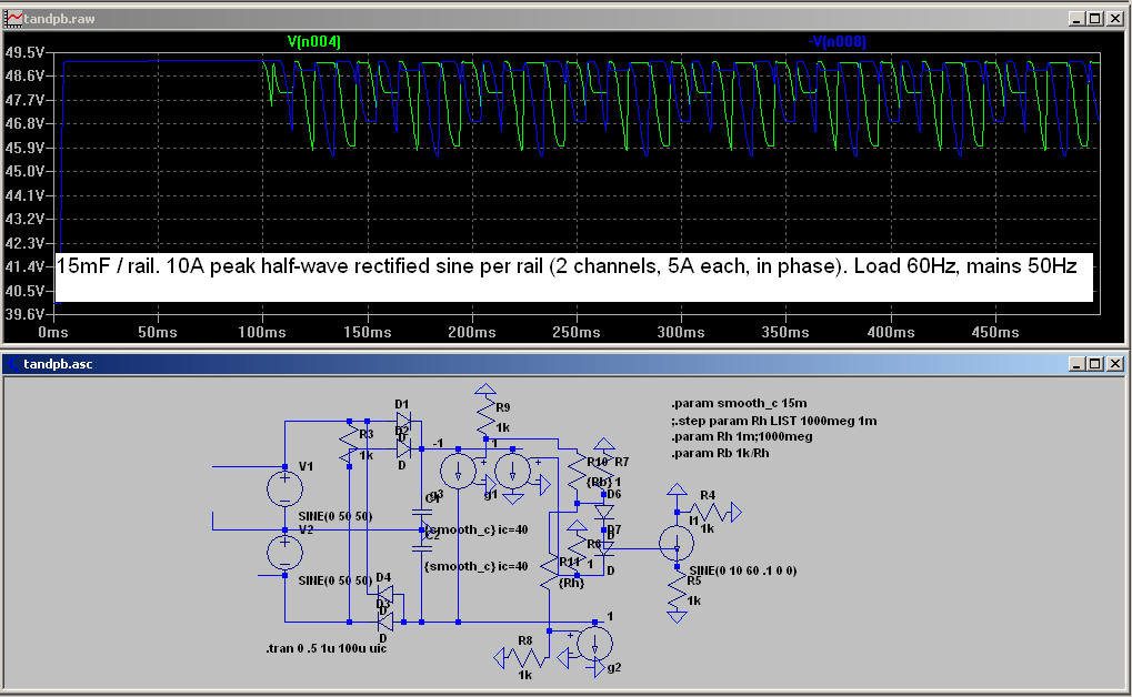

..absolutely nothing without the schematic it is based upon. If a schematic was attached, the picture shows double as many valleys, where the bridged amplifier would clip, while the non-bridged wouldn't. And it shows only half of the bridged amplifier's ripple voltage, because the ripple of both rails adds up in it.

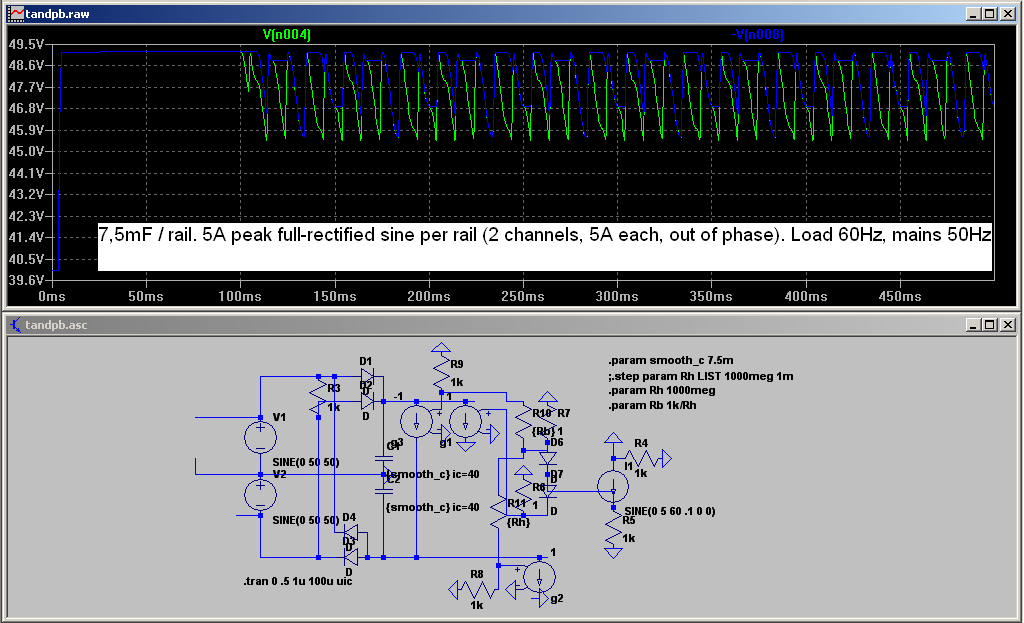

Try this:
Modify your gainclone simulation so that you have two channels working from the ~+-30V supply.
What happens if you run them with the same signal in phase? What happens when one channel is run with the same but inverted signal? The ripple is lower at low load frequencies when one is inverted.
Inverted signal on one channel and halved smoothing?
If you run that simulation for yourself, you will find out that the smoothing capacitance for the inverted pair can only be reduced by ~30% for audio frequencies below 2 x fmains, but not at all for audio frequencies above 2 x fmains.
Now compare the inverted pair to a bridged amplifier and see, what it takes to make them draw the same power from the rails. Put that into relation to a single non-bridged amplifier that delivers the same power as the bridged amplifier in that example.
Where do those insights lead you? That you need 4 times the capacitance for audio above 2 x fmains, but only 2,8 times for pure subwoofer applications? And then you make the bench test and the bridged amplifier still clips earlier, because you achieved the same ripple voltage, but not the same ripple factor.
I find that it can be halved, se attached images. Half the capacitance, same ripple valley voltage, same clipping point. Why do you think you need ripple to halve towards high load frequencies? The frequency of the ripple itself is the same so PSRR isn't lower. And further, the ripple voltage still lowers toward higher frequencies, just not as much.
You haved posted several pictures that all show the same. You see that the valleys reach the same level, I see that the rms value is different. You can keep on posting those pictures as often as you like, and my opinion will not change. I showed you in post #47 that the bridged amplifier clips earlier, in spite of the same ripple voltage per rail.
The bridged amplifier draws current from both rails at the same time, therefore the ripple voltages add up. The non-bridged ampplifier only draws from one rail at a time, therefore the ripple voltage of that rail only is effective.
