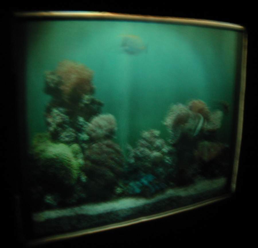

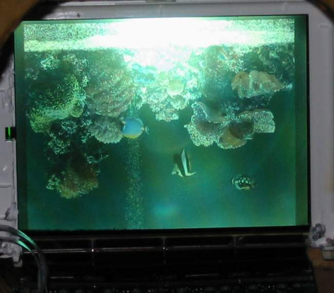

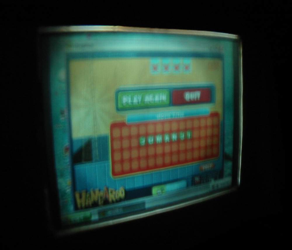

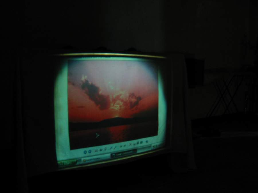

2.5 meter diagonal with psone projector?
rmpmla how in the heck are you getting a watchable 2.5 meter diagonal image with a 320 x240 native psone screen? Everyone that has build a projector using this lcd screen has stated that the image is pixely and lousy any larger than 5 feet diagonal.
Are these results through your vga mod of your computer?
Would you say this is the big diference?

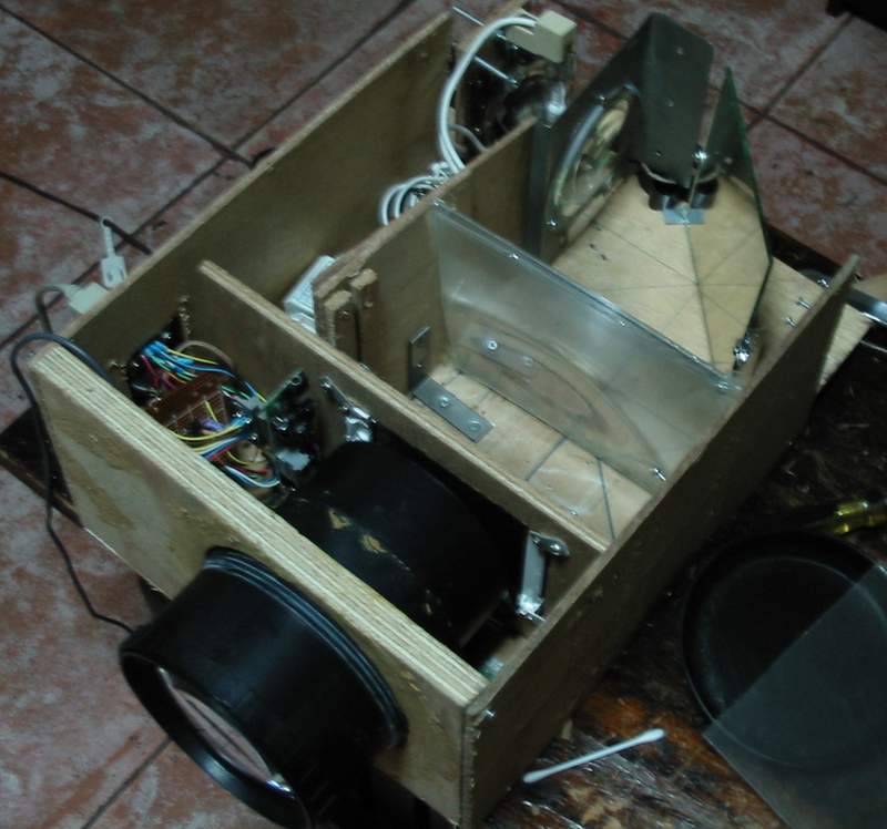

dracul, i'm no expert on this but i'll try to answer based from what i have done on this projector.
the FL of the NEC CRT lens was the distance between the psone LCD and the outer NEC CRT lens. the gap between the inner NEC CRT lens is very close to the PSone LCD (about 15 to 20 mm).
i used an unsplit fresnel from junked Leisegang OHP and this i placed around 13" from the outer NEC CRT lens. i initially started with the unsplit fresnel very close to the PSone LCD but i got a dim circular image. as i moved the fresnel away from the LCD, the projected image became brighter covering the whole LCD image. good thing is that i cut my fresnel with 1" border based from LCD screen size.
the psOne LCd i dismantled does not have a composite video input, so the image i post is a VGA resolution from PC via VGA hack and a PSone console resolution.
i also like to mention, if anyone wants to try this VGA hack for psone, i was not able to resolve the screen image of the movies via PC. something is missing. i can only view around 60 to 80 % of the whole screen depending on the DVD software player i used.
