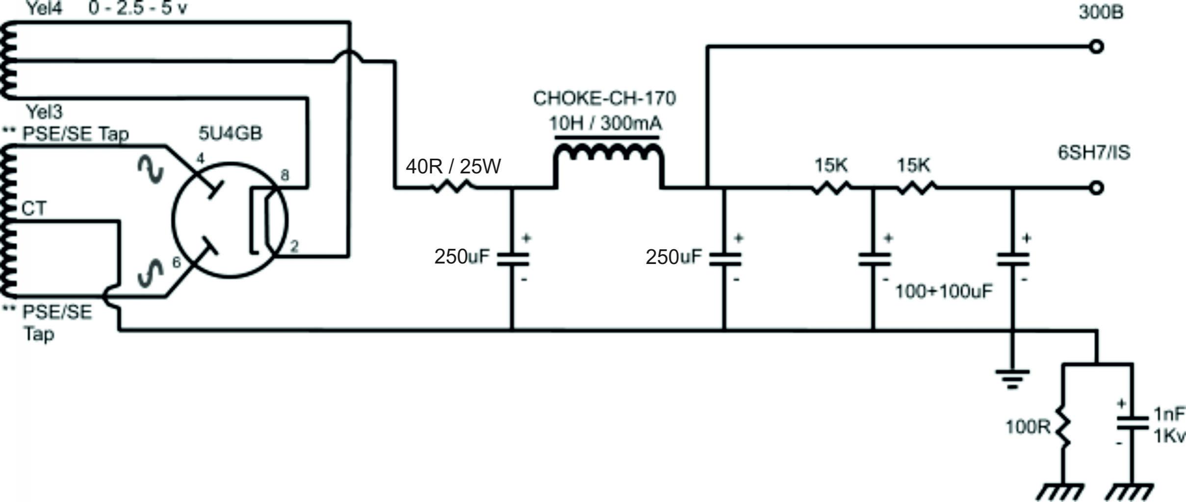

I started a new project 300B PSE.
In the original scheme of the PSU electrolytic capacitors are Mundorf:
250mkF-10H - 250mkF-15K-100mkF-15K-100mkF .

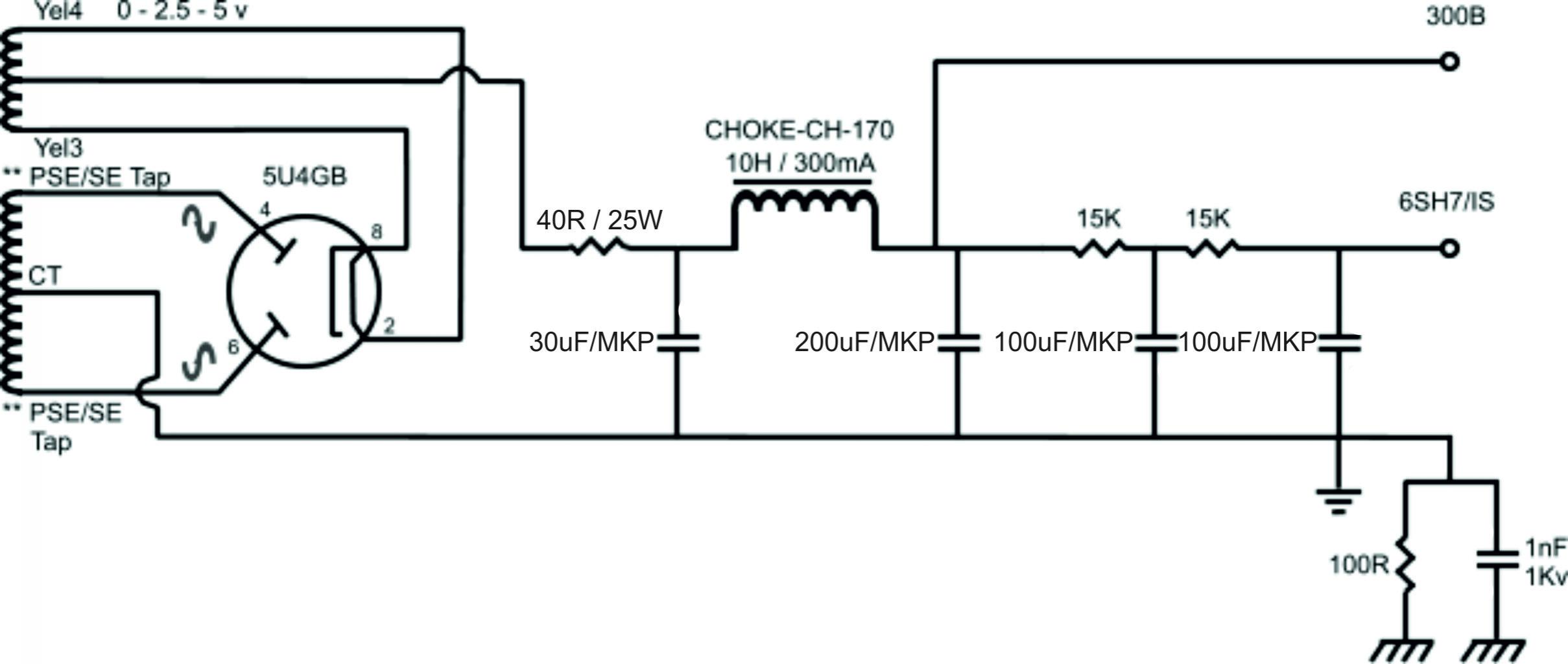

Please tell me if I could put in their place MKP capacitors with voltage 600V:
30mkF-10H-200mkF-15K-100mkF-15K-100mkF ?
It is a problem if you put 30mkF instead of 250mkF ?
It should be all 100...200mkF?
Thank you!

I'm not sure I fully understand your question. You threw me off for a bit with the "mkF" rather than "uF". Anyway... The capacitances in your schematics look pretty reasonable, except the capacitor on the output of the 5U4 in the first schematic. I don't think the 5U4 can survive that much cap, but check the data sheet. 30 uF sounds more reasonable for that - as you have in your second schematic.

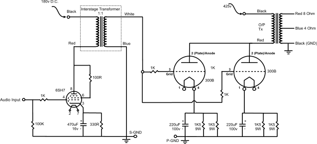

One note on your amp schematic, though. You can get rid of some caps in the signal path by converting the output stage to fixed bias. Instead of connecting the secondary of the inter-stage transformer (blue wire) to ground, connect it to an adjustable negative supply. You'll need somewhere around -65~-90 V on that node. Then just ground the cathode of the 300B. That eliminates two expensive caps and four 9 W power resistors. You'd probably want a slightly lower B+ if you do that...

Thanks very much for your answer ,Tom!
I checked. For 5u4 capacitor must be 40uF.
I'll put this value in my scheme.
I really like your suggestion to move the fixed bias.
But I think I have a problem with the B + voltage to decrease ...

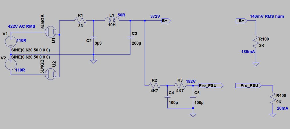

Power supply output voltage depends on several factors:
example
- P. S. transformer secunder parameters (voltage, DCR);
- rectifier tube drop voltage;
- choke or capacitor input;
- first capacitor value;
- choke DCR;
- load
etc.
If you decrease first capacitor (3u3 in my schematic), then output voltage lessen, but hum will increase.
IMHO 200uF too much, in my practice in such case sound too "slow".
