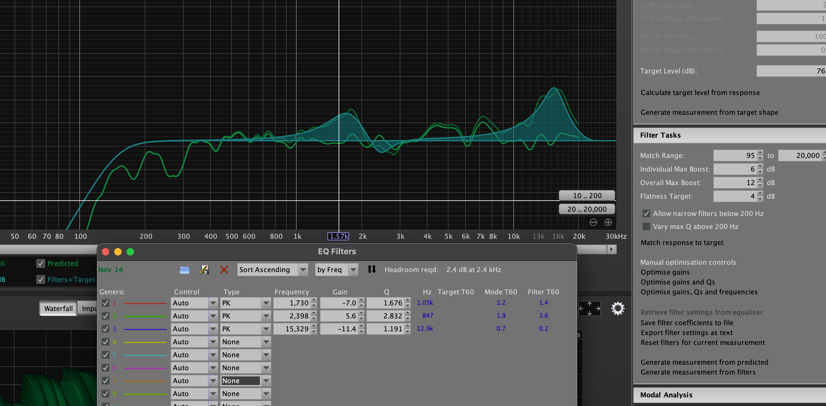

I installed a parametric EQ and computed a simple filter with flatness target = 4.
And... now a few songs I couldn't listen to sound good. Some of them very good. Really...
I recorded a sample with parts of a song, from a single baffle.
I'm hoping to achieve something similar with passive elements because I need to gift a pair of speakers to a friend who wouldn't want to deal with an EQ.
Looking forward to the next build with a different baffle. 4 more drivers to play with.

Your series inductor needs to be at about 1.2mH to help with the low end. 0.3 is simply not enough.
The peak-dip combo will still exist, and a large inductor will deepen the dip even further. A notch filter will help with the peak, but nothing you can do about the dip. That entire band will be missing. I would use a shunt notch, easier to hit the 0.4 octave target presented by the peak.
I've not made a filter for the driver by itself, but plenty of projects using it so you should be able to find something you like by searching.
