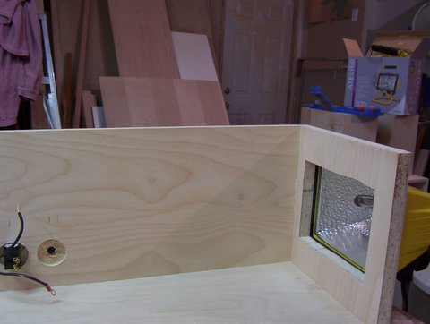

Well I started on my projector tonight. Bought a 500 watt construction light (cheaper than buying seperate) and fresnel (hope I spelt that right) and some switches and wire from a local Canadian Tire all for $80. I had some wood left over from one of my Dads kitchens that he builds, and begain cuting. I went for a straight projctor. No mirrors. And no plans. Here is a pic of what it looked like after I put a couple of pieces together.

since i was stupid and lazy, I didnt upload my picures everyday. So you will be seeing all my pics from start to finish (2 days worth). Now, back to the projector. Since I am useing a powerful lamp I put it out side to help keep the temperature down a bit. I also have a 120v fan from an old slide projector above the light to help cool the beast.

Next I went on to wireing. I first ran the power to one switch that turns on the fan and power to the next switch. And the second switch turns on the Lcd and the Light. This way you need to have the fan on to turn on the lcd. To wire up the light and lcd I ran some wire to an electrical box outside the projector, this way it was away from heat.

Can't wait to see your result pics, sure to be bright ! I have experience with one of those style lighting sets, they are SUPER HOT, So be careful, I hope it does not cook your psone lcd screen, anyway putting a fan near it may help, keep us posted ....
