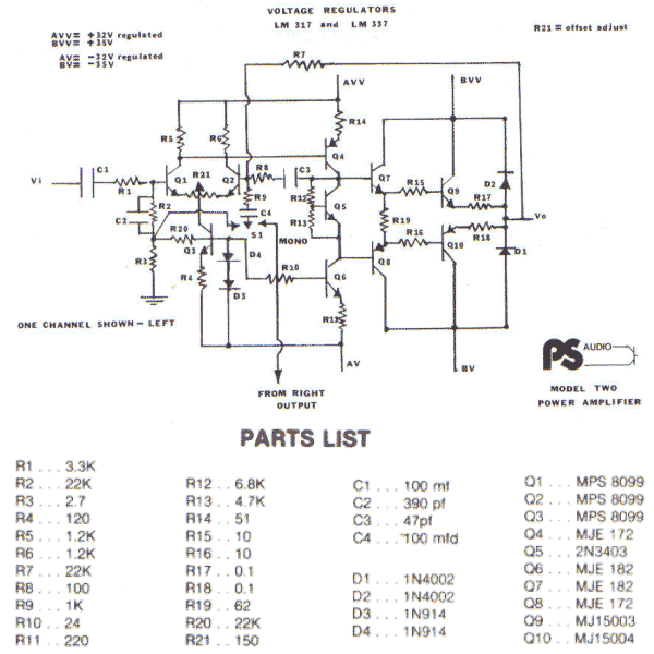

I have schematics for the PS model II, both the early types as well as the IICPLUS. I believe that the Elite uses a model II type design.

OK, I contacted Paul McGowan of PS Audio and he enthusiastically gave me permission to post the schematics here.

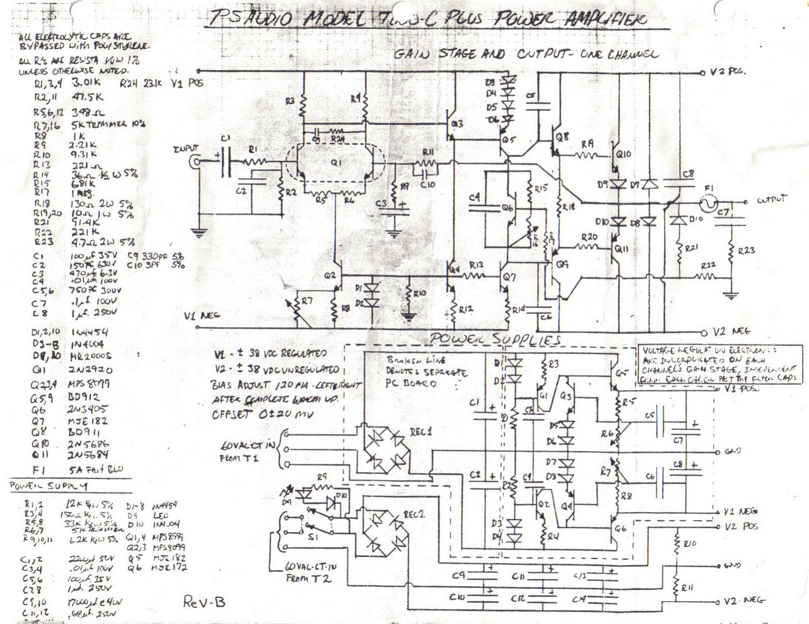

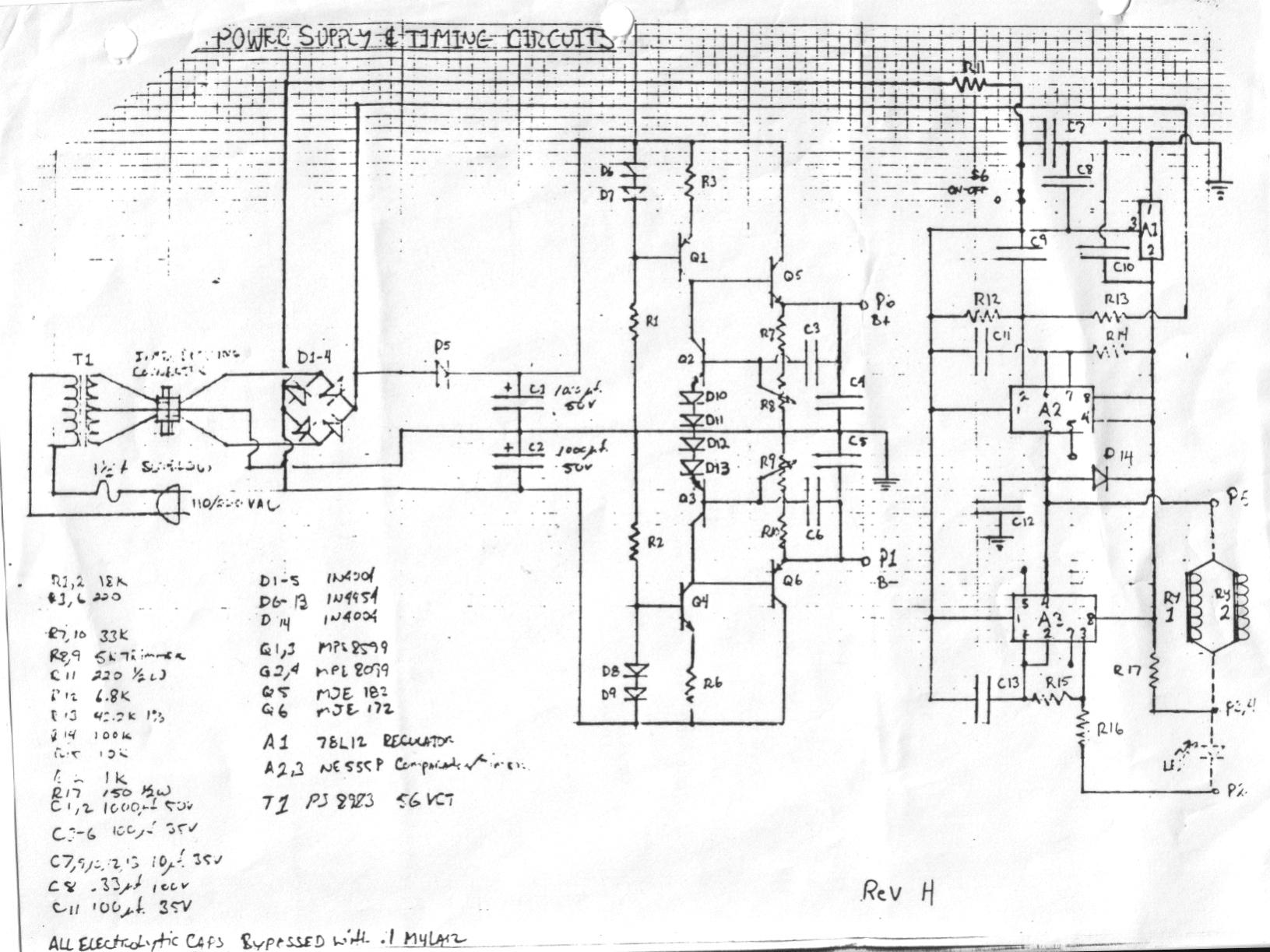

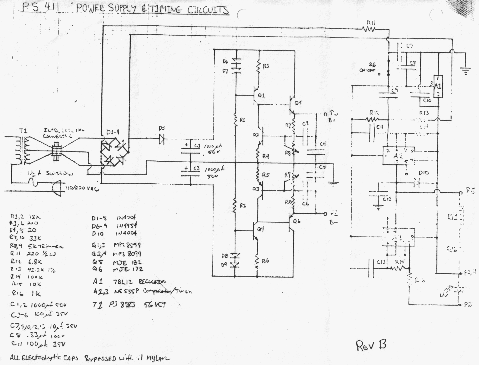

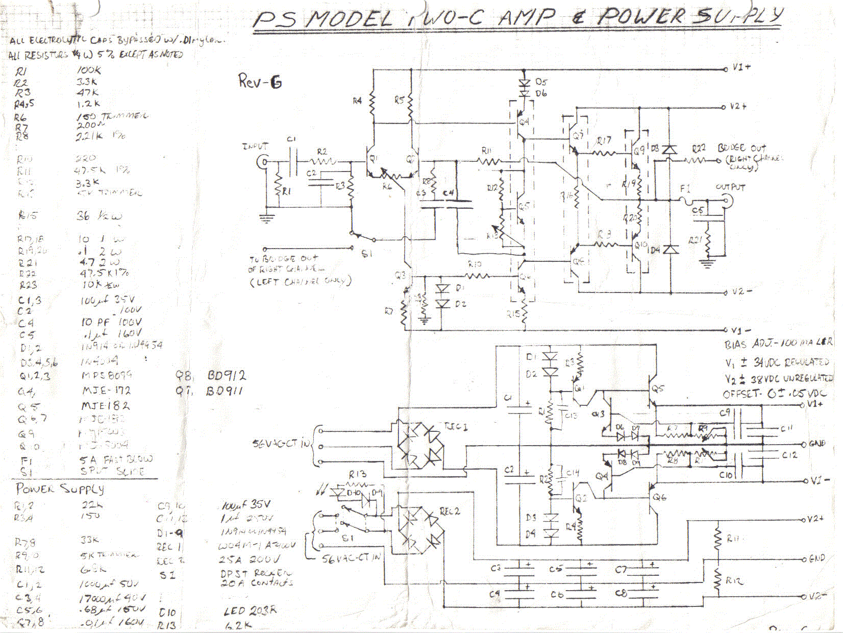

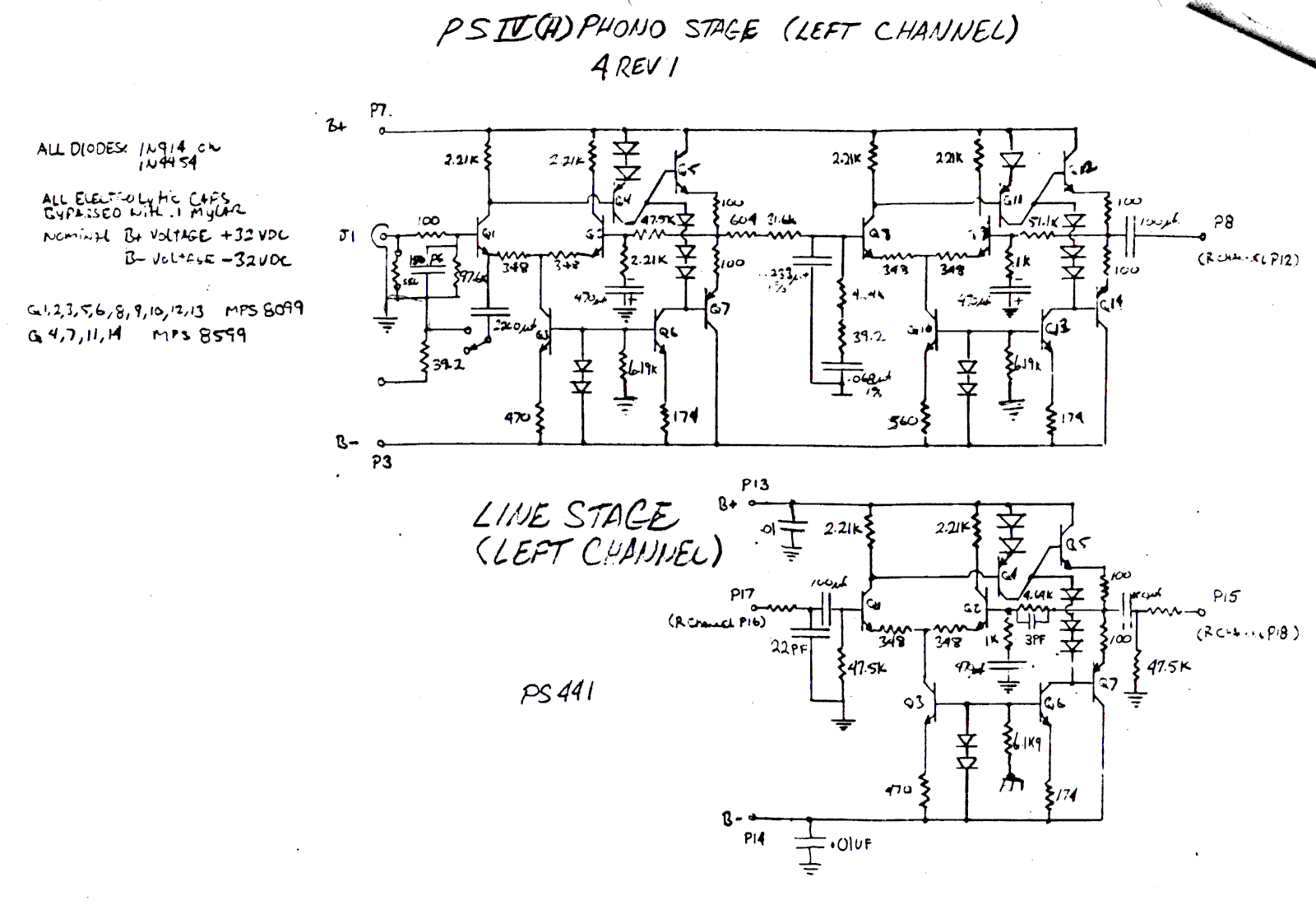

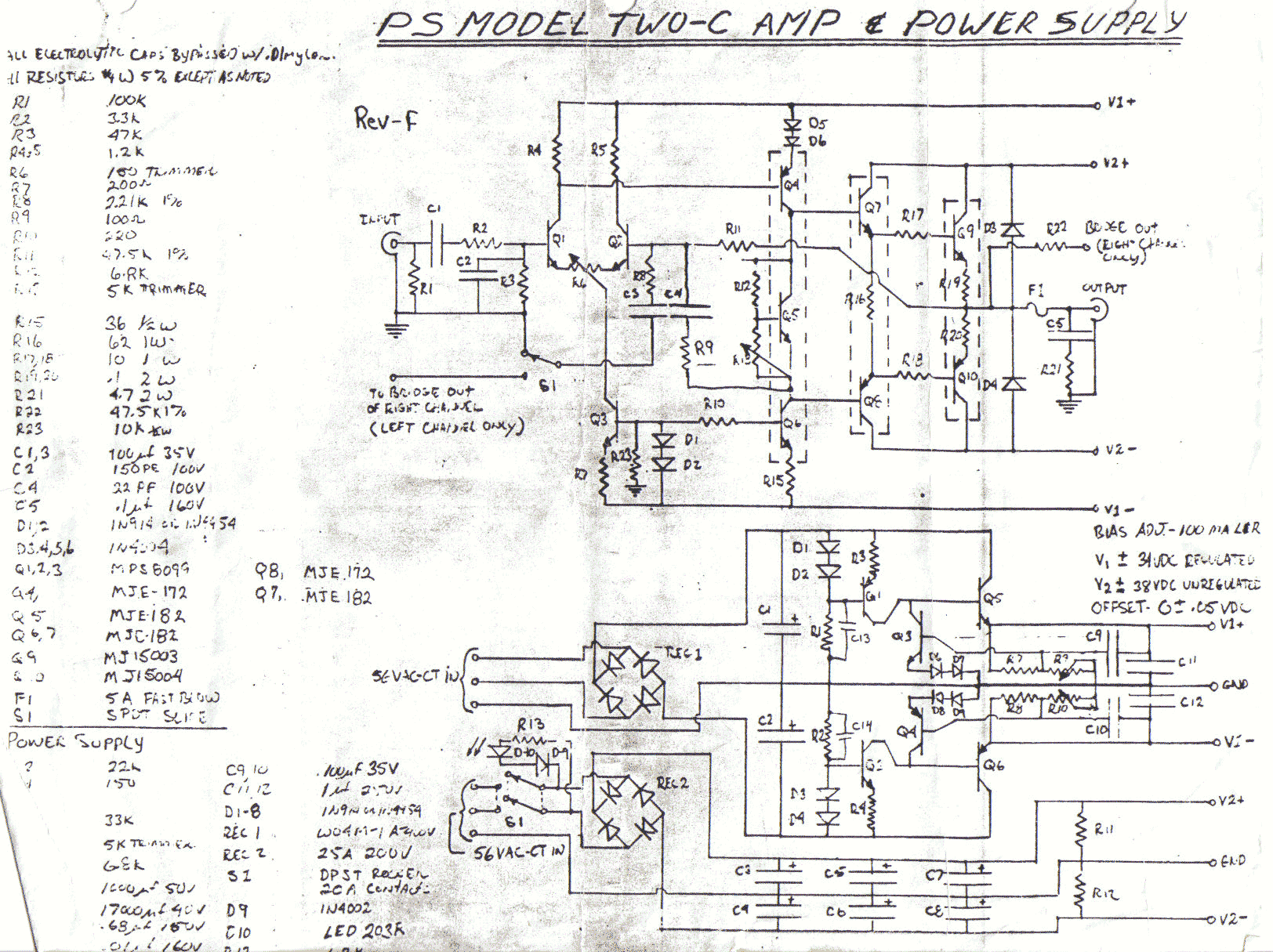

Below are the diagrams for the PS model IV preamplifier rev G and H versions including the power supplies, as well as the power amplifiers including the original model 2, the model 2C rev F and G versions and the 2CPLUS amplifier rev B.
Please be aware that the following changes to the 2CPLUS were subsequently made according to Rick Cullen (production service manager); Q1 2N2920 was changed back to two MPS8099s, C10 was eliminated, and a 0.1uF capacitor was added between the base of Q7 and the negative rail. He also recommended using 2SA909 and 2SC1586 for the output transistors (faster devices but lower current rating). Finally, I have found that the DC voltage polarity on C3 can sometimes be backwards to the schematic and should be measured with a voltmeter and installed accordingly.
The later versions of both the preamps and power amps exclusively used Corning Resista type for the 1/4 watt resistors.
I believe that the Elite used most of these same circuits as well.

I still like the sound of the 2C+. But trying to replace those ring emitter outputs is not likely anymore. Thankfully mine was still working fine when it went into storage almost 30 years ago. I will have to do a full recap if I ever choose to use it again. I can't count how many PS amps I know of that were destroyed when some well-meaning soul plugged them after years of storage. Those PS caps do not age well! same with the electrolytics on the PC.
These amplifiers do sound great and were a fantastic bargain back when they were new.
I have sufficient stock of all parts needed to keep a few of these amplifiers going for a very long time. The biggest problem with the entire Model Two series was that the outputs and heat sinks were marginal for the power output. I have replaced outputs on these amplifiers many dozens of times, as well as the main power supply electrolytics like you mentioned.
A friend of mine owns four Two C+ amplifiers and I needed to repair at least one of them every few years, so I added a second set of outputs and heat sink to each one and they have all been 100% reliable ever since. The updated PS Audio amplifiers that I built use four pairs of outputs per channel and even though they are a lot higher power output than the original, I expect that those transistors will last "forever".

Which transistors are you using? Agreed on the heat sinks. But I had never personally damaged any of my amps. My attitude was if I needed to play it that loud, then use the 200c! All my 2C variants were used with high efficiency speakers (99 dB/1w/1m). So they never got pushed that hard.
I continued to use the 2N5684 and 2N5686 parts on my friend's amplifiers and used MJ15024 and MJ15025 on my own amplifiers. My friend has fairly inefficient speakers and likes his music loud. I have always used Acoustat speakers which are quite power hungry.

Another resurrection. I have just finished a few nights on the bench with the Elite. I rotated it out of the system because it has started to exhibit an intermittent hum so I now plan to re-cap the unregulated power supply and possibly some caps in the regulated sections, if I see anything there with the scope when it "manifests".
So the advice I got three years ago about the dirty front panel pushbutton switches was right on. After spraying them with QD and plenty of exercising, they are all fully functional and the preamp is working fine.

Best be careful with NOS and surplus electrolytics. You can try reforming them before use. But you should always check the leakage. I learned that PS amps hate unbalanced rail voltage, most bipolar driven amps do. If one side is out too far, plan on eating the output section.
