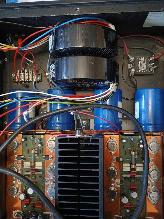

Looking at more reputable suppliers, like Mouser, I found a pair of Triad 500W toroids. These are close, but won't quite work. Just a bit too big in diameter to fit either stacked or on edge. The one thing I could do would be to construct a shelf so they could sit above the filter caps. That would fit, and would make the amp dual mono. But that's about 235€ before shipping (from DigiKey France), and not counting the shelf. On the other hand, these have multiple primaries, so it's still a bit tempting.
So, thoughts? 1000VA dual mono with a bit of fabrication work, and the option to switch to any supply voltage, or go back to the original transformer and add another external step-down (100€ for a 3000VA from Amazon... hopefully it's quiet and not too wasteful).

Got the transformers a couple of days ago from Toroidy. Have not had a chance to install them yet. Looks like the centers are potted, and that's how they get mounted. Each of these 600VA transformers is about the same size as the one AliExpress "1800W" transformer.
Unfortunately, I miscalculated on how much space I have between the front plate and the capacitors and the new toroids are a couple of mm too wide to fit stacked. They will either need brackets to mount them on edge, or a shelf to let them sit flat side-by-side above the caps.
