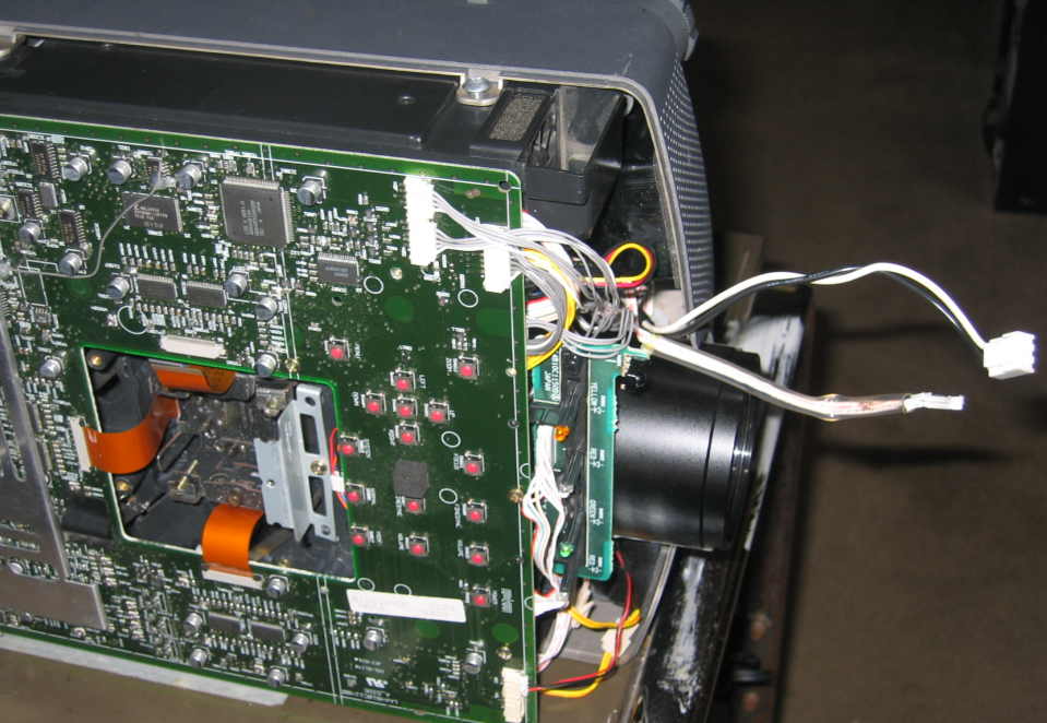

I just scored a Proxima dp5900ug!!!!
A friend happened to see an ad in a local bargain finder paper for a Proxima dp5900ug projector today and sent me the contact info. A quick google search found a very good review
http://www.encyclopedia.com/doc/1G1-19987921.html
When introduced in late 1997, this baby retailed for $9,000.00 US!
The owner`s manual is available here,
http://www.askproxima.com/service/dp5900/downloads/dp5900ug.pdf
The story being it was a very well kept one owner boardroom projector that had essentially gone through it`s first lamp and it sounded like the internal timer was now preventing the unit from operating. The PO ran the unit with the `REPLACE LAMP` light lit for some time until one day it would not come on.
I decided for the very reasonable asking price ($100) that it was a good gamble. This thing is spotless and mint. It comes in a hardshell travelling luggage case with wheels and telescoping handle to hustle around in airports and hotels with ease. This case was alone worth my admission price.
Two hour`s round trip drive to fetch and it is now home. I tried to fire it up and it came on properly, there was dim light out of the lens caused by what I assume the high voltage ignition sequence, followed by a surge in brightness as power supply DC was applied to the lamp and immediate shut down within maybe 400 mSec. During the brief time of light there was a blue screen and the graphic of the name Proxima projected onto the wall a few feet away from my lens.
I am going to assume that the lamp timer has run out of hours and it may well be this that is preventing the lamp from coming on full. There is apparently a reset button somewhere that can reset the lamp timer, to be done only when the lamp is replaced with a new one. If I reset this and the set operates properly I`ll know that I am just a new lamp away from a useable PJ.
I`d like to save the big money that a new 125 watt metal halide lamp assembly costs. Towards this end the idea of removing the existing ballast, fooling the PJ into thinking it is in and AOK, and installing a xenon short arc lamp in my old reflector assembly and wiring in an appropriate ballast is tempting!
I`ll keep this thread appraised of anything I learn and do.

The Lamp timer has NOthing to do with the the unit starting up.
My First opinion ,,, It appears to me Like the Lamp is your Problem. The sanyo Projectors are VERY VERY sensitive to lamp circuts. If the Lamp is on the way out than it is shutting down during the start Up/ countdown cycle. You get the dim light then the Brighter Blue Light starts up then it goes dead.
If I were you I would Buy a New Lamp and Make SURE it is a Philips UHP. This is a fantastic Projector. BY todays standards it would be about 1000 to 1200 Lumens and the quality is superb!.
If you want to try jumping the Ballast to see if if you can keep it running, there is a thread in here that decribes doing just that.
the Board that connects to the Ballast is Located Under the Main top Board to the right of the Lens if you are Looking at it from the front. Be very carefull if you remove the LCD ribbons to make sure the little tabs on the connectors are seperated correctly. You have to pull them out a a few MM's evenly with your fingernails. I am Planning on trying this myself with one of the units I have. I just have to decide which Pins to Jump. and since I am not an electrionic tech,, I am a Bit hesitant
Let Me KNow what you decide. good Luck
Please reply here and Feel free to Email Me Directly
at Stuffyhead1@aol.com
Bohanna

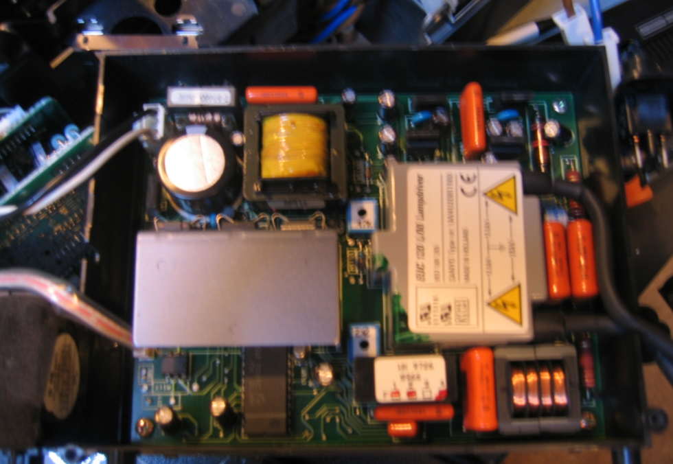

I think Bohanna may be right - usually if the lamp timer has expired the projector won't attempt to ignite the lamp at all. The reason the lamp probably shuts down is that it is worn out....
Most lamps are simply an arc gap - when the electrodes wear down the gap becomes wider. The lamp then requires more voltage / current to ignite.
The projector generally has no way of knowing the power needed to start the lamp until the first sparks jump the gap, so if the lamp is worn, the PJ will still pulse the lamp for a short time before shutting down. (ie. the lamp timer is only an estimate of the true lamp "health", the lamp can of course wear out before or after the timer expires.)
If you're looking for a cheap replacement for the lamp, you can't go wrong with the bulbs from YWH. Yes, they need the original reflector, and can be tricky to fit etc. but they're cheap enough just to get one to "play" with. If your original lamp was a UHP, then you would just need a JYd AC bulb (with the same wattage) to replace it.
I've used a few of these bulbs now and I only had a problem with a JYd DC bulb because I was using plaster back then and some of it got on the globe part of the bulb. This caused the bulb to fracture when in use (probably due to the differences in expansion rates of the glass / plaster). In other words, you MUST keep the bulb part clean!
As long as your ballast board looks the same, you should be able to get the PJ to stay on by just connecting the "lamp lit" signal to the Ground pin like in my post here.....
http://www.diyaudio.com/forums/showthread.php?postid=954813#post954813
It's best to disconnect the ballast board altogether and just short the corresponding two pins on the small signal plug.
!!!! Make sure this is the signal plug and not the power plug !!!!
The problem here is that this won't bypass the lamp timer if it has expired because this is usually stored in an eeprom chip on the main board. Or, on some projectors they use a small fuse on the lamp holder itself which is purposely "popped" when a new bulb is first installed. (Sometimes there are buton combinations to reset the lamp timer, or you have to access the service menu first.)
If you do get the PJ running without the ballast / lamp. You could try a small halogen lamp and external PSU but it'll probably give a very dim image.
If you're looking for projectors, you could take a chance on an eB*y one - most of the faulty ones just have blown lamps but you could still end up with a proper broken PJ of course. I generally like to aim for an XGA resolution DLP because the extra resolution is well worth it IMHO (compared to SVGA). I don't tend to buy second-hand LCD projectors purely because I've bought many in the past with worn LCD panels (the blue ones often fail first due to UV damage.)
So in summary, it's not too difficult to bypass the ballasts in most PJ's, but it does require some basic knowledge and possibly soldering skills. Most PJ's I've seen use a simple "lamp lit" signal, but other ballasts send out a voltage which corresponds to the current drawn by the lamp as it "heats up".
Also, nearly all PJ's use Opto-couplers / Opto-isolators to isolate the high voltage side of the ballast from the rest of the projector. I can usually work out most PJ's by downloading the datasheets for the optos (try G**gle), then tracing the tracks to the signal cable.
OzOnE.
P.S. Again, please don't take any chances with this high-voltage stuff as I wouldn't want anyone to fry for the sake of a big screen!

It worked!!!!
Hey Ozone you are a freaking Genius!!!
It worked !! I used a Little stripped trash Bag twist tie as a conduit and Jumped between the Lamp Lit and Gnd pin slots on the end of the tiny connector as you suggested
I then Unplugged the two wire (Black and white) Power cable from the Ballast and Put the Ballast back in Place.
I also Put small spacer slug in the (indented) Lamp holder cover plate power switch and taped over it.
The thing has fired up!! and STAYS fired up!!! I will Post a few Pictures of this set up soon.
This was a trial unit that had several optical Problems.
Now that I know this works I will be trying it on a Projector that I know is working correctly.
BTW
The Heavy Brown and Blue Main AC power Lines and the Backside of the indented cover switch is attached to the end of the Ballast so it is Better to Leave the Ballast in Place and Just disable it by unplugging the Black and white Ballast Power connector.
So far SOOOOO GOOOOOOOOD!!
Thanks again Man
Bohanna

Here are two Photos of the Ballast and the connectors that need to be unplugged to disable the Ballast. this is the Ballast with the cover/shield removed so you can see it.
the Little cable bottom left is the optical sensor cable that has to be removed/unplugged and the two Pins jumped . The Bigger black and white plug is the one that actually powers the Ballast.
you unplug it as well. the second photo is the t wo cables out of the unit for refrence Purposes

This Photo is a shot of the Projector tricked out with the two cables removed from the Ballast and still connected to the projector.
The Little one (originally from the Ballast Optics) is Jumped with a bent staple.
the Larger one is the one that was originally connected to the Ballast. It reguires NO JUMPING!. It stays unplugged.
Good Luck

to avoid any confusion the Ballast supply Pictures in the Beginning of this Thread show a red and Black wire connected to the Ballast power supply. In My Photos it shows a Black and white wire. They are the same connectors and wires just different colors. I don't know if is because it is a sanyo 8800N I am using or that they changed colors during Production of these units. Also it seems Like the Picture views of mine and the first pictures in this thread are turned 180 degrees or upside down from each other even though they are the same Ballast Board. Any questions twist you neck upside down and Look at the Board
