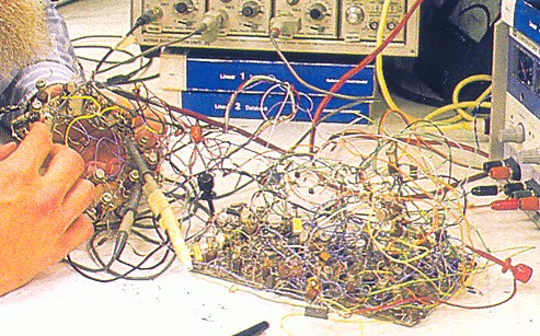

Something like this:

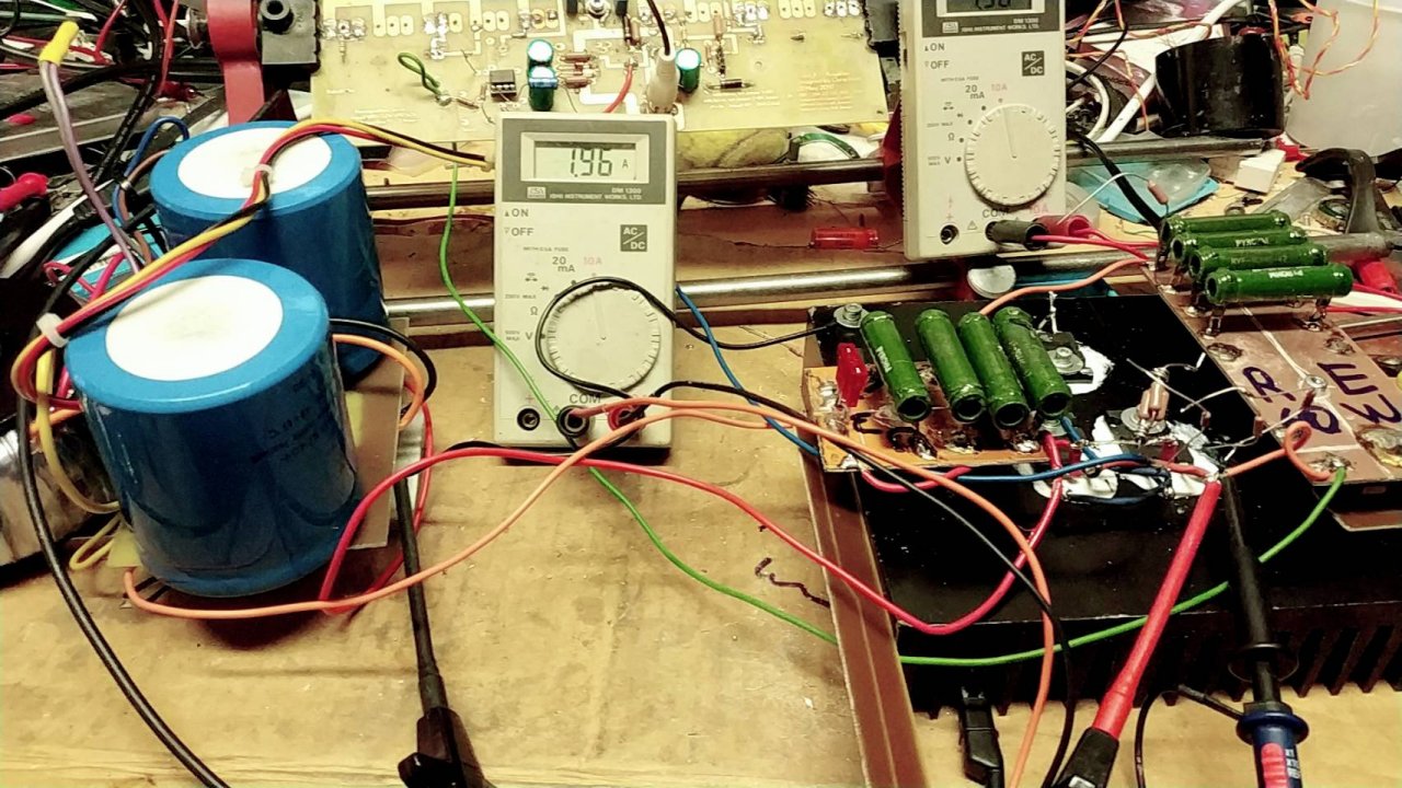

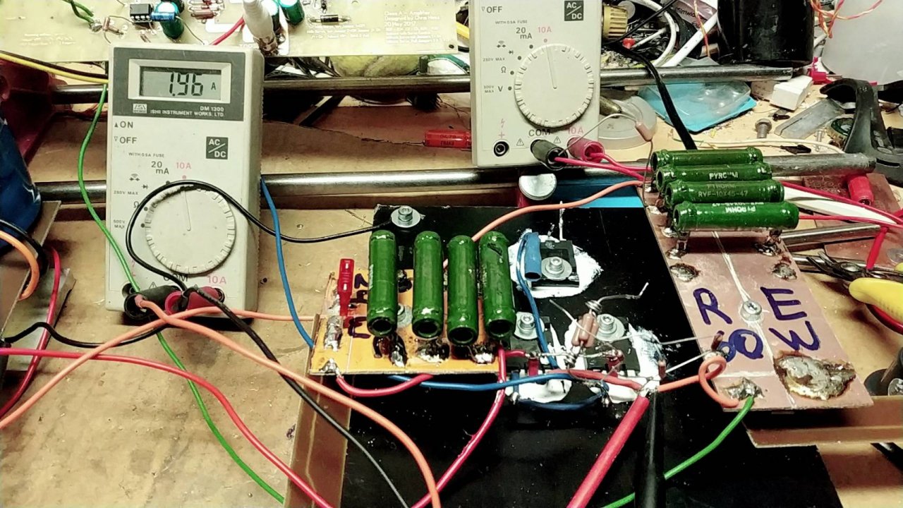

In the nineties, I Drew the circuit I was going to Test on a A4 or A3 Sheet. A4 is 21x29 cm and A3 29x42 cm .. about in these sizes.
Then I glued it down on a same size 5mmthick Plywood,
For Each connection point I used iron Nails with a bit NAIL HEAD, and used a Small Hammer to get the nails into the plywood. then used wires to make the connection, after that soldered the Resistors and Transistor on top of the NAIL HEADS, also Capacitors. and finally had an neat and clean Circuit, to look at, and to test, without to have to fear get a Wire infection on the fingers, because of cross wires all over the place..
Developing electrical Schematics and Prototypes should always be good over viewable..Check out the Pictures, and this was the start of the CLASS A SINGLE END AMP which you can look up in my other Thread..
That's my 2 cents to this and I do not press or force anyone to do so. any one should do as he's pleased with.
Enjoy Sunday..
