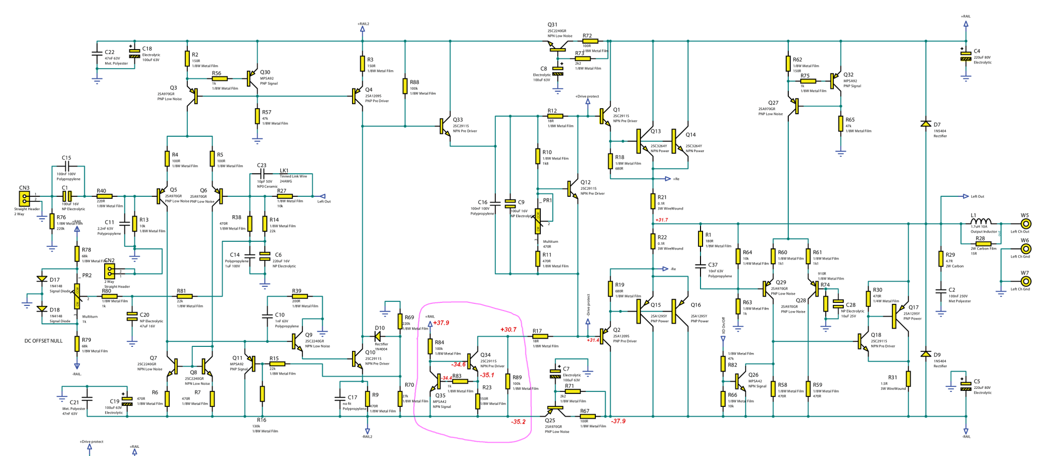

Hi again guys,
It turned out that in addition to the filter capacitors, there was another problem +31 VDC offset. I took some measurements in what I think is the problem area (they are written in red)
The board looks good, no overheated areas. I measured all the capacitors with an ESR meter as they are in the circuit and they look fine. The final transistors are ОК.
I look forward to your advice.
There circuit you've circled is a constant current source (CCS) and the voltages you noted are definitely problematic. There should be about 0.6V base to emitter at Q35, which should in turn drive Q34 to deliver about 0.6V across R23, i.e. constant current = 0.6V/150 ohm = 4mA.
At first glance, there's only 0.1V across R23, which might indicate Q34 collector has opened, or Beta deteriorated badly. But then how can there be 0.8V showing at Q35 base-emitter? Both transistors deserve scrutiny. I suggest connecting your meter's negative lead to the -35V rail and probing points of interest. The readings be easier to make and interpret.
