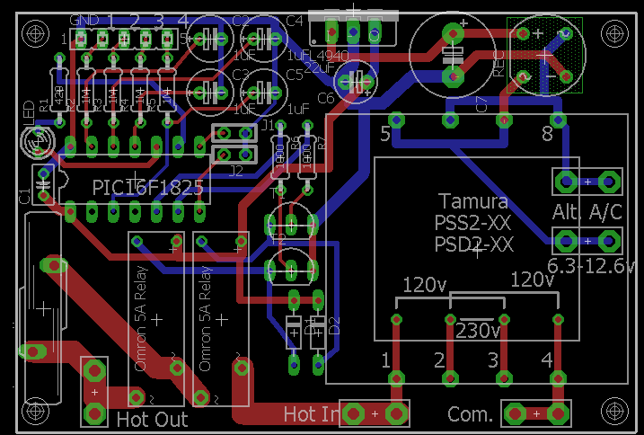

Hey this is topical. I am working this up. It watches up to 4 tubes using the 1.024 volt A/D reference voltage on a PIC 16F1825. The program works in tube pairs and watches for a 20% imbalance between two push-pull tubes and shuts down if it finds it.
So for say a 60mA bias using a 5 ohm cathode resistor gives .3 volts to the A/D converter of the PIC. I also programmed it to shut down at 1 volt for any tube or 200mA using a 5 ohm resistor. So far in testing it is working great.

Interesting. Right now I'm working on making the disparate ideas I already have on my plate play nice with each other. I'm not really concerned at this point in refining current balance with a microprocessor. Provisions are already made for individual manual bias control for each tube via a dedicated source follower mosfet. Overall balance of each side of the push-pull for each channel will be front panel accessible without changing each tube's individual bias adjustment. Two meters on the front for that. I'm old school that way. I'm also a believer that when you explore new territory then it behooves you to be as conservative as possible in every other aspect.
Despite my own preferences I hope you can get it to work reliably for you. I'm sure there are many members here that would be interested in what you are doing.
