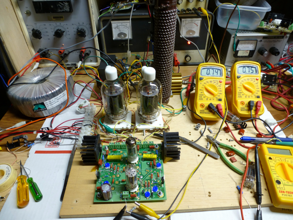

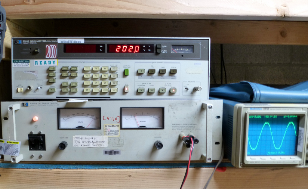

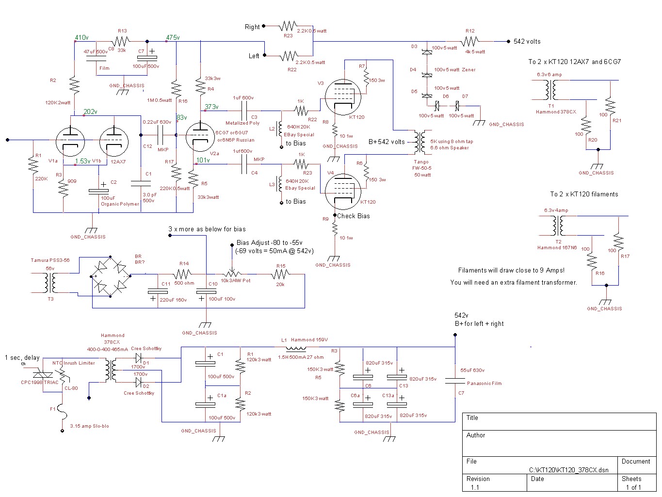

Here is my cathodyne at slightly less than the 1/4 split. It drives the KT120's well into clipping. The grid chokes do help and also I am not using any feedback around the cathodyne. Running the KT120's as triodes I get 40 watts which is lots of power. This is my favorite amp ever for sound.
Any modern CD/DVD player with 2v output will drive it nicely. The 6CG7 gave the lowest distortion...12AU7 the worst.
That looks like a really nice implementation. I'm inclined to borrow ideas from it and scrap using one tube for amplification and phase splitting in a dual tube. I like the idea of using a 12ax7 paralleled too. It's a little more gain than I need but I may use some local feedback (unbypassed cathode) to tame it. It at least gives me enough gain to drive 6v6s to clipping which the 6sn7 couldn't do. I then have the option of ppp 6v6s as well as el84s.
Something I noticed - you have a lot of volts on that 6cg7 but it's only rated at 300 volts plate voltage. Are you worried about flashover before the heaters warm up? Also, what's C1 for?
That 300V rating should be just the max quiescent Va-k. He's running Va-k = 272V so it looks fine to me.
I was thinking more about before the load resistors pass current and before they drop voltage. For instance, when there exists B+ but heaters haven't warmed yet and the tube isn't conducting. But if he hasn't had problems yet then perhaps he won't.
That's what I'm saying, a design-center DC plate voltage maximum rating takes into account that there will be momentary plate voltages well in excess of this number. I would say that you would be fine up to at least twice this value for momentary plate voltages.

No problems with the 6CG7 the amplifier has been running daily for over a year and I expect many more years of service from the 6CG7. Also with the relatively large cathode resistor as soon as any current flows the voltage on the cathode of the 6CG7 goes up. 6CG7 has a 200v rating for Heater negative with respect to cathode also and I don't think I ever exceed that in this design although you could elevate the heater winding if you wanted to. The small C1 cap is to stop any oscillation in that stage. I have not tried it without C1. I found the grid resistors on the KT120 are required without them the amplifier would oscillate like crazy as soon as you put a signal through it. Cheers!

I have a design that routinely feeds about 500 volts to the 6GC7's on start up and runs them near 300 volts. Its been kicked around from test amp to test amp for nearly 7 years. There is also a 6SN7 version that's been around as long. Both boards still have the original previously used tubes in them. They go back to the 6L6GC in AB2 thread. The latest version does about 100 V P-P per phase at 0.14% distortion with zero feedback. It can make about 200 V P-P without clipping from a 500 volt supply. With mosfet buffers, it can drive the grids right out of most tubes.
http://www.diyaudio.com/forums/tubes-valves/133034-6l6gc-ab2-amp.html
The neon bulb is a clamping device to prevent H-K failures on start up with high negative supply voltages. Some big tubes like the 845 need -200 volts.
The driver schematic is enclosed, as are a pair of pictures showing 202 watts being shoved through one of my Plitrons by a pair of 4D32 transmitting tubes on 650 volts.....yes that is running a wee bit over 300 volts on the 6CG7's. More like 400 volts idle, 470 on signal peaks. The 6CG7 is derived from the 6SN7 which was used in TV sweep oscillators. The "peak positive plate voltage" is specced at 1500 volts.

It was always recommended to use grid and anode stoppers. Did you want to not use them for a reason?Hi exeric:
Did you note how many tubes you rolled through your testing, and what the THD% magnitude spread was with the samples, and whether the THD% characteristic was at both low level and when output stage assymetry may be starting to impose? How well were the R4/R5 matched?The 6CG7 gave the lowest distortion...12AU7 the worst.
