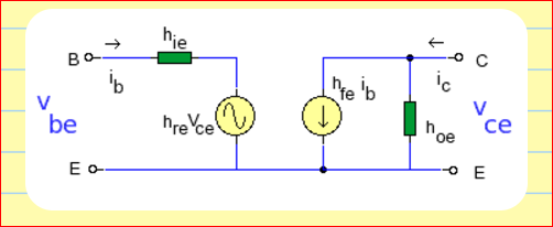

If they say all of the output is feedback into base, I would want to see some detalid explantation along with a professional drawing of the hybrid pi model for it. Clearly they do not have any of this.

It is also clear when you use the hybrid pi model you mentioned; just consider the E as both the inverting input and output (exactly as a unity gain opamp buffer with output connected to inverting input). Try to think conceptually.

BTW the attached model shows what is meant with E is both input and output (as the opamp buffer example). Just hang an Re between E and gound and hang the C to a power supply, and voilá!

If you are choosing A = Re/re then are you defining Vin = Vbe and Vout = V(Re)?
If so, I don't get how that can work as an equation for A as these two voltages are not referenced to a common point.
Also, how did you determine that B=1?
B=1 is the easy part: the output voltage is applied without any attenuation in series with the input.
A=Re/re is a little harder to grasp. The amplifier is a BJT, so gain is simply transconductance (1/re) multiplied by output load resistance (Re). The input and output voltages are both referenced to ground before feedback is applied. The snag with the emitter follower is that it is not possible to break the feedback loop as the emitter is both an input and output. However, conceptually we can split these two roles and see that the transistor (like all feedback amplifiers) amplifies the difference between the input signal and the feedback signal.
