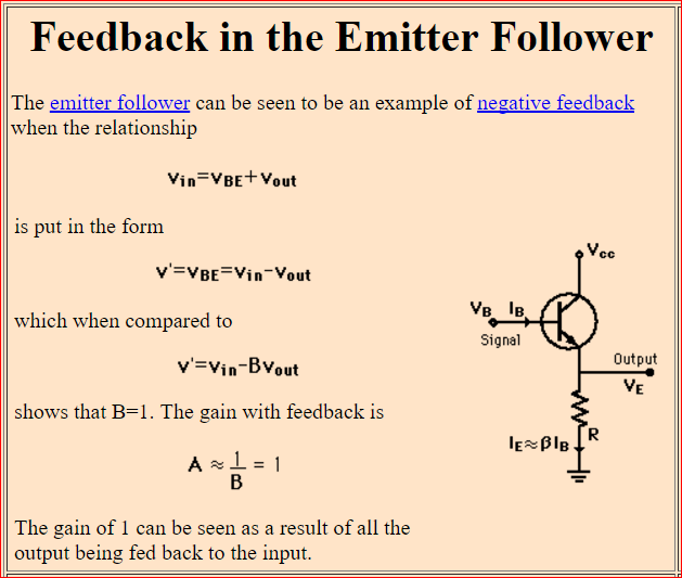

The emitter resistor functions by sensing the emitter current (a close proxy for the output current) and feeding back the resultant voltage. The result, as predicted by feedback theory, is an increase in input and output impedance, a reduction in gain and a reduction in distortion.
What you have described is the simple version of the theory told to newbies.
Degeneration is feedback.

The way it is normally understood in the literature and the technical community is as follows. The signal effective input for an emitter follower is the signal Vbe. Since the B is the signal input and the E is the 100% output, emitter followers are considered to have 100% local feedback.
The proof is that all the usual feedback advantages, like increased Zin, decreased Zout, decreased distortion, increased bandwidth, are all present in an emitter follower.

Are you sure you are not missing something?Hey guys thanks for the response, I may want to conclude that change in supply voltage dosen't effect sound quality and its better to have lower voltage outputs with higher bias current.
Does a resistor use 100% NFB?
When people are talking about using NFB in a circuit they aren't really talking about resistors.
Not sure what your point is or whoever you are addressing, but I don't think you can tie the concept of feedback to a single component. Feedback is in my view a circuit property.
For instance, the 100% feedback of an emitter follower we discussed before is taught to students at Georgia Tech as the attached.
