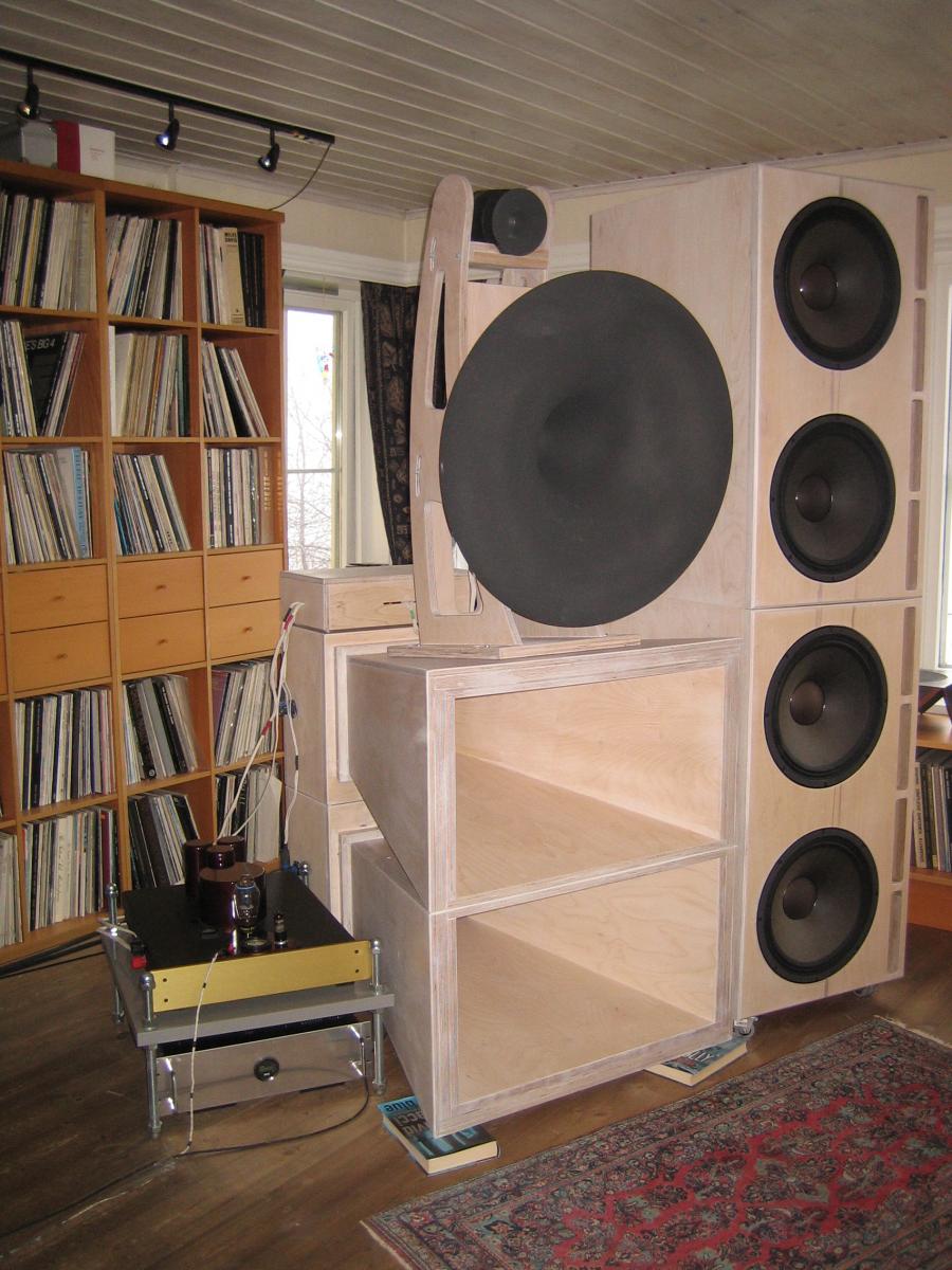

My suggestion would be to use the K-402 horn itself for midbass (as well as highs), using two or four 4" to 8" drivers per cabinet, depending on your SPL desires. The dispersion will be seamless, and because the offset mid bass drivers all share a virtual point source with the HF, output will integrate at a much closer listening distance than with two separate large horns.

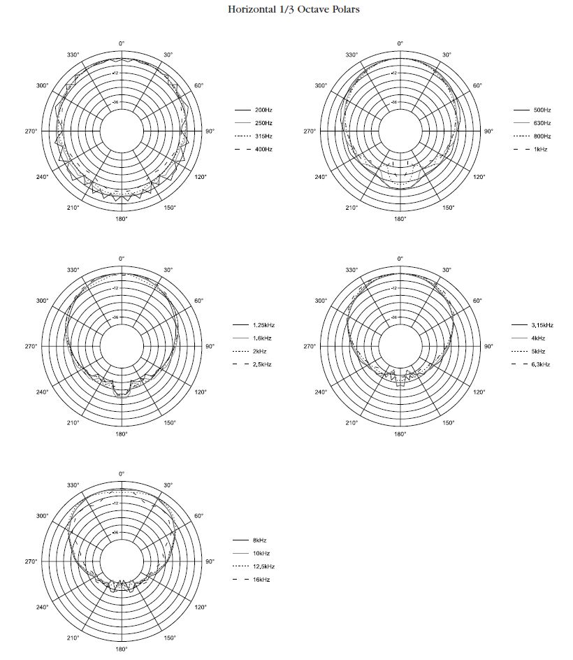

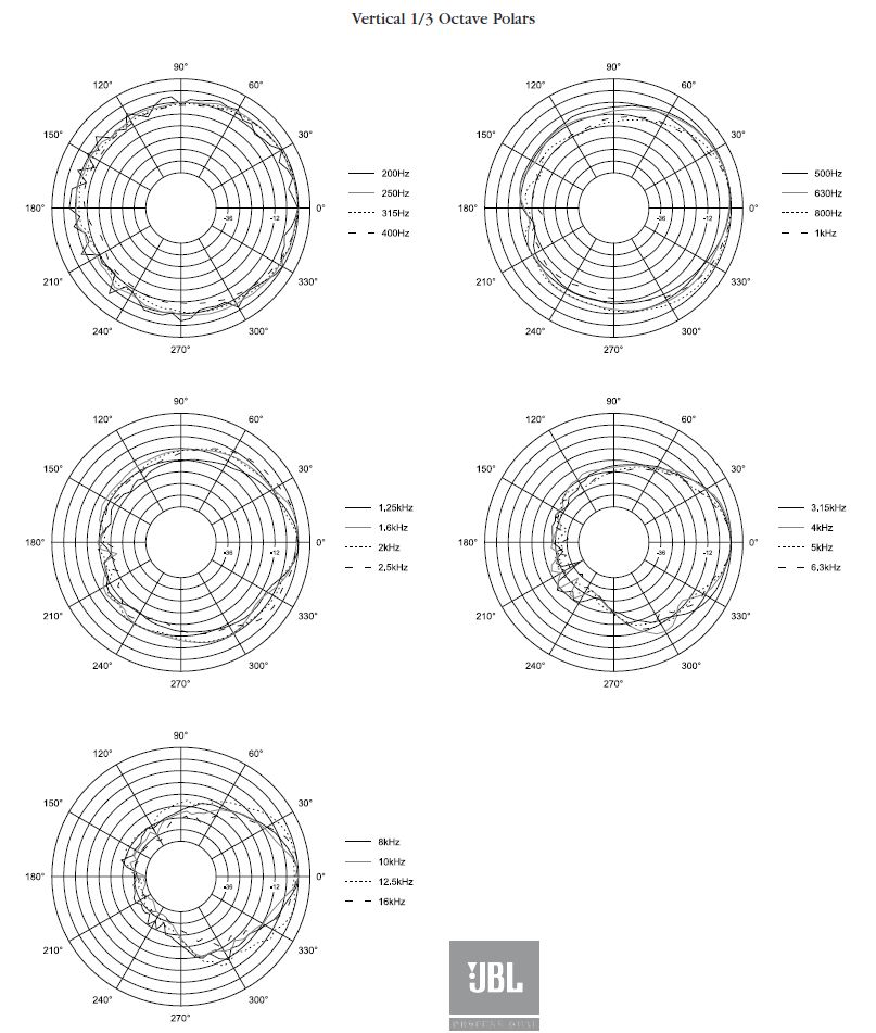

JBL 90° x 50° Coverage M + T Waveguides, JBL CMCD-82H, 8" midrange + 1.5" CD tweeter. Closer to your directivity goals.

That JBL apparently doesn't go nearly low enough - 250 Hz at -3dB point. The OP asked for crossing at 80 Hz, which means it probably should go to something like 50 Hz at -3dB. That would make it about 5.6 feet long.
A problem I have with JBL 2226 at the moment is a steep fall from around 400-300 Hz. Maybe related to baffel step.Your 15" drivers already roughly match the directivity of the K-402 in the 500 Hz region. For a mid bass horn to continue to have a roughly 90 degree directivity even a single octave lower than the K-402, it's diameter needs to be roughly twice as large.
Using horloading is tempting though in other areas then simply matching the directivity.

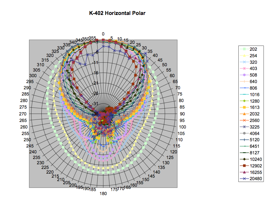

It certaintly matches well when it comes to apperance. I'll take a look at it. Is there a polar of it anywhere?Going with a horn like the KPT-XII-MB would match dispersion at crossover, but in reality not much better than the 15", though the horn depth being similar does have advantages in horizontal polar response over the front loaded 15".

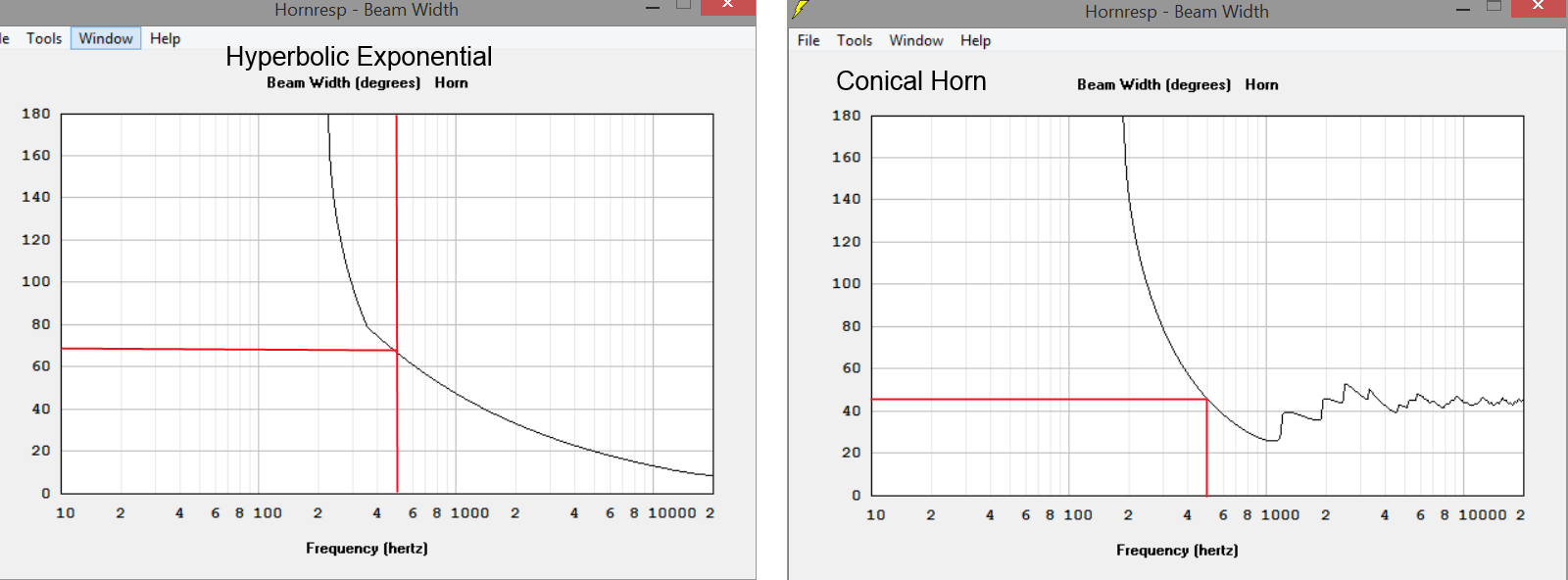

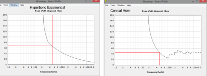

I'm also wondering about the pros and cons regarding conical vs hyperbolic horn. Below is a picture of a hyperbolic a fellow norwegian is building now. I've attached a simulation as well showing JBL 2220 in 84 cm deep conical horn (the bottom graph) and same driver in hyperbolic horn with 100 cm depth at the top. The deep hyperbolic is more even but I don't know anything about the directivity. Any comments?

The conical horns are usually considered to have the benefit of "constant directivity". But in this case when the mouth is small relative to the pass band they will not be. As Weltersys said, you would need a really large mouth just to get one octave deeper with same DI.
One of your "problems" is that you want to get to 80hz. This requires a horn that is about 1/4 of the wavelength at this frequency. Some people like to make them even longer for proper loading. This means something like 110cm~.
This depth means you need a super large mouth to reach your dispersion goals with a conical horn. It's simple geometry.
Myself, I would build a hyperbolic exponential and make the throat tall and narrow. (In fact I am building one myself now but only to cover 180-800hz).
That way you can get broader dispersion in the horizontal plane at the top of it's passband to kinda match the K402 in the horizontal at least. It also loads a little better down low as you can see from your own picture..
The downside is they are harder and more time consuming to build.
I think you worry to much about the lobing effect at least when it comes to reflected energy. Such a hole (limited to less than an octave) in the vertical response at this frequency will not be audible. The lobing will only be heard as a change in tonality if you move up and down near the speakers.
Do you find this troublesome today? Your 2226 stack won't be much better in this regard.

Thank you for chiming in. 🙂The conical horns are usually considered to have the benefit of "constant directivity". But in this case when the mouth is small relative to the pass band they will not be. As Weltersys said, you would need a really large mouth just to get one octave deeper with same DI.
I think I can live with getting the same DI around the crossover (500 Hz). One octave deeper would be optimal but I don't have the luxury of that size.
Or do you consider DI down here to approximately 450 Hz more or less a waste and of no benefit?
80 Hz isn't an absolute requirement. Again, an approximate area I gave. 80 Hz would give me great flexibility. However, as you know, I can easily cross over considerably higher to my JBL 2226 towers. And most likely I will cross over in the area of 100-130 Hz considering this is an easier way to get an even response in the room.One of your "problems" is that you want to get to 80hz. This requires a horn that is about 1/4 of the wavelength at this frequency. Some people like to make them even longer for proper loading. This means something like 110cm~.

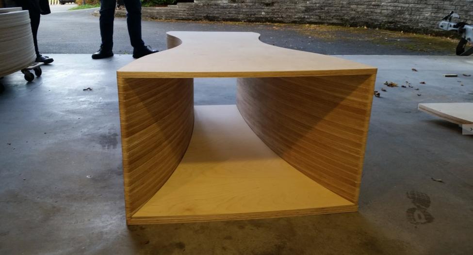

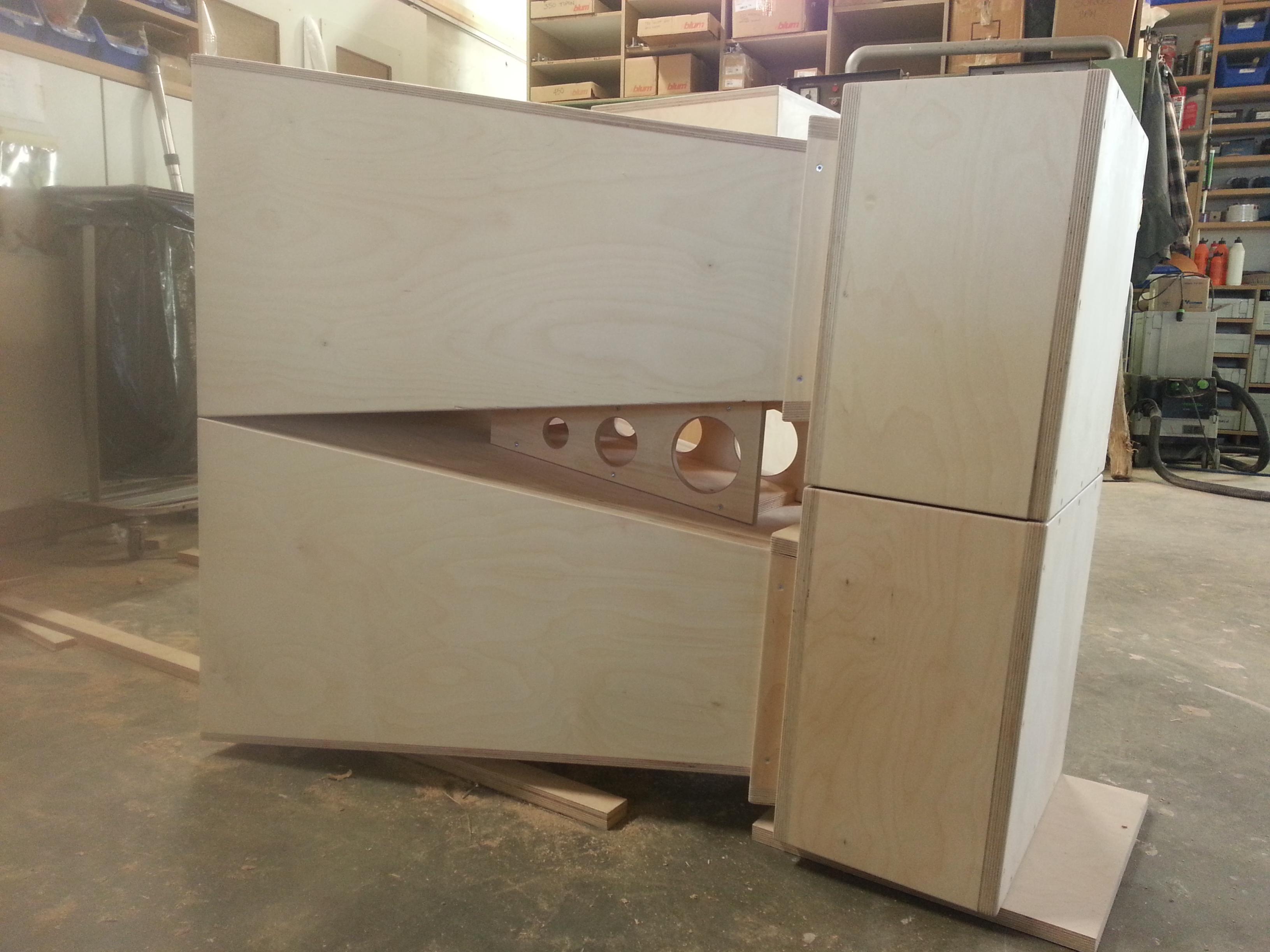

Here's a compact free-standing folded horn design that will cover the 80-800 Hz (one decade) range:
https://community.klipsch.com/index.php?app=core&module=attach§ion=attach&attach_id=7987
Not sure that I would consider the Jubilee a compact size. I prefer folded horns in the style of the University Classic opposed to the bifurcated Klipsch style. The primary issue with the bifurcated style is you get frequency ripples at multiples of the distance between the two exits.
Sounds close to what I've been thinking, but I'd like to get up to 750hz and flat down to 100hz.

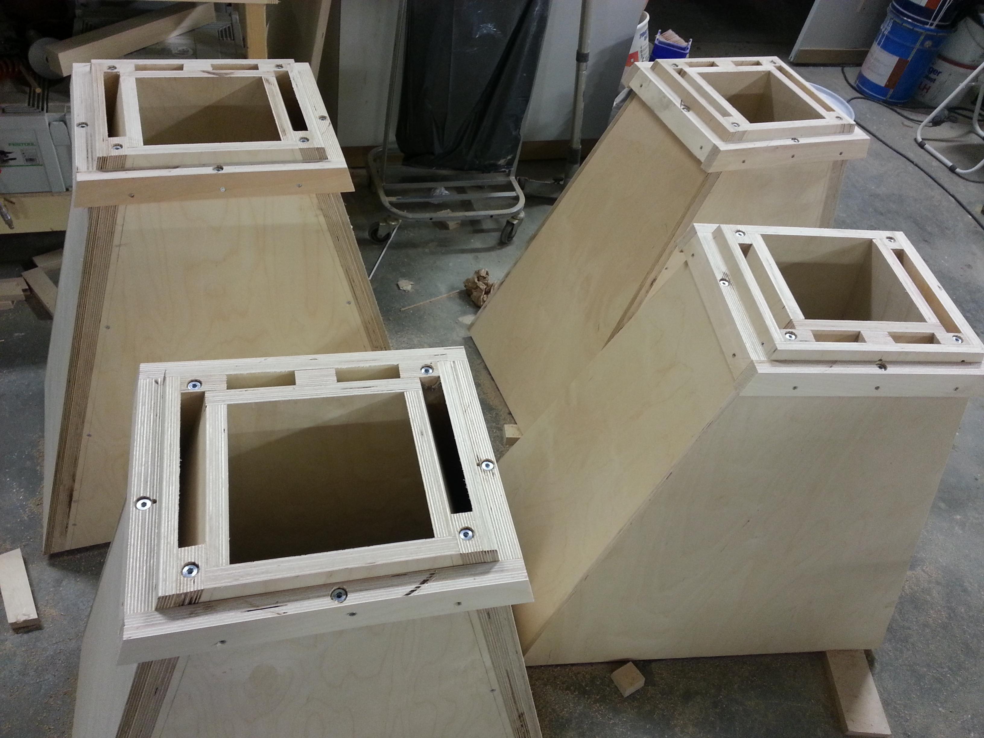

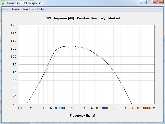

mine are 87cm effective length
throat 20x20cm and mouth 40x70cm
cavities are for sandfilling
stacked they´re flat from 70-550, only lo-passed 24db oct
acoustic hi pass really steep
rear chamber 40x40x20cm
112db
Hornresp basically nailed it
best
Leif

I have not seen a polar map of the Klipsch KPT-XII-MB mid bass horn.I'll take a look at it (the Klipsch KPT-XII-MB). Is there a polar of it anywhere?

I was suggesting using your K-402 as a Synergy horn. To extend the response down only an octave could use small drivers with small port holes, to go down to 80-100 Hz would require larger drivers and larger holes and bass reflex porting.
As you can see in this thread, using some 10" on a smaller horn than yours gets response below 100 Hz, though requires EQ. Your wider vertical dispersion will not load as low as my more narrow vertical dispersion conical horn.
http://www.diyaudio.com/forums/multi-way/262838-synergy-tripp-10-a.html
Since you really only need another octave or so more mid response to work well with your 15"s, it would be quite simple to add four sealed back midrange to the K-402 horn. Hole saw, a little bit of filing and sanding, screw on the drivers, could be done in an afternoon of work, though the driver decision seems to take most of the Synergy builders an inordinate amount of time 😉.
