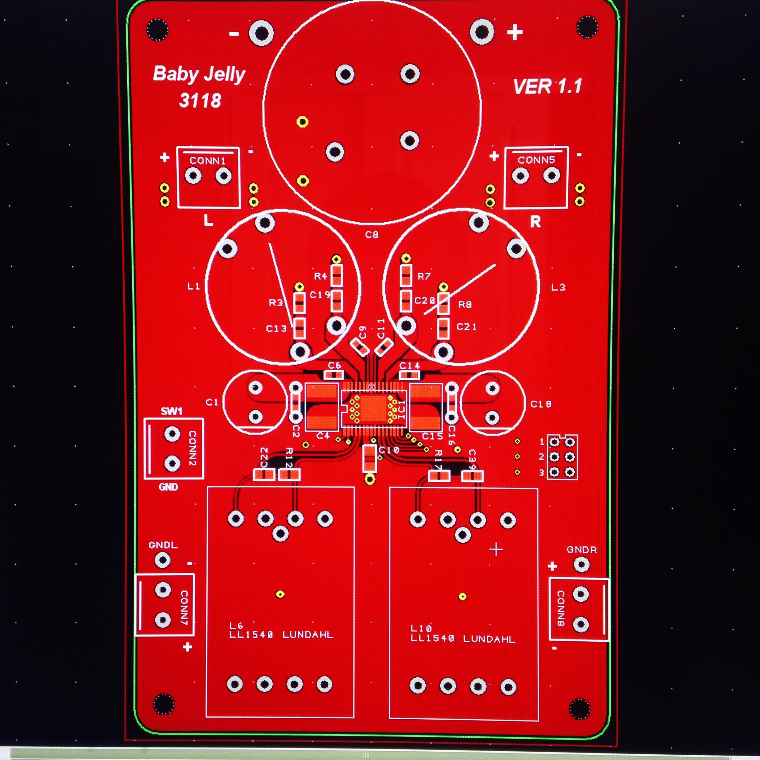

"Proper" TDA3116 PCB

Comparator circuit is the same as I posted earlier. /OFF pulls the timing capacitor to ground, using a couple of diodes and a resistor to ruggedize the input. I'll post it later when I'm home.
Turn-off pop isn't handled, but the turn-off pop is far quieter than the turn-on bang that you get when you don't provide a turn-on unmute delay.
Regarding synch pin - would it make sense to provide for a bypass cap and a series resistor / jumper around the synch pin as shown in the Typical Application circuit in the data sheet (figure 37, page 26). It looks like there is room, and more could be gained if the two vias were rotated 90 degrees clockwise.
I'll sneak those parts in. The datasheet example uses 10K and 1nF to filter the sync signal going from chip to chip, which makes a ~16KHz lowpass filter. With the switching frequency set to 1.2MHz, that can't work too well...
You should be able to get by without synchronizing for most applications. The decoupling design should keep switching frequency content off the power supply. And unless you jam two boards side-by-side so that L1/L2 are practically touching, you shouldn't get any significant magnetic coupling.
My attempt @ a 'proper' TDA3118 PCB.
4 Layer Board with GND on the 2nd layer - 120mm x 80mm
3118 or 3116
LL1540 LUNDAHL
Mundorf 4-pole Cap
Bourns 2200H
Rubycon ST 2220 + 10mm Oscon x 2 + 0603 per side
YMMV.
Dwight
The synch frequency is in the order of 100kHz. The incorrect values have been noted for the next data sheet revision. The suggested values give a cutoff of 720kHz.
TPA3116D2 in 2.1 master/slave mode - Audio Amplifiers Forum - Audio Amplifiers - TI E2E Community
"Yes the RC values need to be reduced. 4.7K Ohms and 47pF would work well. This is already noted for the next DS revision. Thanks."
and
TPA3116D2 ? About slave mode - Audio Amplifiers Forum - Audio Amplifiers - TI E2E Community
"The SYNC freq should be in the range of 100KHz +-10% for optimal operation. The internal PLL will provide the desired PWM siwtching freq based on the AM pins settings."
Added sync components. TPA sync pin -> series R -> shunt C -> via. Current top shot:
power off here is standby isn't it?
Yeah, pulling /OFF low pulls SDZ low on the TPA, dropping the standby current to a couple mA. I could do a lower standby current but I'd want to put the microcontroller back in for that.

I don't think this design needs ground plane slices. I've used those in mixed signal analog/digital/RF designs and SMPS designs, where I've needed to keep things as electrically 'separate' as possible.. that situation doesn't really exist here. All the high power stuff is west of the TPA, no significant current will flow in the ground plane to the right of the TPA, so the analog stuff over there is pretty safe.
