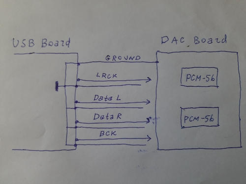

By the way what about a situation with ground loops when we have 3 ground wires (connected to the ground from both sides) between the DAC board and I2SoverUSB board? I mean, could the change in sound be explained by the fact that if I cut connection from these ground wires to the ground from one side only then ground loops are eliminated?
Not exactly. If your claim that the USB board clean power is fully isolated from the dac power is true, and if you cut the three I2S grounds, then that implies there are zero grounds between the USB board and the dac board. According to EE principles, then the circuit can't be working. It can't work because there is no ground return path for the I2S signal currents. Yet you also claim the dac is working, which leaves us an with inconsistent set of claims. The most logical explanation would seem to be that there is an as yet unidentified ground path between the dac board and the clean side of the USB board. It doesn't necessarily have to be a DC ground path, but it at least would have to act as a ground path at I2S frequencies.
I would suggest what we need to do to understand what is going on with your I2S grounds is to shift our attention away from the I2S grounds for awhile and instead focus on looking for that as yet unidentified ground path. That's why I asked you to take a resistance measurement. That could help to understand if the unidentified ground path is DC coupled or AC coupled.

The explanation is very simple. Of course there is one ground wire that connects the ground of the USB board and the DAC board. It is always there. Otherwise, as you stated, it wouldn't have worked and there would be no sound at all.
In other words, there is one ground wire that is connected to the ground from both sides and then there are three. shall I say, shield wires because they are connected to the ground from one side only.
If all four of these ground wires were connected to the ground from both sides then I guess this would have led to a ground loop but when only 1 ground wire is connected to the ground from both sides then there shouldn't be any ground loop.
And one more thing that seems very important. In fact there are only three signal wires between the USB board and the DAC board and when originally I used only three corresponding ground wires I had to connect one of the ground wires from both ends to the ground, say, a ground wire near bck signal wire. In that position the sound was not good. The sound improved only after I disconnected this ground wire from the ground at one end and used an additional wire as a true ground wire which was connected to the ground from both ends.
I hope that I have been able to explain all the situation in detail.

OK. Here is my drawing attached in a file.
As you can see four ground wires are attached to the ground only from one side and one ground wire is attached at both ends. That's all. There's nothing more to draw.
Your drawing does not show how you provide the power to each board. Also I assume there is a digital isolator on the USBI2S board. That needs power (VDD+GND) on both sides of the isolator. How is this provided.

Unfortunately all I can do is connect these 2 boards by wires only. No PCB, Sorry.Yes, those four are shield wires. They have poorly controlled impedance, and a discontinuity at the load.
This would work better if all the circuitry were on a single multilayer pcb.
And as I have been speaking above when I connect both ends of the four shield wires to the ground (which makes them ground wires) the quality deteriorates quite a lot.
