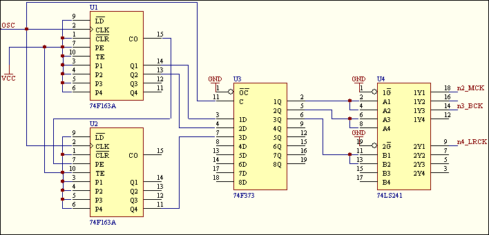

Here is the current iteration of this circuit. The buffer is included so that the rise time of the distributed clock is slower and to ensure Tlh=Thl. A 74HC241 will be used; the LS part is simply for simulation. Any criticism on this setup?
The timing is actually a little tight for worst-case, but I think the 74F logic will be quite sufficient. Looking at the timing diagrams more closely, the latch could probably be omitted, but I think this would open you up to a host of potential timing issues.

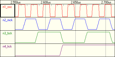

Timing diagram for above. LRCK rises on the falling edge of BCK, as intended. I haven't found any datasheets that require a specific phase relationship between MCK and BCK/LRCK, so I believe this could be a good general purpose clock divider.

Looks good to me, but I trust you for the different connections 😉. Just don't forget to ground unused inputs on the 373. Speaking of that, did you have particular reason for chosing a 373 (level triggered) instead of a 374 (edge triggered) ?
