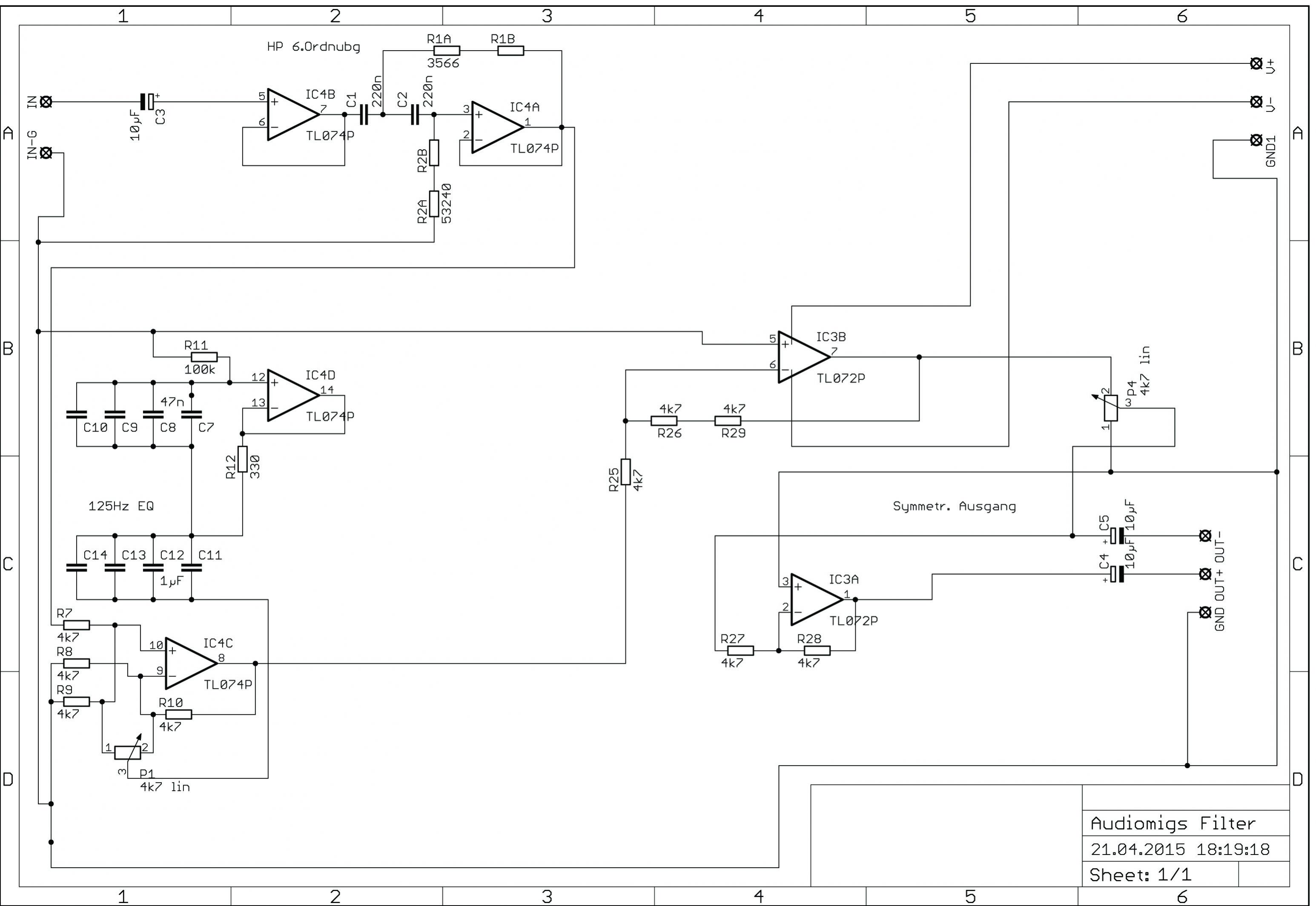

Here you can download the schematic and a calculation program for such a highpass including buffer:
Active High Pass Filter
What Jörg wants you to do is described in this famous paper by Mr. Keele:

Would it not be possible to make the active high pass filter with software like Foobar if Audiomig is using any such thing?
If Foobar can do IIR filters - then yes. A 2nd order highpass with the proper pole frequnecy and Q value would do.

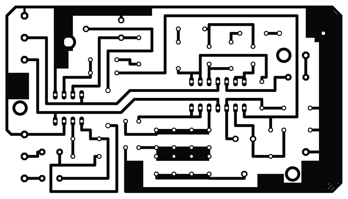

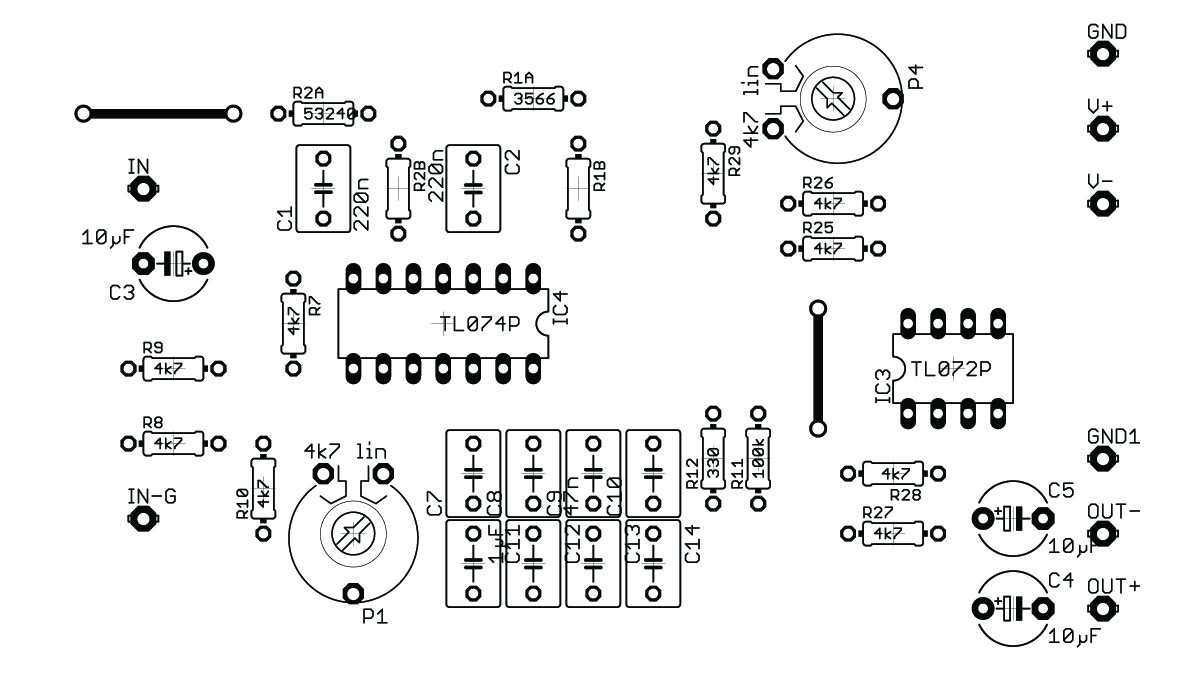

Hello altogether ,
here are the Files as jpeg.
It was not possible to share the EAGLE-Files (sorry they had not the right data Format to post them...)
Burgunder & Phase_accurate woke up my interest fot Foolbar. What is it?
And to Calculate an active (Sallen-Key) Filter i am a littel bit old-school - I take my Book "Tietze & Schenk -Halbleiter Schaltungstechnik" and a simple Excel-sheet.
Regards Jörg.
Regards Jörg.

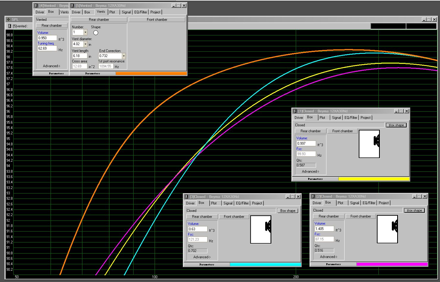

The 12xa30nd 12" midbass with Qts=0.21 using a 1.2-1.6Khz Xover will get the best sound in a sealed, well stuffed box. A large box volume can be reduced by adding wood blocks if some transient tuning experiments are desired. These interior dimensions provide space for 2" of absorption material on 3-walls. Qtc=0.7 tuning is typically not considered optimal for a Qts=0.21 speaker. Golden ratio: 1 x 1.618 x 0.618
14"W x 22.6"L x 8.7"D = 2753 in^3 = 1.58cuft - 0.6cuft for speaker+ bracing+port walls = 1cuft
port = 3"Dia 3"Long 63hz
SEALED = Qtc~0.58 100Hz
15"W x 24"L x 10"D = 3900 in^3 = 2.08cuft - 0.6cuft for speaker+ bracing+port walls = 1.5cuft
port = 3"Dia 2"Long, 55hz... -3db bass-shelf
SEALED = Qtc~0.5 87Hz

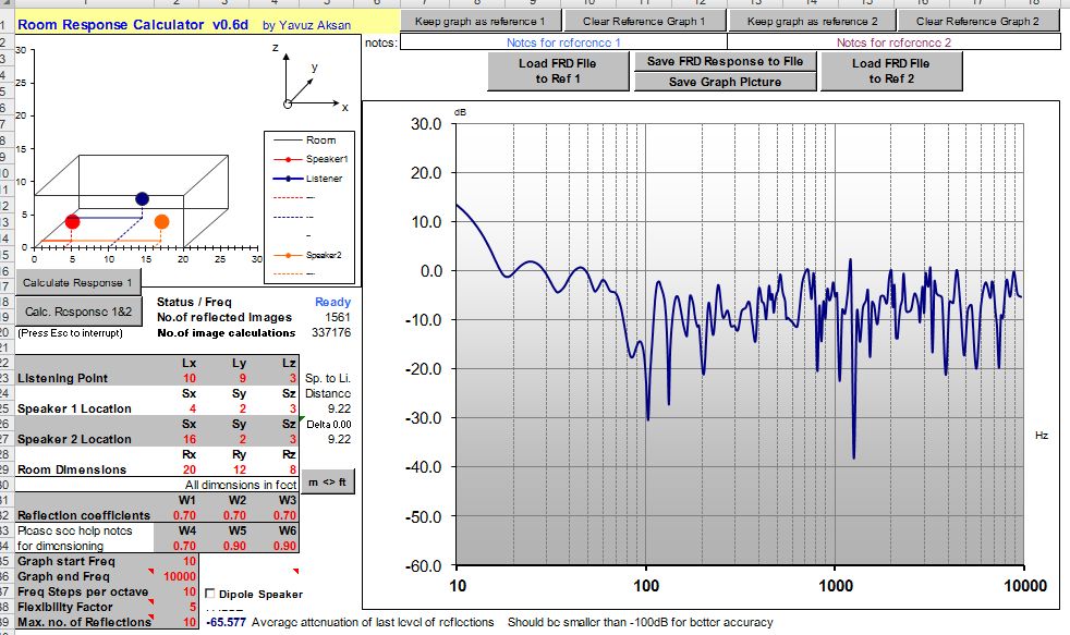

If you run a tool like "Room Response Calculator by Yavuz Aksan" and simulate the best speaker and best seating locations for your listening room, you will observe the large variations in bass SPL, plus wall reflections affecting upper frequencies.

I am planning to go with this configuration (as suggested by LineSource):
38,1cm x 61cmL x 25,4cmD = 59L – 17L =42L
15"W x 24"L x 10"D = 2.08cuft - 0.6cuft for speaker+ bracing+port walls = 1.5cuft

Hi Jorg,
I think I will try your box as well:
36cmW x 46cmH x 29cmD = 48L - 17L (bracing+speaker) = 31L
Port: 70mm Diam, Port Lenght is 91mm.
Active Highpass-Filter based on the filter you have supplied.
Let's see how this will come out ...
