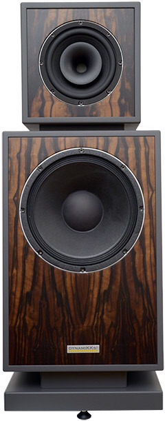

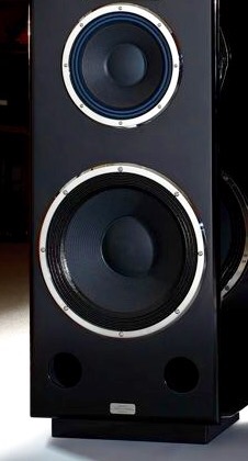

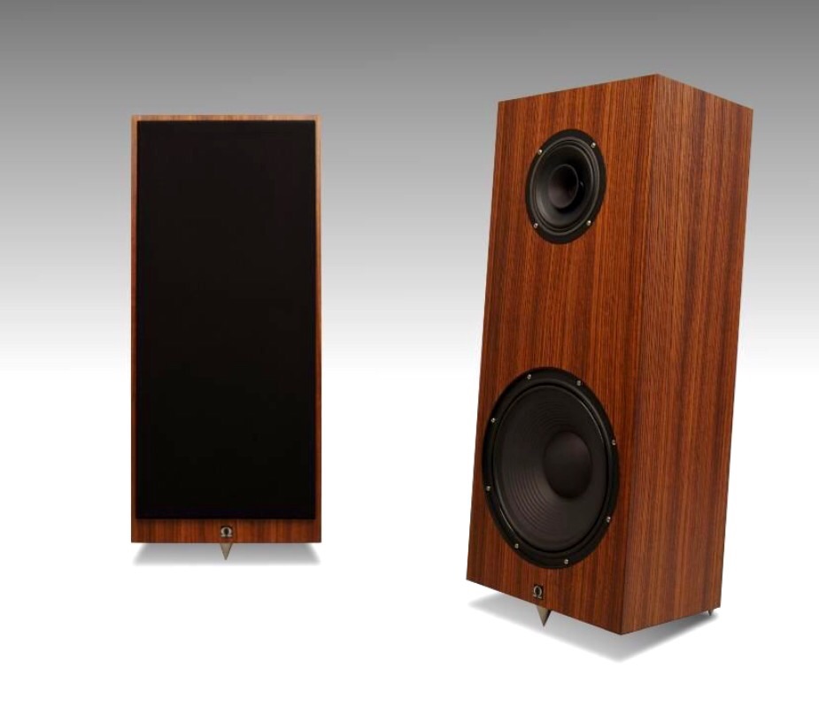

Here are some interesting speakers I like or a representation of.
As Linesource suggested, the modular approach is much better in the long run, enabling me to change and experiment with the T/M module.
And that's the way I want to go, so although some of the speakers are in 'one piece' the objective is to separate the bass from the T/M.

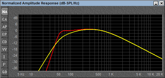

In the beginning of this Thread you wrote about a medium sized enclosure for the 12"XA30ND, you have already Buyed the Speakers.
My reconomation is a Bassrefelex-Enclosure with a internal Volume of 31 Litres.
Port Diameter is 70mm, Port Lenght is 91mm. AND an active Highpass-Filter with a Cutoff-Frequency of 52,5 Hz by a Filter-Q of 1,93.
so the predictet -3dB Frequency of the System will be at ca. 50Hz.
Ok, this is not really a deep Bass but it is well for a 12inch Speaker with high eficiency.
If you like i can workout and post the active Filter for you and Show the result of my Software - howevwe i Need some Time to do this.
Please excuse that my English is not the best.
Regards Jörg

...and before i Forget: Here is the Datasheet of 12"XA30 and my predicted
Response in teh described Enclosure.
Red Line Shows with active High-Pass-Filter-
Yellow Line Shows without.
If you need help for the Filter construction you will get it.

Hi Jorg
Thank you, that would be great.
I don't have a DSP, meanwhile I went to see what what an active filter was. Saw your graphic as well, it greatly adds to the extension of the speaker.
If you can provide me with the schematic for the xover/active filter I would really appreciate it.
