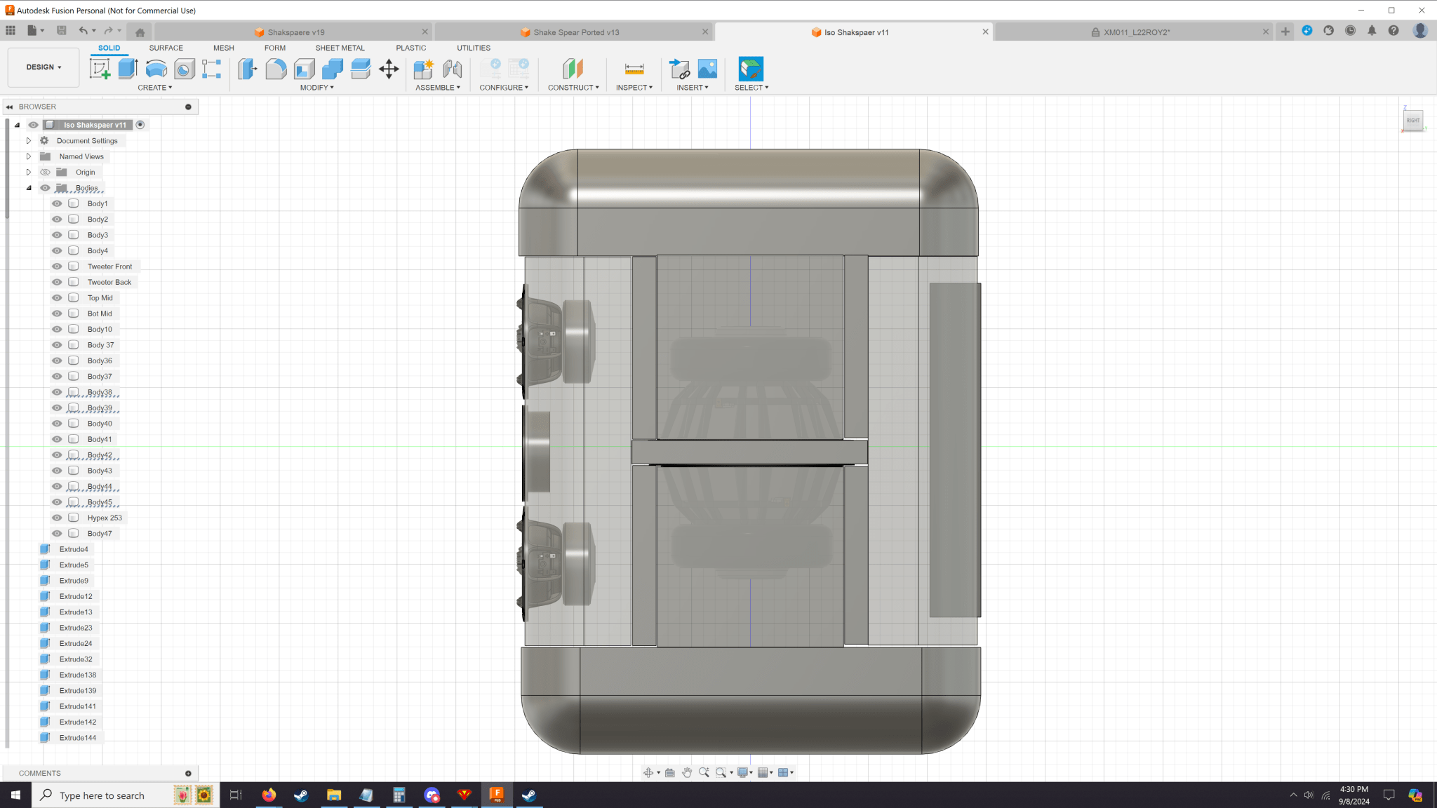

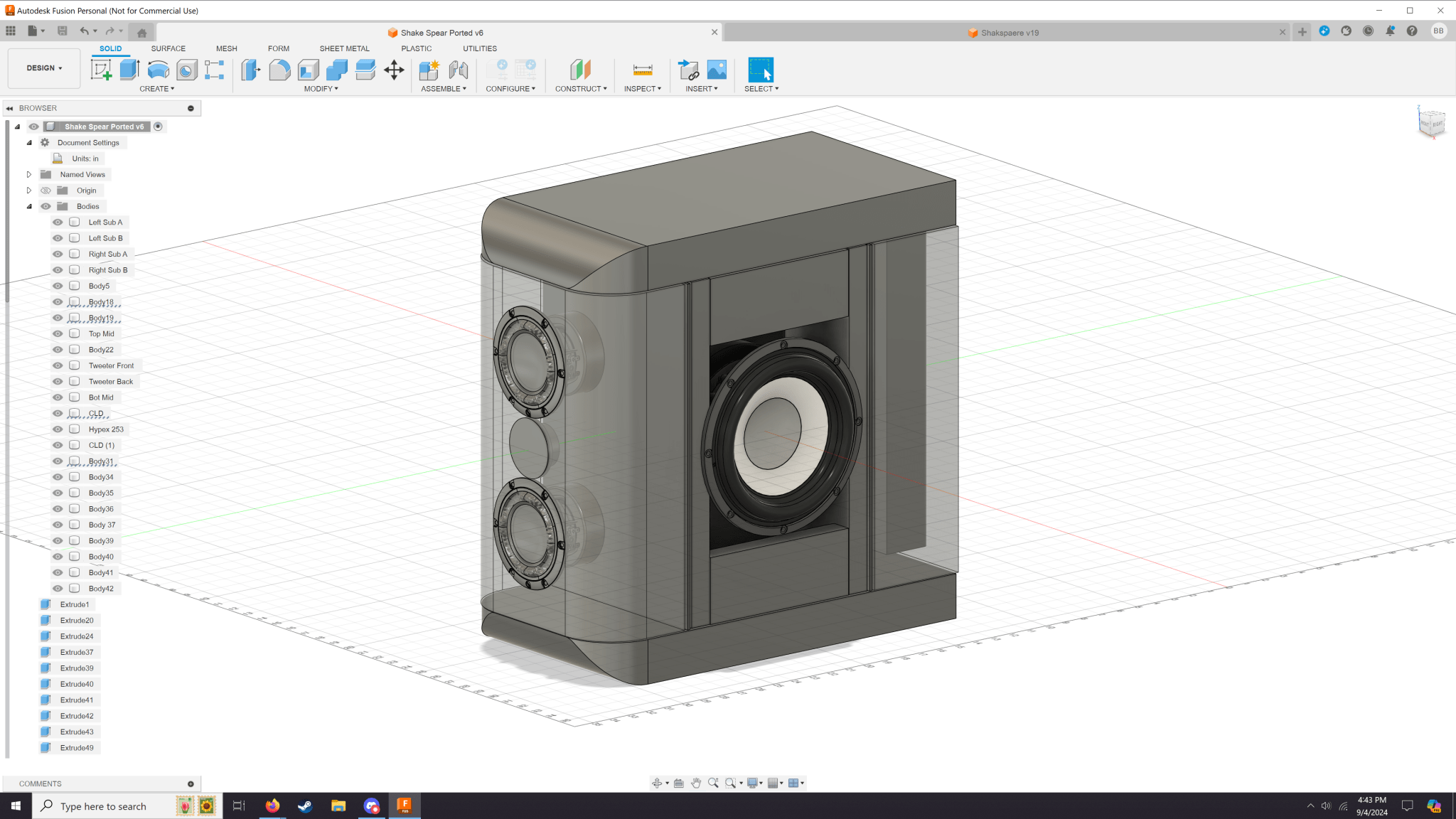

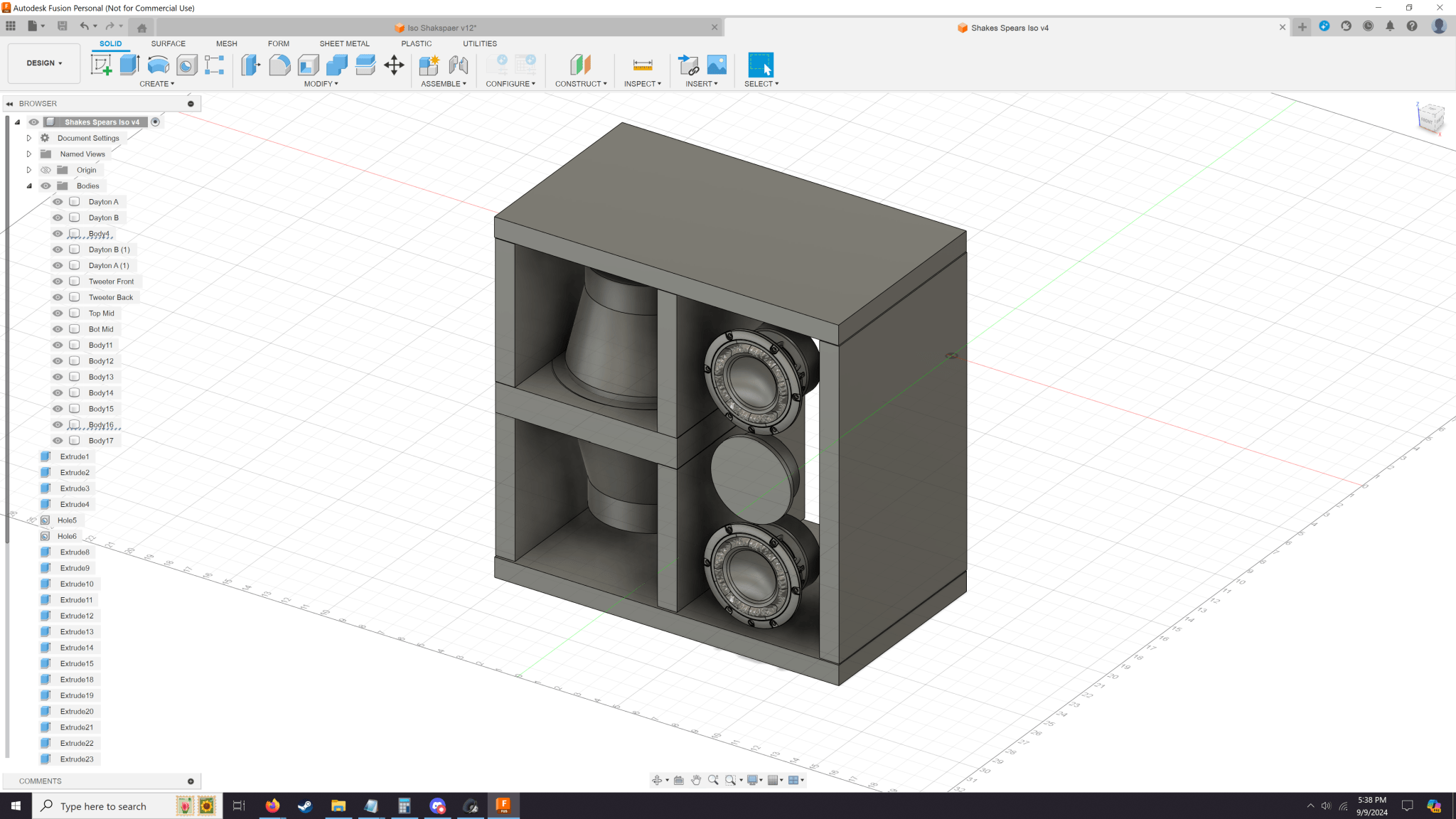

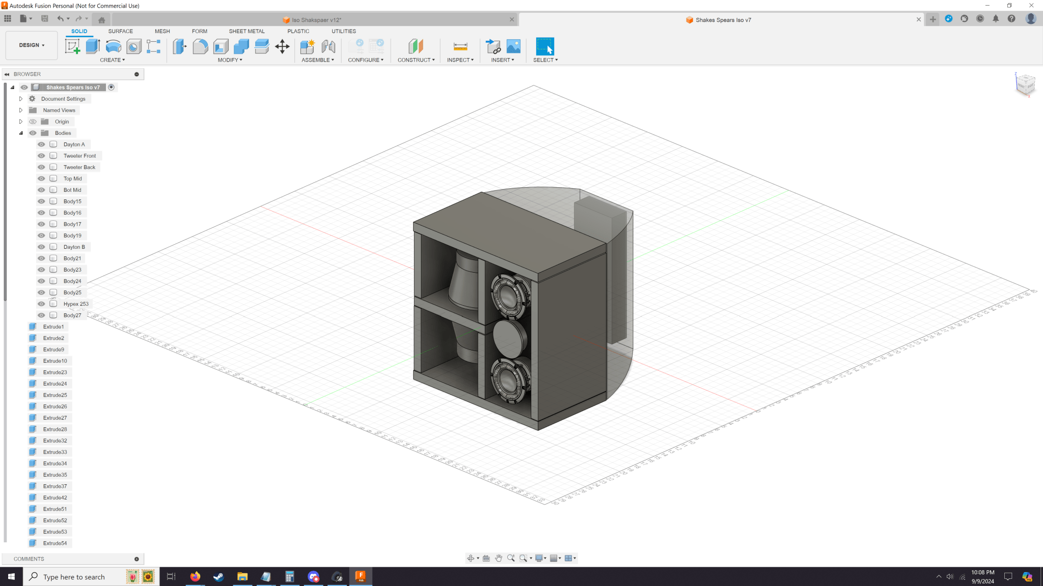

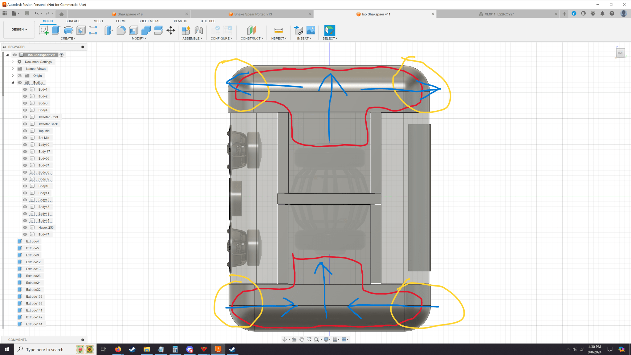

So far so good I think. Still need to figure out what I want to do with the back half. I also need to get the actual volume so I know how much space to leave to get the best I can out of the LF drivers.
My answer to the Vas problem. The top and bottom boxes are place-holders for ports. Other than that, no idea how I would do it other than going isobaric and, at that point, defeats the whole point of having push-push woofers.
An old saying comes to mind while doing this. Trying to cram 10 lbs of... stuff in a 5 lb bag. Now I see why there's more than one engineer who usually works on these things lol

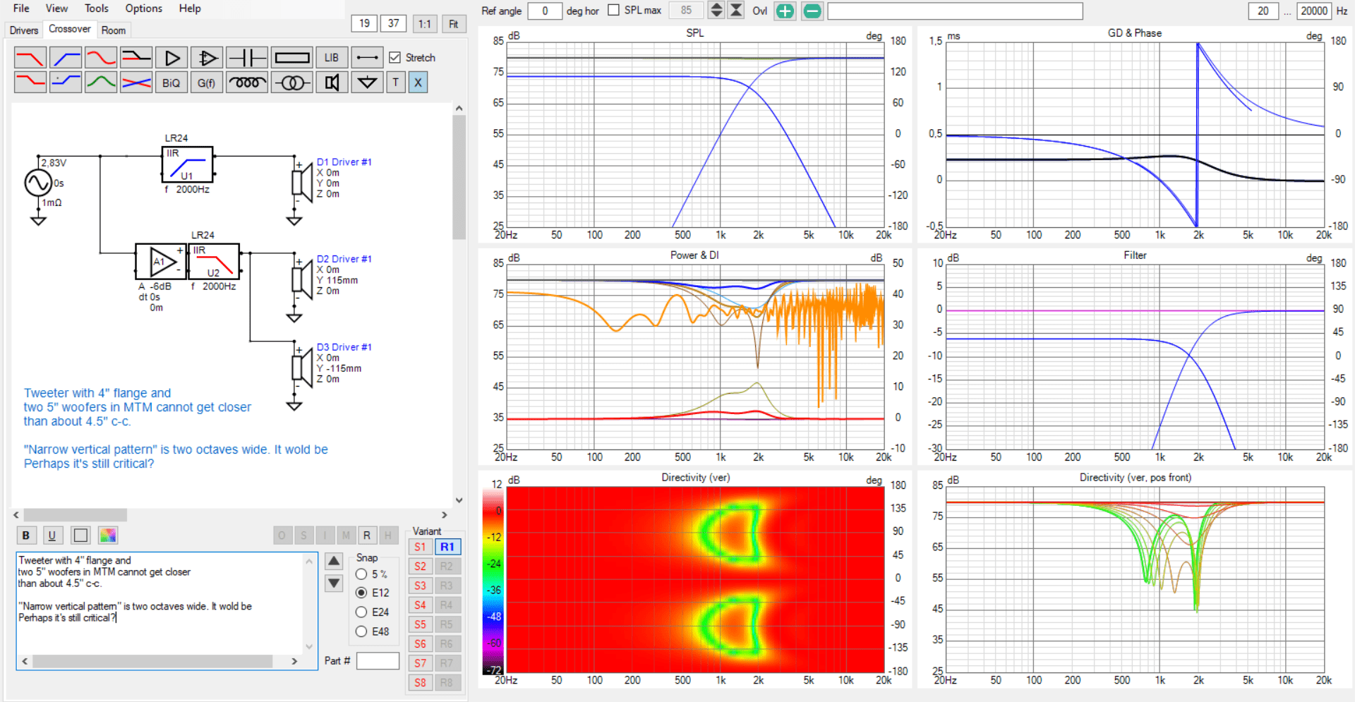

Hi, I didn't read the thread, only this last page 😀 And write some comments on morning coffee:

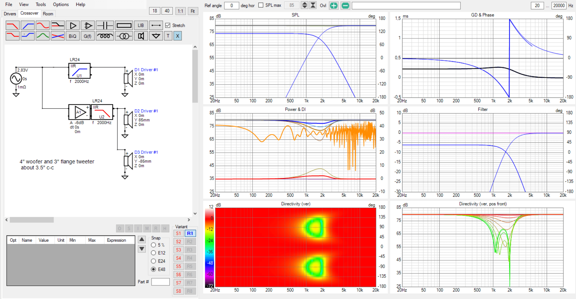

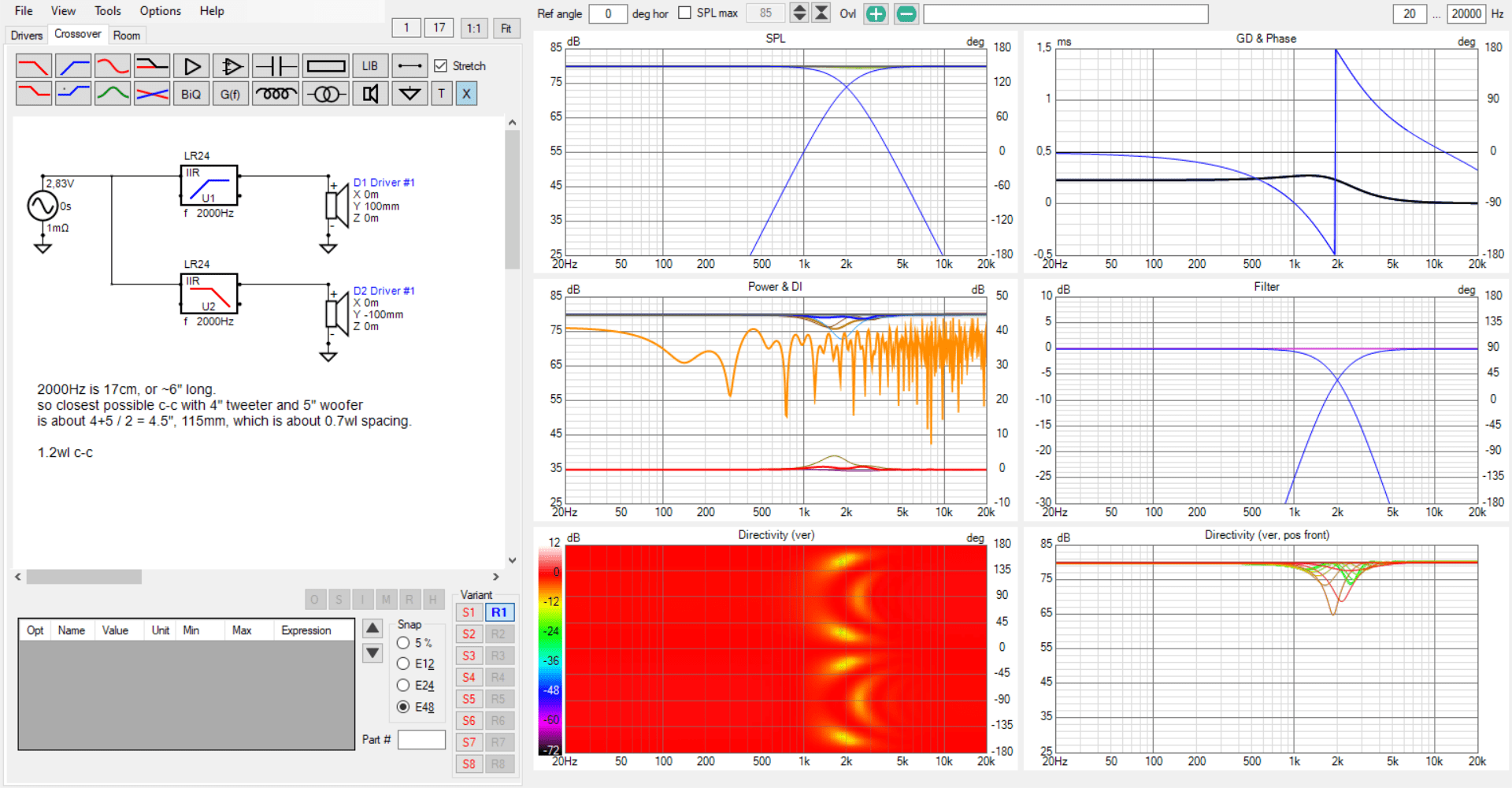

MTM with dome tweeter has only very narrow bandwidth of narrow pattern, which doesn't help that much with any reflections, at least in simulator. So it seems not very logical arrangement.
Also, lobing is just physics and happens with physical transducers we have, if there is a tweeter and it's not coincident with the woofer, because these cannot be close enough physically to prevent it. Coaxials and MEH have it coincident, as well as fullrange driver with possible assisting woofer could do 1/4wl spacing. So, for most speakers there is lobing. If one plays with in a simulator, the graphs actually get better with more sidelobes, iow increased c-c spacing rather than the usual as-close-as possible. DI flattens out. Nulls get closer to on-axis but these seem to be hardly audible on home listening situations, when listening far away compared to acoustics and the early reflections render them less audible. Dips in frequency response in general aren't that audible, not obvious. In this sense fear of lobes seems not logical, just based on fear, and limits design space if bound to it. It's just another design freedom which sometimes is important and sometimes not so much. For example in a nearfield situation one might want to avoid lobing, so then use a coaxial.
This is mostly reasoning based on sims and limited experience, so take as an opinion.

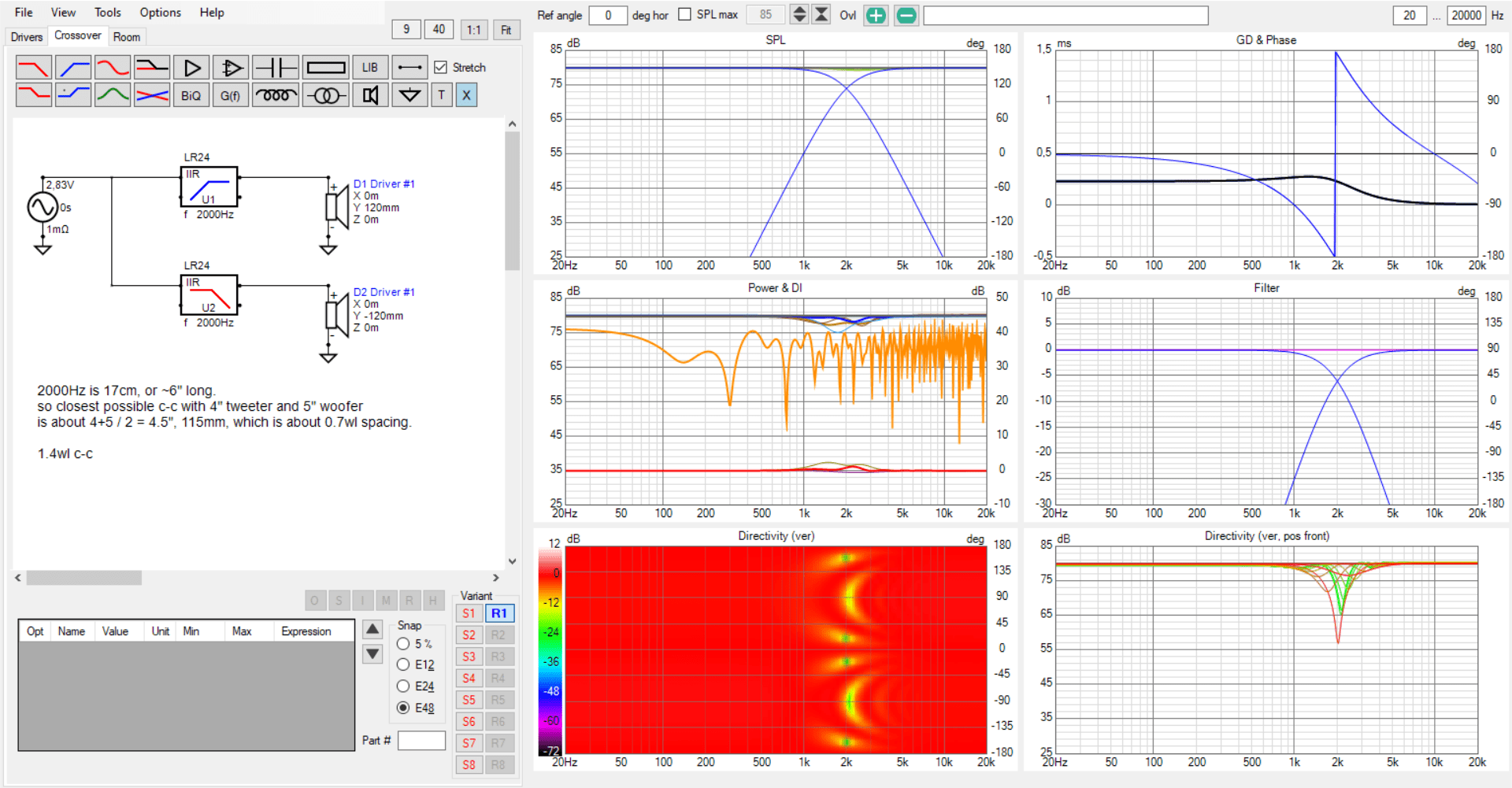

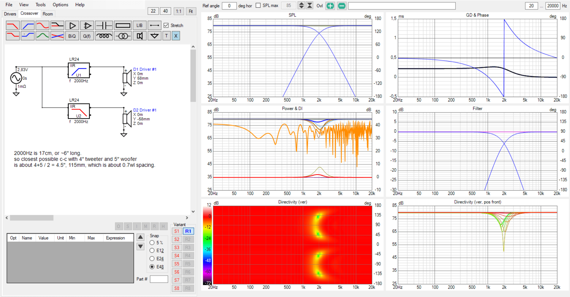

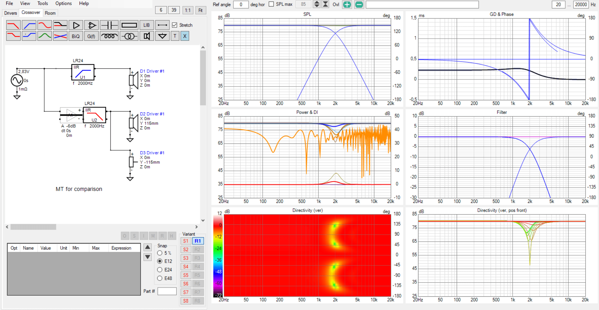

Quick sims with ideal drivers to accompany, MTM makes about two octaves wide bump in DI. Better put this at critical bandwidth where it matters, or does it matter? two woofers increase headroom at least, perhaps the directivity also matters in some use cases. Never had MTM so this is just speculation.
Here effect of c-c in MT. 0.7wl c-c is about as close as anyone gets with 4" tweeter flange and 5" woofer in this case. Next images show when it's increased up to double 1.4wl spacing, which could almost fit another 5" between the tweeter and woofer and it's still about the same, there is lobing and c-c just adjusts which vertical angles get it better or worse, which might matter or not. DI gets better by increasing c-c and adding additional sidelobes.

The solution actually is to switch from the T25B to the T34B. The T34B allows for a much lower crossover point which in turn means more bandwidth for said crossover to occur. This should prevent the typical issues you would have with an MTM. Perlisten speakers kinda do the same thing with their tweeter array, except I'm just using one tweeter instead of three.
Some updates:

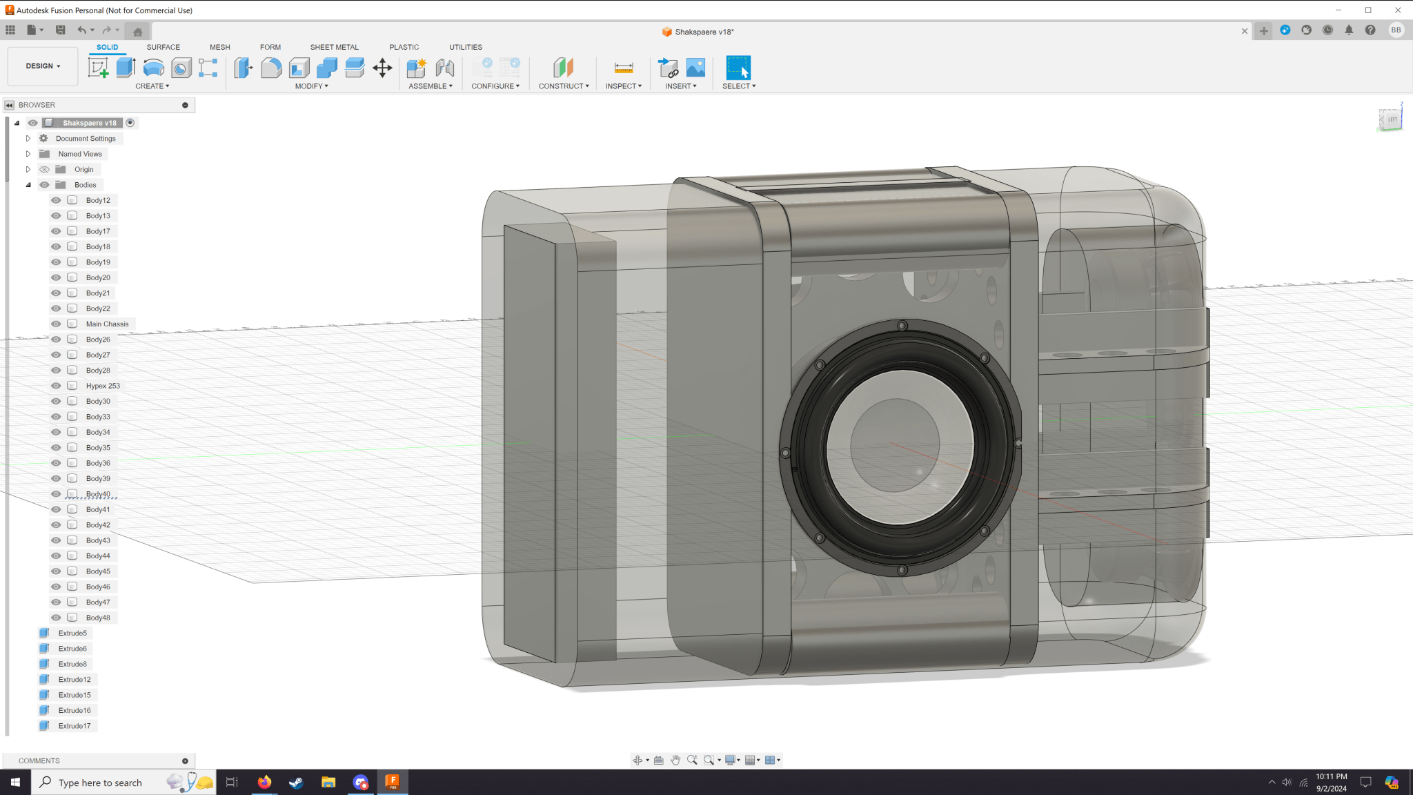

I thought I would try an isobaric design for grins. Half Vas is kind of a nice trade off for 3db. For a smallish build like this, that seems more ideal. I also decided to switch to a different LF driver. https://www.daytonaudio.com/images/resources/295-458-dayton-audio-rss210ho-4-specifications.pdf this should allow for a smaller enclosure space without sacrificing too much in the way of sensitivity (even though it's technically a slightly larger driver.
I was toying with this configuration, but not sure what you would call it. The idea is while one speaker pushes, dragging in pressure as it does, the other pulls with the addition inertia of the bottom driver. When the poles reverse, so does the process. I could also see this not working because of a lack of a sealed volume of air in which the driver can recoil against. Would like an expert opinion on this one.
Looks like a 6th order bandpass with an isobaric driver setup. However, paralleling drivers makes sure that the sensitivity is not lower. Series wiring cannot make up for the losses.

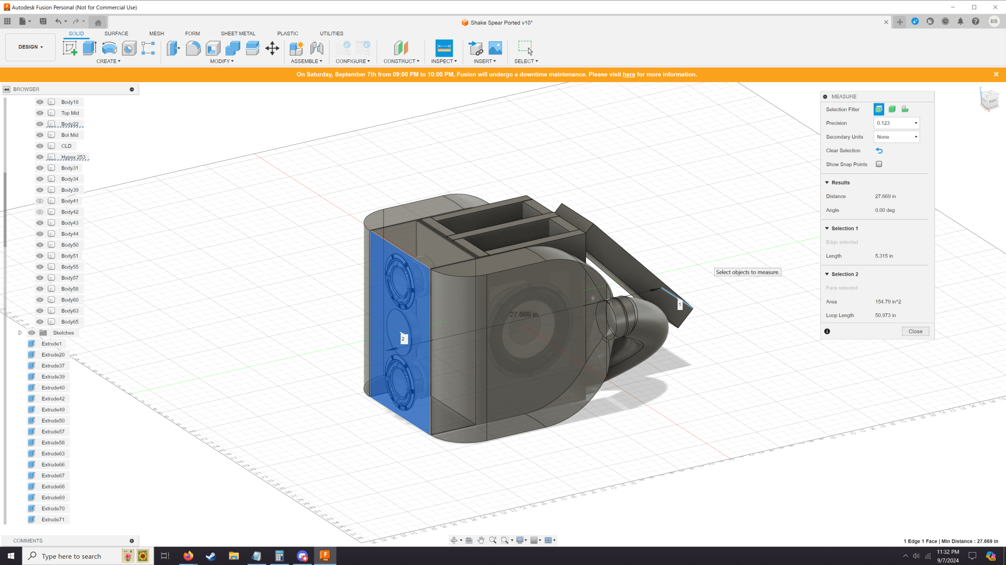

Actually I was just gonna section off the MTM and probably just give the LF drivers enough room to complete the function and only do a single port. WinISD says it liked one port better so that's what I'm going with. It only needs 20 to 30 liters and about a 15 inch port.Looks like a 6th order bandpass with an isobaric driver setup. However, paralleling drivers makes sure that the sensitivity is not lower. Series wiring cannot make up for the losses.
Edit: since I'm going with hypex I can get the 4 ohm versions and tun them at 2
I think this is our winner. A few other things I need to figure out and I'm golden.
1) Port orientation, entrance, and exit, as well as material.
2) Decoupling the MTM mechanically from the chassis (I've read rubber bushings?)
3) Anything else that needs to be done with the subs like flaring out the holes in the front etc.
4) Bracing bracing bracing.
