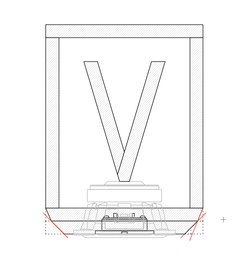

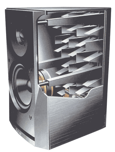

This is an example of sufficient differences in cabinet depth to actually make a difference. The depth would spread the reflections of the back would be spred over almost an octave. B&W would have had to expend a whack of cash for the injection molds to make the back.
With 3D print tech it would be fairly simple to emulate. But as GM suggests there are ways to achieve much the same result using different tricks.
Something like this for instance. Achhievesthe almost 2 octaves of relection spreading, gives room for damping which will remove some reflections creates a short closed TL, and can act as a driver brace. Much more efficent with gross box volume.

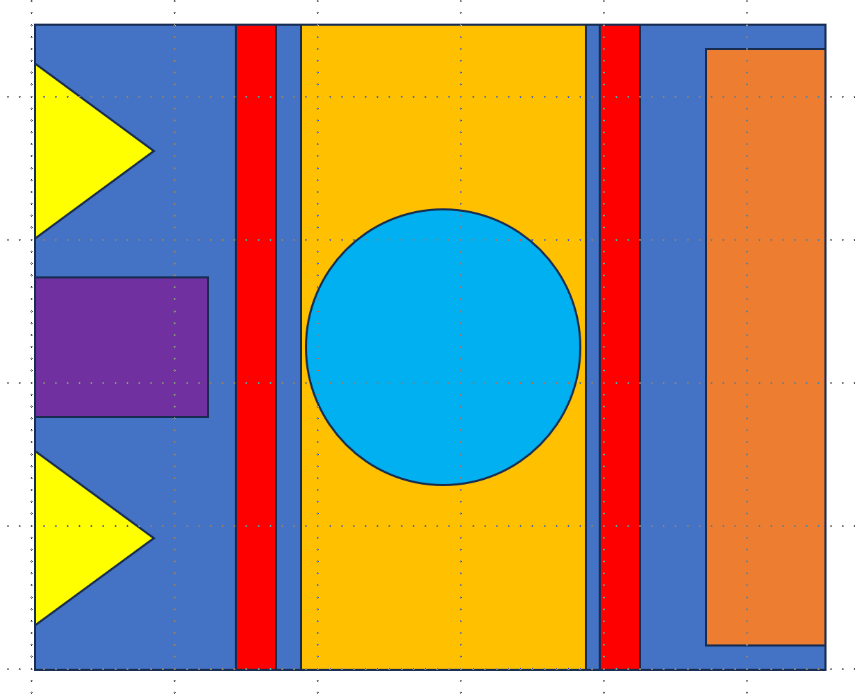

Sorry for the radio silence. Life has a funny way of derailing everything, but I had a free moment to spare so started working on this again.
Here's the revised design concept (disclaimer this was in powerpoint because I didn't feel like putting it in CAD yet so here's a quick and dirty):
dark blue = enclosure
light yellow = purifi 4" drivers
purple = raal tweeter
light blue = x2 seas 8" subs
dark orange = hypex amp
Went back to a simple cuboid enclosure. Although @planet10 's enclosure shape would get me closer to a tear drop shape, the cancellation of opposing forces from the subs wouldn't be symmetrical and would defeat the purpose of dual opposing subs. The red shapes are dividers in order to split it into chambers. This separates the electronics and the mid/high freq sections from the woofers just like the original design. The dark yellow is a center support brace. On the back of the subs are a small metal protrusion (only thing i can really think to call it) as opposed to just a flat surface. The center brace will allow me more surface area to connect the woofers with, as well as providing more support for the enclosure. Still trying to decide on which CLD product to use to line the case with (still need more data), but for the dead space, was probably thinking rebond foam. Only point of contention there is if it will attenuate the higher frequencies or not. If not, will probably just use some shredded denim fill. As always open to thoughts and suggestions.

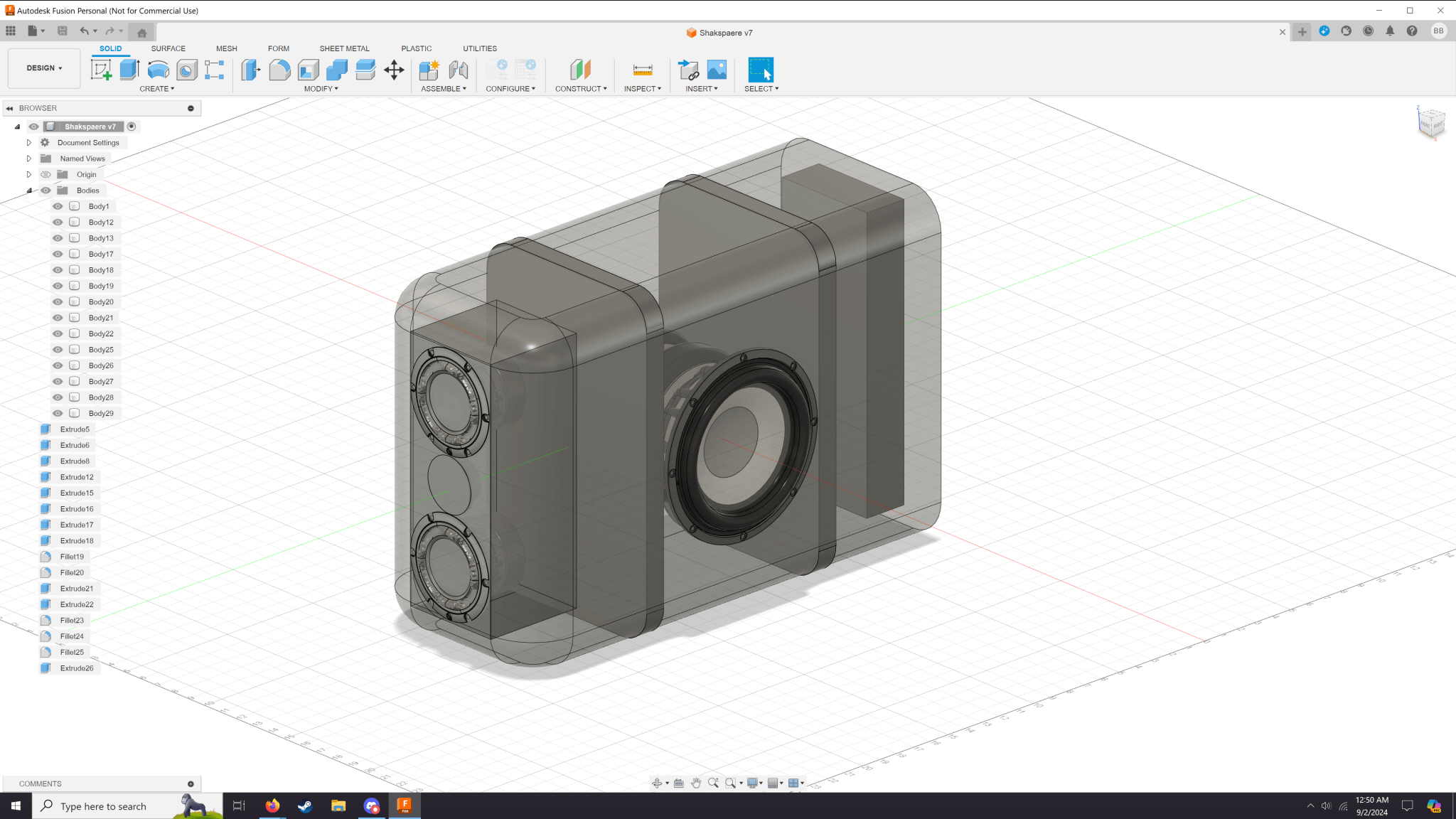

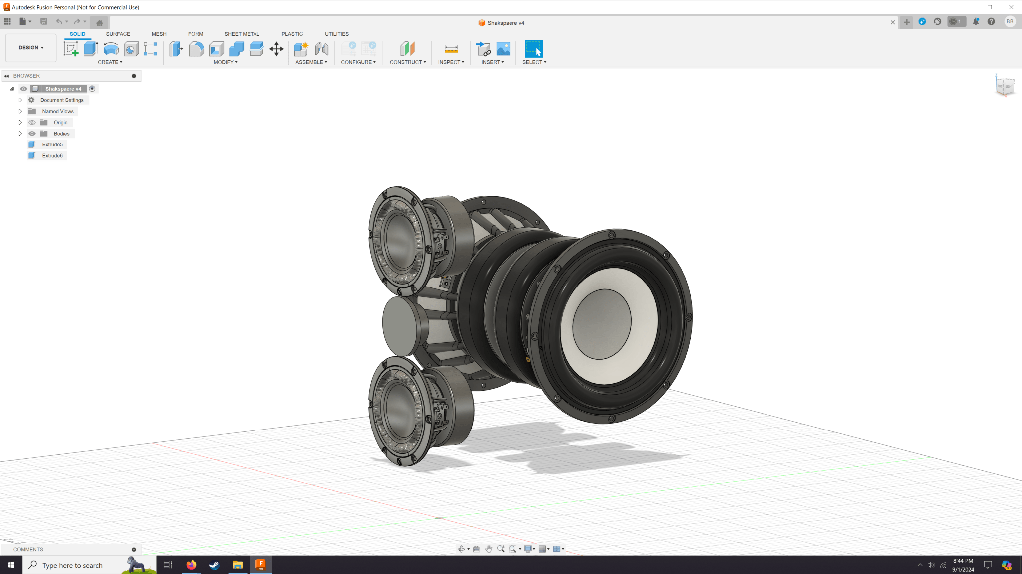

Found a moment for a quick update. Not much, but I'm starting to play around in CAD a bit.
It looks like there isn't a whole lot of clearance so I may need to bring this back to the drawing board again. Additionally, I've looked around and found a few works stating how the RAAL 70-20 works a lot better with some sort of horn. If that's the case, while it wouldn't be too bad to recess the driver to make the horn, it would force me to pick different drivers for the side firing LF drivers because of how far I would have to pull it in.
Another idea is I could revisit the "electronics in the stand" idea and just take the DSP out of the equation for the enclosure. That would probably allow me to use my current pick for the LF drivers, but would probably have to look at using a different layout for the internals.
Also, shout out to Seas. They didn't have the step file for the L22ROY2 on their website, so I shot them an email and asked them if they would post one. Looked at my email this morning and found a CAD file waiting for me lol

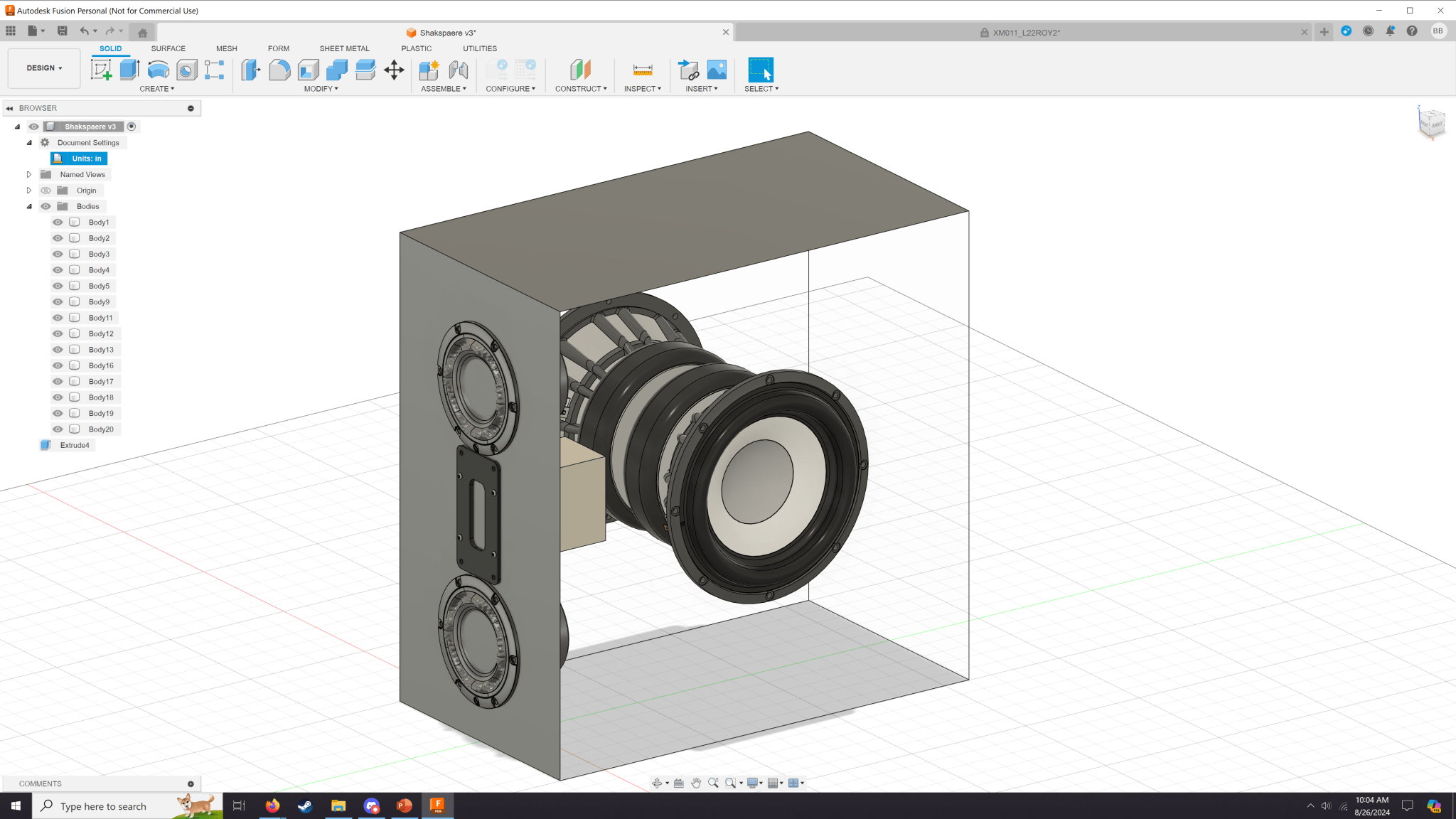

So a few things:
1. It is with a heavy heart, but I think I'm going to switch out the tweeter. I notice I'm having to jump through too many hurdles in order to accommodate the RAAL. I remember a while ago a post from @xrk971 ( https://www.diyaudio.com/community/threads/raal-70-20xr-and-ptt6-5-compact-tl.356906/ ) a lot of the issues. Directivity especially since making a horn on a small(ish) speaker kind of defeats the purpose of it being small. Another big issue is simply its size. It would be too difficult to create a separate MTM compartment within the enclosure using the 70-20. All this considered, I will most likely be switching to the Bliesma T25B tweeter for its size and performance characteristics.
As you can see here, it's far easier to design with the Bliesma than it is with the RAAL. It's a bummer, but that's kind of what engineering is about: finding optimal solutions to a given problem. In this case, the Bliesma is simply the better option.
2. The enclosure design I would still like to have very few diffraction points. I'm still scribbling away trying to figure out an overall design for it. One thought that crossed my mind is swapping out the L22ROY2s with a set of Purifi 8" woofers. This would allow the enclosure to overall have a smaller cross-section, but I'm not quite sure on the swap. The Seas woofers are made specifically for LF work, where as the Purifis can perform up to much higher frequencies.
3. Since I don't have all the tools available to me like I used to, I'm still trying to figure out how I'd like to proceed on assembly. I've had a few ideas on how to approach this, but all of them still require me to have tools on hand. Maybe I should just suck it up and start from square one again and get some basics like hand tools, clamps, etc. Another idea I had was going the 3d printing route and do it in parts, but I'm not so sure on that one for a lot of reasons. Again, still just spitballing on this, but first thing's first I need to finish the enclosure design in order to figure out how I want to make it.
