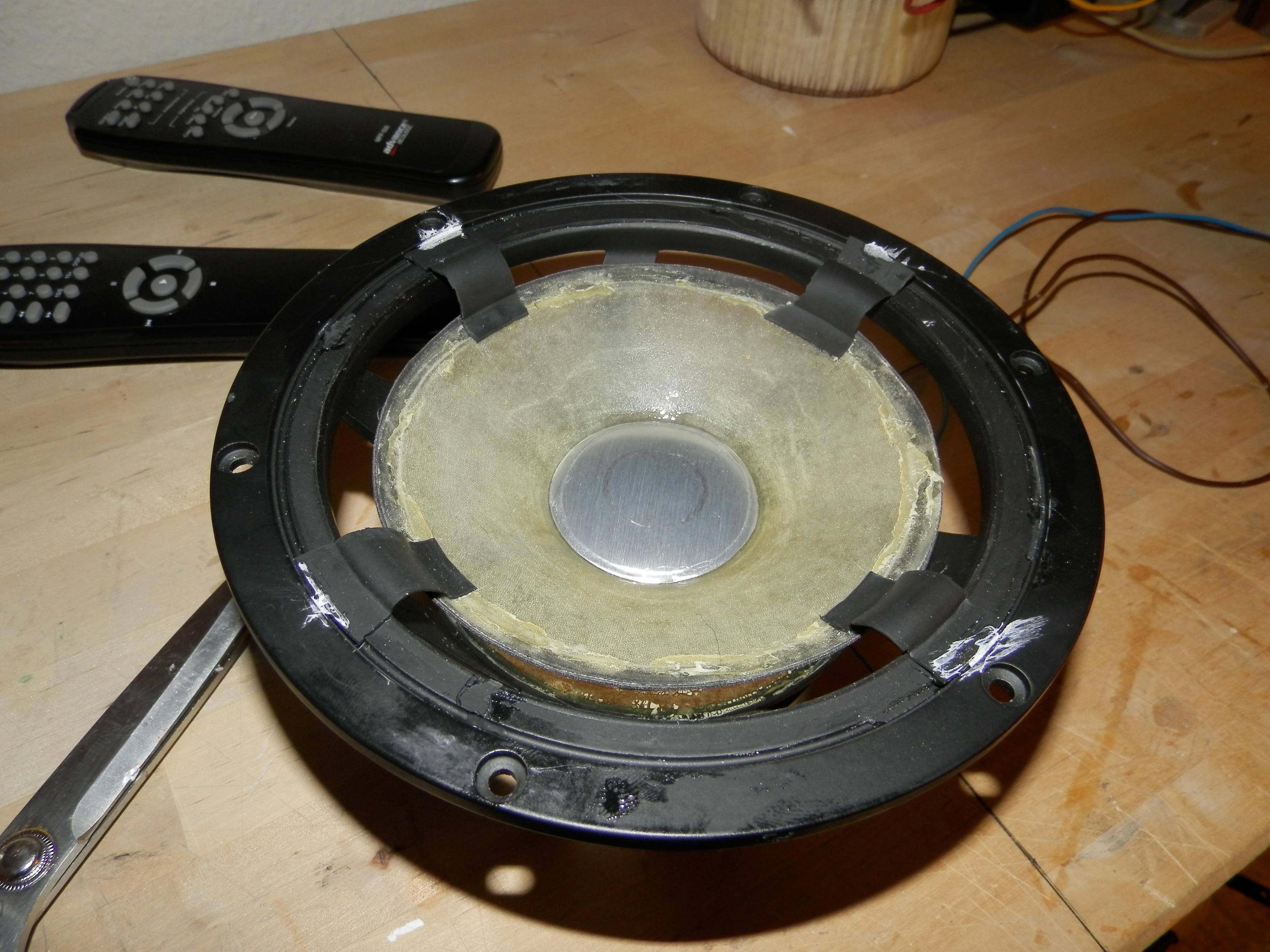

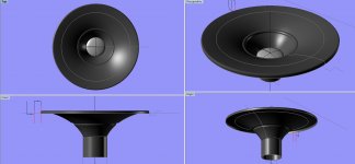

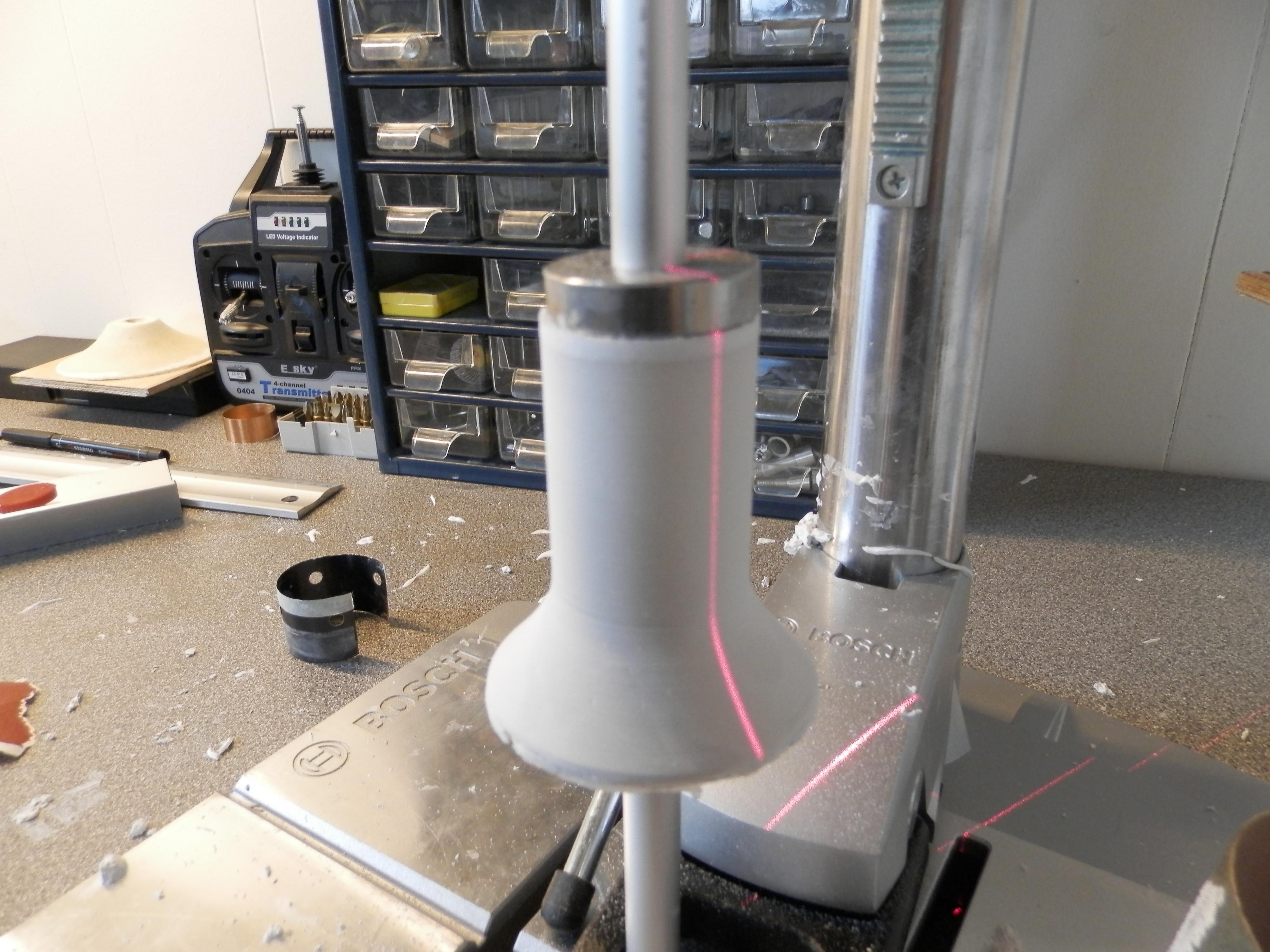

Some notes:
It was noted that the surrounding of the my unit was to thick, so I removed most of it. There was no audible changes ta all, (I have not access to any measure devices).
I added a aluminium cone to the membrane, this give a higher output at high frequency, more or less logical...... It increases the areal in the centre of the membrane. Buy the way the cone was made from the bottom of a beer can😀
I have decided not to try to make the unit without a spider.....due to the softness of the edge of the membrane. Instead I will bend the edge abut 90 degrees, to make it mechanical stiffer.
At the moment I am trying to make a wizzer with integrated voice coil. Here is some pic's.
