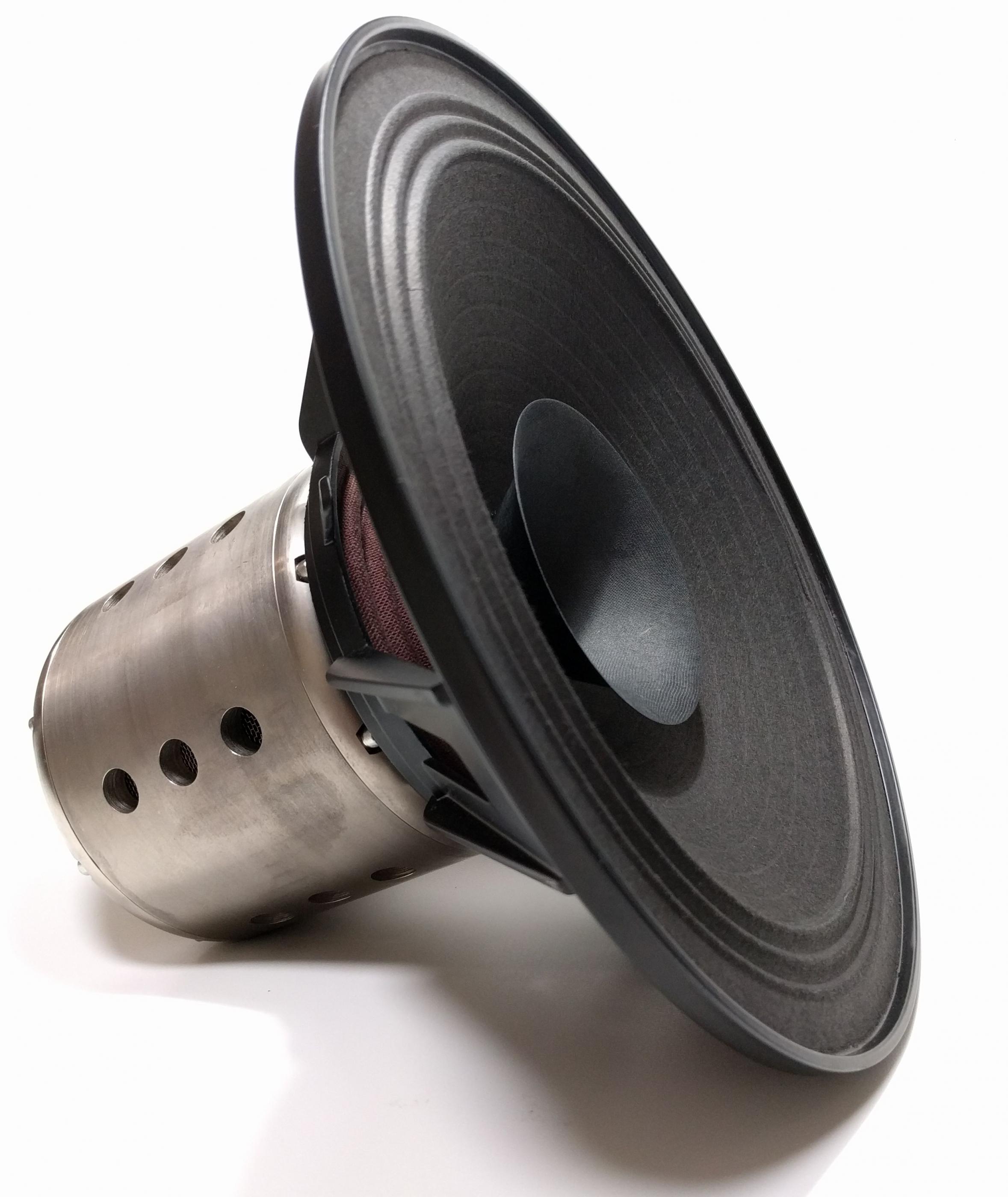

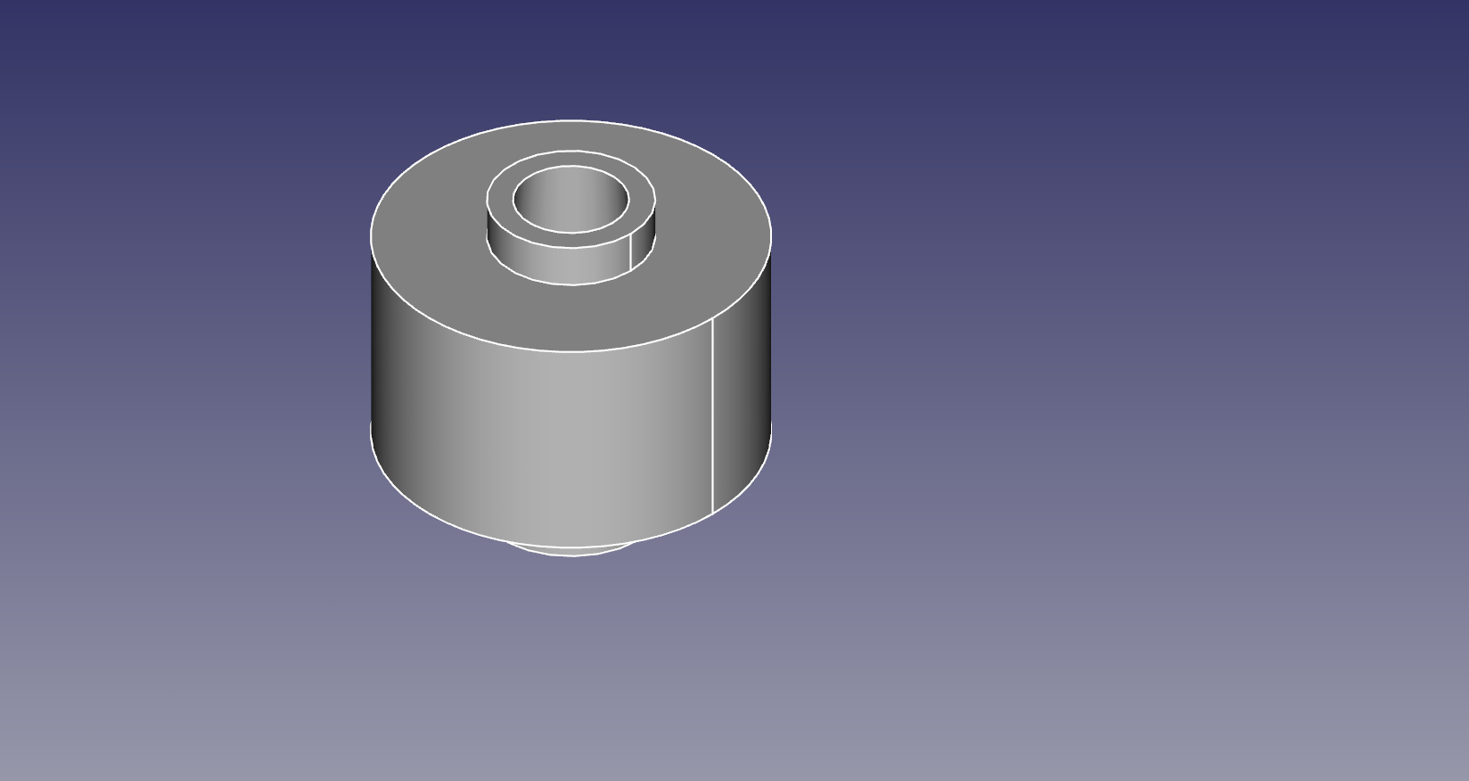

A little update for BillWojo and the 808 field coil conversion. BillWojo provided measurements of various parts of the driver and I was able to make a fem file. In the attached archive you can find it along with a stl file for central pole piece. This is a temporary design though so treat it as is.
We will refine the design more until a final version is ready but just wanted to share it here.

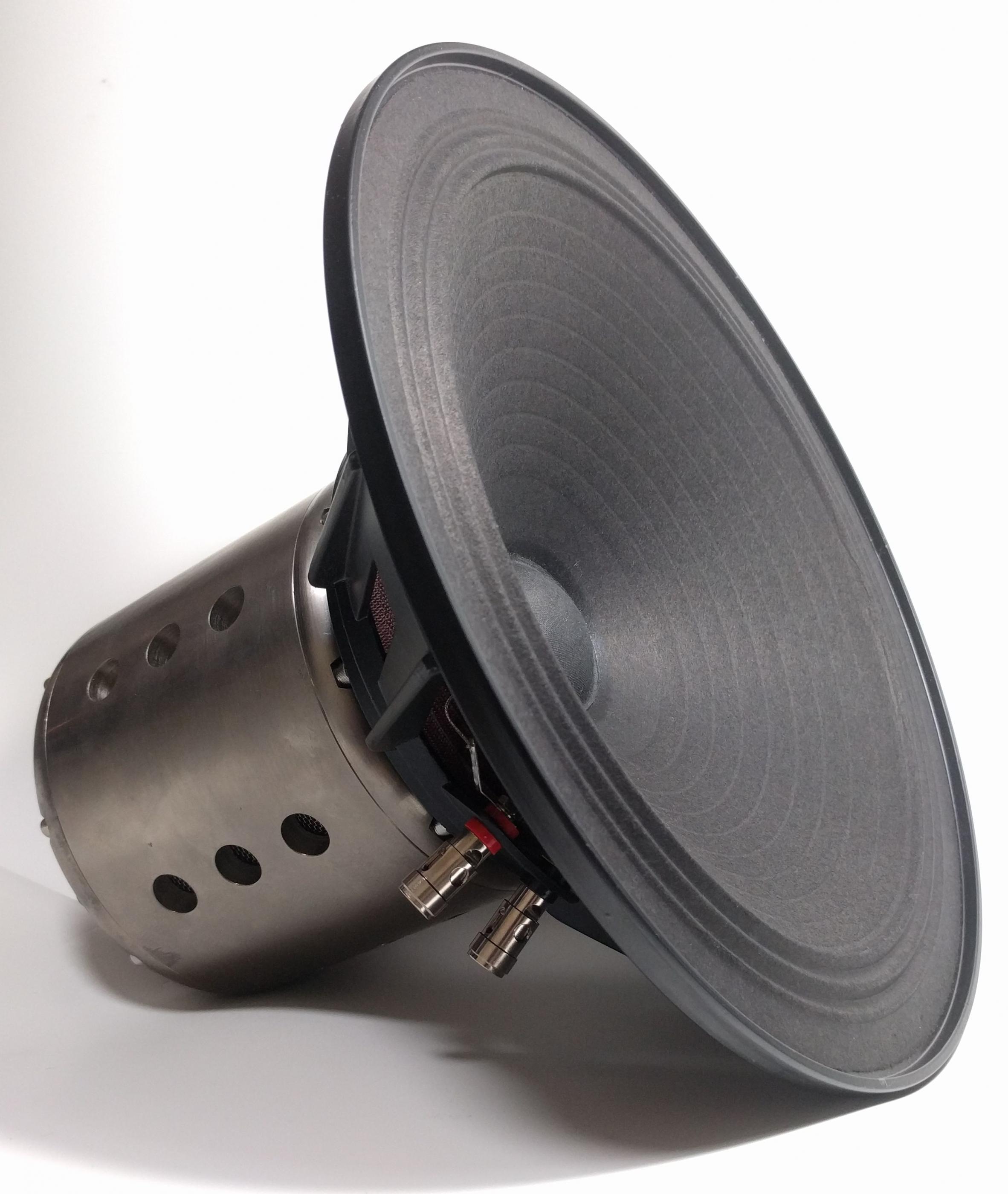

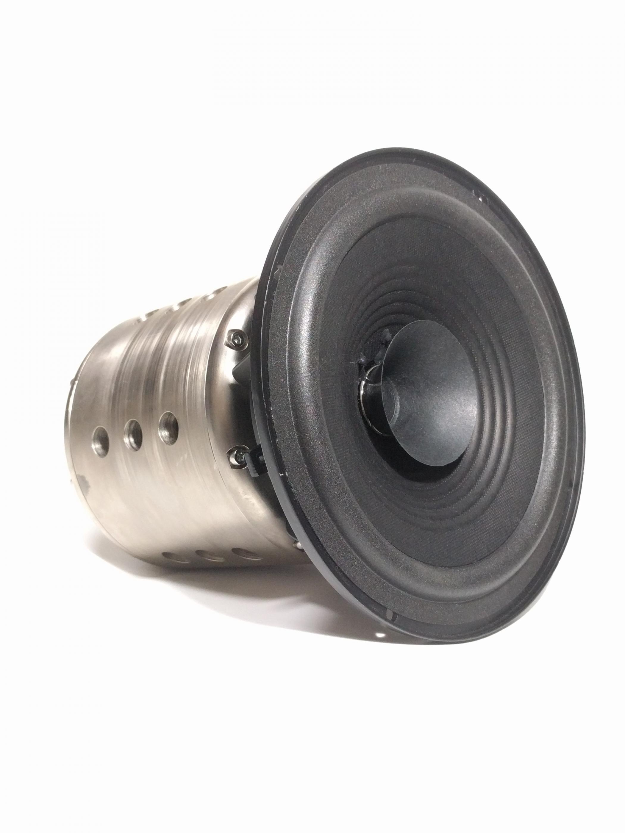

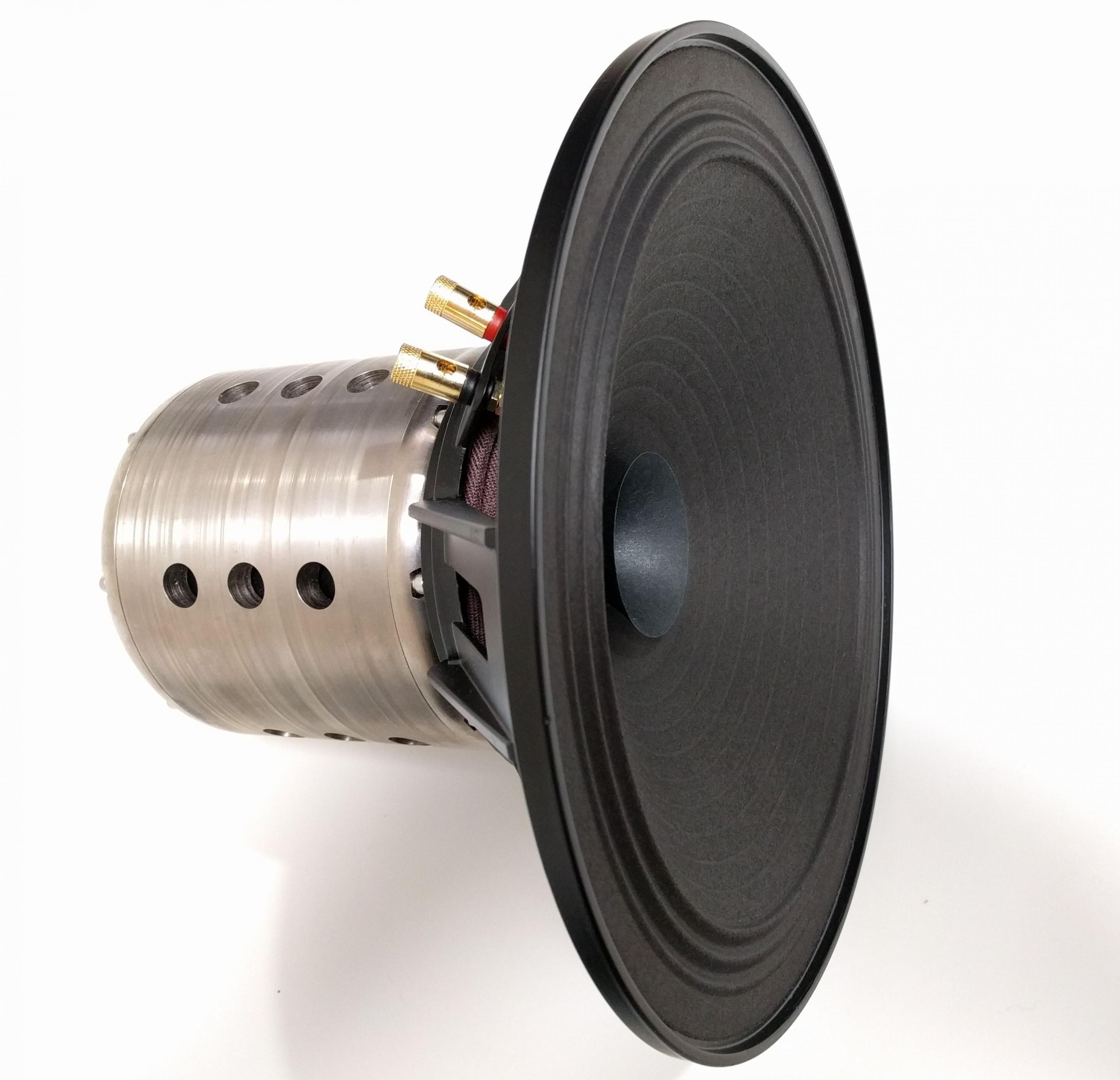

F144 based 12" drivers are pretty much done. You can check the datasheets and DIY files in the links below. I have 2 pairs available if anybody desires to purchase them assembled the price is 490USD/driver.
I am also attaching a picture of an upcoming 8 inch version.
