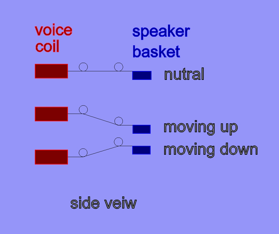

I have made some changes for the spring system. With the other system I would get tension energy at the joints, due to the twist of the spring when moving up and down. This is massive reduced with the new two loop springs, this will keep the two spring- joint close to 0° angle when moving becouse most of the flexing will be between the two loops. See picture.

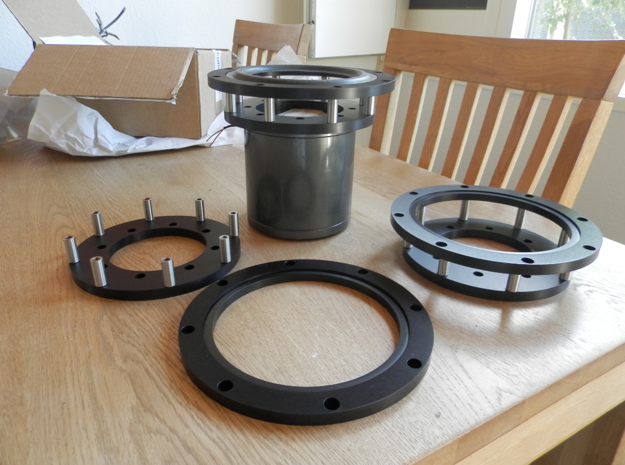

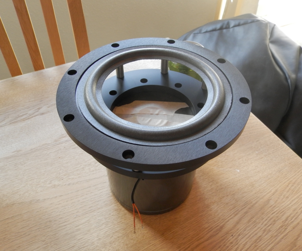

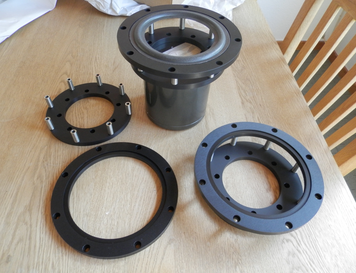

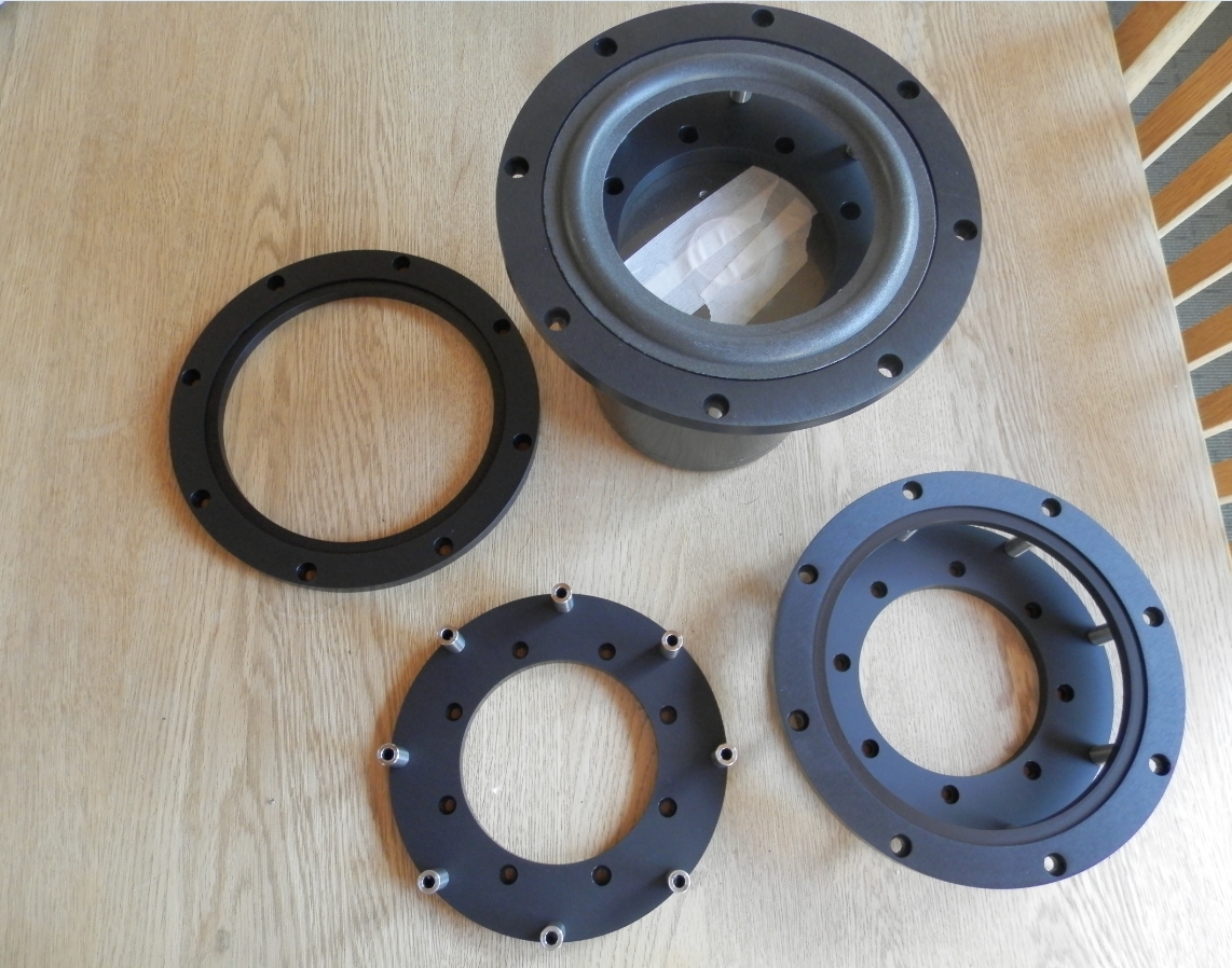

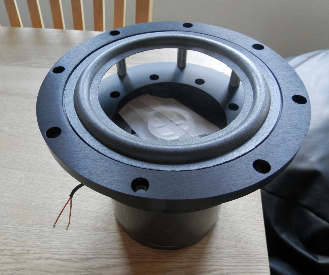

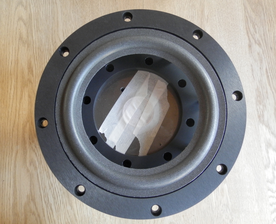

Just pick up the parts for the basket for the unit, man I am exited.... It is made from 10mm aluminium and the spacers made of stainless steel, they should be able to hole the field coil. Here is some pic's.

Very nice Frank. I like this frame design a lot. Much stronger then a normal frame. Looks cool too.

Have pondered about using the two spring system myself. Do you think it necessary to connect the loops to say carbon pultruded tubes or carbon ribbon on edge would improve action by forcing the bending moment only at the springs?
Also using two springs per joint each turned opposite to the other when attached as mentioned above zero's out torque twist and giving you exceptional lateral stability a single point of a three point mount could never achieve.

Well I am no expert in spring suspension. But if you use carbon tubes you will ad a little bit of weight, but you can use the carbon tube to adjust the compliance of the springs that is a nice feature. A good thing is if you glue the carbon tubes to the voice coil former, you will have more surface and a better connection to the voice coil former.
Using two springs turned opposite to the other is a great idea, and considering the low mass of the springs it will give you no problems.
Hentai, Yes the 8 holes is for mounting the unit in the cabinet. 8 times 6mm screws should hole it in place.
Take care
Sorry Hentia, I misread you question... the answer is no. There are 8 separate holes for mounting the unit.

May I ask what kind of unit are you building, if you have some pictures it would bee great if you would post them here.

I haven't looked into using fishing line in decades, would need to look into the new formulations available today. Hopefully they would be better behaved now than then when heated. Slowly creeping up on the temp and lowering it to form the loop. I would think very fine spring steel would work better. Don't know of anyone that makes springs from carbon tow at this scale LOL
Tangically attaching them in a V should help. Have these loops oppose each other along the length.

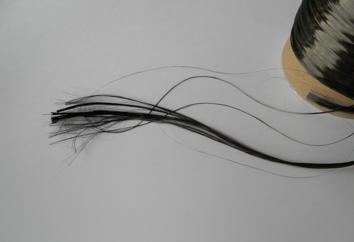

You gave me an idea regarding carbon spring, why not make my own. I got some carbon roving.. each fibre is 7 micron in diameter, so it is just a question of taking the right amount, adding resin and put on a former. Got to give it a try...
