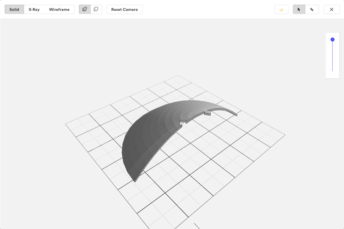

I'm not far from ordering the 3D printed 500mm wide parabolas and I managed to make it quite cheap.
If I'm alone, it's 22€ but if we're 3 of us it goes down to 12,5€ per person for the full parabola.

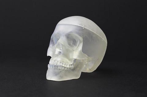

I planned to do it in clear resin because it leaves things open for the decoration ( I attached an example).

I'm surprised the price is that low for 3D printing. In the U.S. I'd expect a part that size to be 5 times that or more, depending on the material used.
The clear SLA items I've had printed have yellowed over time. It might be worth asking about the light stability of the material if you intend to rely on its transparency for decoration. There are newer materials out that might do better in this regard, so it may not be an issue.

Ok my bad, I did some changes on the unit on Blender and it changed the model size, price is not relevant anymore, sorry for the late night enthusiasm...
Enthusiasm is in short supply these days. It's nice to see someone operating with some.
I've also had issues at upload where the imported size is off by a factor of 10, so I try to check scale carefully these days when having parts printed.
