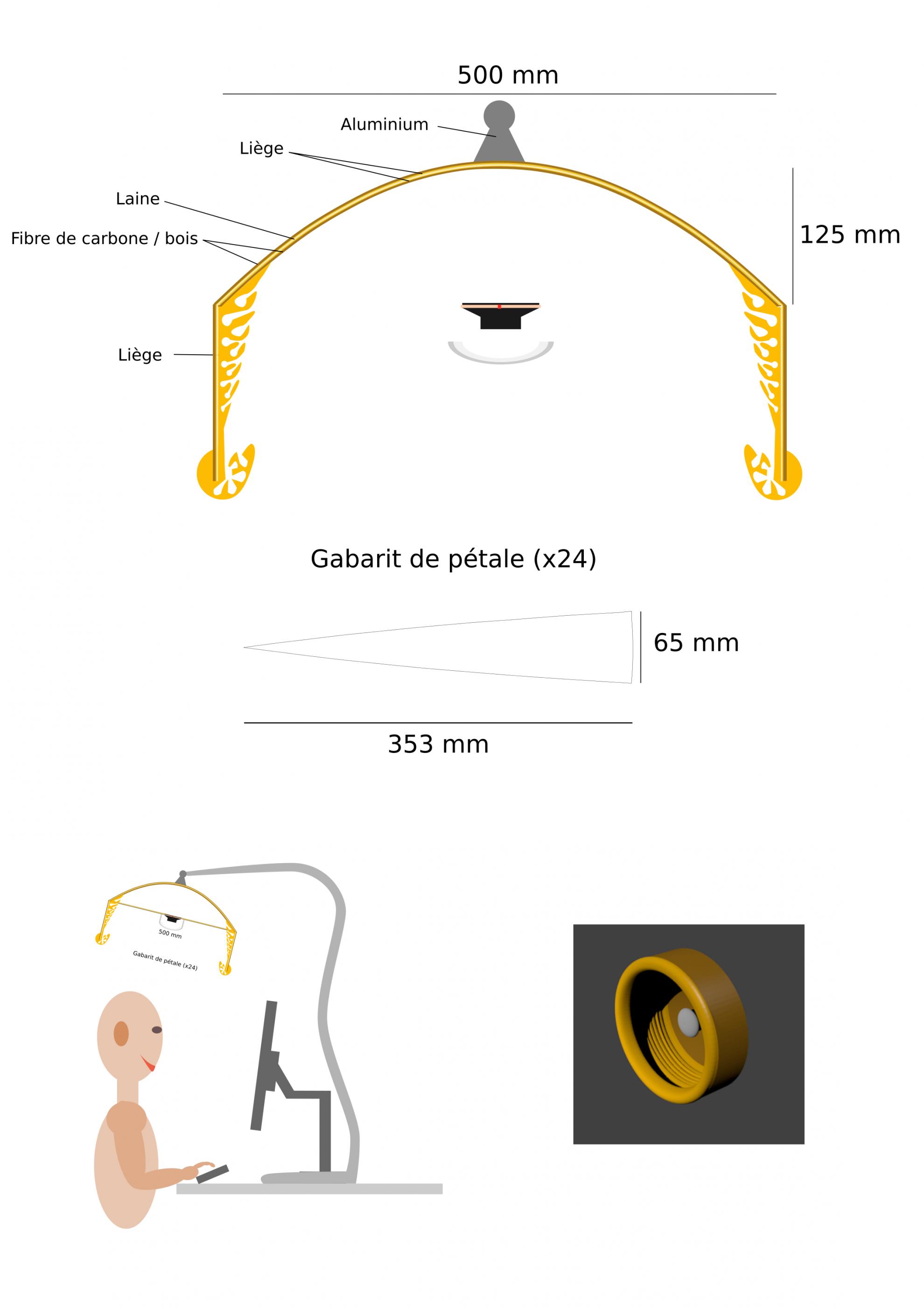

I'd like to build the best quality possible parabolic speaker as a prototype first and then for home offices.
I have made few designs, gathering the pieces to get the parabolic part done. What I miss is a partner to guide me on the electronics/acoustic parts. I'm capable of learning but it will take way more time than having a partner.
Ideally we'd share the design principles here so that anyone from the community can build his own one.
Here are the few first designs, any help or feedback would be much appreciated !

A short list of what you are trying to accomplish is worth adding also. Things like:
1) Frequency range you expect the reflector to operate across. At lower frequencies the sound will wrap around the reflector, leading to more sound leakage to surroundings.
2) Distance from reflector to listener.
3) SPL you want at the listener vs. that leaked to the rest of the room. If this can vary with frequency, that should be defined.
4) SPL you expect to need from the speaker at what distance (directly, not including what the reflector does). Low and high frequency limits for this output would also help.

I won't go much beyond 500mm as this speaker is supposed to be put on top of a desk (maybe 600mm max).
It is supposed to be an alternative to headset as I'm tired of having headset on my ears all day long.
> MattStat
1) I don't expect much bass in daily use as the bass propagate in open air which goes against the purpose of relative isolation. Still I would enjoy a "bass mode" that could be activated on demand if you know you won't disturb anyone. So I can't define a precise range as I'm not an expert bu I hope you see what I mean
2) Distance from edge to listener would be approx 500mm as per schema attached.
3) & 4) Honestly SPL is were I struggle defining anything. I expect it to deliver the best that can be done in term of SPL range mitigating the form factor and the usage in open air vs not disturbing your neighbor.
My idea was to use a 7cm full range speaker and tweak the overall system.
Use a very reflective surface for the interior of the parabola.
Use overall a sandwich of wood/cork/wool/cork/wood for my parabola.
Maybe you can help me at defining what you think is reasonnable for missing parameters?

In fact I seek for help on multiple topics:
1) Is there a blocking factor in my project that prevents any kind of fidelity for any range with an acceptable usage.
2) What do you recommend in terms of reflection surface for the interior?
3) Do you think my insulation strategy: cork/wool/cork sandwich + wave traps is relevant for my purpose?
4) As soon as I manage to get the parabola done, which speaker do you suggest I try? It should be excellent in mediums, not too directional, max 9cm of diameter. I can buy multiple one to try them out.
5) As an input to this speaker, what kind of embedded amplifier should I bring on + circuitry to enable a plug & play approach for users on their office plus to allow me specter fine tuning? In the mind of DIY, the easiness should be a criterion.

1. Laws of physics. Low and lower mid frequencies will not be focused from 500 mm parabola (or 1000mm) and will escape out. You can have some fidelity, but there will be no isolation for other persons in the room.In fact I seek for help on multiple topics:
2. Any hard enough material - plastic, etc.
3. No, the "wave traps" will not help. Sandwich with (glass)wool in the middle will absorb some of the mid frequencies, but nothing in the low spectra. It is impossible to get isolation this way.
Bottom line: try some neckband loudspeakers: Bose SoundWear Companion, JBL Soundgear, Sony SRS-WS1, Long Run Technologies Neckband Wearable.
Amazon.com: Wearable Speaker: Bluetooth Wireless Neckband Personal Neck Body Handsfree Mic FM Radio SD Card Microphone Portable Sport Gym Workout Travel Running Biking All iPhone iPad Android Smartphones Tablets: Home Audio & Theater
There are commercial parabolic loudspeaker, but they are designed for speech only (museums, galleries, etc), see photo below:The purpose behind this device is to allow listening to music without headset and without annoying people in the room, like a traditional speaker but aiming at reducing the spread of sound in the room.

I confirm you're working against the laws of physics, and physics always win.

Thanks for the feedback and alternatives but I really aim at making it real.
So what I understand that all of it could work at least partially with the mid-range frequencies.
That would fit with a wide range of usage for me such as calm music, voice, audio books for kids, etc.

Ultrasonic high directivity loudspeakers are the best performing technology for highly focused sound. Also much smaller dimension than parabolic speakers. And with good prices now.
thanks for the feedback mattstat, that's exactly the kind of help I was needing. I'll have a look to the HP.
I did try with papier mâché and an old bluetooth speaker unit but could not achieve the parabola, just a kind of rounded cone
I have now made the model to 3D print it, I'll try with that.
