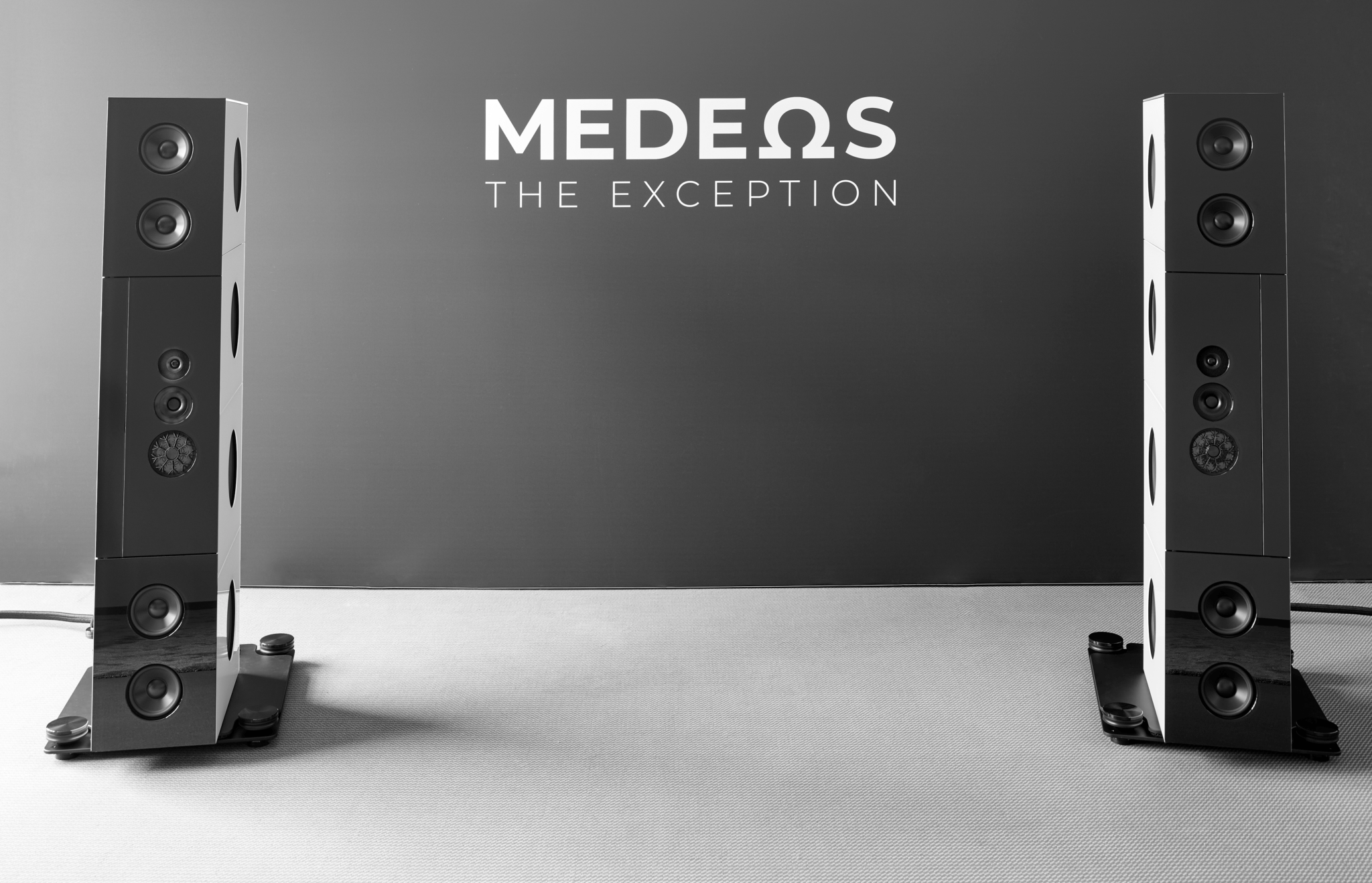

Everyone who know me understand that I am a big Audio Physic fan, so when I see this one launched at hi end München show, I am getting really stunned... at every point. There are many things that tick boxes here
https://www.audiophysic.com/en/medeos/
  • Point source, or really close to point source, the whole passband down to around 300 Hz is managed by the central 3 drivers really close together, the other drivers symmetrically around this point.
  • Lot of cone area in the mid-bass up to 300 Hz, must leave us with unreal dynamics, and there is nothing like lots of cone area
  • Woofers for midbass located low and high which means it triggers different room modes and so should be more even mid-bass and less room influence with mid-bass, the same gows for the lower bass
  • Integrated subwoofers, an all in one solution that makes it feasible to place even in a medium size flat (like mine)
    With four large / tall towers my place would look like Stonehenge, I don´t want that.... this is also going into the main living room
  • Really really really cool design, the way it looks, IMHO 😍
Somehow this ticks all the boxes for me, except for the price of €160.000, no matter how I look upon it, this is out of reach for me, so it makes me thinking, is it possible to build something with this geometry?
This is a really complex thing to do, 5 way with 3 separate cabinets each side.... Call me absolutely insanely crazy but I am thinking, is this a project I would like to consider?, maybe 😱
It could be a setup with Bliesma beryllium tweeters and hi mids, Purify mids and woofers, several possibilities with subwoofers. But to have any chance it must be active with digital crossovers, this would easily be a €20K to €30K project, so there is pretty high risk here.... I have a working title of "project madness" 🤣
I have not been doing any simulations or calculations on cabinets sizes and/or setup yet.....
Any thoughts guys

Still, placing the tweeter and mid slightly off center to counter (the worst bit of) diffraction that you know will happen isn't the best way to deal with it.
If looks are more important than function I do begin to wonder about having the priorities straight.
All I can offer as advice is to take up Vituixcad, build a model with the appropriate drivers into it (using on and off axis data) and see what it brings.
That alone will provide the answers if a project undertaking like this has any merit, as when used properly these models offer a great deal of useful data
to predict the outcome of a project like this. So spend some time on that first, before committing on driver choices. I think it is wiser to work out the
concept first, and then determine which drivers will fit the functionality instead of the other way around. The sim will show that kind of info about the
most fitting crossover frequencies to use to maintain proper directivity control etc. Not as nice as dreaming of those boutique driver choices but it
will result in a better end product. If that can satisfy your goals.

Most certainly! More important than the driver choices you end up with is integration!
The important question being: which driver can do this specific task.
If you end up with the drivers you listed: all the better... but the task at hand should be the priority.
That determines the specific driver needed to do that job.
Almost all projects I've read about do it the other way around.

Well, if you want to match or stay close to the light weight spider less driver(s) used in the Medeos you probably won't end up with Purify drivers...
the 4" Purify driver I looked at had a 11.7 gram moving mass figure.
In that case a spider-less full range Alpair 7 MS driver from Mark Audio with light weight cone would come closer, right? Mms being ~3.3 gram.
Just as an example of how wildly different designs can be.
