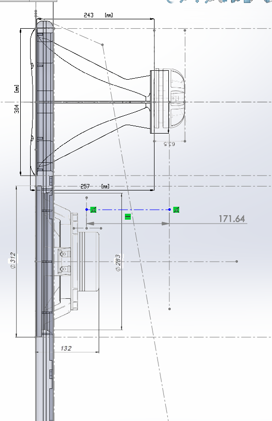

Background : We currently use oak clad Orion 3.4 speakers in our church. They look and sound(ed) great! Unfortunately after 6+ years of use two tweeters have popped due to a operator error. They are pricey to replace.
So in memory of our lost friends I picked up
Faital HF146
18Sound XT1464
Beyma 12P80NDv2
The Beyma will be in a ~50L non square box, possibly with a custom aperiodic vent of around ~130cm2 so should yield a close to flat response to ~ 90hz with a few db EQ in the 70-120 region.
Work in progress.... updates to follow!

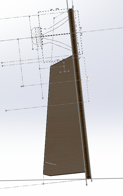

I used the boundary and diffraction sim v1.2 to set the woofer position on the baffle and machined in 20mm rads all round too.

The 12p80nd ended up as a 1.2cuft BOM square box with two ScanSpeak variovent aperiodic ports. Testing in progress. A church filling sound! Pics to follow.

I spent some time looking at humblehomemadehifi in particular the Calpamos and the newer Mezzo Calpamos. My reasoning to go it my own way was that I didn’t want another box. I have machines at work I can put to wood cutting use! LineSource is my motivator regarding TPL/12p80nd/18fh500. I’m going for a bespoke horn for the room, eventually.
After spending the afternoon with REW I managed to get the speakers up and running for the showing of The Muppets Christmas Carol.
