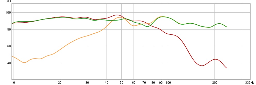

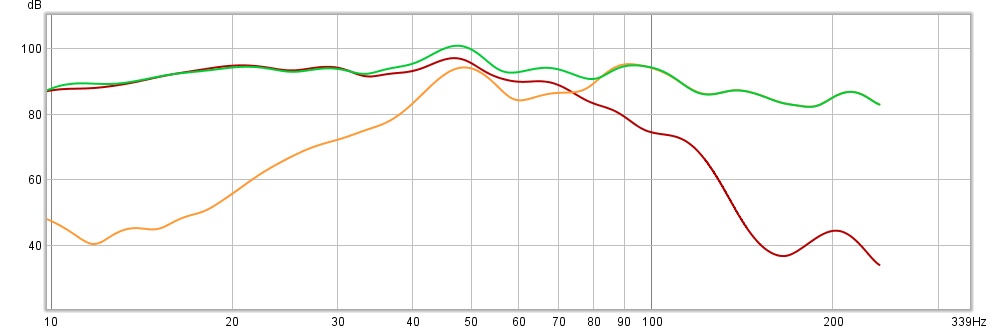

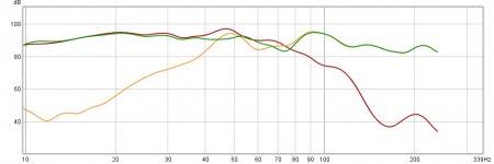

Managed to perform phase alignment using mic and REW. Before and after response attached. Red is sub. Orange is Mains, Green is total.
Before graph shows almost totally out of phase, lots of destructive summation
After response shows my best attempt down to the closest 0.1ms at constructive summation. Sounds much better now this is corrected.

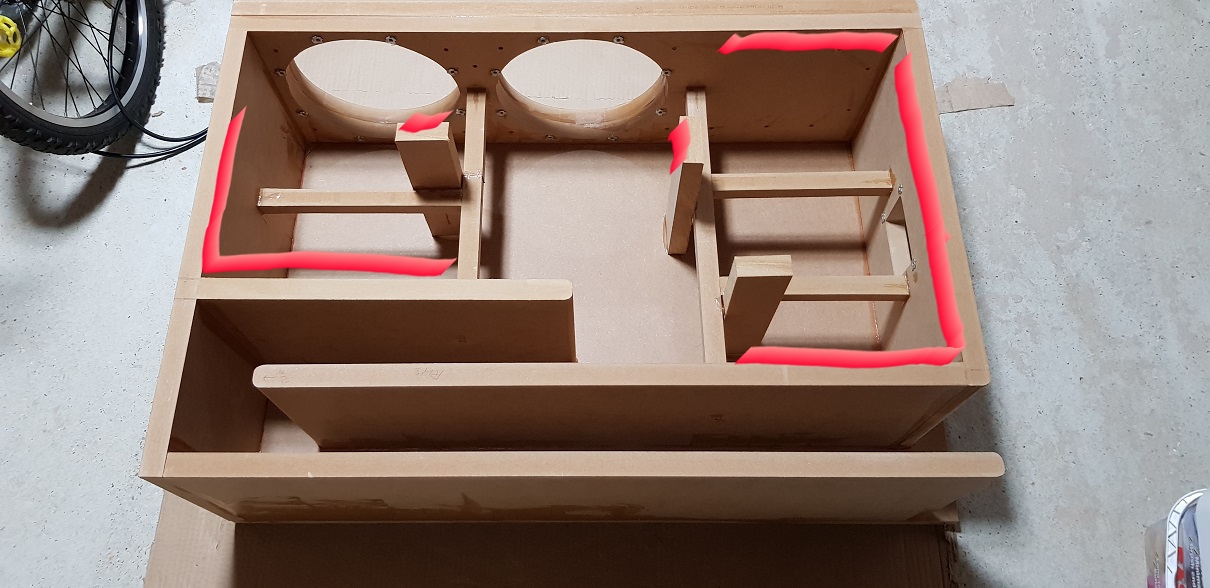

Hi all, below is a detailed before and after assessment with measurements of the application of acoustic lining to this design. Any questions, please let me know. I hope this post is of interest.
Some of the issues I’ve had with the enclosure –
I’ve long suspected the enclosure sounds hollow. It sounds like echoing - albeit heavily attenuated and short lived echoing, which colours the sound.
Upper bass and midrange being emitted allows the sub to be located. I’ve always believed this is due to reflections and/or ringing bleeding through the drivers/port. Note: the enclosure is fairly substantial (1 inch thick with 2 Inch front baffle) and braced relatively well.
It has a howling sound emitting from it. Only audible when putting your ears up to the enclosure and playing low frequencies loudly (20Hz for example). I believe this is due to the movement of air around and over the smooth internals of the enclosure.
A cabinet buzzing noise from 310Hz to 360Hz when doing frequency sweeps with no LPF.
Spikey frequency response outside of passband. The first notable spike is due to the port resonance @ 132Hz and in room produces a measurable spike at 111Hz.

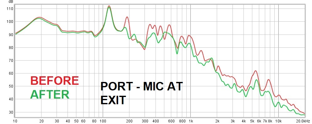

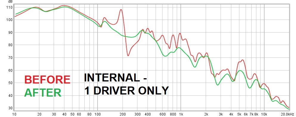

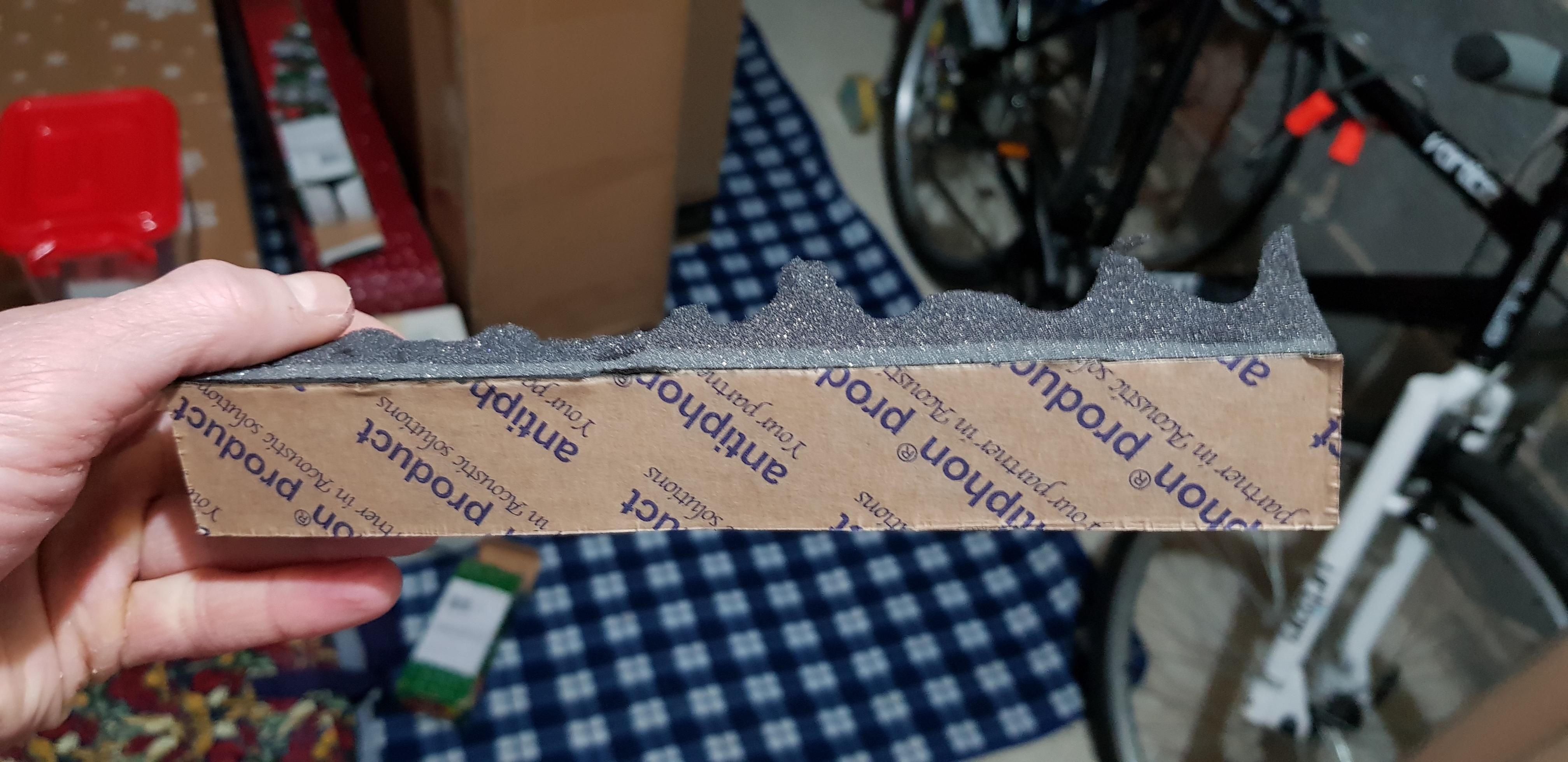

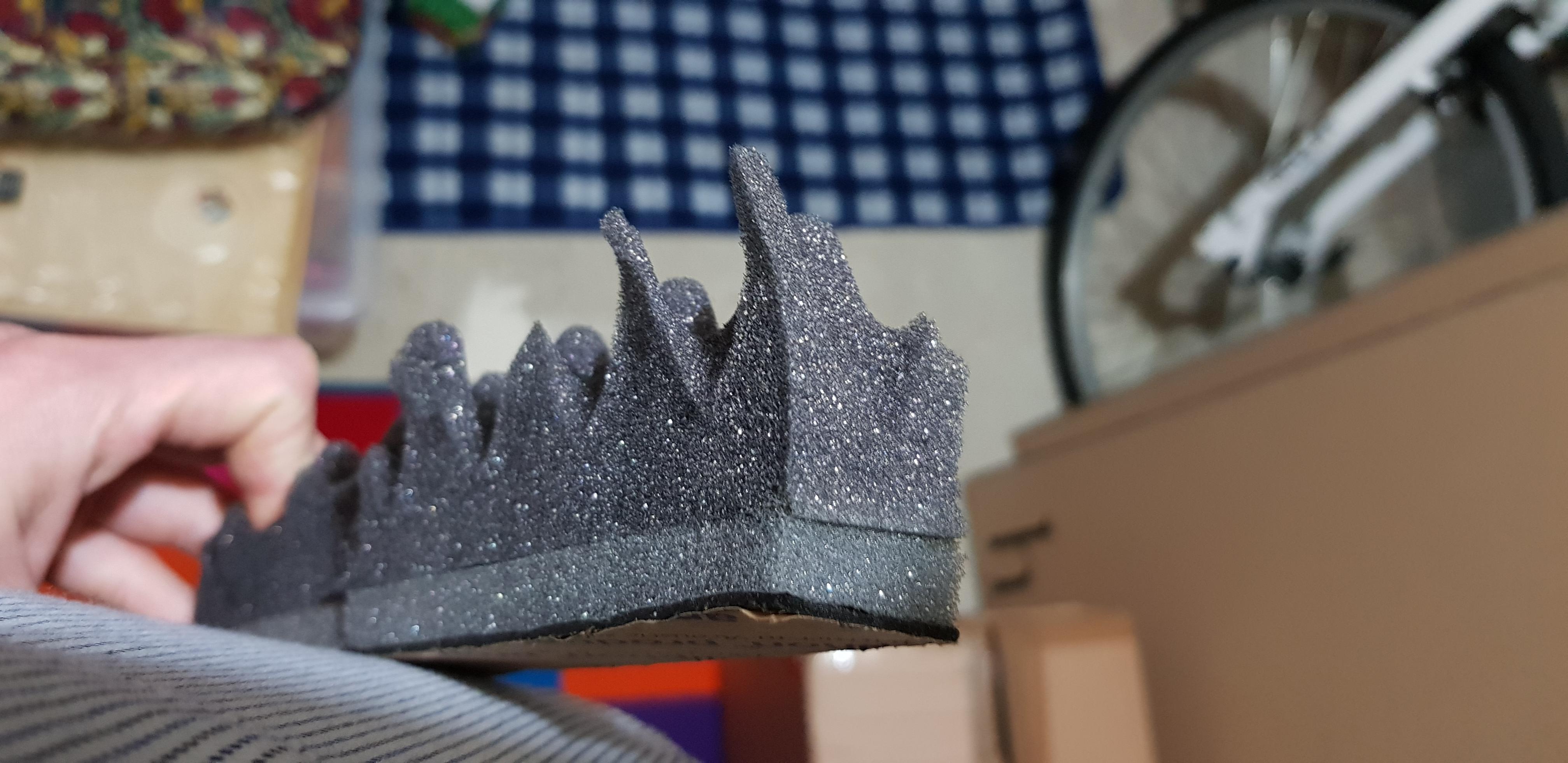

For the above reasons I decided to fit some lining to the internal walls of the enclosure. I spent a lot of time researching and opted for a foam type material. The acoustic material has a peel and stick backing with 1.5mm of bitumen, 1 cm of foam (I believe closed cell) and 25mm of egg crate open cell foam -Total height of 35mm. The dimensional resonances of the enclosure are at 201Hz, 381Hz, 527Hz and 623Hz with the port resonance being 132Hz. The Height dimensional resonance at approx. 200Hz and the port resonance at 132Hz are the greatest concerns being closest to the pass band of the sub. 0.3square meters (3.3 square foot) of foam lining was applied as per last image, which was strategically placed to reduce the 201Hz, 381Hz and 527Hz resonance/ringing. No damping applied on the side walls (623Hz) and no damping applied at the internal mouth of the port (132Hz). I was hoping the combination of closed and open cell foam offset each other to have no impact on the apparent volume seen by the drivers (where open cell foam effectively increases the volume seen by the drviers and both closed cell foam and bitumen reduce the volume).

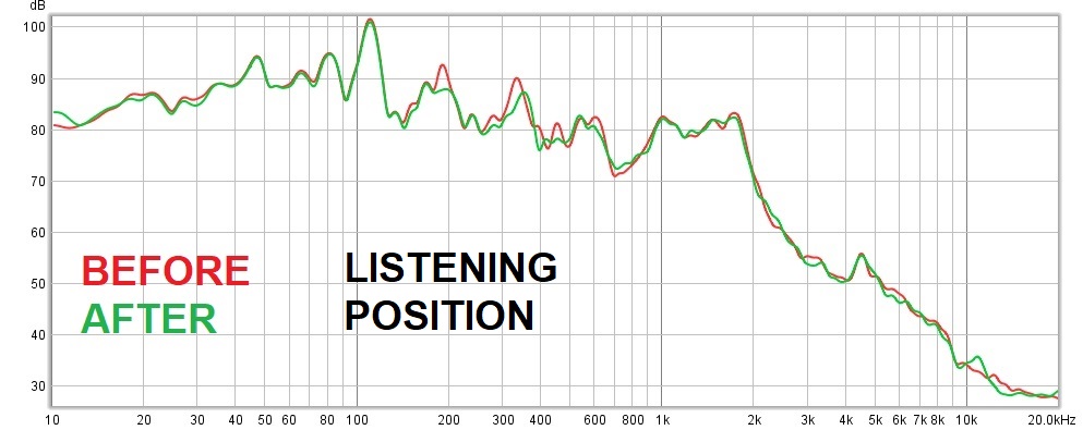

Listening position – on sofa. Barely any noticeable difference, apart from slightly flatter response in mid range, and 200Hz peak being cut.

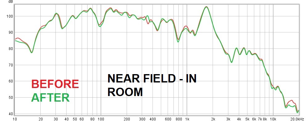

Nearfield - 15cm from top driver. No noticeable difference
Port – directly at opening. Issue caused by 200Hz ringing is drastically improved, no change to port resonance as expected.

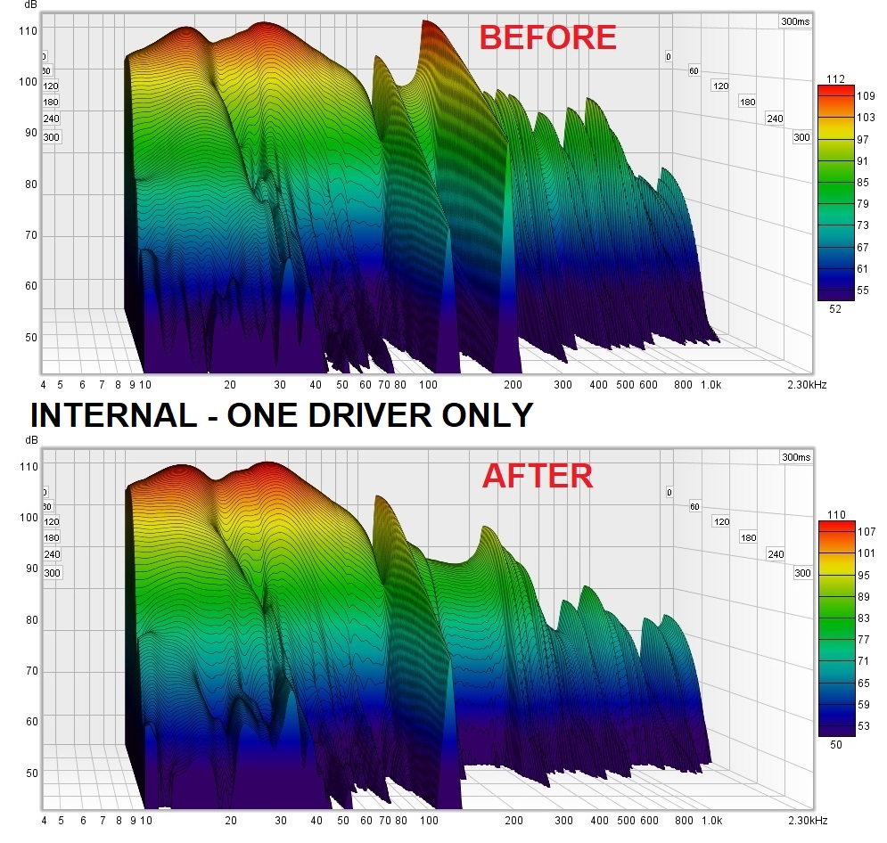

Internal – one driver removed and one left operating. Mic placed inside the box and the driver hole covered with a pillow. Checkout how much the upper frequencies have been reduced, especially the 200Hz resonance/ringing issue !!!!! This waterfall graph says it all !!!!!!!! (This measurement was only possible due to my sub having two drivers, otherwise I’d have never got the mic in for measuring)

Maybe with your next build, you could add lengths of mdf cut at 45 deg and place it in the corners of your slot, bottom left the two corners.
It is huge! I was under the impression that space was an issue. I dont know why I thought so. Well done on the build.
Thanks ! Space was never really an issue, always wanted to go bigger, but realized having built this, that I can't go any bigger, because then it would be a two person build.
Agree on the 45's - didn't have correct tooling in this build. Still happy with it though. Just need better drivers, hence hoping to upgrade to the SEAS one day. The SEAS drivers also have silver cones, so will match the Montior Audio mains nicely
