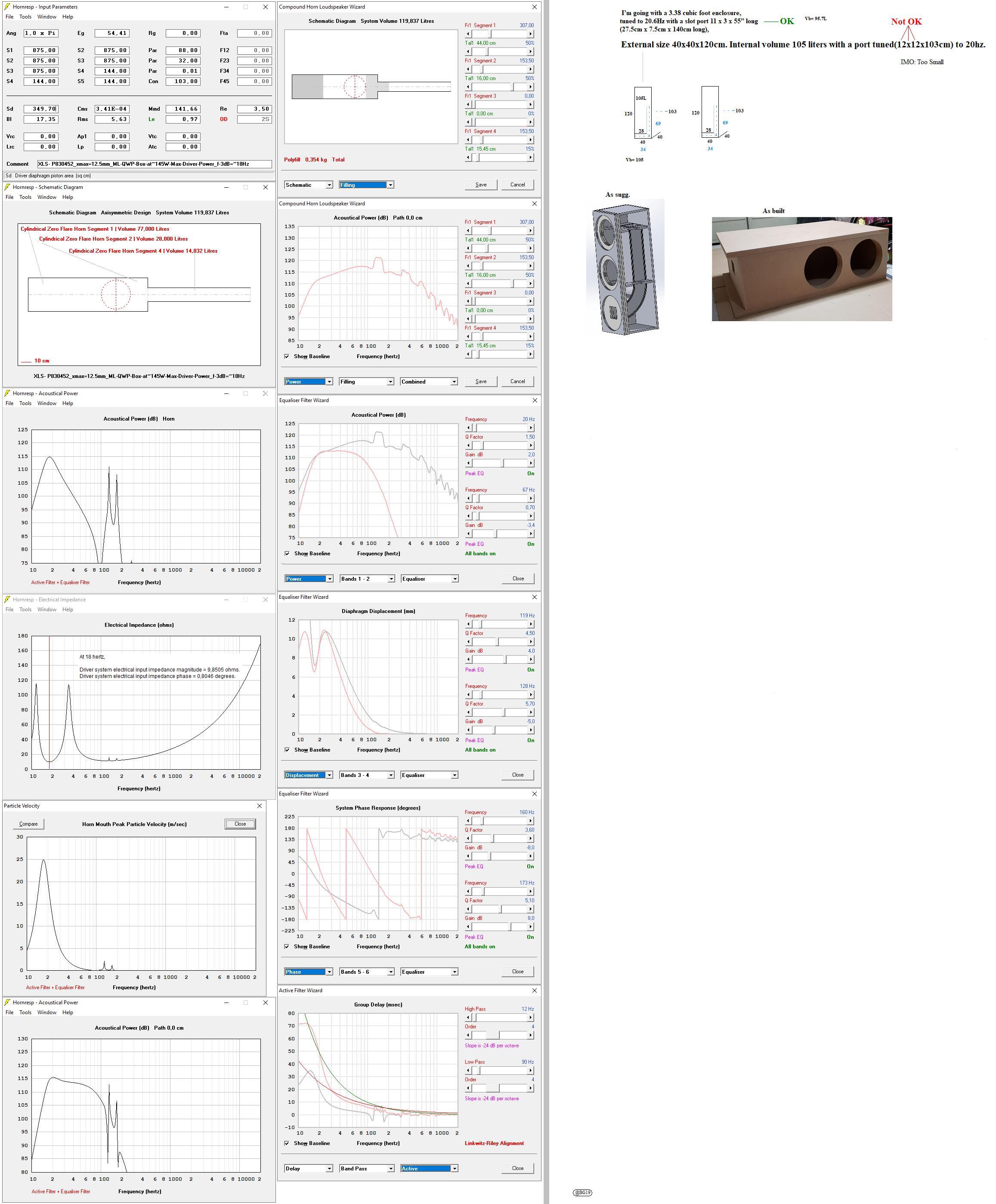

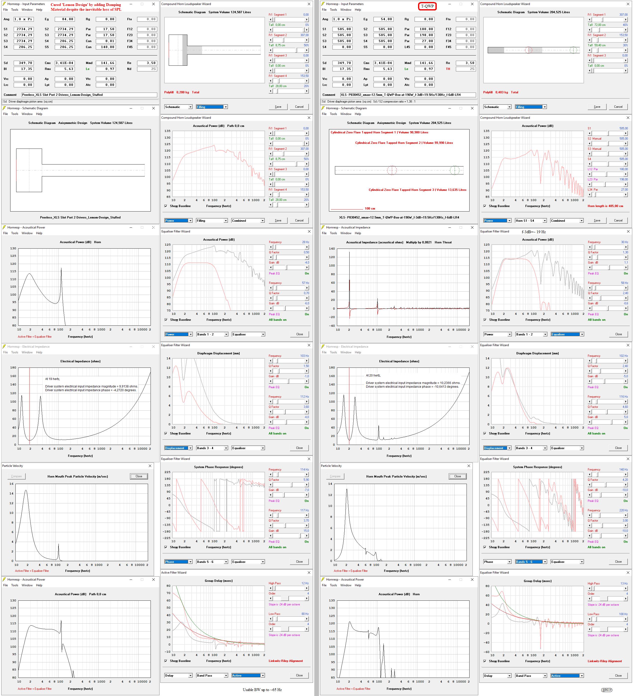

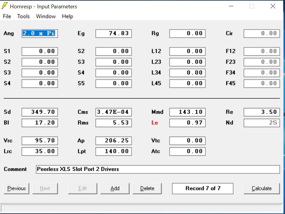

Project – 2 x Peerless XLS 10” 20Hz tuned slot port subwoofer

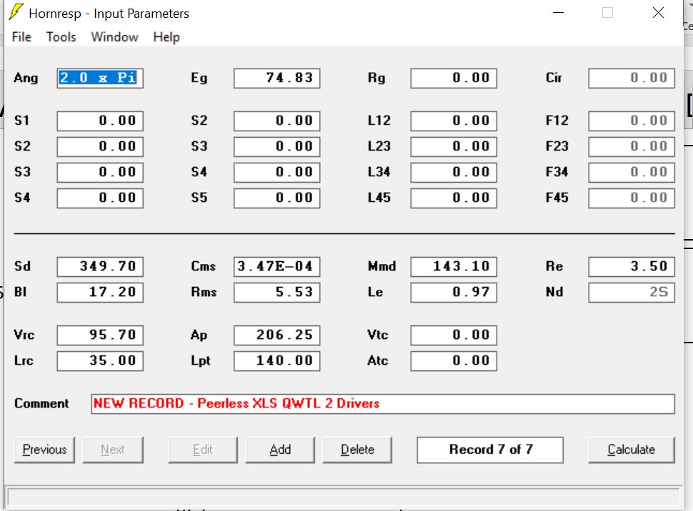

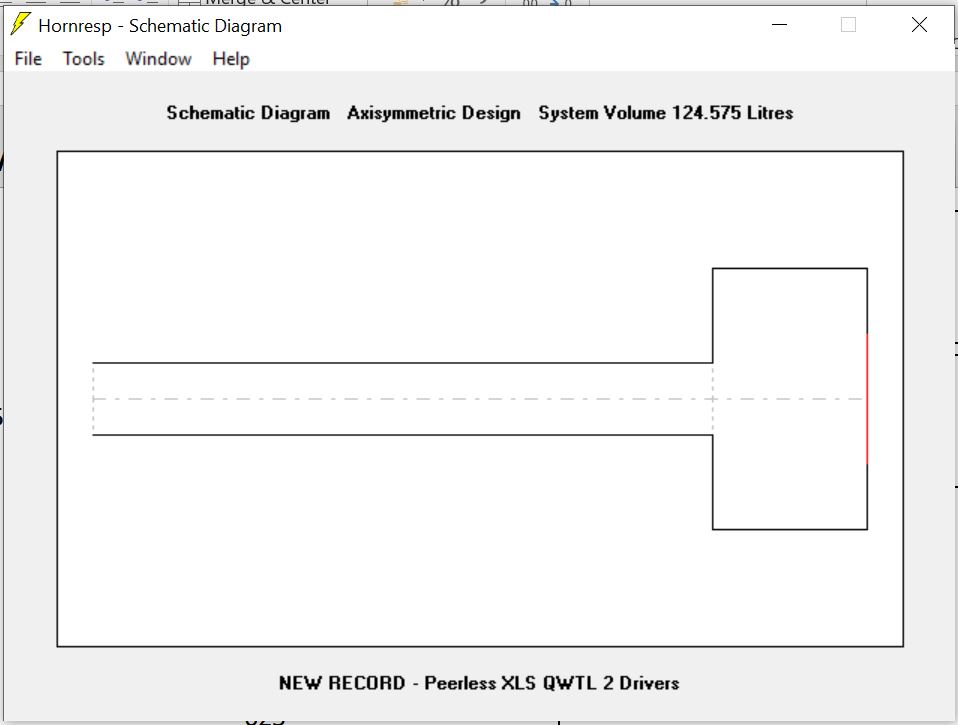

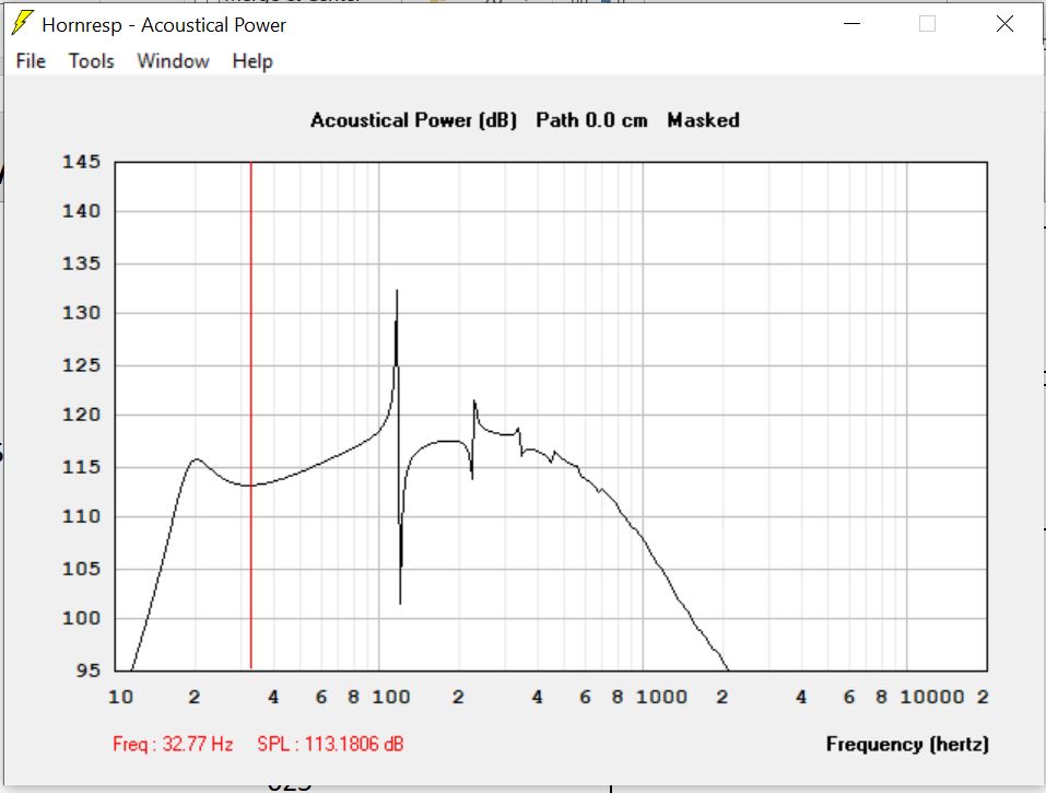

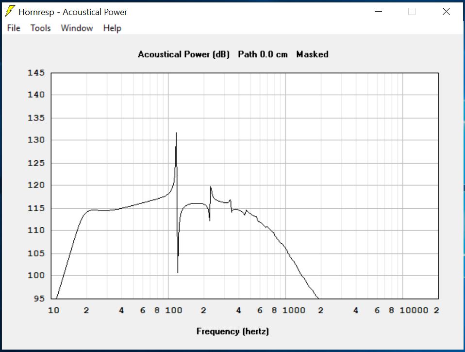

I've modelled my build in Hornresp, and I was surprised to see a hump in response at tuning frequency 20Hz. Granted it's only slightly different to that modelled in Winsid, I'm just concerned I've made a mistake in the modelling in Hornresp. This is with 350W on each driver, no filtering. Excuse the "QWTL" in hornresp title/decryption, this is a mistake, I copied from a previous plan for a 1/4 wave transmission line.
Are there any Hornresp experts out there that could kindly verify my design ?
I'm ready to order my MDF for the build, just need to double check my design and cut sheet.
Cheers

HR doesn't account for any natural losses due to friction/whatever, hence the peaking at Fb, sharp vent pipe resonant spikes in the mid-bass, etc.. Use the Wizard to add a bit of damping and it rolls off nice. 😉
Have you checked the vent mach? Lossy inductance?
GM
GM

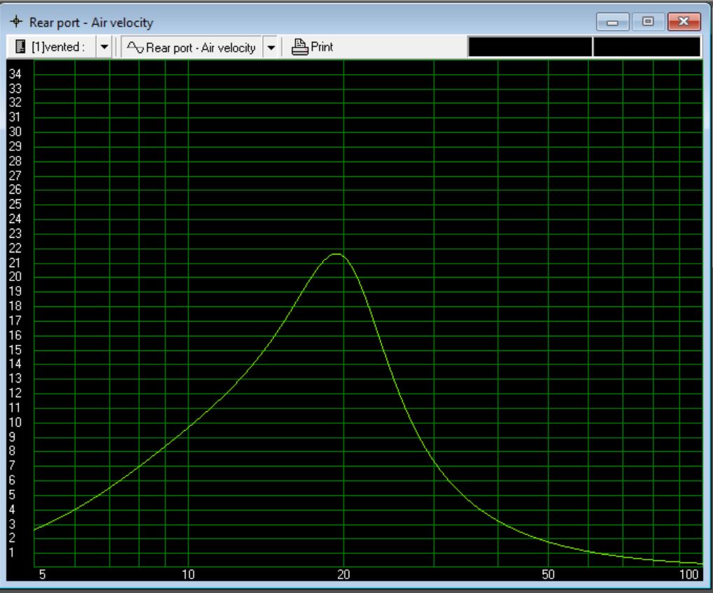

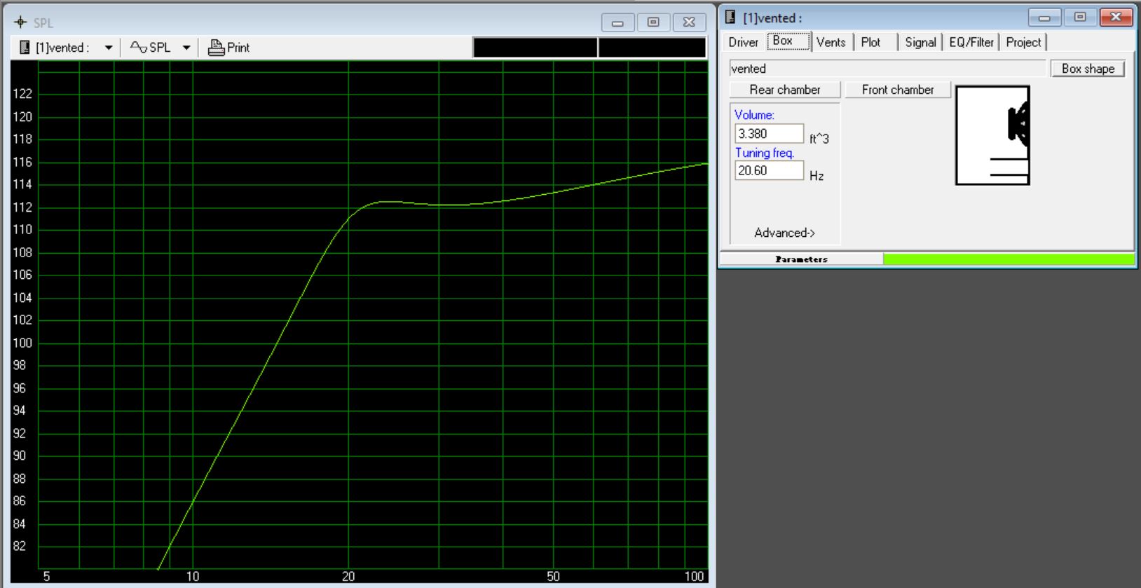

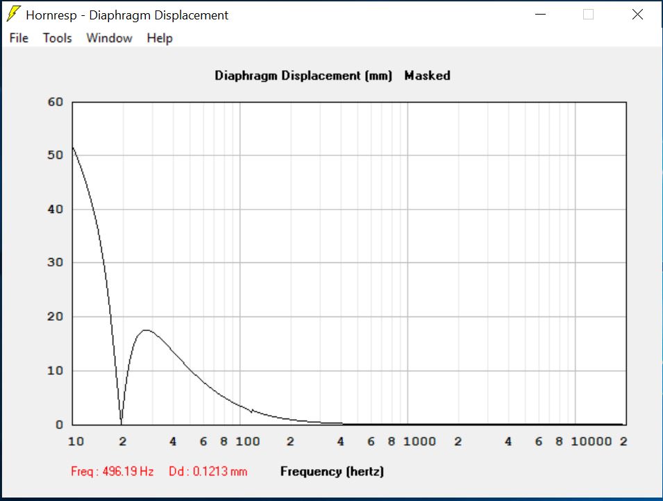

Thanks GM, appreciate the explanation. I've modelled with a Lossy LE, and results are attached, appears to have smoothed out the response. Interesting now comparing the Hornresp model to the Winisd, seems like there's a 2dB increase on the HR model over the Winisd, with a corresponding increase in excursion. I had to double check my power inputs, but they appear to be the same.
As for velocity, I'm not sure where HR shows this. WInisd modelled port velocity at 21.5m/s @19.5Hz (≈6% SoS @ 343m/s)
PS. No filters applied, or damping as I'm not quite sure how to do that in HR either. The HR model was more to verify I hadn't done anything silly in the Winisd model. Having completed the HR model, I'm now happy to hit the order button on the MDF.

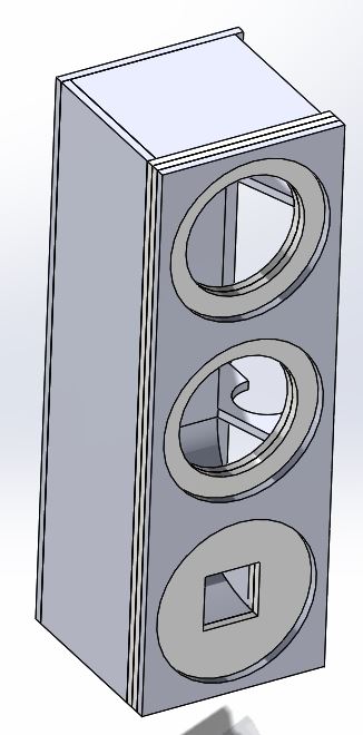

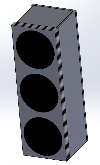

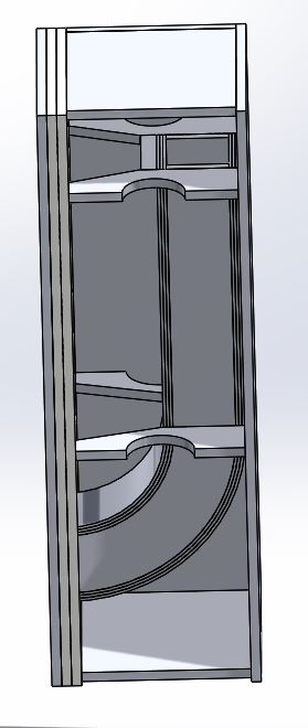

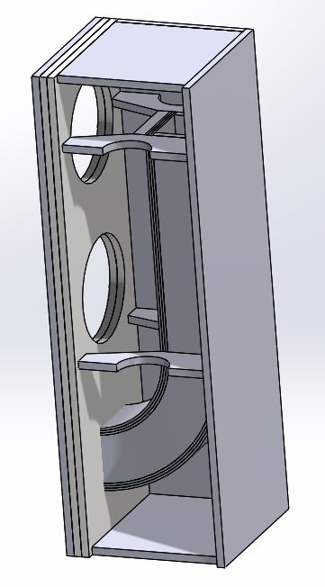

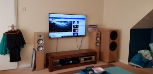

If I hadn't moved into an apartment I would have made something like this with the XLS 10"s I have.
Though I don't know if the bracing is restricting the internal air to much
External size 40x40x120cm. Internal volume 105 liters with a port tuned(12x12x103cm) to 20hz.

@CCU
Do the bracing in a different way, use simple 5cm x (40cm - two times the panel strength) and place them at the sides where they are needed. For your cabinet I would estimate 3-4 per side. By not putting them on the same height, you will have enough way for the pressure and prevent the panel from flapping in and out. Try to do it asymmetrical, as this will break up unwanted resonances too. I personally prevent to have any un braced area of more than 12cmx12cm, this depends a bit on the panel you use. The test is knocking with your finger at the outside of the cabinet. If it is dry, sharp "tack", you are OK, if you feel a more soft "tock", the panel vibrates. This stability is important with closed and vented cabinets and you find it in any simulation as a loss factor. Really working bracing is easy, but for some reason hated by DIYS, even more by the industry. B&W went away from the perfect matrix they once did, but only for cost reasons, as even the people in Malaysia started to demand money for their work hours (How could they?).
You can do it at hardly no cost as a hobbyist.
Your curved channel looks nice, but the air is more picky at the start and end of the port than in a bend. It likes trumpet like openings to find it´s way in and out.
Your plan makes it too complicated. Better try to use two sides of the cabinet and don´t build a completely separate construction as port.
If you're concerned about restrictions, use a hole saw to turn the bracing into swiss cheese, reduce the mass but retain most of the strength.

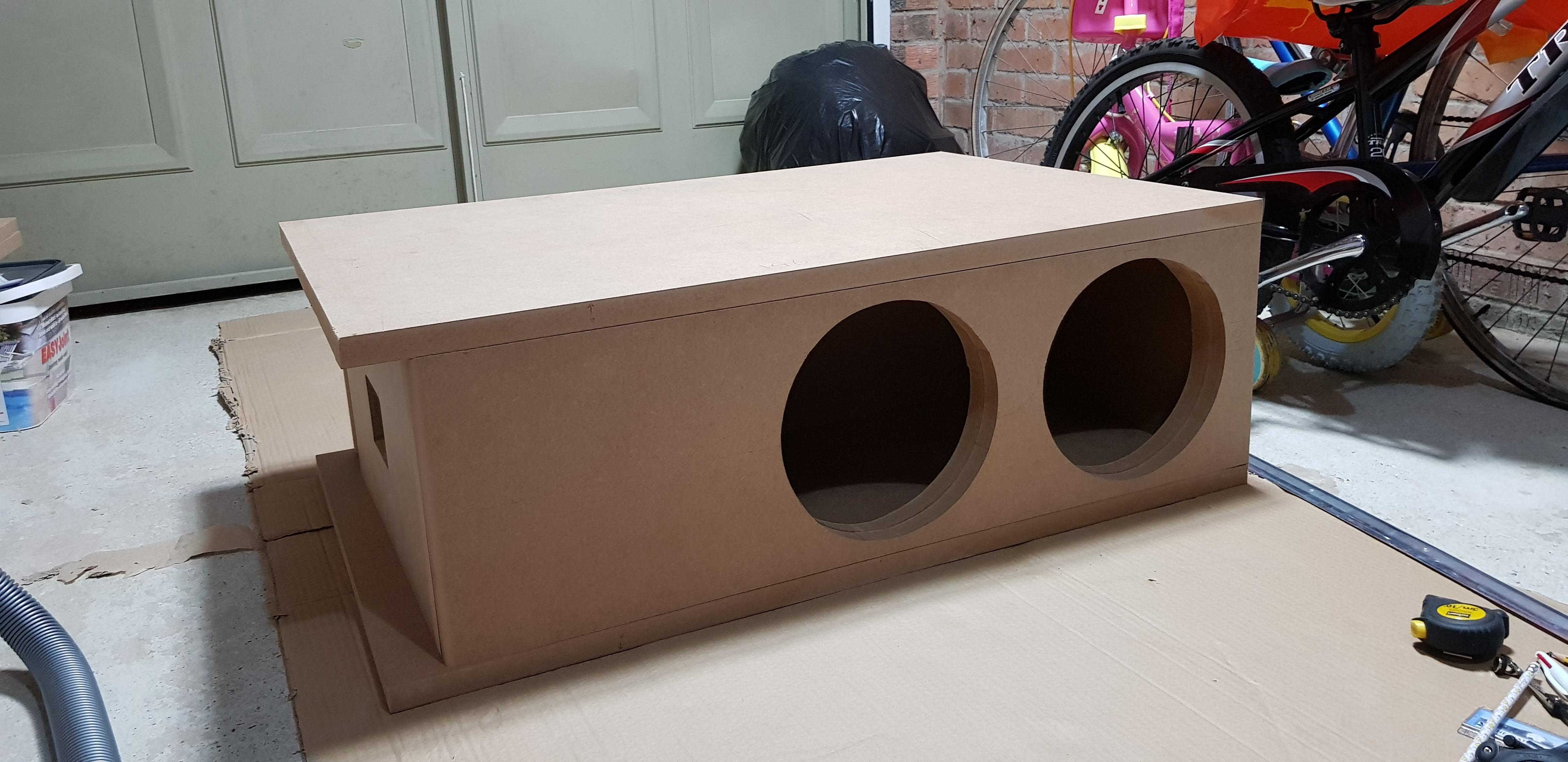

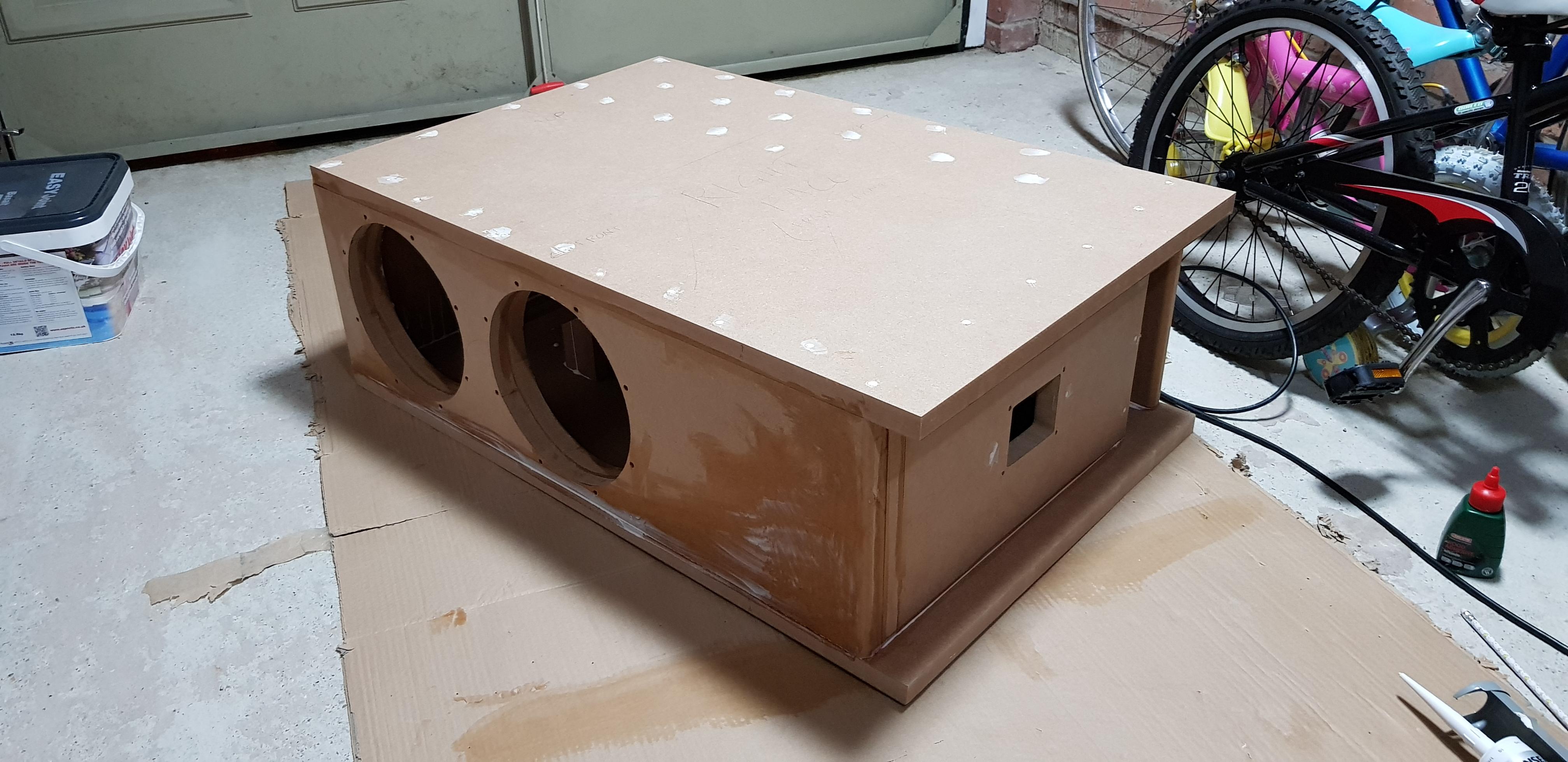

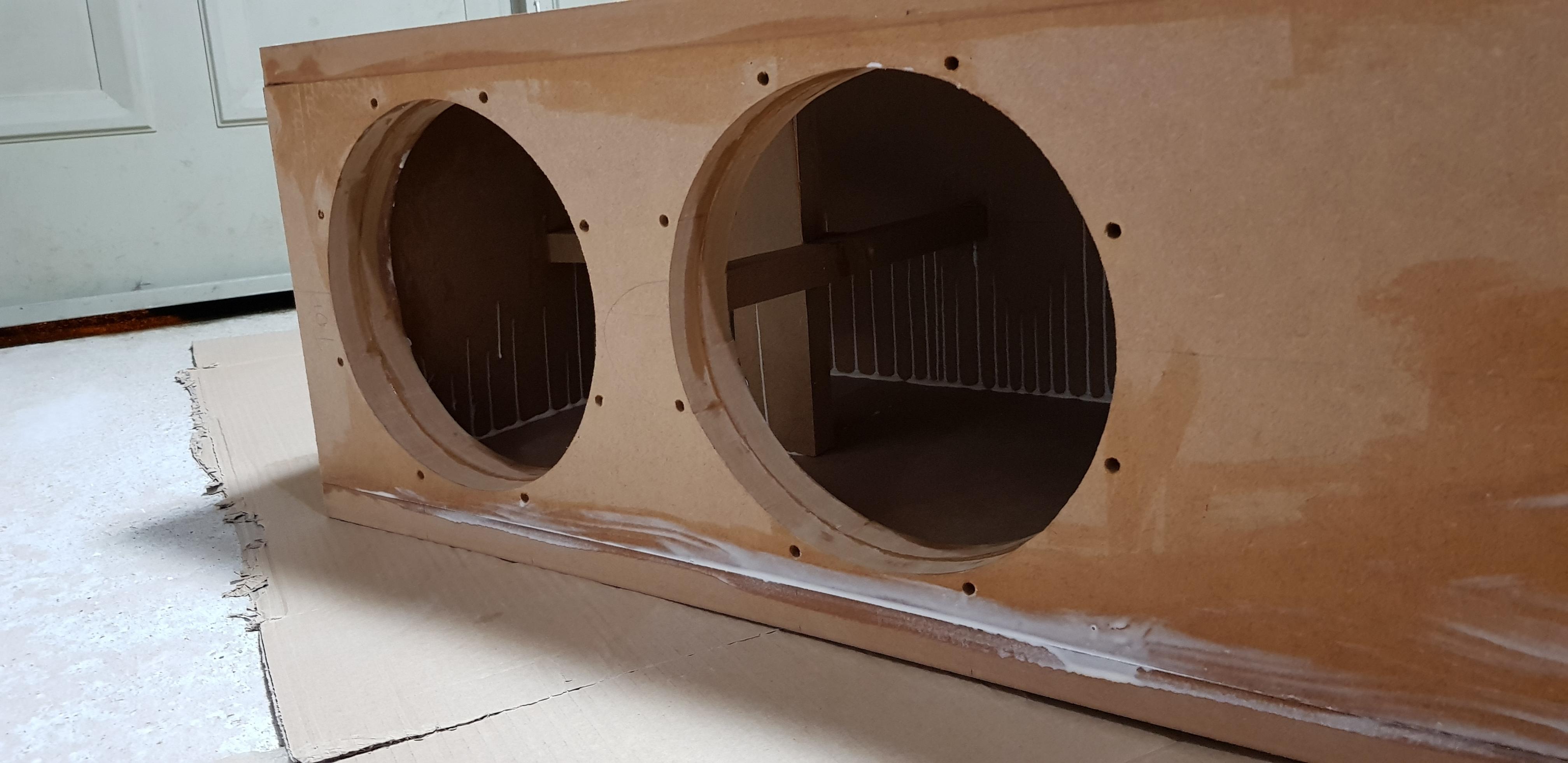

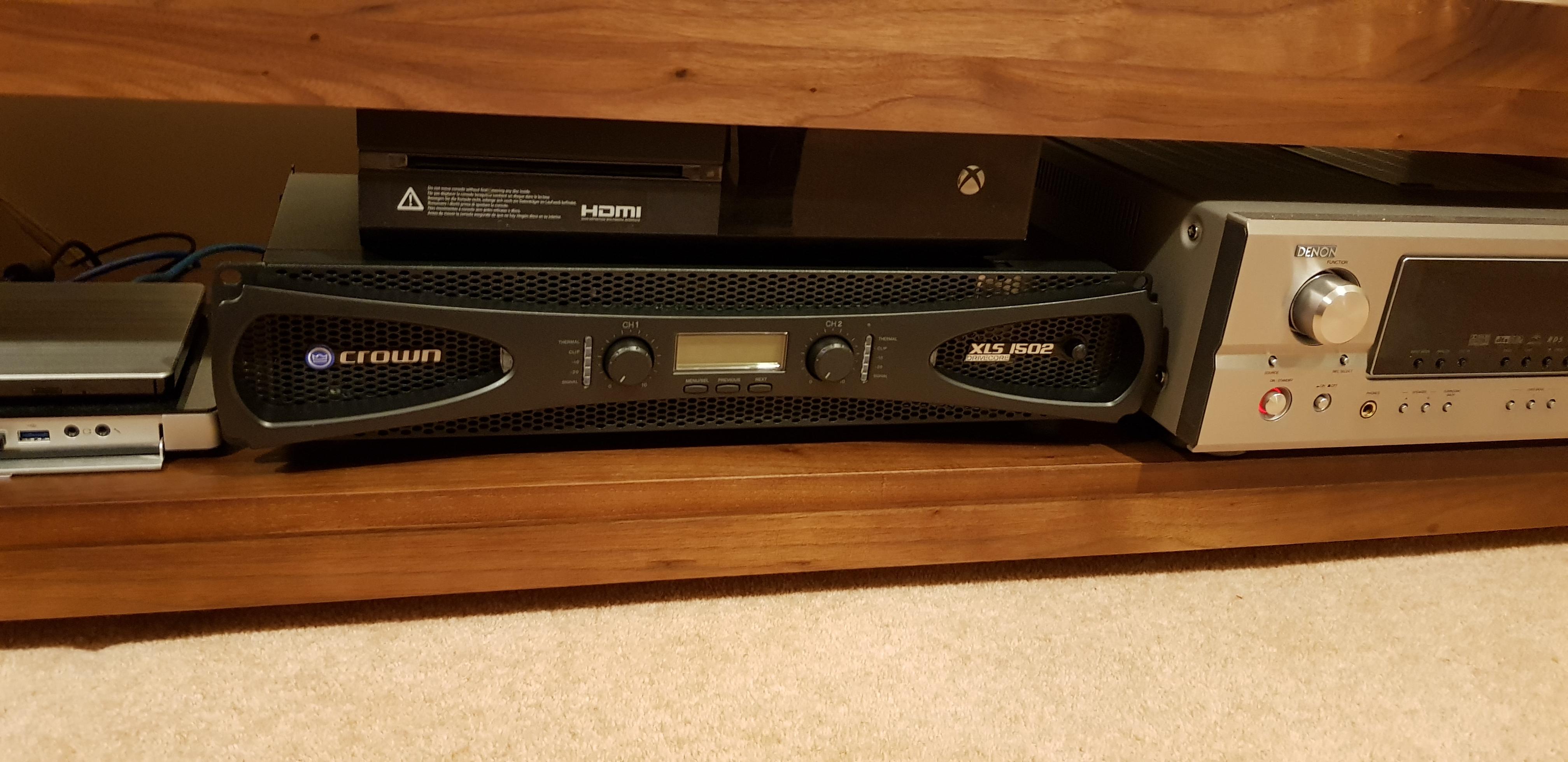

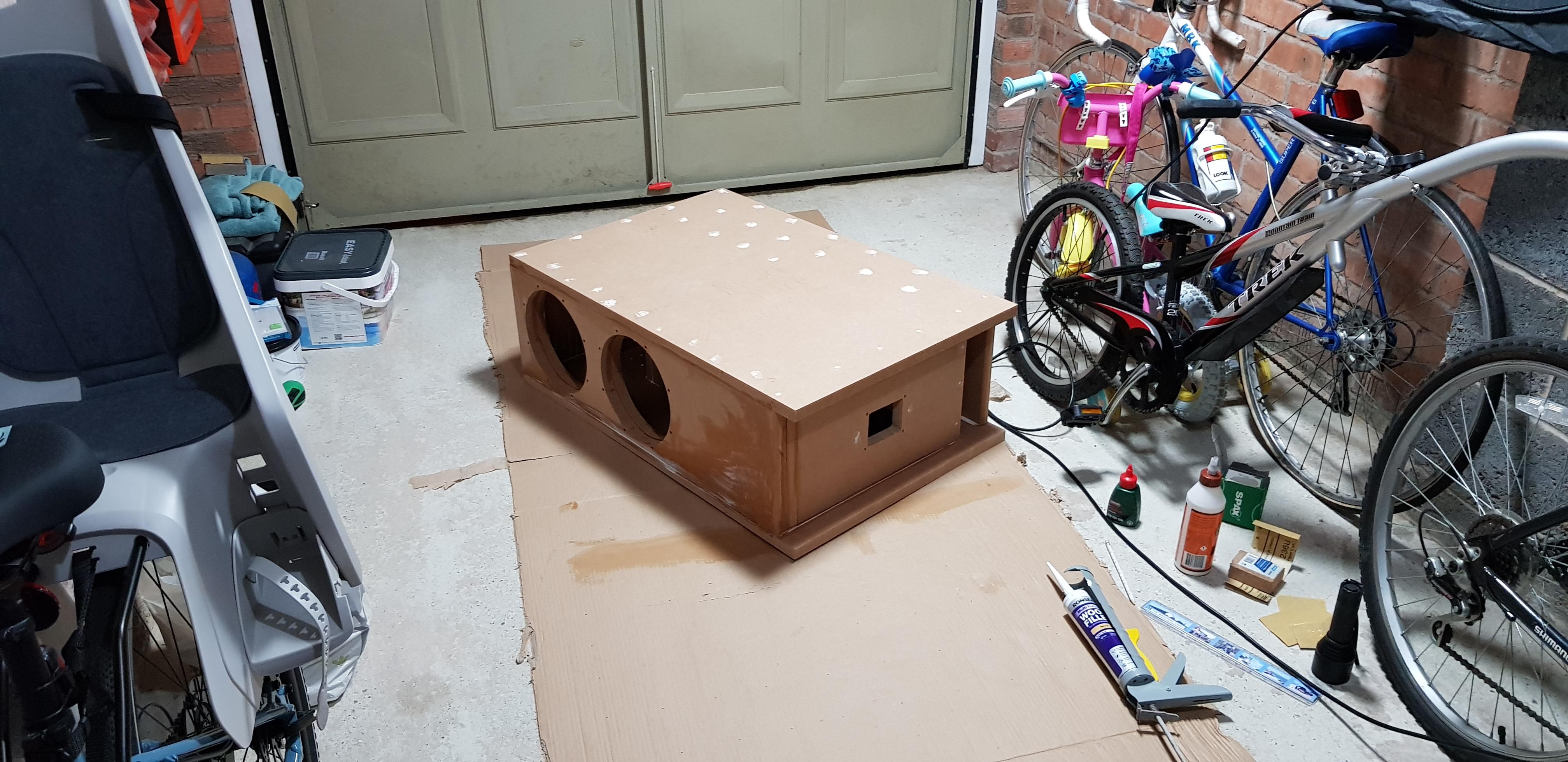

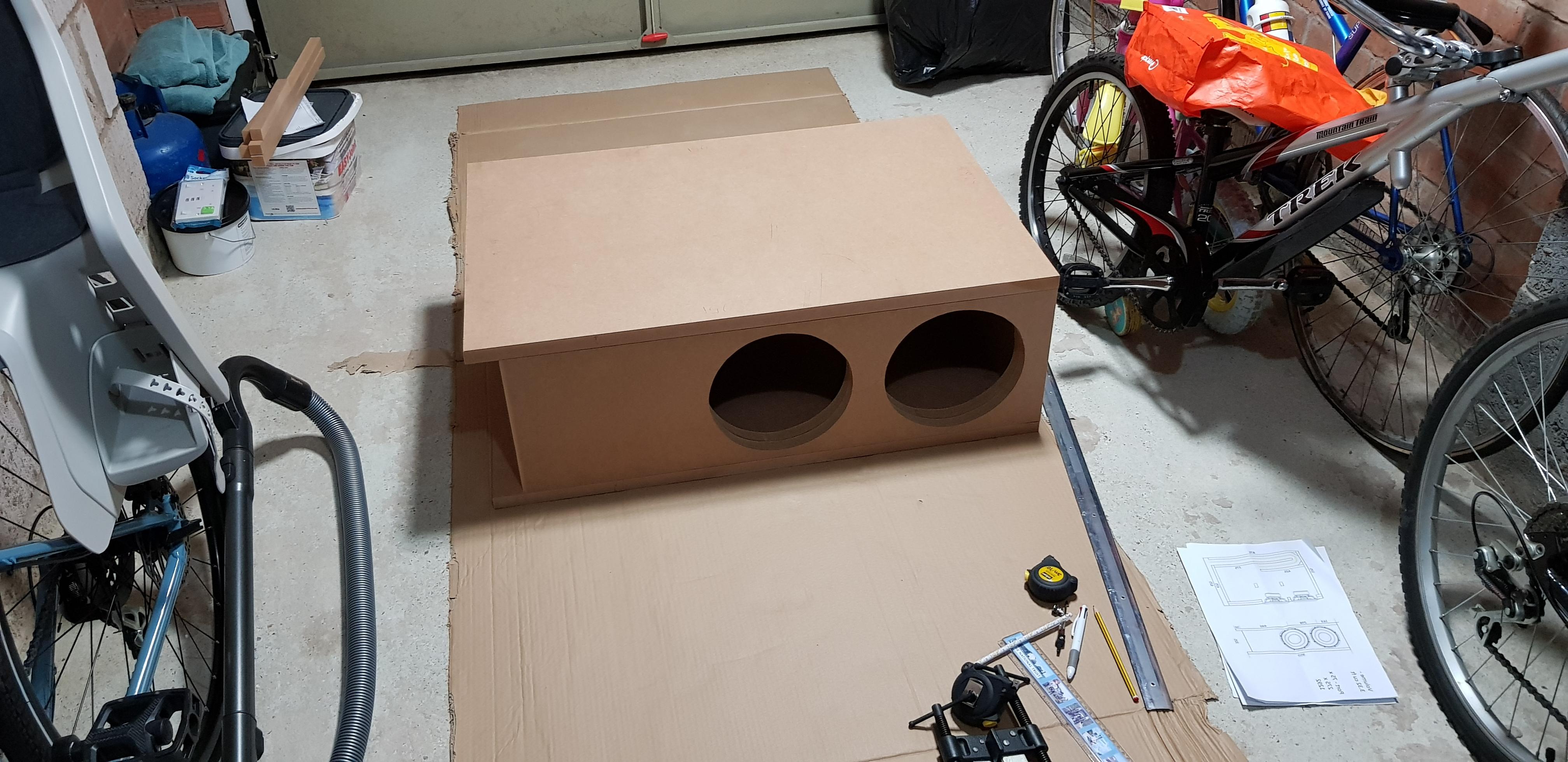

Mock-up of the build - just the panels arranged. I've started assembling, struggling if I'm honest, but will just take longer than expected. Bought an XLS 1502, so just need the sub built now. XLS 1502 should cover my future intentions, as this build is a trial for something bigger and better in the future.

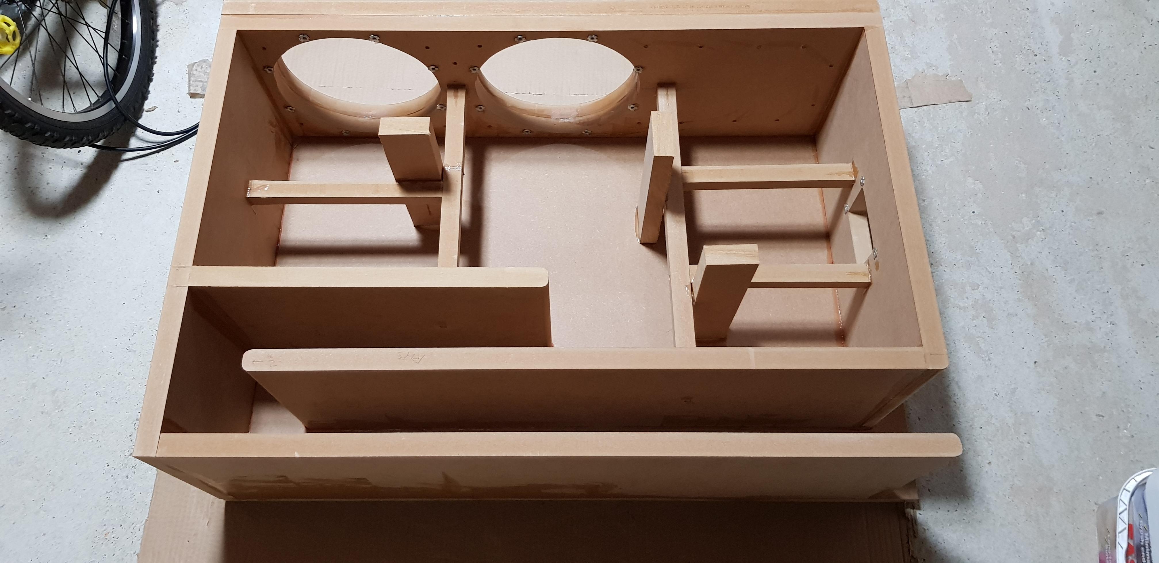

Literally just put the last panel on tonight and started with a bit of filling. Will fill, sand and trim edges that didn't line up perfectly. Hoping for good weather at the weekend so I can take it outside, to jigsaw some feet out of the bottom of the side panels and roundover all the edges.
Happy with the build, first one in nearly 20 years and by far my most complicated.

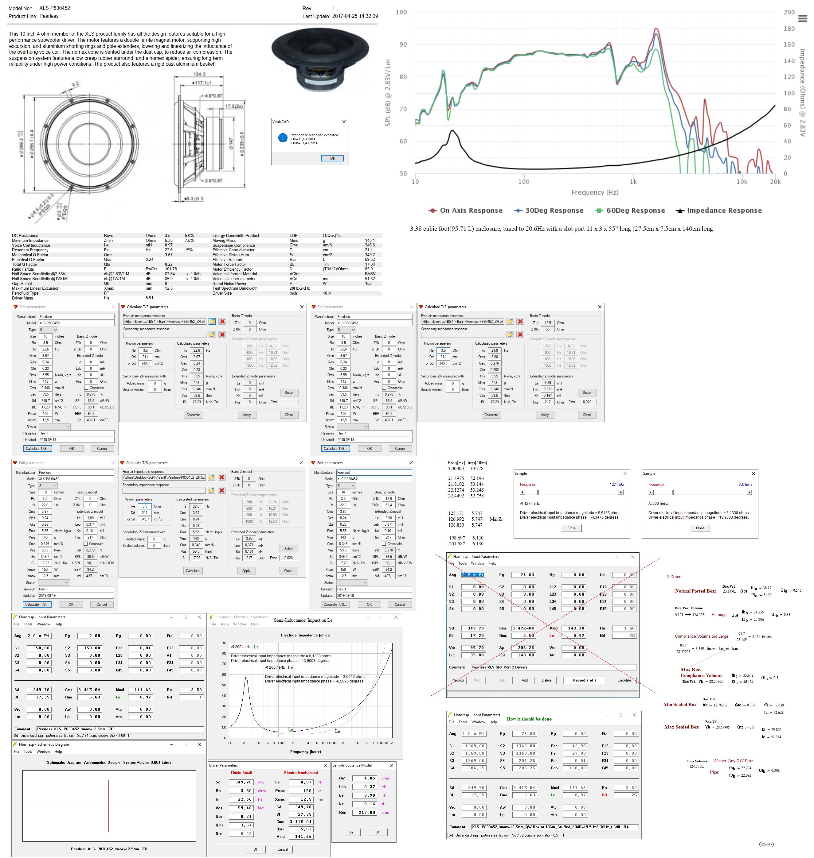

Hi All,
FYI:
b🙂

Many thanks Bjorno, appreciated. A lot of info, I'm looking forward to digesting it when I get a chance. Initial observations - looks like I should have used damping, although I currently have a 24db per octave low pass set around 50Hz, so hoping this meets your stated less than 65Hz? And I luckily got the port size correct!

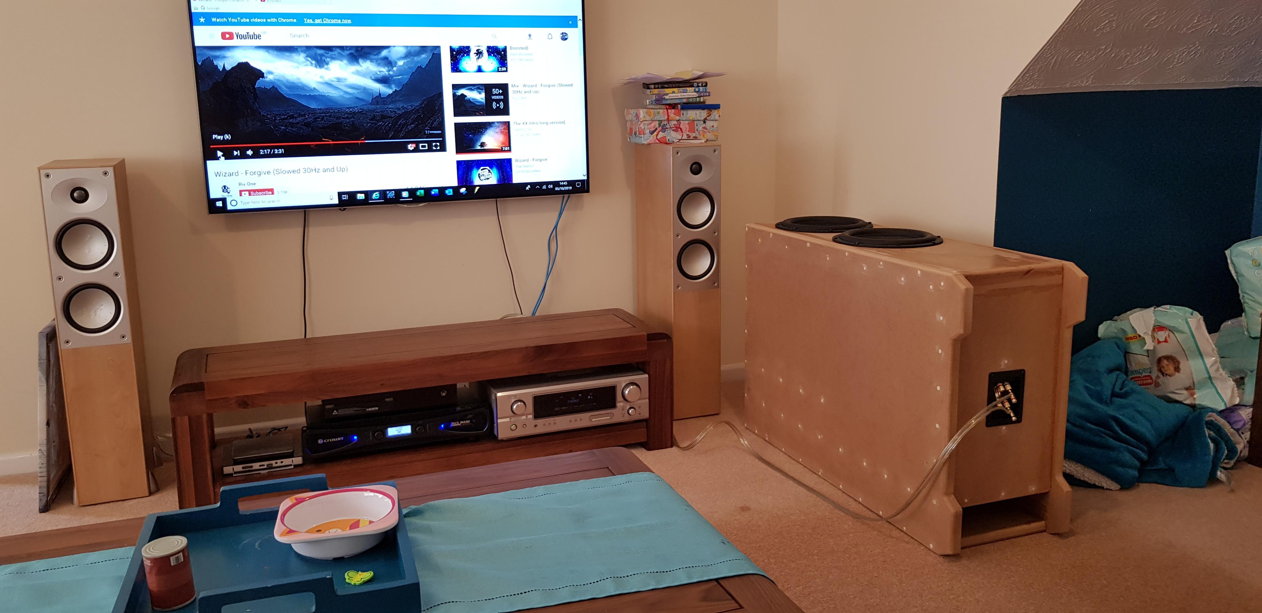

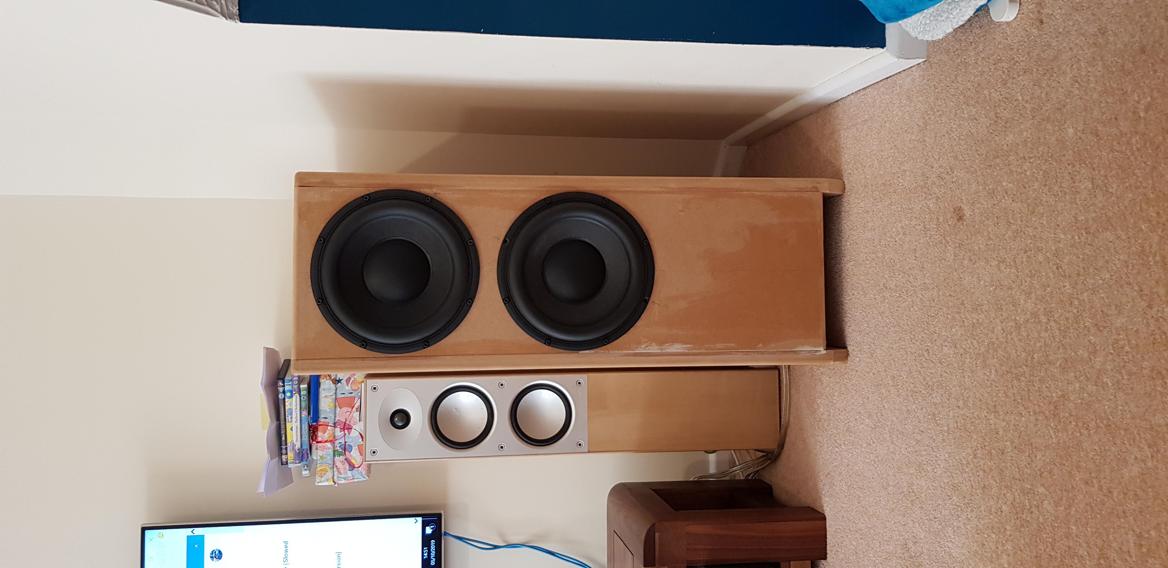

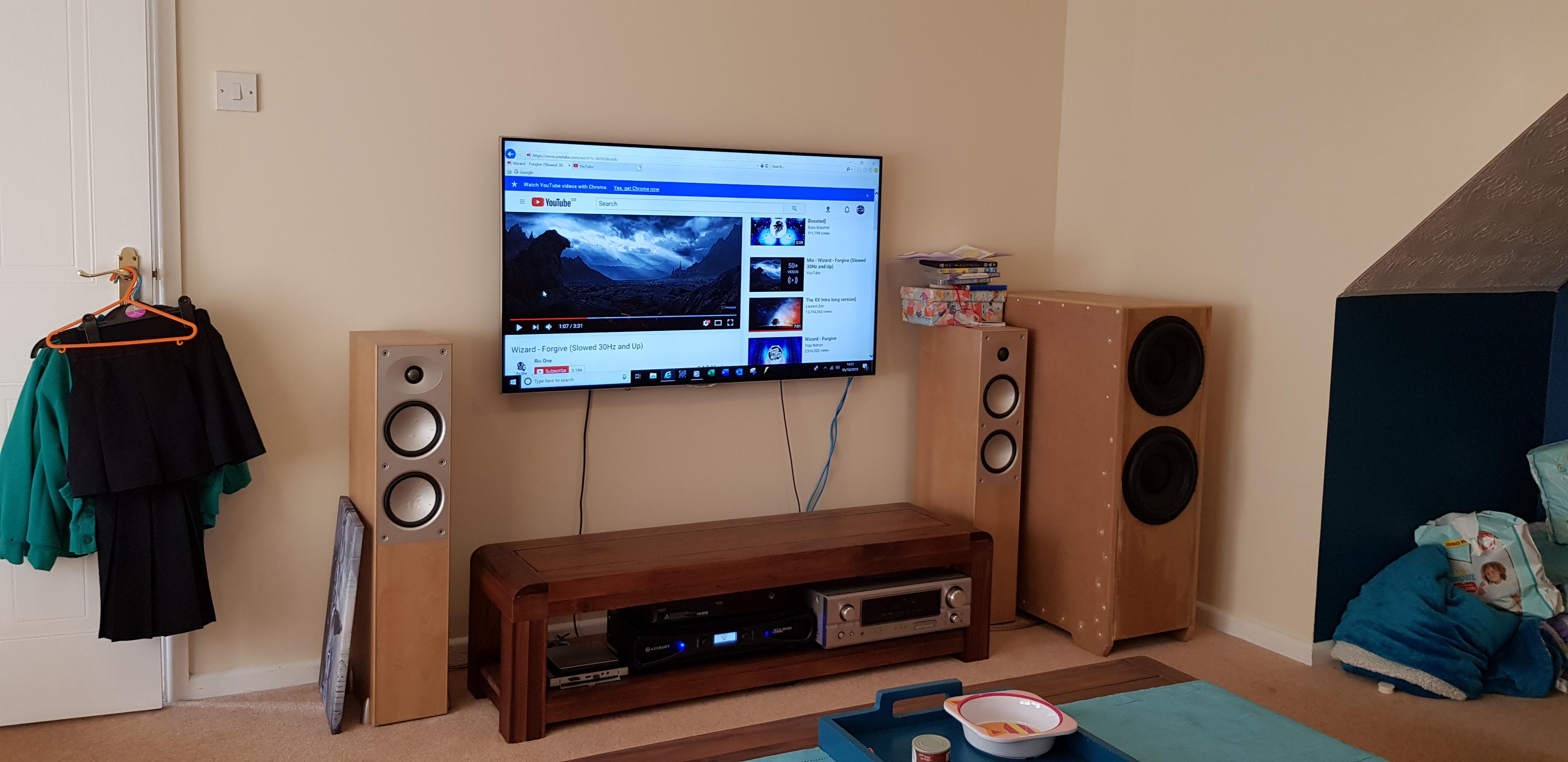

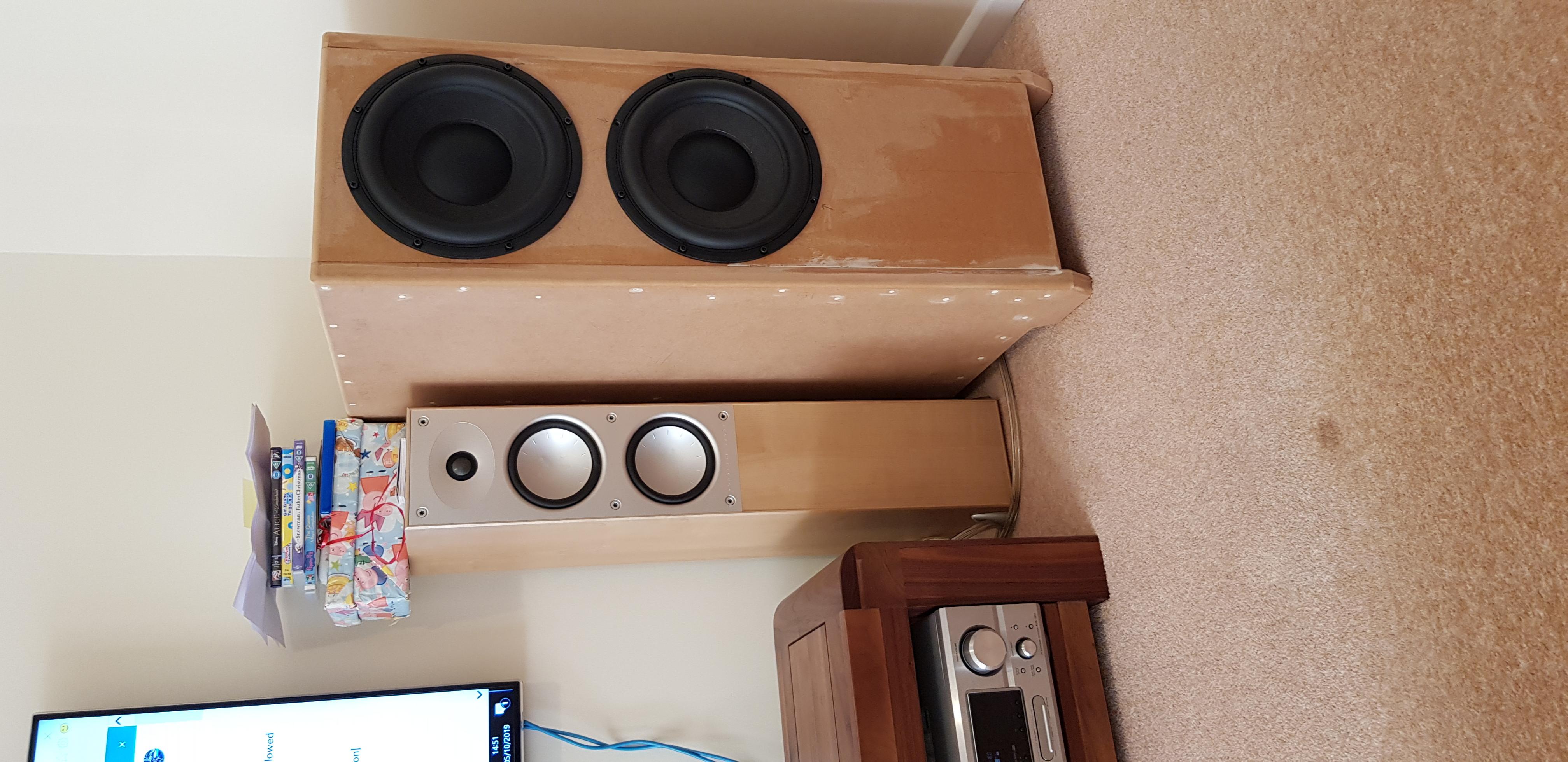

Finally got the box finished today, had a trial this afternoon and was a bit blown away. I dont have a basis for comparison, and maybe my expectations were too low, but playing some electronic music with low frequency content had my sofa and house rumbling. It looks a bit over the top, but I guess that was the point. Painting next ....
