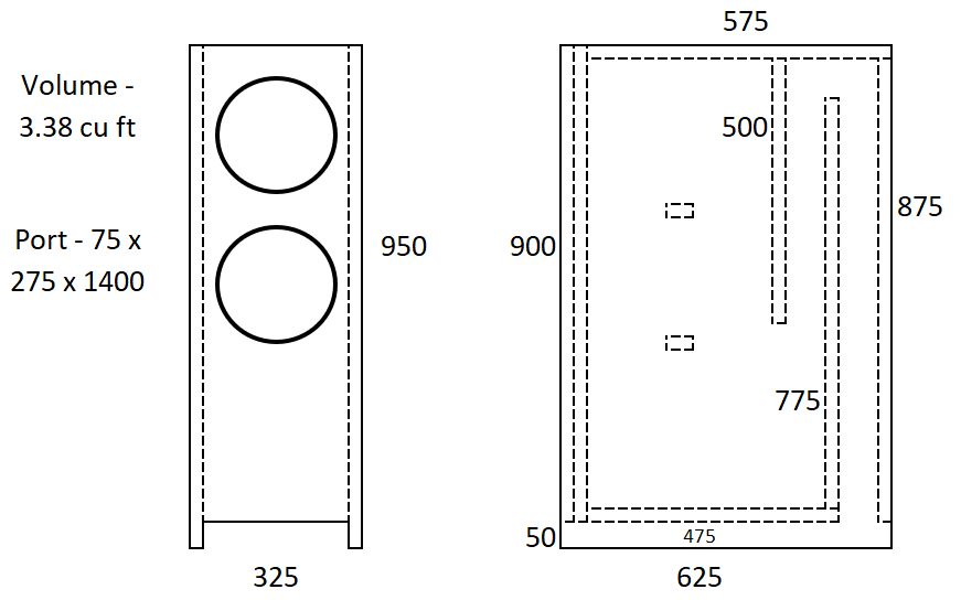

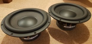

I have two Peerless 830452 drivers which I’m planning to put into a single slot ported enclosure. Picture of both drivers attached. I know I should be building two separate units to smooth out room modes but my partner would not accept this.
I know these drivers are best suited for either sealed enclosures or enclosures with passive radiators, but I’m going ported. One of the reasons passive radiators are desired to compliment this driver, is due to sealed configuration not achieving good LFE due to steep roll off, and the ported configuration requiring very long and large csa ports to achieve good LFE without excessive port noise. Size is not an issue for me, I am only limiting myself by attempting to use a single 1220x2440 (4ft x 8ft) MDF panel. So, I’m going with a 3.38 cubic foot enclosure, tuned to 20.6Hz with a slot port 11 x 3 x 55” long (27.5cm x 7.5cm x 140cm long), which limits port velocity to 21.5m/s @19.5Hz (≈6% SoS @ 343m/s) with 350W on each driver. This slot port has a csa equivalent to a single 6.5” diameter round port, which sounds very reasonable for two 10” drivers. Note: Peerless quote the XLS driver at 150Wrms, however, it’s well known these drivers can handle more, with majority of users running these at double their quoted rated power handling. 350W per driver pushes excursion to 13mm at ≈28Hz, peerless quote the xmax @12.5mm and I’ve seen reports the Xmech is around 20mm so no issues. Cabinet will be 1” MDF all round, with double thickness front baffle. I’ll round over the edges, and will attempt to paint for best finish I can possibly do (fair at best).

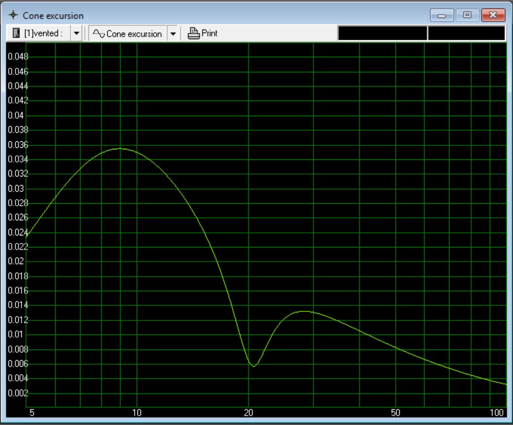

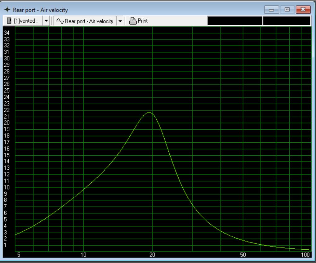

Winisd modelling attached for 350W per channel. Note: No HP or LP filters configured in the modelling, I have however put a second order high pass butterworth @ 8Hz to simulate the XLS natural roll off.
I’ll model it in Hornresp too when I get a chance.

· Can someone kindly verify my design ?
· Any foreseeable issues ? anything I’ve overlooked ?

I'd build a more cube box with the drivers opposing (on opposite faces) so you get push-push and place the slot at the back or bottom. I use the 830452 in a side firing vented design with a down firing port.

Thanks but I'm putting both drivers on the front. I've gone over many different options for the construction, and I require a slim enclosure, but can accept tall and deep. If I put a driver on front and one on the back, I have no idea where the 1.4m port is going.
Plus i just have a personal preference for both drivers to be on the front .... it will weigh quite a lot so I wont be losing too much of the gains from opposed drivers.

I've been using the 830452 sub since 2004 and never had an issue but I only use it for movies where it works a treat. No chuffing or bottoming out with my domestic use (250W plate amp). Some builders have had problems with the larger 830500.

Nice build, liking the huge flared port. What's the tuning frequency?
Fb=27.5Hz

Thanks, I've read the application note before, very informative. I've treated my design like a numbers game, and have designed for flat response down to 20Hz. How this performs "in room" with room gain, will be interesting to see once I'm able to afford a calibrated mic. My main goal was for flat response over the audible range (down to 20Hz), primarily for electronic music, and secondary to that - also for movies.

I'm not planning on boosting anything, the design is such that the response is flat in the audible range. Ported designs cant compete with sealed for subsonic extension, and I cant boost in the subsonic range due to mechanical limitations of the ported designs. Plan is to use a minidsp parametric equalizer to tune out room modes, but this would typically involve attenuating the peaks in frequency response caused by the room, to eliminate the boominess which is an unavoidable consequence of achieving flat response to the lower end of the audible spectrum. This will be once I get a microphone and use with REW.
