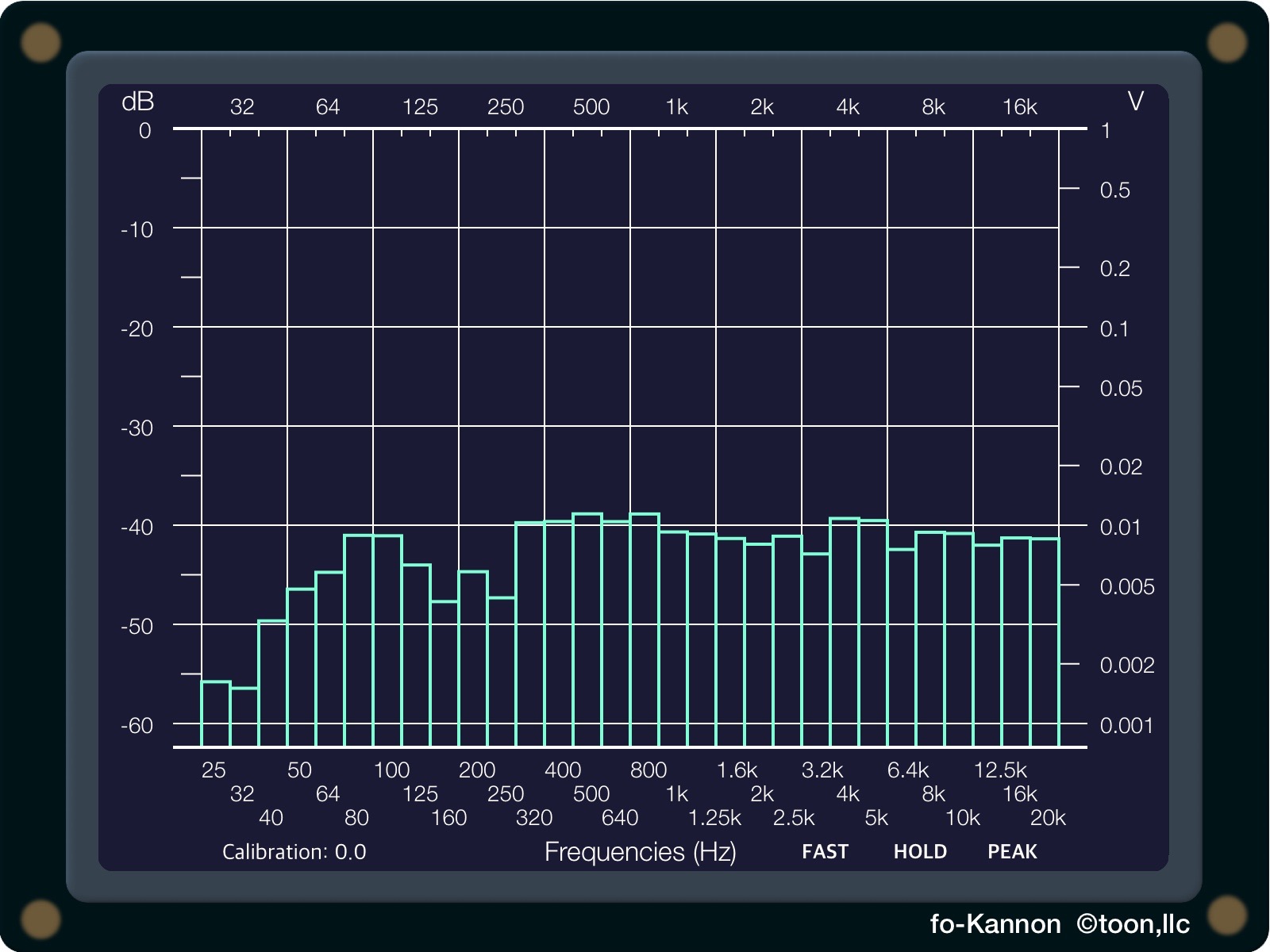

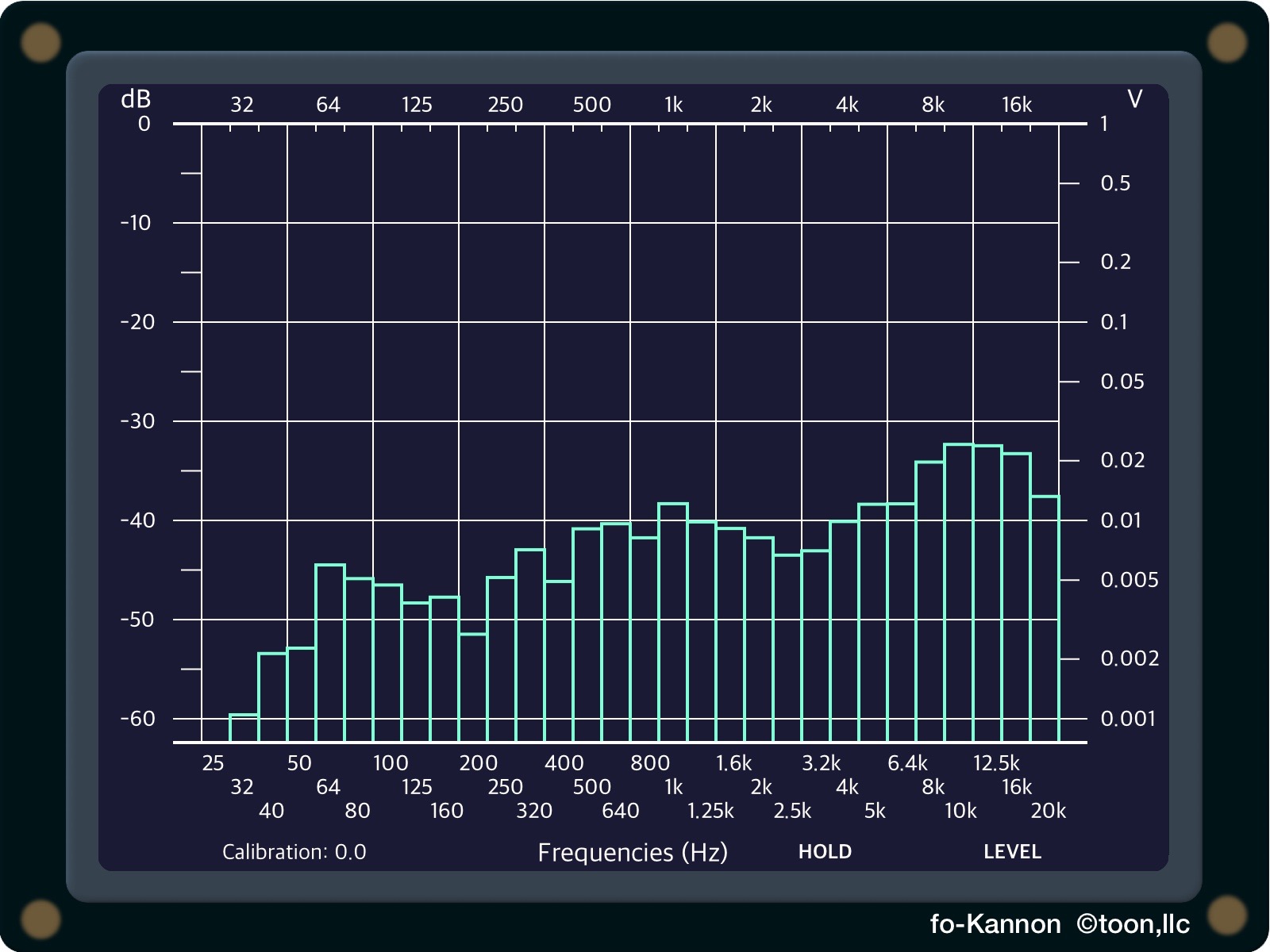

Yes, all measurements were taken with the same set up. The mic was centered about halfway up the speaker, one foot away. Don't think any of the panels are wired out of phase, but will check just the same to make sure. Both left and right speakers showed the same dip, even though they're located in different parts of the room. If the measurements are taken farther away, say three feet, would that give you a better idea of what's occurring?
Bolserst, thanks for looking into this.
...The mic was centered about halfway up the speaker, one foot away.... If the measurements are taken farther away, say three feet, would that give you a better idea of what's occurring?
So, the measurement with the dip was taken 1ft from the panel as well?
Yes, measuring at further distances from the speaker will help better understand.
How far is your listening position from the speakers?
For starters, try 3ft and 6ft with mic centered as best you can on the middle panel.
- Measure just "Group 1" panels
- Measure all panels driven
Use 1 ohm series resistance for all measurements.
Yes, the dip measurement was also at one foot. I listen approximately 10 feet away, but sometimes at 12 feet.
Attachment 1: Center panels at 3 feet.

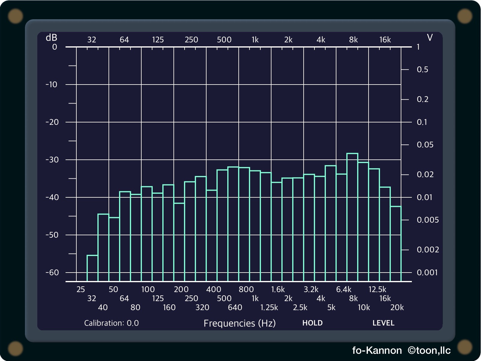

Attachment 2: Center Panels at 6 feet.

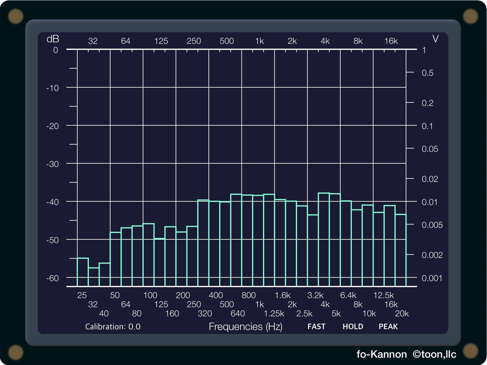

Attachment 3: All Panels at 3 feet.

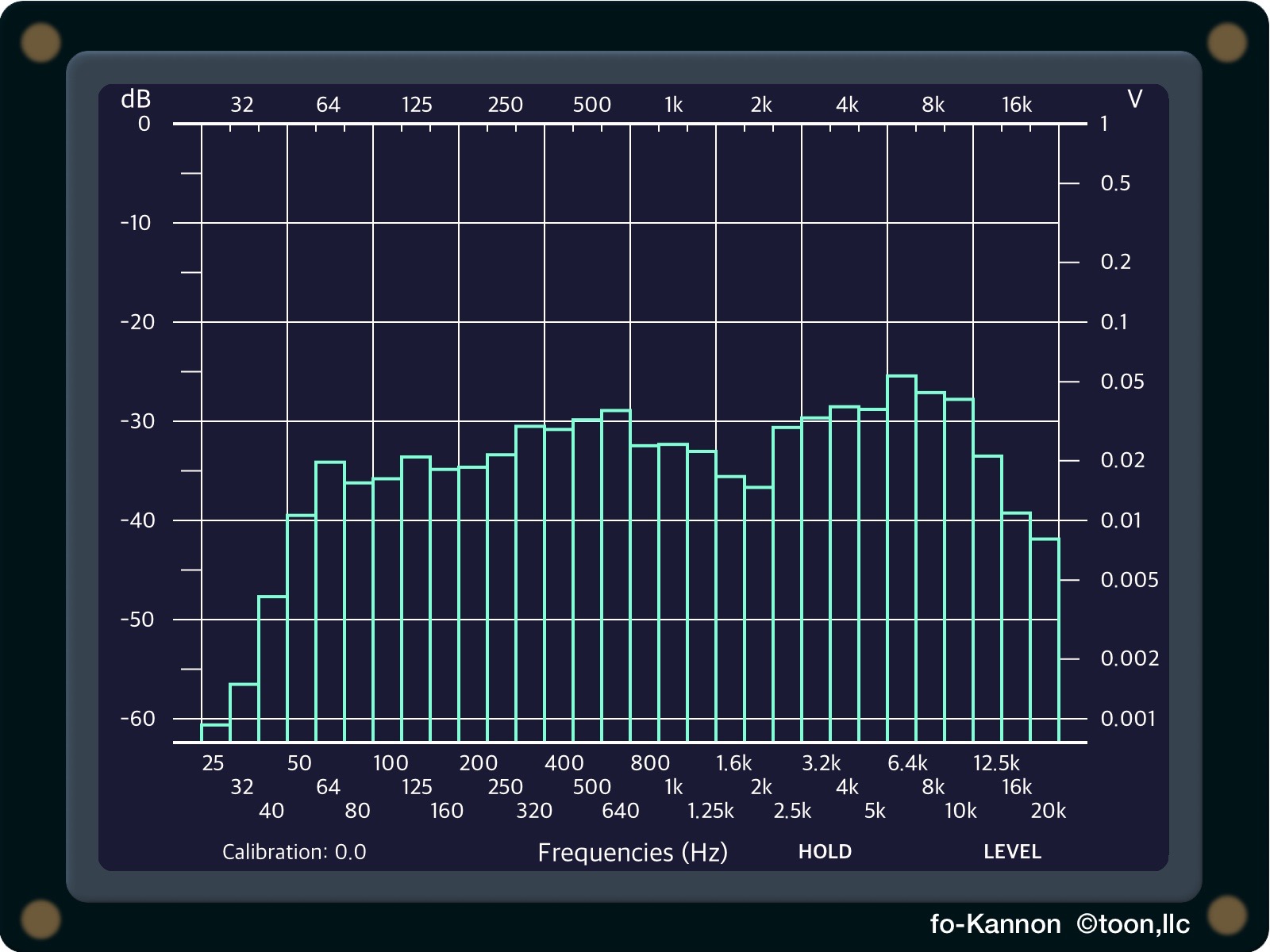

Attachment 4: All Panels at 6 feet.

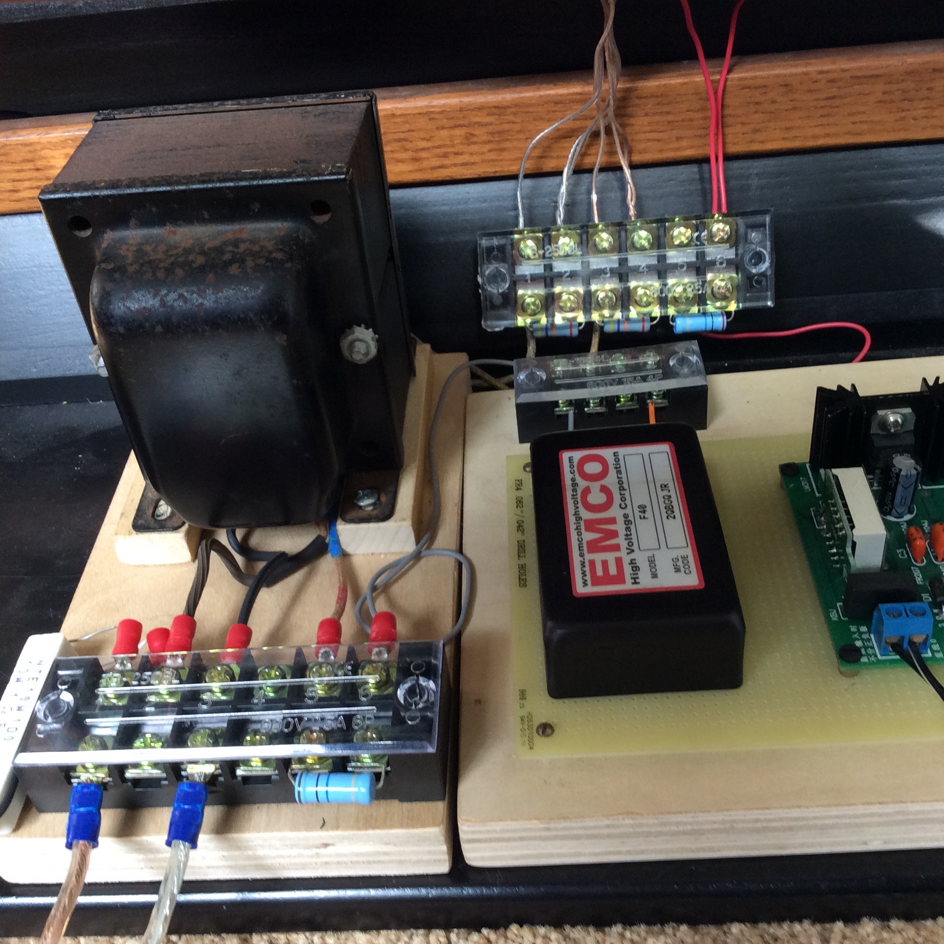

The amp I am using puts out a good 130w pc. On the Scott OPT's, I used the two highest voltage measuring leads, which happened to be the 8 and 16 ohm taps. Mistake? As you mentioned, the ESL secondary leads are bad:
Good OPT Bad OPT
r-blu 144 ohms 116 ohms
r-br 158 ohms 67 ohms
blu-br opn 83 ohms

…The amp I am using puts out a good 130w pc. On the Scott OPT's, I used the two highest voltage measuring leads, which happened to be the 8 and 16 ohm taps. Mistake?
Yeah, you were probably pushing your luck a bit there.
You may recall from your transformer thread the suggestion to keep power < 30W if using step-up options other than the 4 ohm input.
Good OPT Bad OPT
blu-br opn 83 ohms
If I am understanding your measurements correctly, you are saying the Good OPT measures open between the blue and brown wires? Should have been the sum of your other measurements (144 + 158) = 302; you might double-check it. Unfortunately, the measurements for the Bad OPT indicate you have some shorted winding layers in the secondary…not fixable like an open winding termination joint would have been.

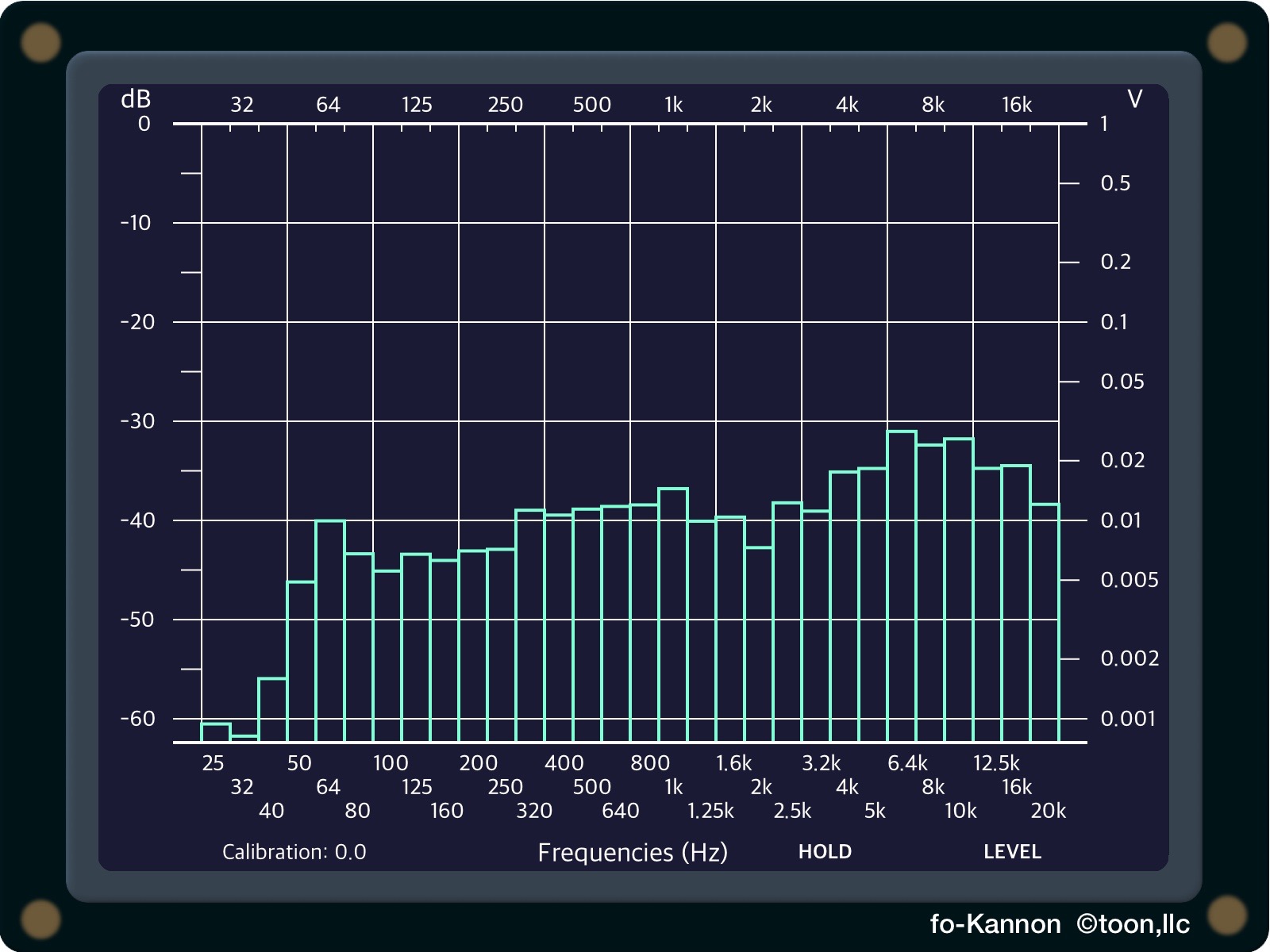

As you can see in the graph below, the 50k seems to have evened out the higher frequencies nicely, but I now have a more pronounced dip in the 100 to 250hz region. I have moved some furniture around, so perhaps that's an influence? Phase cancellation, more equalization needed?

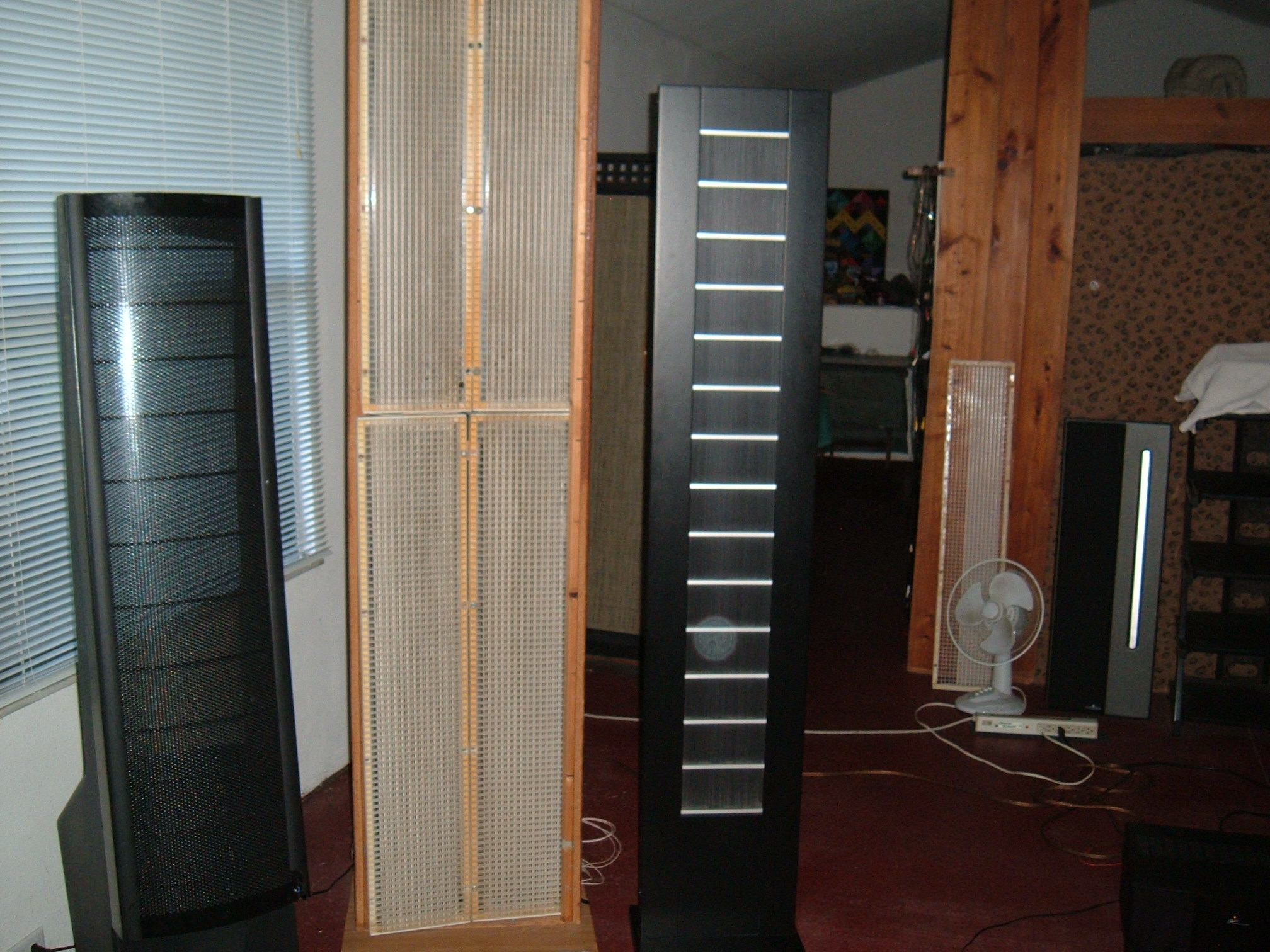

One good thing...it well only take a min..to hear what the felt well do..So I just lay it in... but that's me...
I have these Audiosats..thay use silicone dots nothing on the back..only .segmented panels I have ever owned....this ESl type of sound is not for me.....have fun
...I like the look of the old Magnepan frame...
the dot in the pic come from the camera.....

Moving furniture around certainly can modify the room response, but I think you are probably correct that the dip you are seeing is from un-equalized roll-off from dipole cancellation. Did you have your bass control adjusted up for this measurement? Post#23
If so, take another measurement with the bass control adjusted flat. Then we can design a simple shelving filter to flatten out the dip area.
See the last link in section 3) from Post#17

Interesting.....Having been gone for a while and returning to listen with 'fresh' ears, the speakers at first sounded just a bit brighter, but are now back to how I remembered them. Ears can sure be fickle sometimes.
The first attachment is the speaker's response with tone controls set to flat. The second is with the bass control all the way up. Did this for the fun of it. The low frequencies look better, but sound wise the boom effect begins slightly again....more flabby sounding. I prefer them with the bass about half way up, which should be around +3db @ 100hz. This was the setting in the post #50 measurement. All tests have been done with the mic centered about halfway up, three feet away.
...Ears can sure be fickle sometimes.
Ain't that the truth. :boggled:
The first attachment is the speaker's response with tone controls set to flat. The second is with the bass control all the way up...All tests have been done with the mic centered about halfway up, three feet away.
Thanks for the measurements and setup details.
Can you can tell me the make and model of your power amplifier, or what its input impedance is?
With that info, I will see if there is a simple passive filter you can wire in between your pre and power amp that will help fill in that dip in the mid-bass.

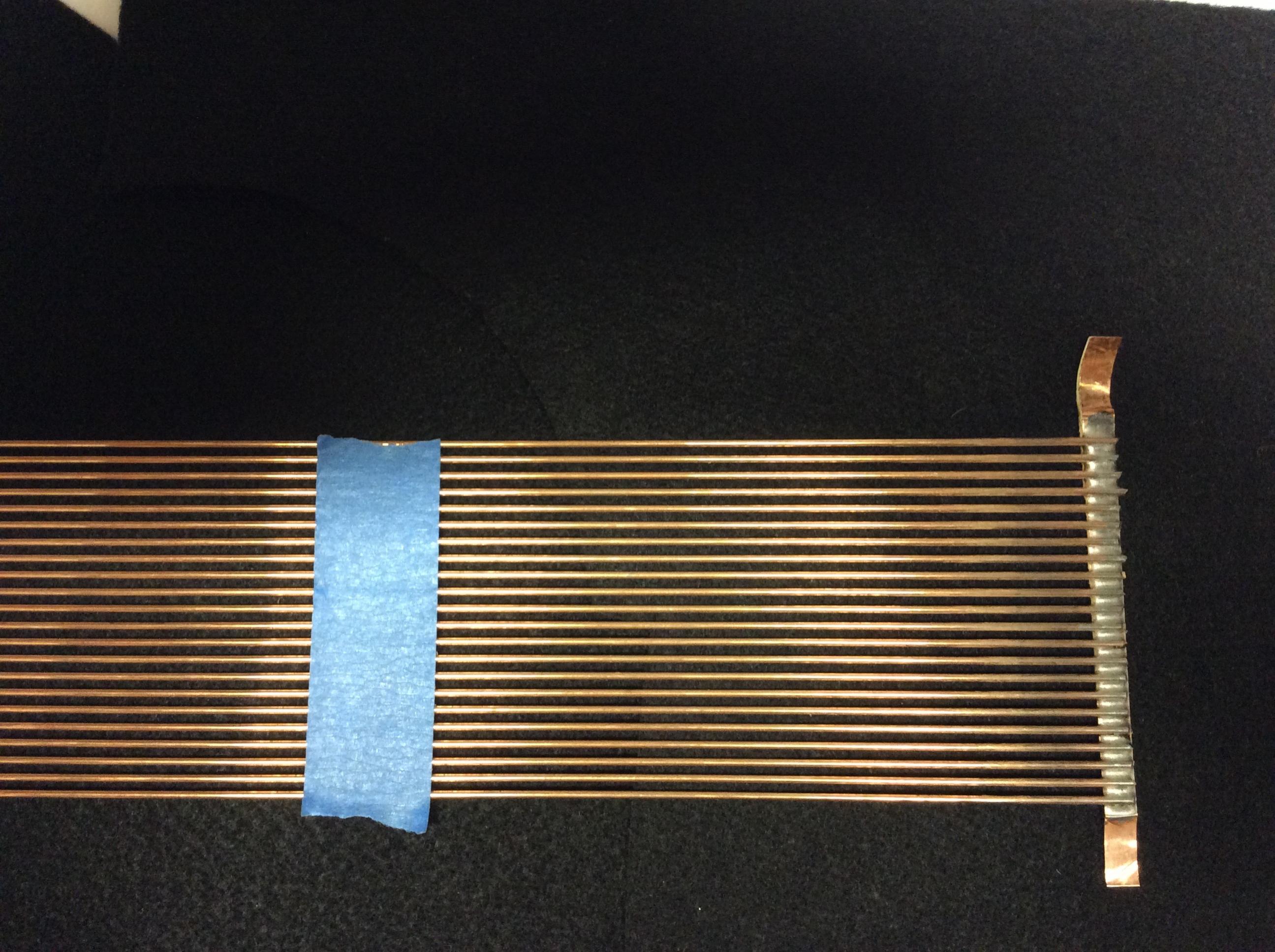

On to the build summary, starting with problems and issues I've run into:
-The biggest problem has been the bottom 7" horizontal panels; arcing and stator to diaphragm contact. They were actually an after thought as there wasn't quite enough space for a full 7" vertical addition to the existing bottom frame. To increase the surface area for possible bass augmentation, there was enough room to add the horizontal panels. I'm not sure what the causes were, but I think the longer 7" span was too much for the semi flexible ABS to handle, especially with the weight of the other three vertical panel assemblies pressing down on them resulting in the ABS bowing. I tried stiffening the plastic with aluminum bar strips and bracing the wood holding frame with extra wood blocks. Helped, but still occasional arcing. In another thread, Bolserst had mentioned he used FR4 for his latest panels. So I gave it a try and it worked. Much more rigid than ABS, a bit more difficult to work, and more expensive. If I were to rebuild all the panels with FR4, it would add about $100 to the total cost of the build, but think it would be worth it. Plus aesthetically, the horizontal panels just don't fit in right. Sometime in the future I'm going to try to shoe horn 3 vertical 7" panels. We'll see.
The second issue has been some mylar crinkling on a few of the diaphragm corners. Extra heat shrinking fixed most of it, but a few have been persistent. On one of the cells it was necessary to place a piece of Scotch tape on the mylar to insulate from the stator.
There have been other problems, most being stupid and/or ignorant mistakes. My biggest regret was forgetting the OPT wiring recommendations of Bolserst, and ruining one of the Scott trans. But after testing them and discovering their output, I got so excited that I forgot about his cautions on how I should have configured them.
-Things I would or might change:
Besides replacing the ABS with FR4, I'd probably start the progressive sized cells at 4" instead of 2 1/2" to end up with a two cell vertical 7" panels on the bottom, adding a little more weight to bass response.
While the aluminum cross bars look nice, I've read they add unwanted capacitance. I would replace the aluminum with 1/8" x 1/2" FR4. I've already experimented soldering stator wires to copper tape, so all I would have to do is glue the assembly to the FR4 cross bars. See attachment 1.
I might try stretching the mylar before it's glued to the panel frame to see if that helps the crinkling issue. And I might try Licron spray instead of graphite. I don't know. On small panels like these, graphite is actually very easy to apply(although messy), it's cheap, and has a known permanency.
