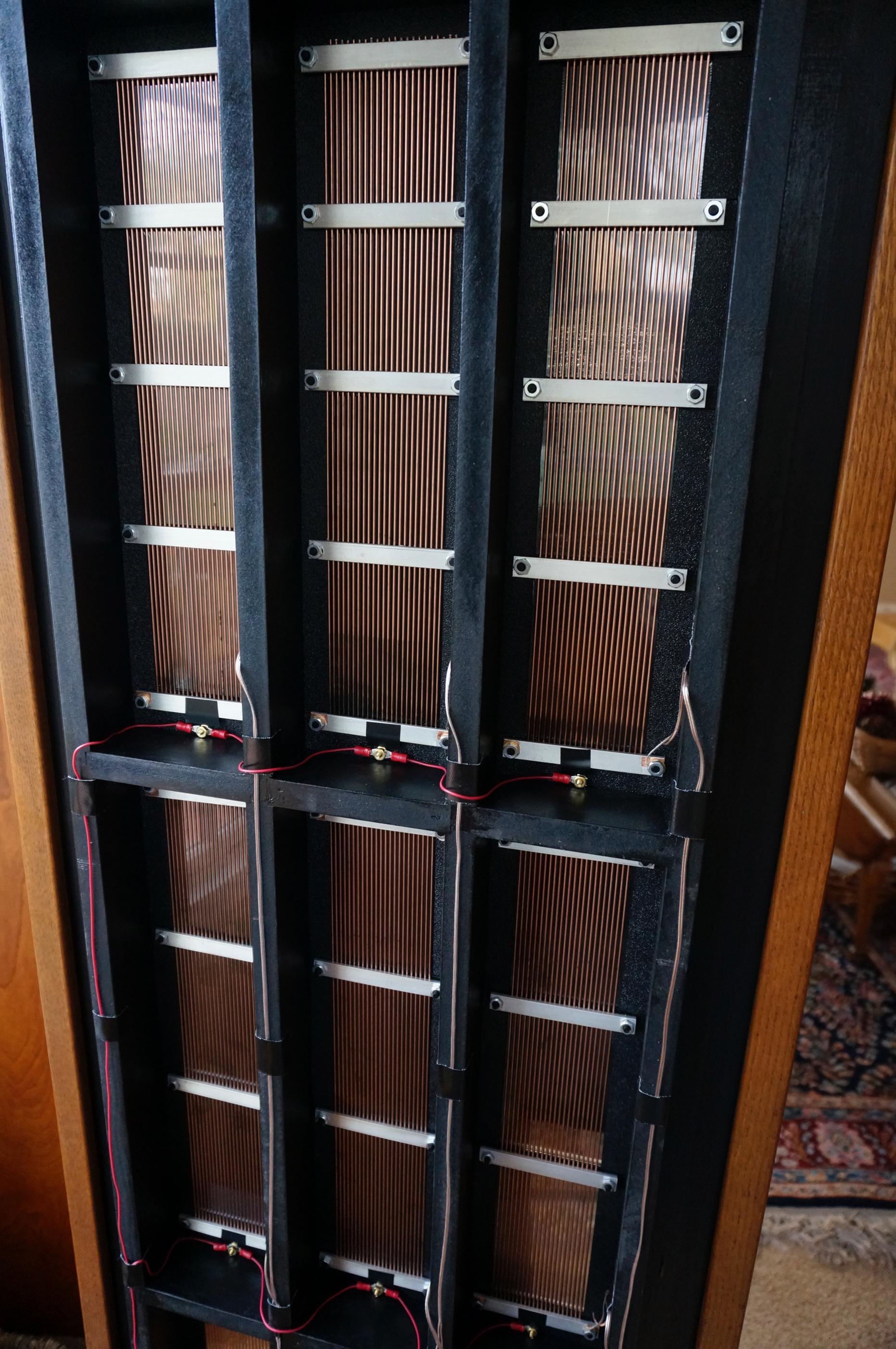

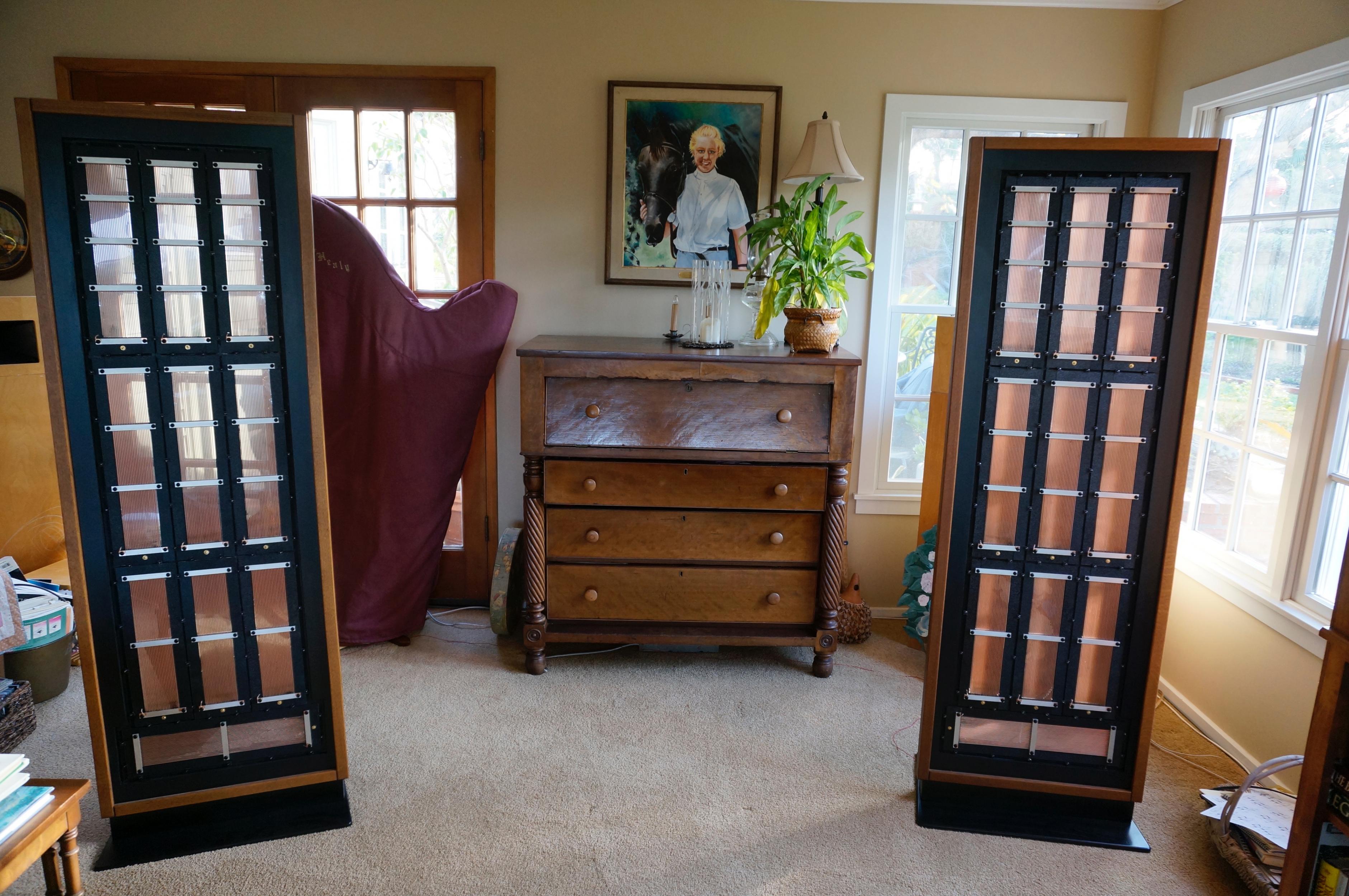

Hello All,
Don't know if this is the proper description of this type of ESL; where the diaphragm size gradually gets larger from top to bottom. Something akin to a Sound Lab speaker.
As with most flat panel ESL's, my previous ones were very restrictive in listening position; I needed a tennis ball strategically hanging from the ceiling where my nose should be for optimum imaging. An inch side to side was noticeable and could become very tiring.
From reading several post at DIY on dispersion it seems I had three choices to broaden the 'sweet spot': 1-angled or curved panels, 2-segmented wire stators using resistors to vary the frequency, or 3-decrease the size of the radiating area.
I knew curved was out of the question for my abilities, while angled panels might have future possibilities. Segmented stators showed promise, but for my limited knowledge of electronics seemed a little too complicated, especially for the type of wire stator I'm familiar with building. That left smaller 'cell' panels which I thought would be the easiest to build, but at the cost of diminished output and bass response.
A review on a Sound Lab speaker made me think that gradually increasing the size of the diaphragm possibly could help with the two issues of smaller diaphragms. I am sure I've read posts here at DIY that question the effectiveness of this design, but figured it might be fun to give a try. It was never the intention to build a complete system initially, just a few experimental panels to start out. However after making the jigs and templates, I found myself in full production mode. Having a blast. Just like a kid building a giant model kit.
Had no idea of proper sizing, specs, formulas, etc.. Just dove into it. From a little research, a 3 inch width sounded like it should work well. The Sound Lab reviewer seemed to think that the length started out at 2 1/2 inches so thats where I began. I just randomly chose a 1/2 inch increase for each diaphragm. Since I wanted to reuse my existing Magnepan wood moulding and base, the 1/2 increases took me down to a final diaphragm length of 6 1/2 inches. I later added a two cell panel of 7 inches horizontally(still not sure if that was a mistake).
For ease of construction(although much more time consuming!), smaller plastic panel frames were used. All are 5 inches wide and average around 17 inches in length. I figured this way if I ever wanted to add on I could build more, or eventually have two rows facing forward and one row on each side slightly angled for even better dispersion.
I'm a slow typer and getting a little tired so will give some detailed impressions later. I will say this, though, the sound output is diminished, but not by much. The bass response is lower than the older panels but inconsistent. The dispersion is greatly improved! I can now swing the tennis ball a foot side to side. More importantly I can wake up from a stupor in my listening chair with my head nodded to one side and still be hearing a good image.
Below are a few pictures. Wished they were more clear, but the camera didn't always like focusing on the stators. Will post more if there's interest. Any comments or suggestions are greatly appreciated.

Hi Bondsan,
I love the cleanness of your design. I am somewhat familiar with Soundlab's "distributed resonance" scheme but I've never had an opportunity to hear their speakers play.
As I recall Soundlab applied for a patent on it which included a quite detailed description with illustrations-- so you might try searching for that. I'm not sure if the patent was granted or may have even been revoked, however, as there was controversy over who actually came up with the idea. Basically, I think, it breaks up the diaphragm's drum head resonance such that, instead of having a really loud resonance in a narrow band of frequencies, you get a bunch of less loud resonances spread out over a wider frequency band. And the resonances are used to boost up the bass band overall, above what it would have been with a single/un-sectioned diaphragm.
I also recall some comments by Roger Sanders rejecting the distributed resonance approach on the basis that the multiple resonances remain high-Q, uncontrolled motion distorting a wider bandwidth.
ML also applies the distributed resonance approach on their hybrid speakers, I think to boost up the midbass a bit and prevent the suck-out effect.
Your speakers are very neatly done. Since your panels are wire stators, I'm sure you could still apply the electrical segmentation scheme, with only slight modifications. I'm a complete dummy with electronics myself but Bolserst's Excel calculator makes it easy.
Beautiful speakers!
Jazz

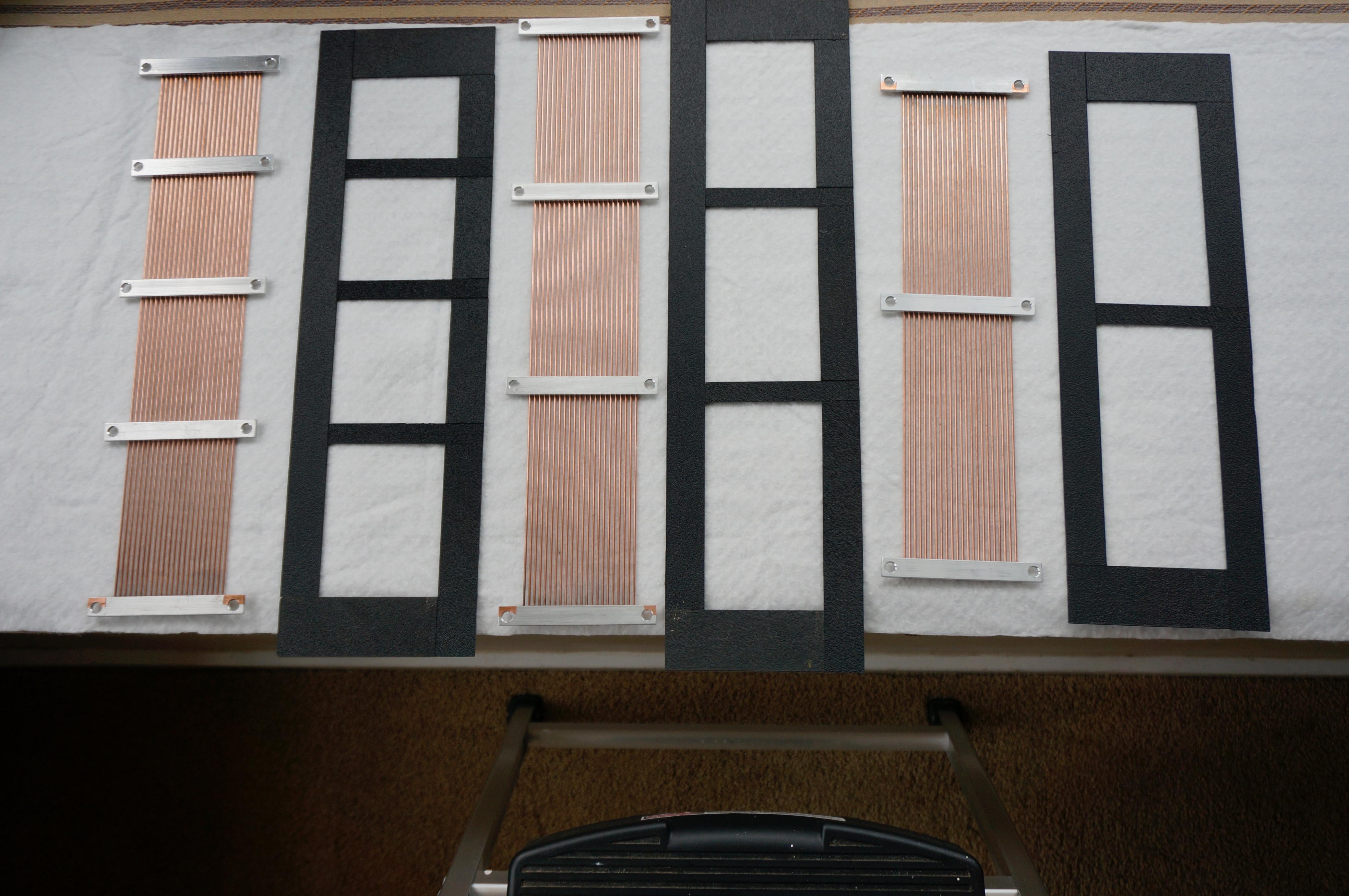

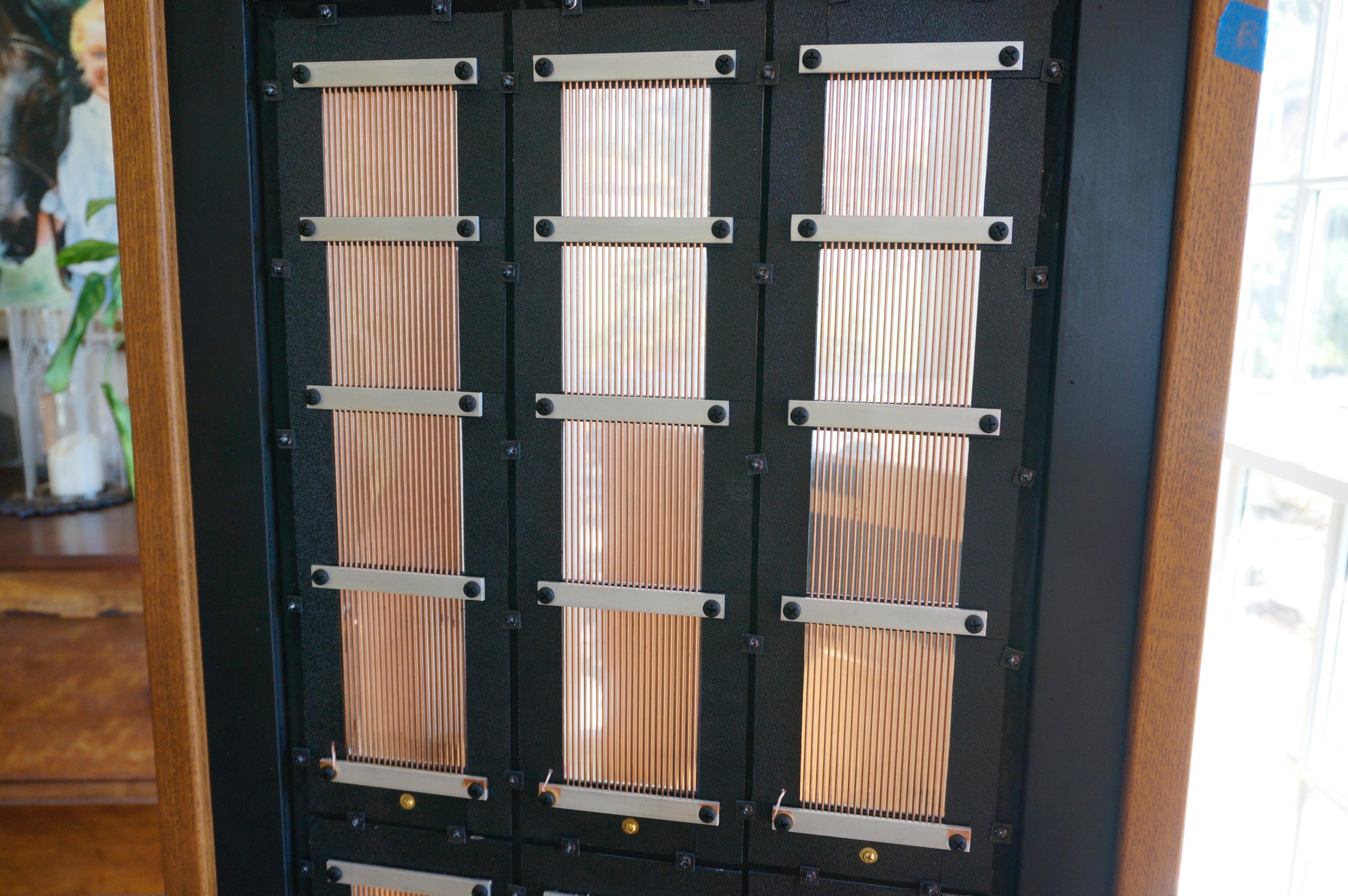

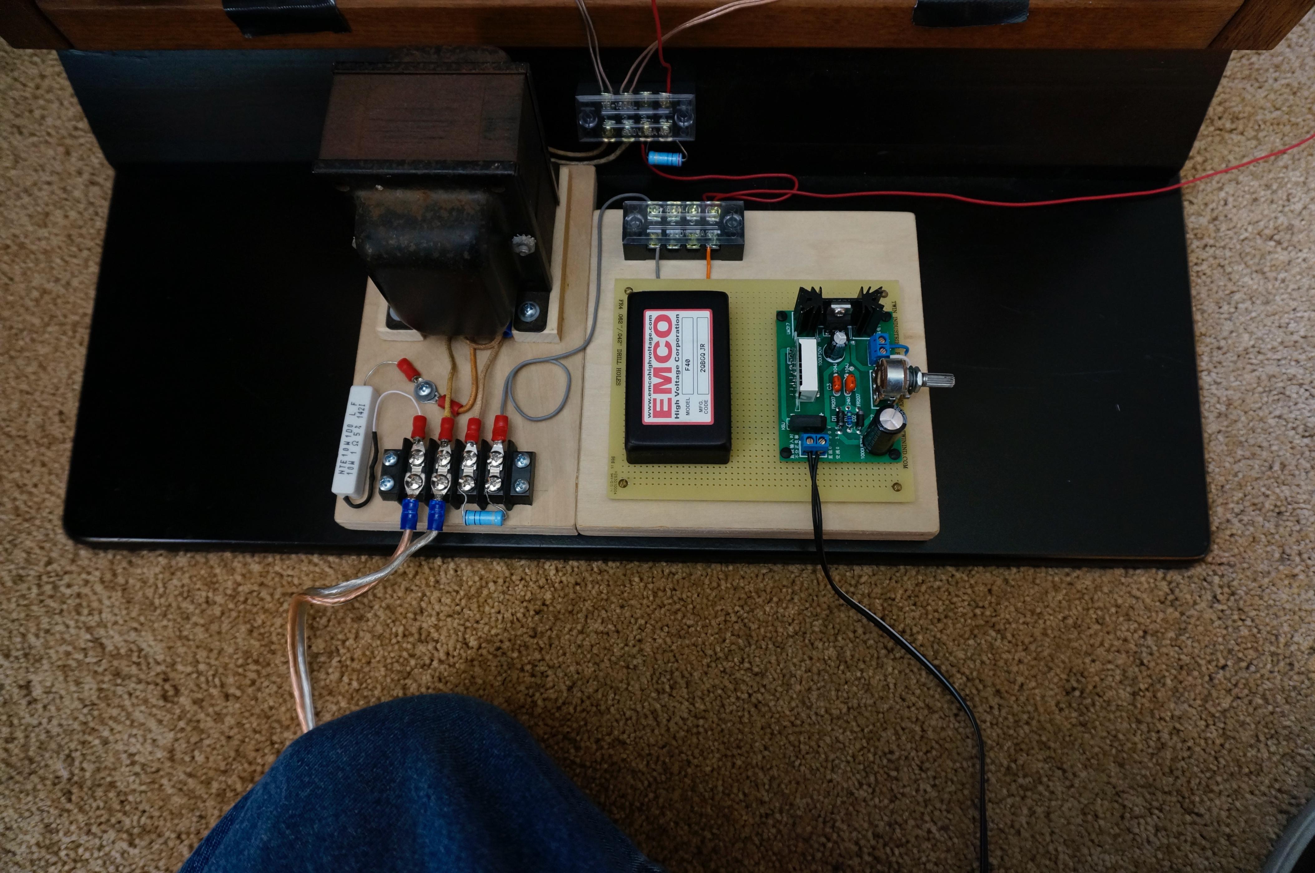

The transformers are OPT's from an old Dyna ST70. From much help here, especially Bolserst, I was finally able to set them up correctly with the bias supply. They only have a small turns ratio of 1:45 but sound just fine. I may change or add onto them in the future. The bias supply is an EMCO F40 HV unit controlled by a LM317 module. The EMCO was $55 on Ebay, and the LM317 was around $15 from Amazon. While not cheap, the price was reasonable for an easily assembled adjustable power supply, especially for a person like me with limited electronic knowledge. I've notice the same Ebay seller now has some 'B' stock F40's for only $40 and a few E40's for only $30. I bought a second 'A' stock F40 for possible future use about a month ago, but guess I should have waited.
The stators are made with RG45 1/16" copper coated welding rods epoxied to 1/8 x 1/2" aluminum bars. The bottom stator bar has a 1/4" copper conductive tape across it that the rods are soldered to for continuity. Their construction is very time consuming, but fun. The diaphragm frames are made out of ABS plastic; very easy to work with compared to polystyrene-terrible stuff. I will post some notes and pictures on the construction later on. Below are pictures of the bias supply and the stators with their corresponding ABS frames. Thanks for your interest.

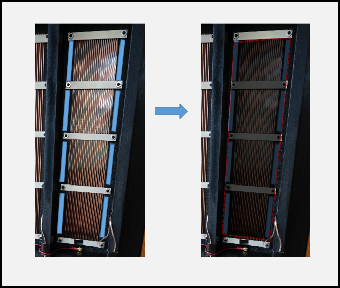

…I like your idea of possibly segmenting the panels. There would only be 10 segments, but any improvements are always welcomed.
As a first experiment with segmentation, I would recommend splitting the panels into 2 groups as shown in the attached pic. Group 1 would be connected directly to the step-up transformer. Group 2 would be connected to group 1 through a resistor. Although it is only 2 segments, it will provide a nice improvement in dispersion. If you can tell me the thickness of your spacers that set the distance between the stator rods and the diaphragm, I can calculate the resistor values for you to use.

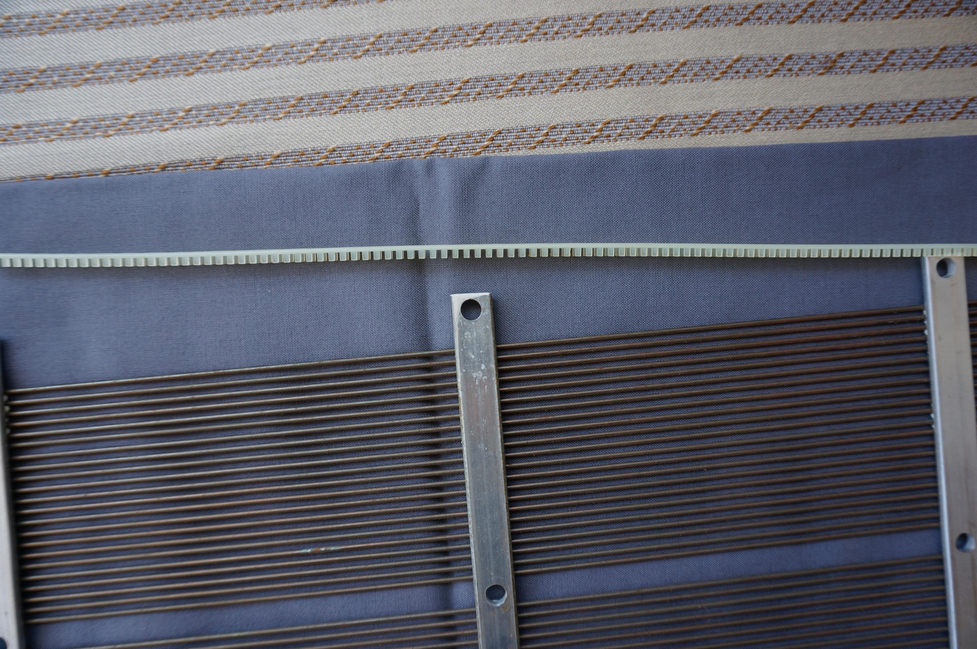

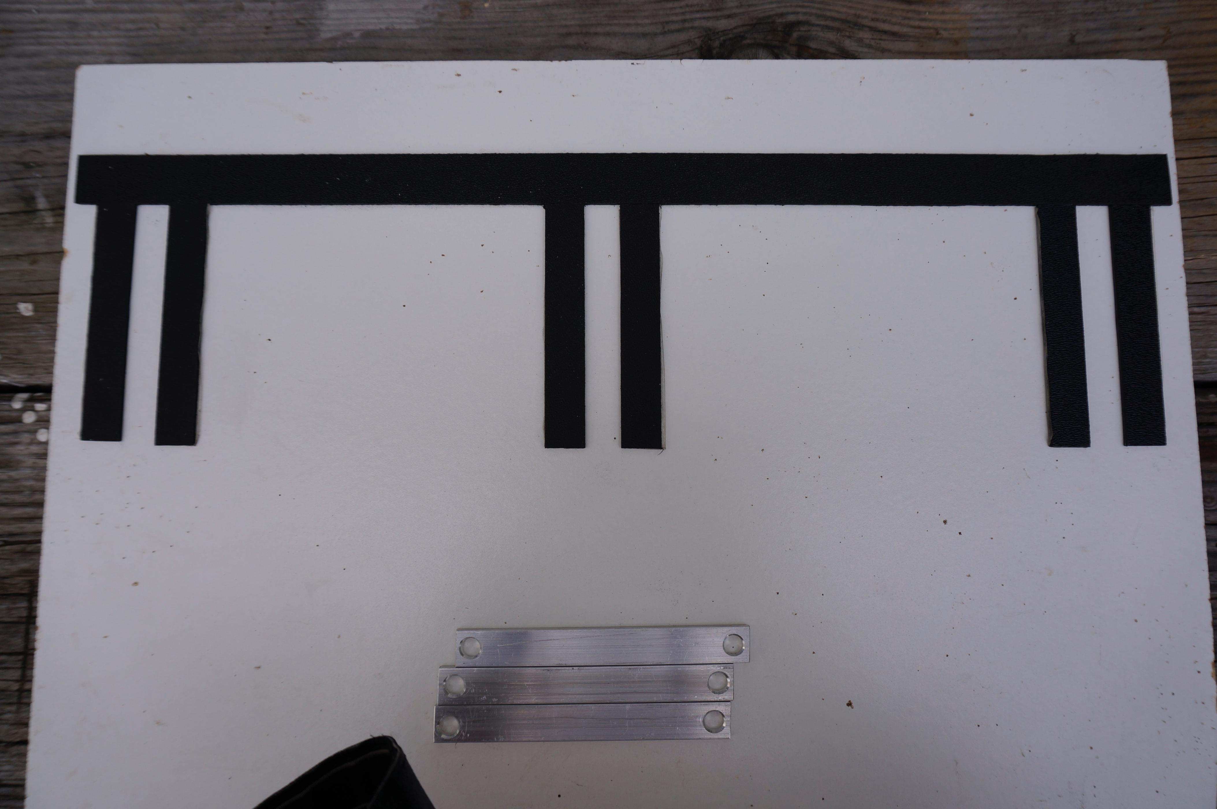

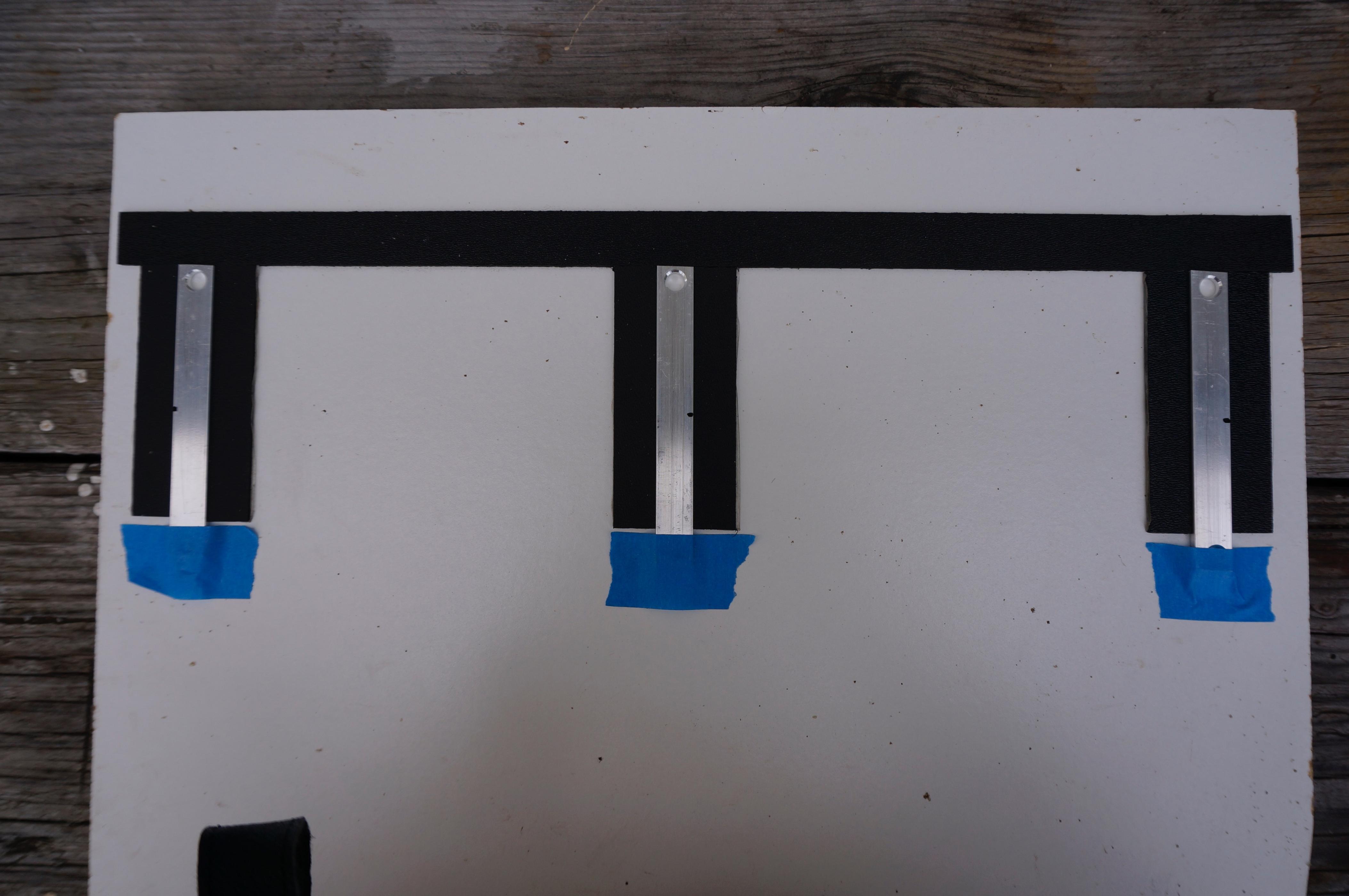

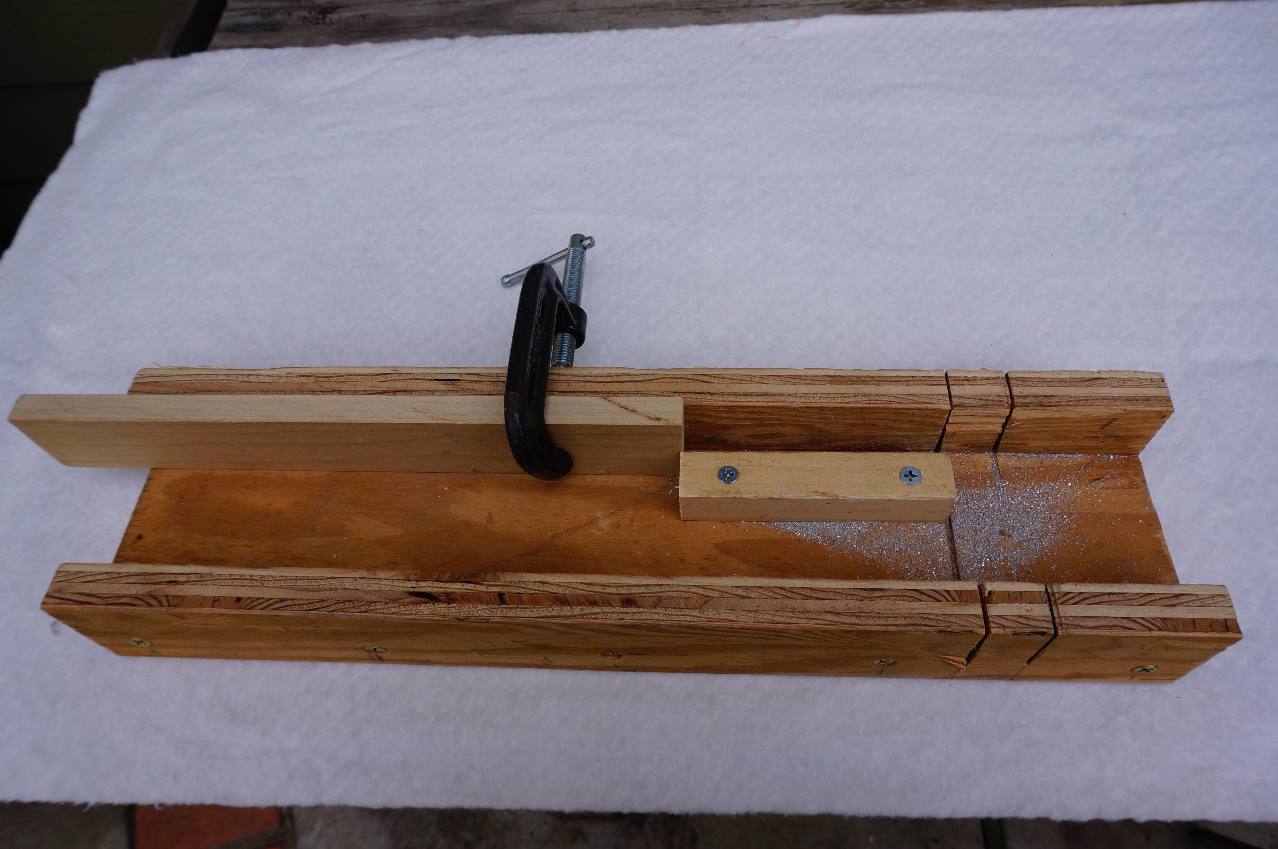

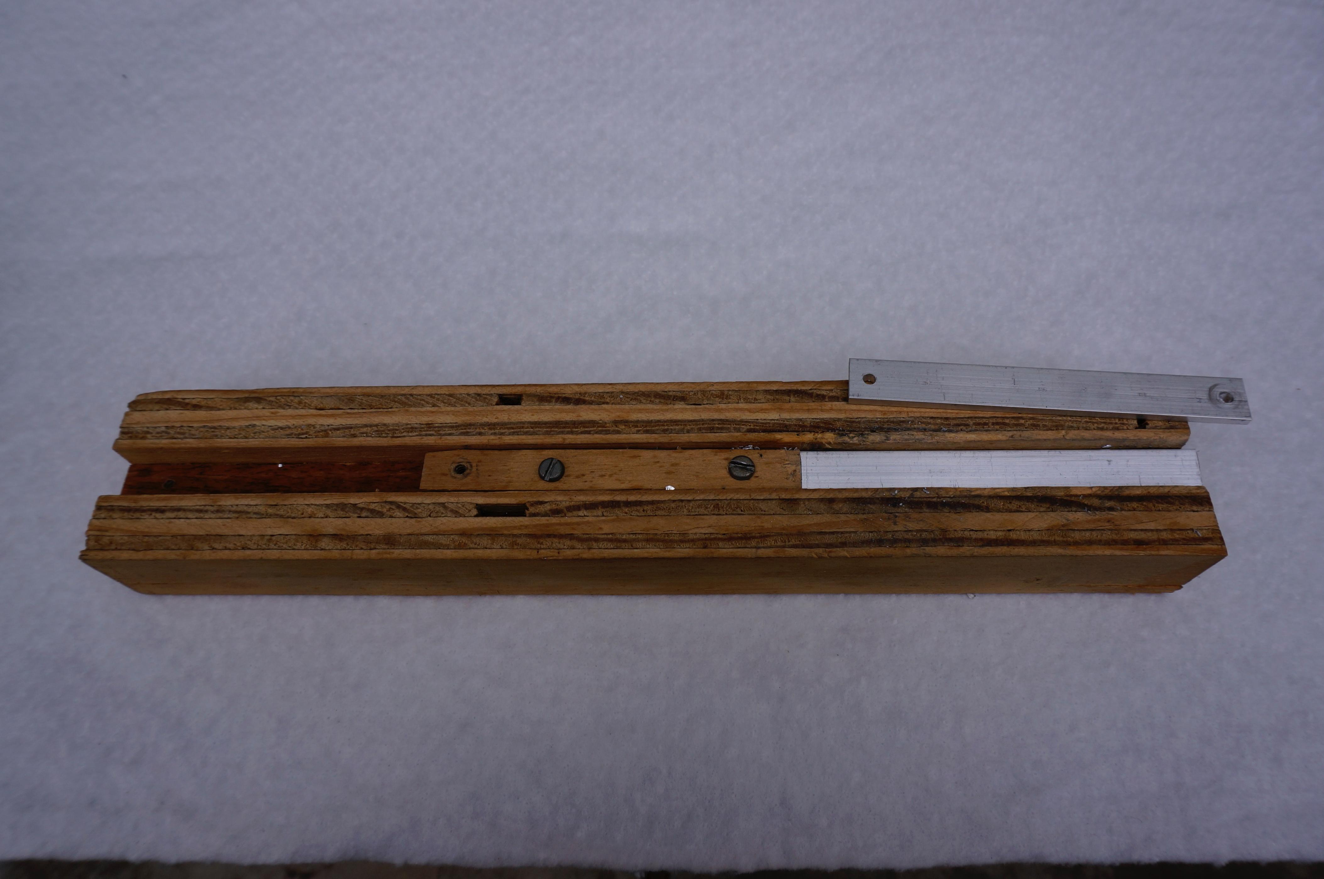

As far as construction goes, why not start with the most time consuming and difficult portion of assembly-the wire stators. As mentioned previously they're made with 1/16" RG45 copper coated welding rod and 1/8 x1/2" aluminum bars.
The aluminum crossbars are the most tedious and boring to construct since in my particular design over 150 bars were needed. Yet they are the most important piece in the stator construction as they need to be made fairly accurately in order for the front and rear stator assemblies screw holes to line up.
The bars come in 12 foot lengths and had to be cut into 4 inch pieces(the diaphragm width is 3 inches and at least 1/2" overlap on each side of the plastic frame is necessary. However, the next stators I build will have at least 9/16" so the screw holes are not as close to the edge of the frame). The first attachment below is the homemade miter box used to cut the bars. At first they were cut one at a time with a hacksaw, then two at a time, then five using a Sawzall.
Now comes the real tedious part; the screw holes, but the most important key. The second attachment below is the crossbar jig with one of the many bar templates needed( the holes become too worn after about twenty to thirty uses). The first holes from the templates are 1/8' pilot holes. They are then drilled out to 1/4" and slightly counter sunk to remove any burrs. After a while you kinda get to know which bars won't work. I could only make about twenty or twenty five at a time without becoming tired. I'd then go work on another project. If I had a drill press it would have been much easier and more accurate. The next time I'll use one, even if I have to get it from Harbor Freight.
The third attachment is the crossbar jig to hold the bars in place as the wires are glued. It is made out of melamine shelving and strips of the 1/16' thick ABS plastic. The melamine is very flat and has a semi smooth surface thats works well with the double sided tape that holds the ABS strips securely. Once you know the distances for your crossbars, you carefully lay it out on the melamine, making sure all is square and aligned(very important!). Scor-Tape works great for holding the plastic strips down, and if need be, can be pulled up if some miner adjustments are required. The bars should be a snug fit but not too tight, just enough for the bars to slide in and out easily.
Fourth attachment. The bar strips should be about 1/2" shorter than the bars so that when the wire glue has dried, the assembly can be lifted off the jig. Since the ABS is 1/16" and the crossbars are 1/8", there is enough clearance for the glue and wires. A little masking tape on the ends keeps the crossbars in place.
Fifth attachment. The wires on the jig. How they got there will be the next chapter.
Bondsan

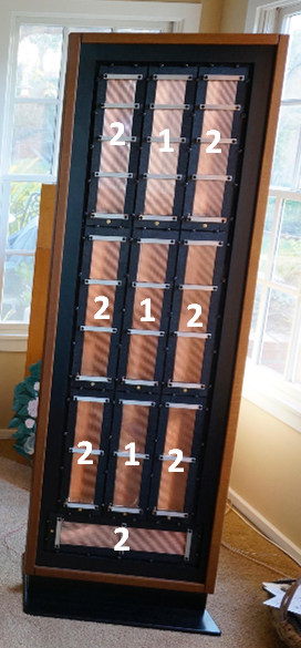

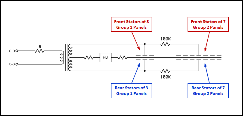

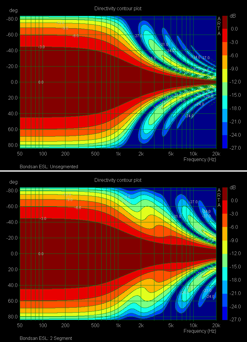

Here are the details for modifying your panels to a 2 segment design.
The 10 panels are split into 2 groups as shown in the first pic.
The schematic shows how to connect the two groups with two 100K resistors.
With your step-up ratio, you can use any 2Watt or larger metal oxide or metal film resistor.
The directivity plots show the improvement in dispersion.
Sweet spot will be widened and the music will sound much more balanced when walking around the room outside of the sweet spot.
Almost forgot to mention, since this segmentation reduced the effective radiating area in the top octaves you will likely need to change your primary damping resistor back to 1 ohm. You had mentioned increasing it to 2 ohm to address the overly bright response.

Hi Bolserst,
Thank you so much for taking the time to design and calculate the conversion of my ESL's over to segmentation. Looking forward to the improved sound.

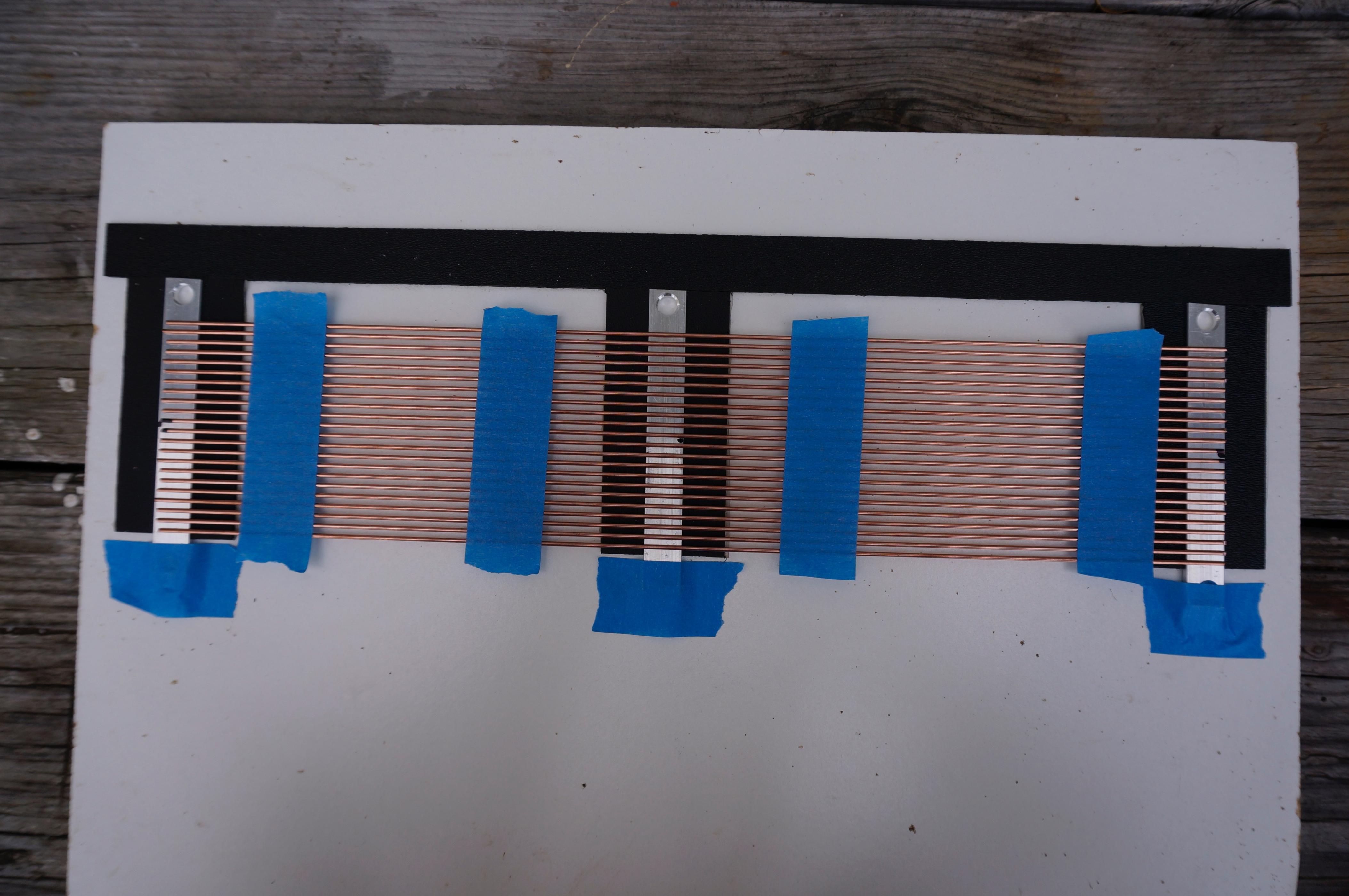

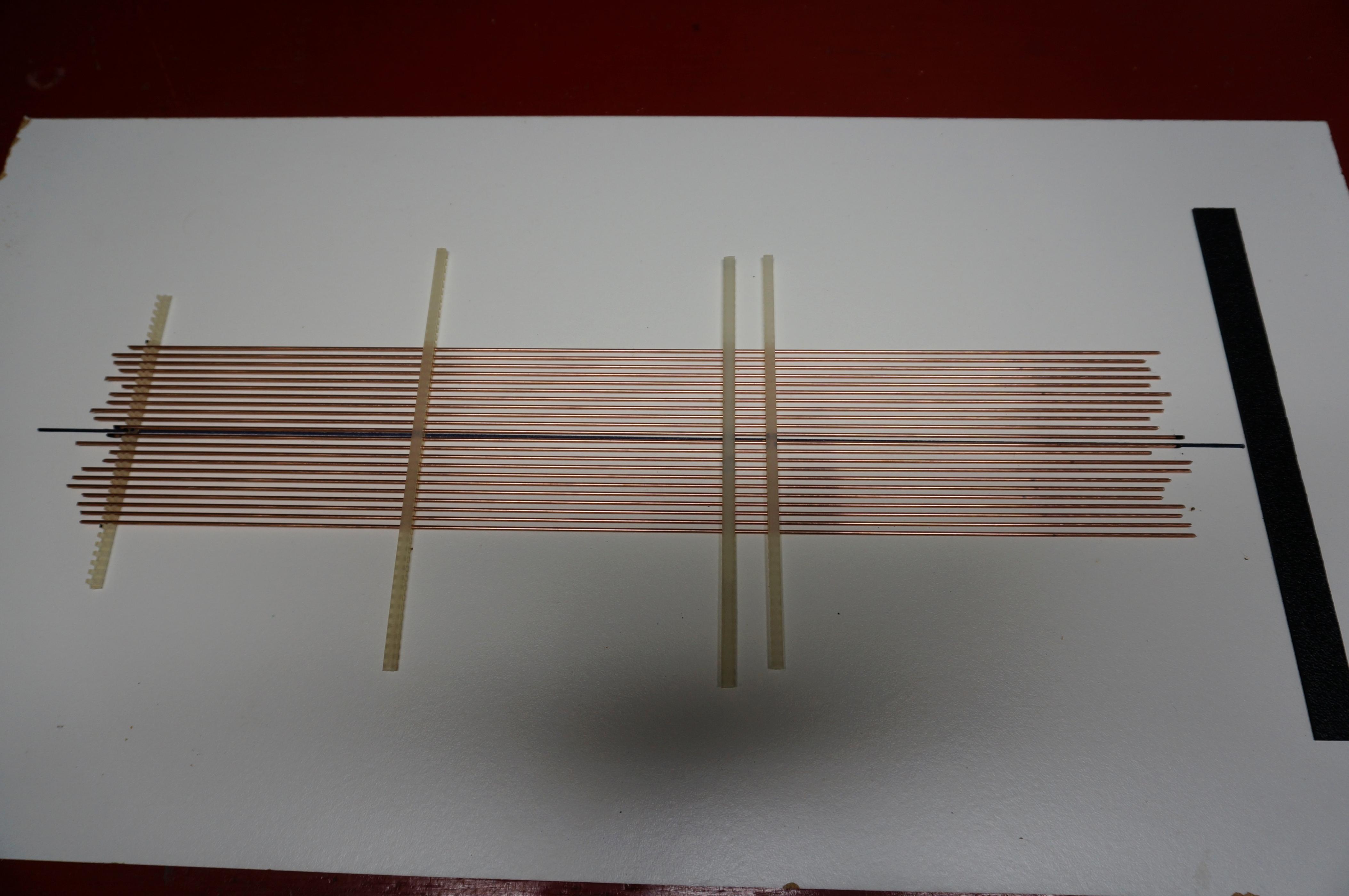

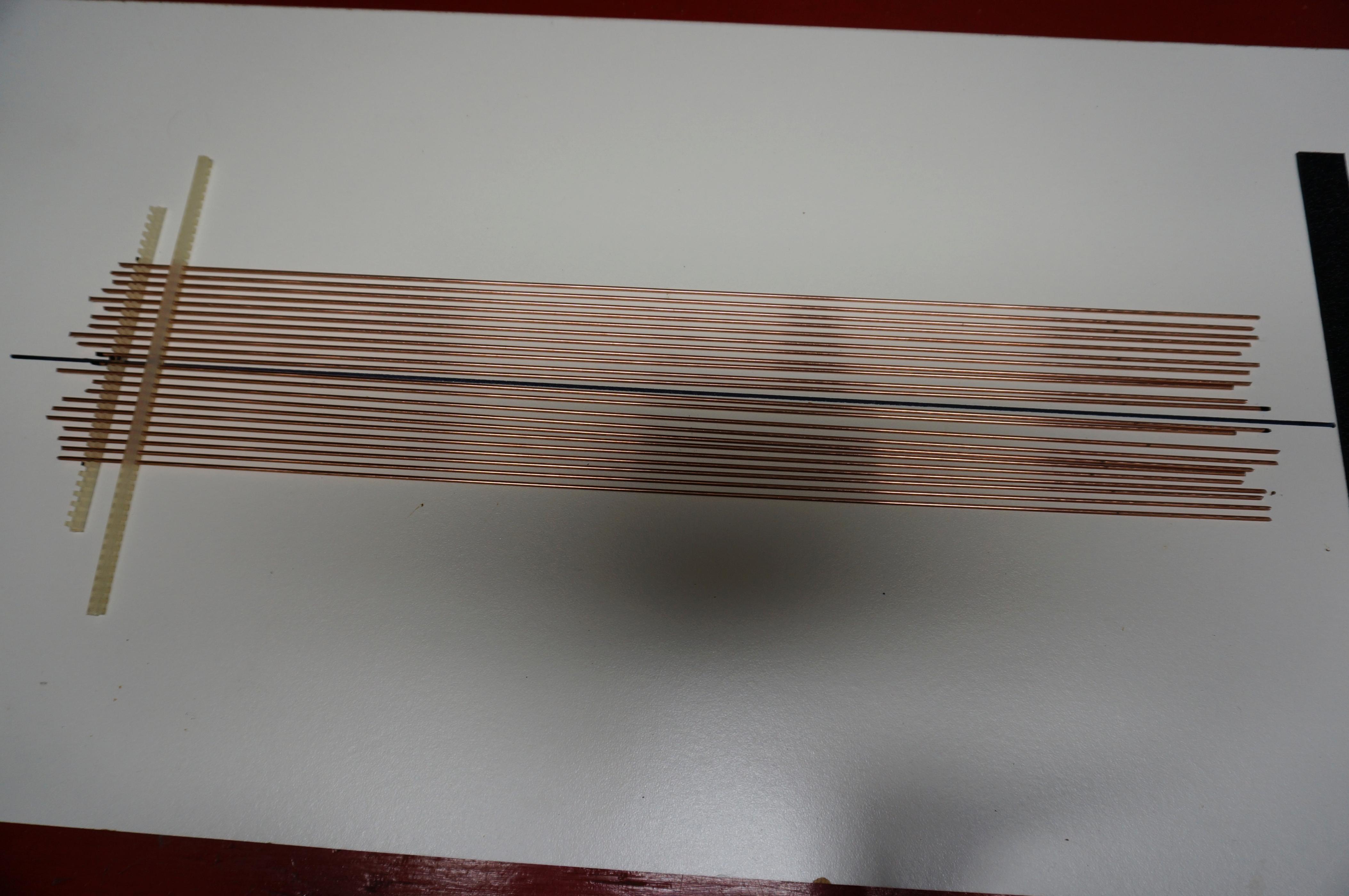

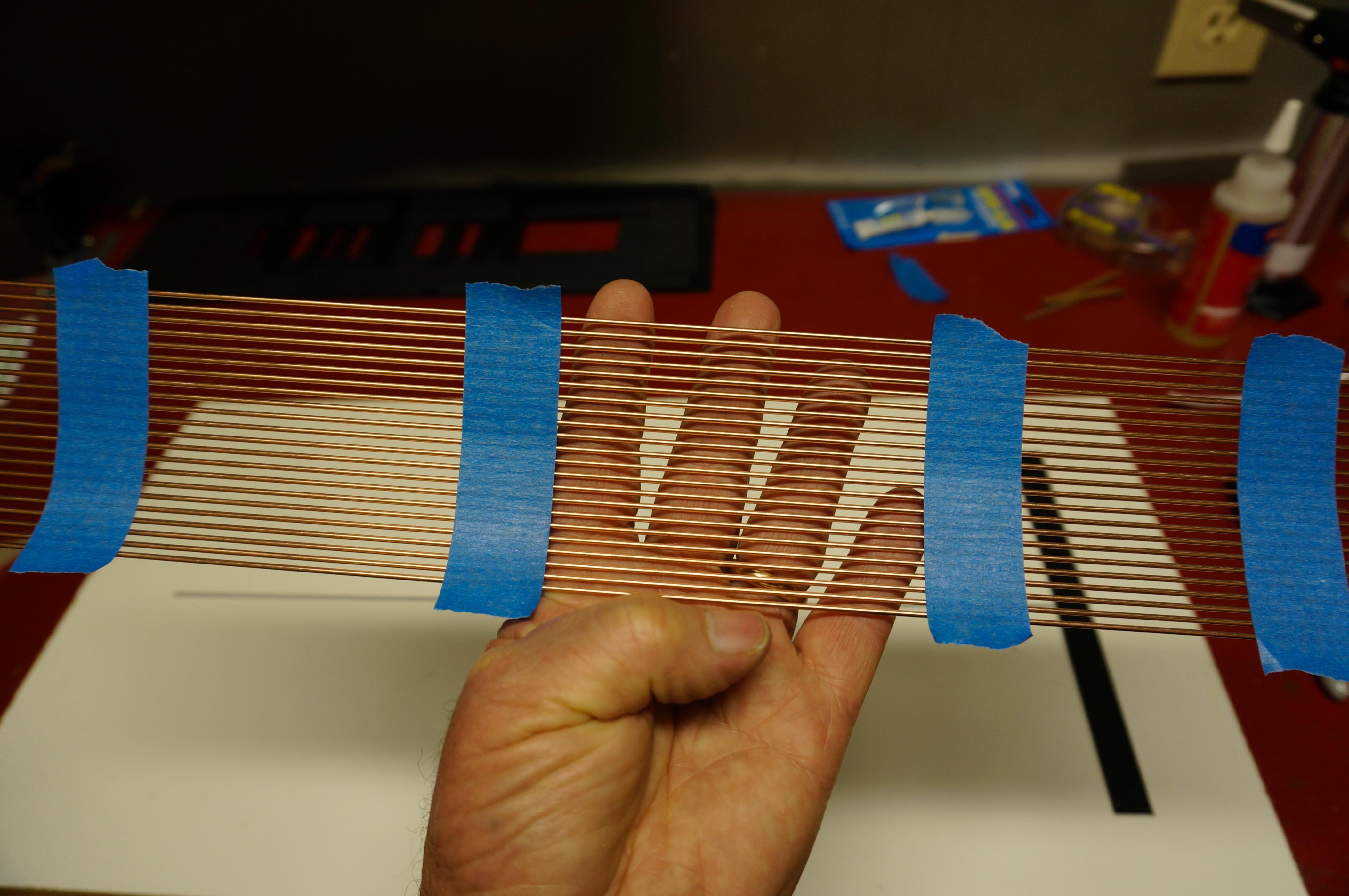

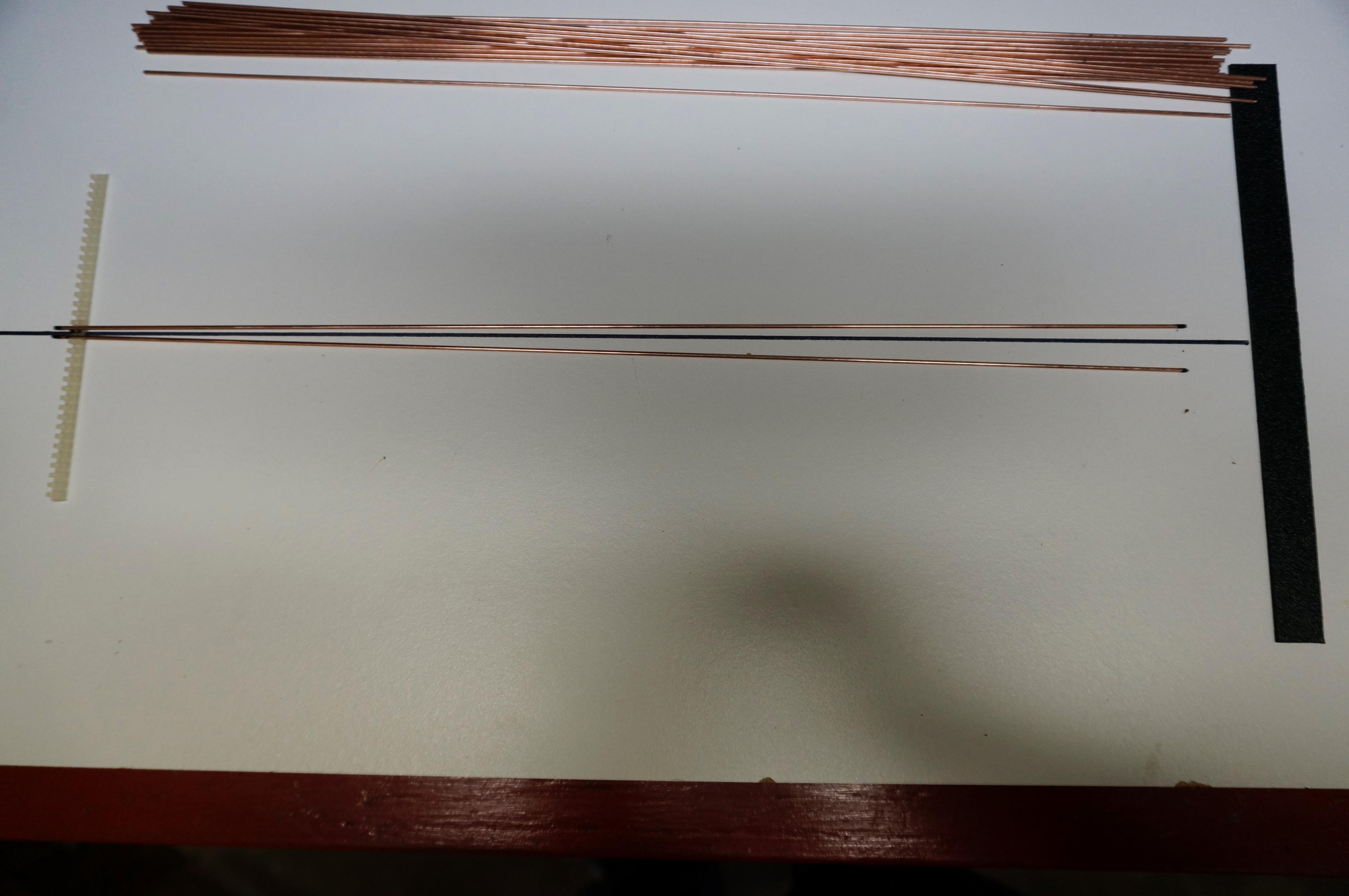

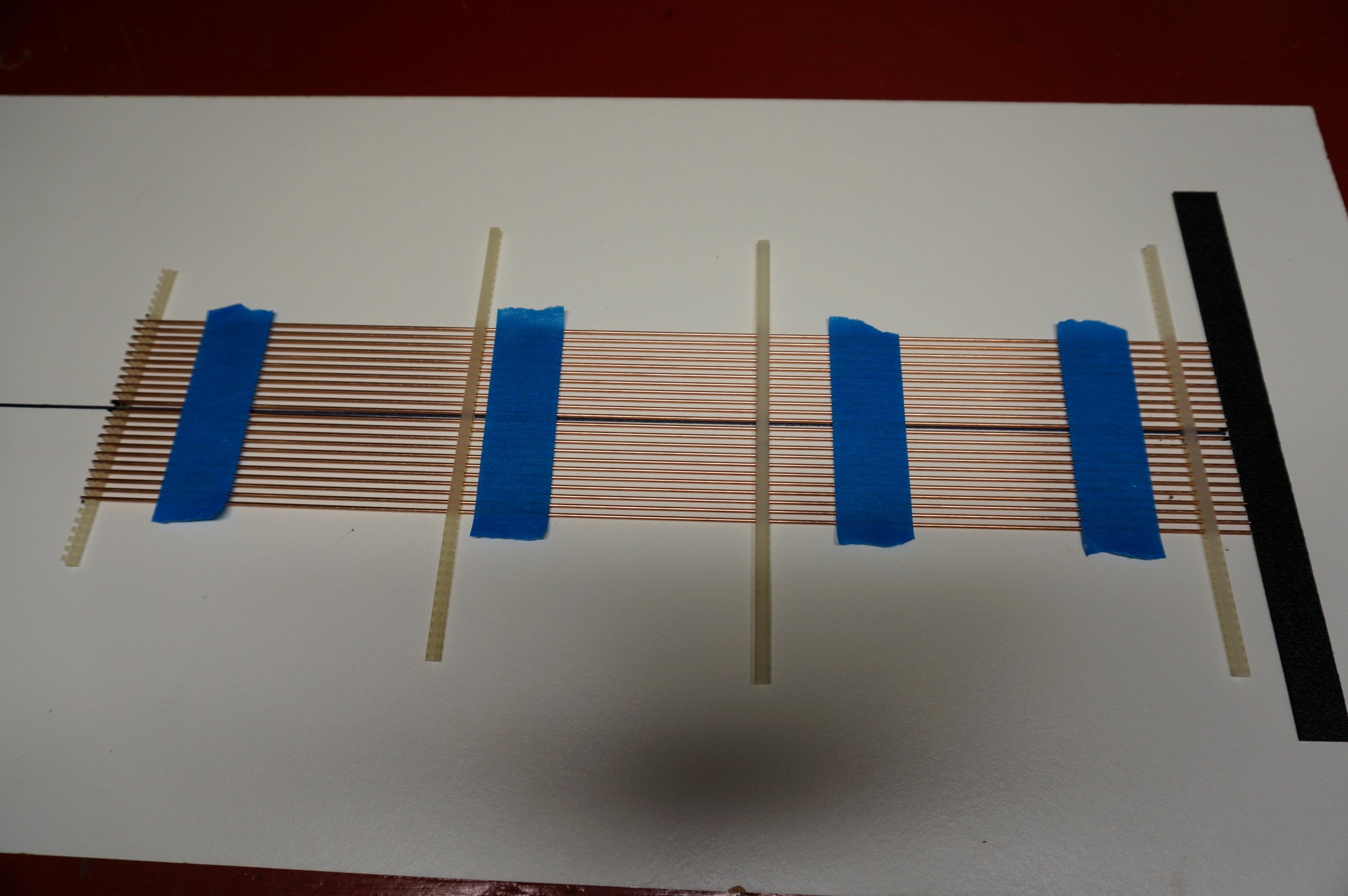

Now for the second most tedious job...cutting the wires to length.
Originally I tried the bulk method described on another post using bundled wires tightly held together with hose clamps, cutting with a metal blade(in my case on an arm saw). Somewhere I must have erred, cuz for me it was a total disaster. The first 3 or 4 rods cut ok, but the rest just fused themselves into one solid end piece. I decided to go back to cutting one at a time using a good set of wire cutters. Time consuming but good for developing a manly handshake. The wires should be about a 1/16 to 1/8" shorter than the end to end measurement of the cross bars.
Now the fun parts begin; pre making the wire assemblies to lay on the cross bar jig. Making a template with another piece of melamine easies the process. A straight line is drawn down the center of the melamine, with a strip of ABS positioned at right angle to the center line used as a stop. Placing a nylon edging grommet(attachment 1) with their teeth facing up on the template, the wires are ready for assembly. The grommet has marks for the center and ends. Starting with two wires that have both ends marked by a black sharpie,to indicate the center of the grid( I used an even number of wires-22, but with an odd amount- only one marked wire would be necessary), they are placed on the center of the grommet(Attachment 2).
Once all the wires are down, another grommet, now with its teeth down, is positioned next to the first up grommet and slid(or combed) down about five inches-aligning the wires as it goes(Attachment 3). This is repeated until the wires are evenly spaced end to end(Attachment 4). Making sure that the wires are centered on the line and the ends are evenly against the stop, carefully start laying some masking tape across the wires. Just enough to cover them, but not so much that the tape sticks to the melamine(Attachment 5). Try to mark where the cross bars will be so the tape does not get in the way of the glue. Now the grommets can be removed and the taped assembly can be carefully slid off the melamine, ready to be glued to the cross bars. Attachment 6. Fun
Next: Epoxying and soldering
