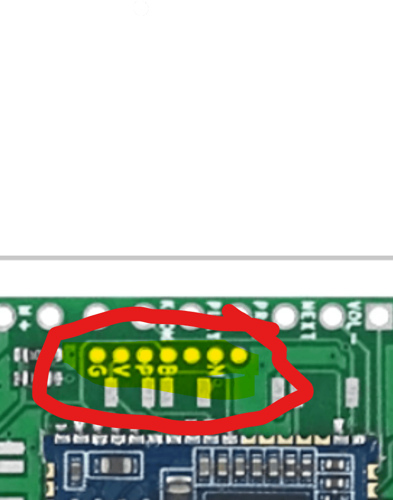

Hi guys, i put this question in here because of this good thread CSR8675 programming guide w. software and tons of CSR info and have in the past edited a few CSR chips, but prefer the QCC3003/3005 boards. Normally ill use my CSR\USB programmer and connect to the board with a Pogo Pin clamp and then change the name of the BT and edit the DSP\EQ settings. Recently i grabbed the QCC3034 board shown in the Aliexpress link

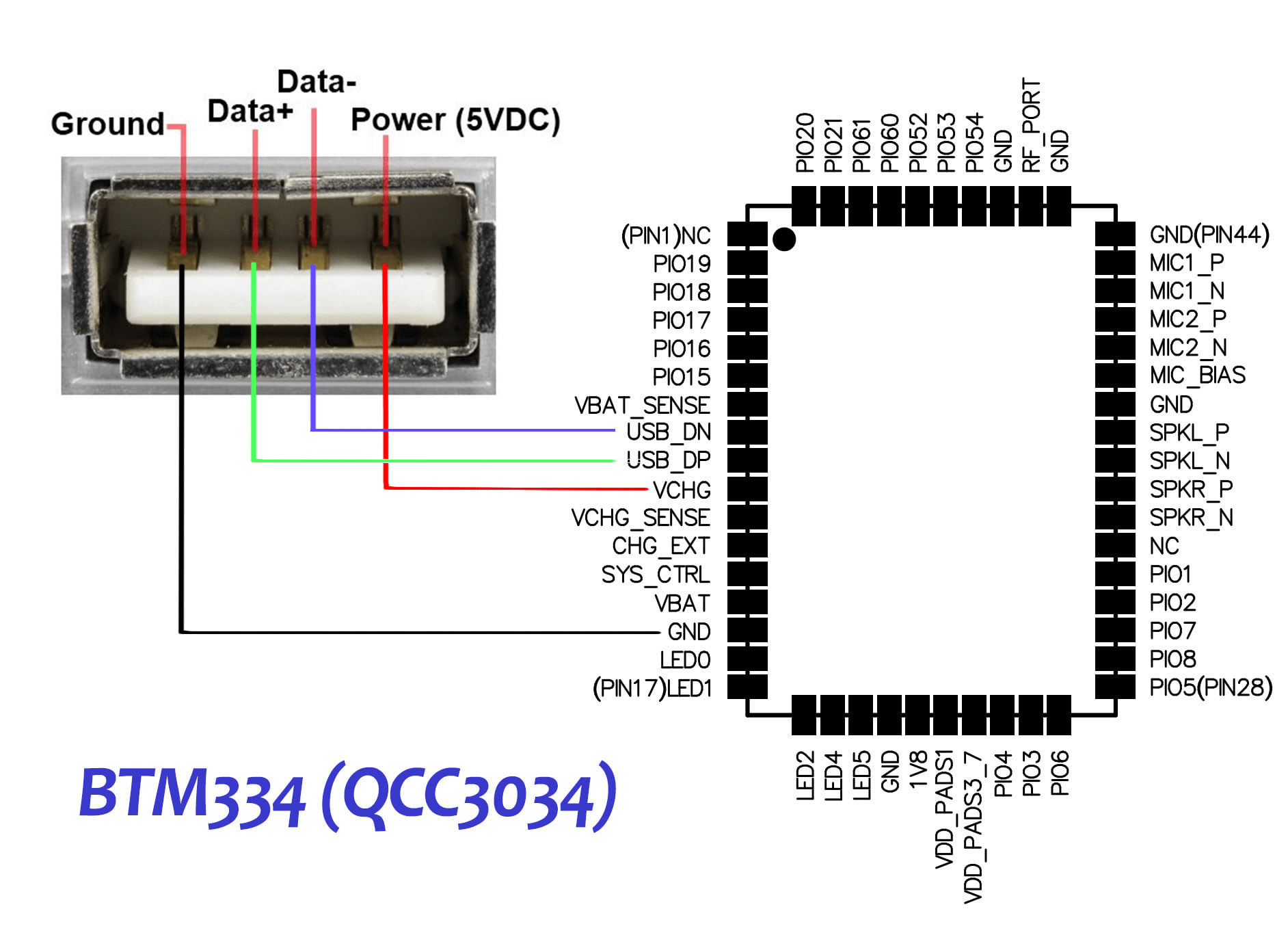

but cannot figure out what the N, P, P, V and G relates to the programmer and if i can use the Unviersal front end and APK tools like you do with the others?

thanks. Sorry to keep asking all these dumb questions, i see how you unlock/backup using the tutorial. but one other Q i have is do you solder to the board? Looks like there are some contacts on in the PCB that could connect, but not 100% sure.
