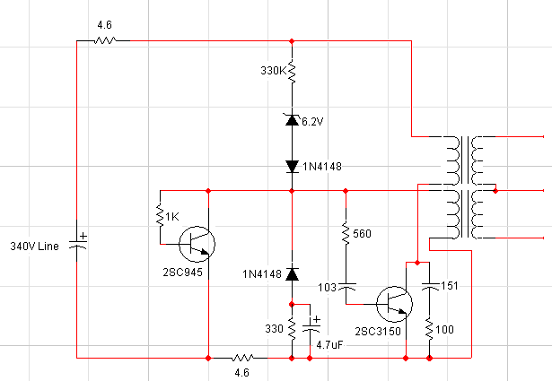

Prof-check this schematic (Please!!!!!)
I copied this schematic off of an ATX power supply, it's the stand-by circuit.
The transformer is a 1 primary, 1 feedback on the same side and one center tapped secondary.(I didn't have the right symbol in my program so I stuck two together)
Only other thing I notice was on the board they had a spot of a resistor going for the emitter of 2SC3150 to base of 2SC945. Any ideas what that mite of been for?
