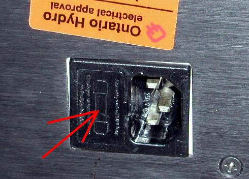

moamps said:(P.S. Does ML380 have three fuses in the transformer primary????)
There are two fuses: on live and neutral connections.
Peter Daniel said:There are two fuses: on live and neutral connections.
And this one ....
Very good observation. I actually didn't even think about it.😉
